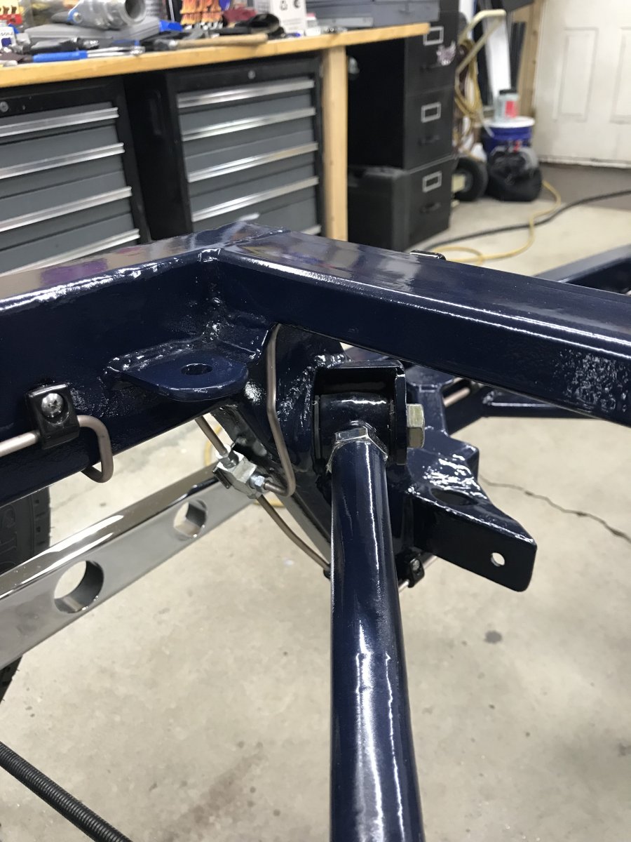

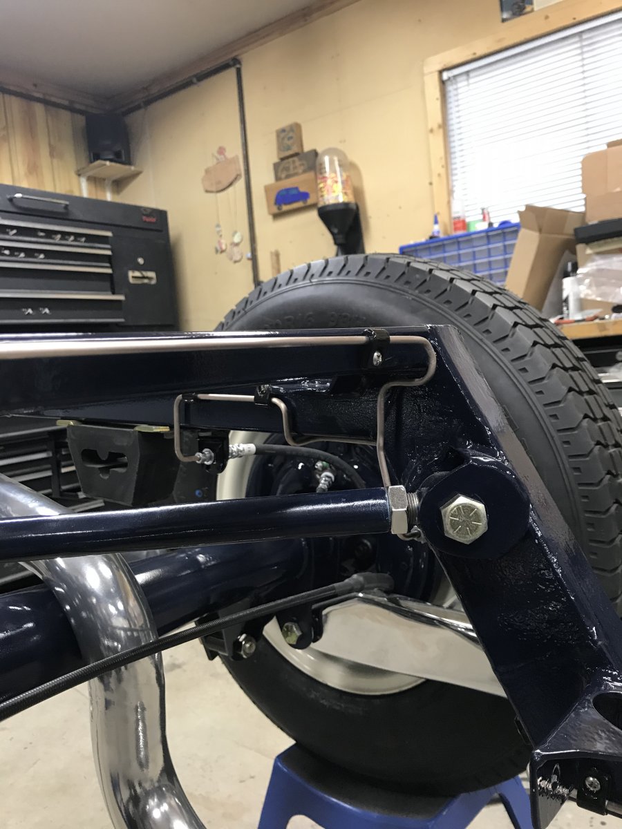

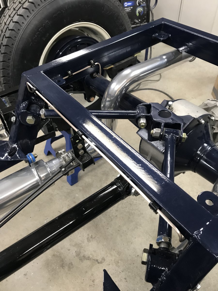

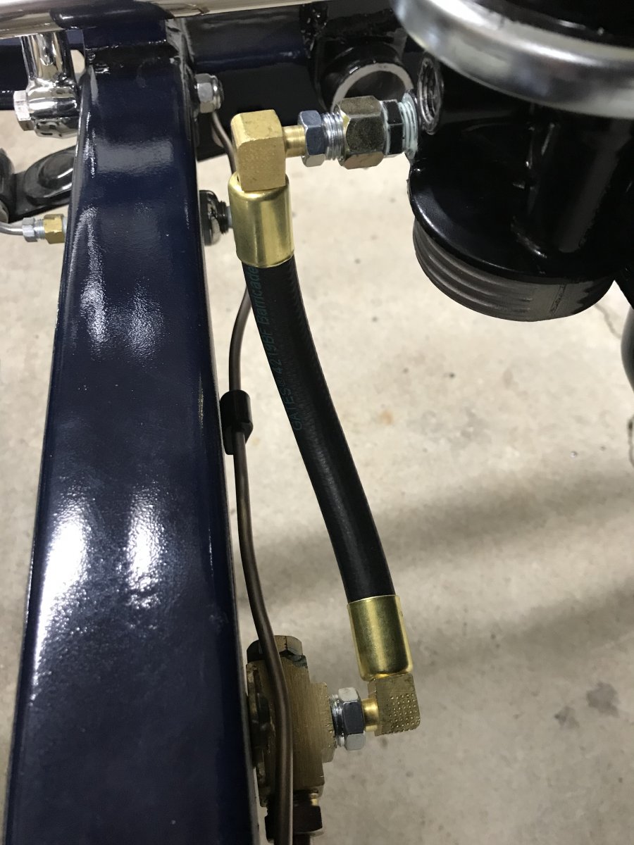

    Brake lines are wrapped up to the rear brakes.
    Not having any brake lines mounted on the quick change itself worked out well and looks clean.
    Fluid and bleeding soon.

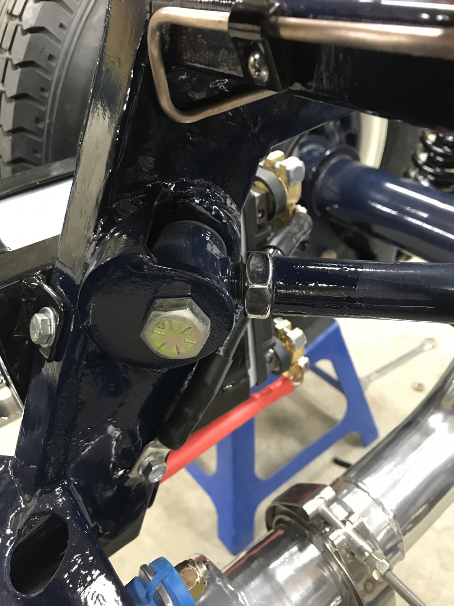

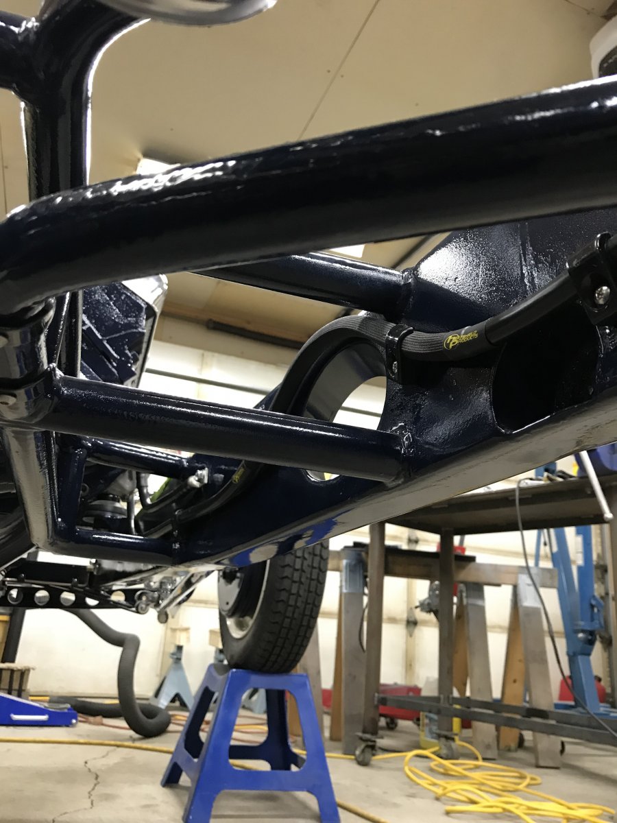

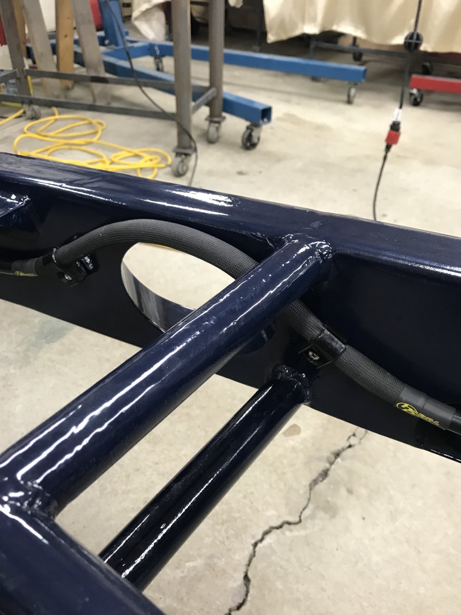

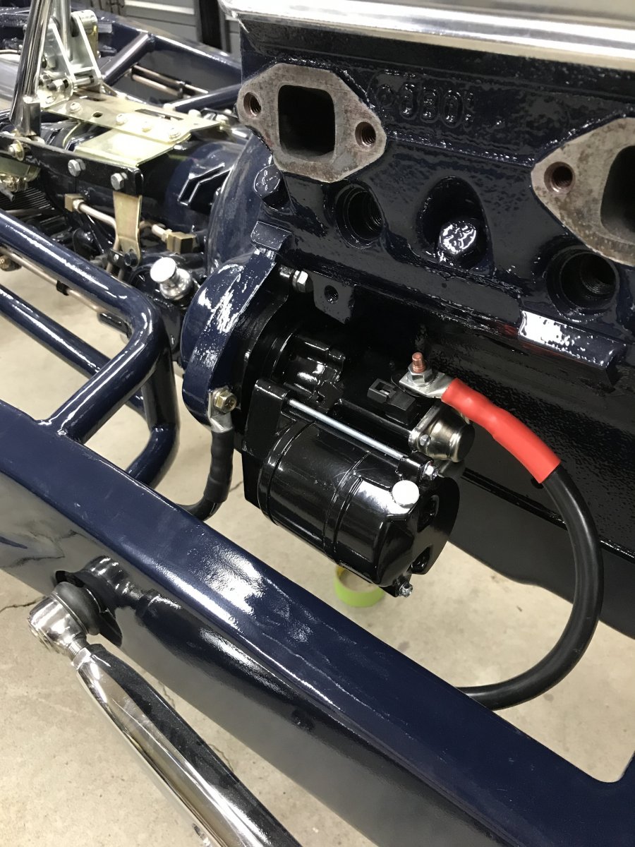

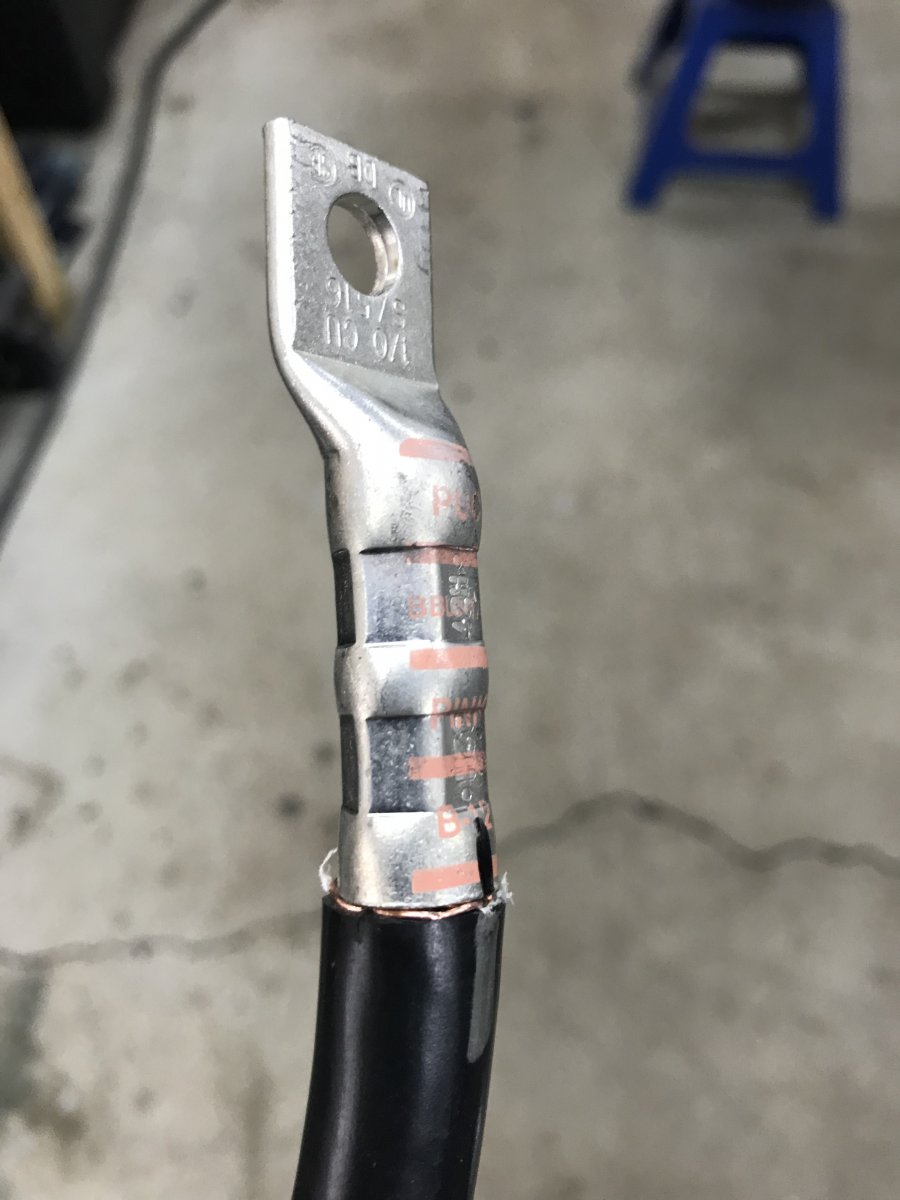

    Had to crimp the lugs on the battery cable and then seal the lug ends with glue lined shrink tubing.
    The cable is all mounted using the same made for you clamps I used on the brake and fuel lines.
    I used a little Hot rod heat sleeve heat insulation on the cable where it p***es over the exhaust.
    So the full system including the ground for the engine is 1/0 battery cable.
    I’m still debating removing the starter and painting it black.
    594391A2-0EB4-4922-B480-D80EAE7C355E.jpeg ED8658F9-E270-449E-90CC-541F8CFA701F.jpeg D7C73727-489A-4F13-ADB5-6E1EDD5E3725.jpeg CD3ED94C-6051-4DCB-AAF5-4140FCAAE72D.jpeg A266561F-6F1C-4950-B7E3-B6452F15CBDC.jpeg A7935389-F655-45B5-A4A1-1DDFE04C7AA0.jpeg 315B3336-C448-4AB9-90F0-4BF94C29A2E9.jpeg 8458789B-9B41-4E8B-AD37-463E21993E30.jpeg 07D1C7C1-9840-490F-B05F-2E14159B3337.jpeg

    Paint that starter!
  16. Blue One
    Joined: Feb 6, 2010
    Posts: 11,512
    Blue One
    from Alberta
    The starter is perfect, it’s been tested and works flawlessly
    :D Okay guys I’m painting the starter :D

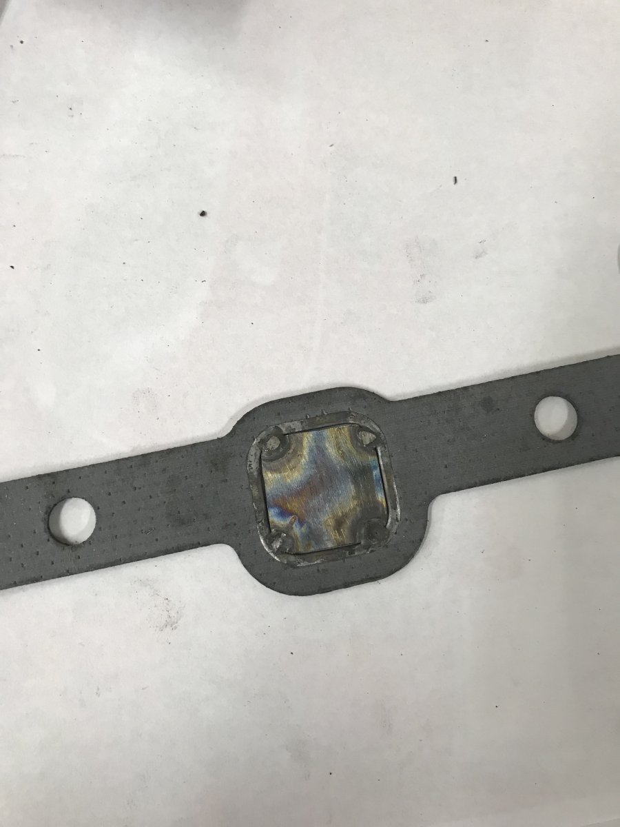

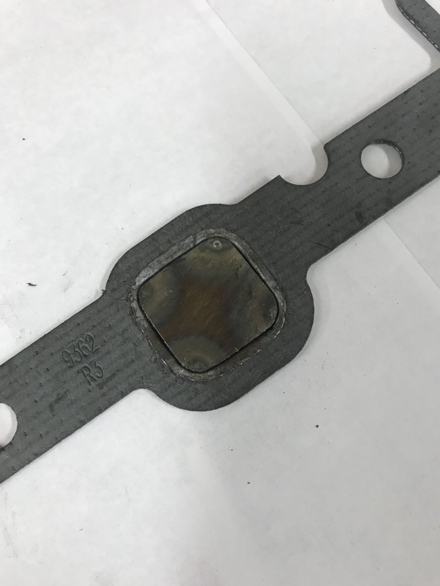

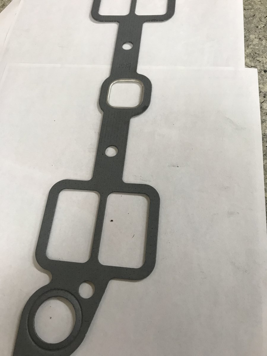

    I wanted to mount my intake and I also wanted to block off the center exhaust ports to the intake so that it won’t burn the powder coating on the manifold.
    I took the gaskets and gently pried out the sheet metal insert around the center ports
    Then I cut a couple of small squares of 1/16” stainless and carefully Tig welded (20 amps)
    them in at the 4 corners.
    Placing them back into the gaskets and tapping the lip back down did the trick. :cool:
    Blocked off and my intake will stay pretty :cool: :D

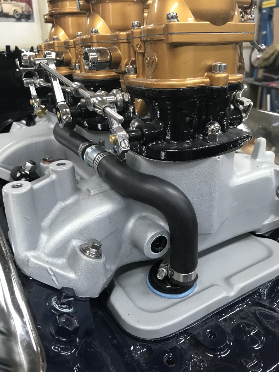

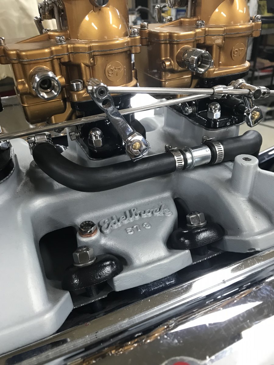

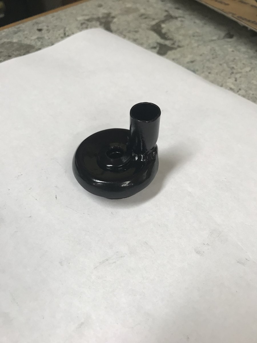

    I came up with a technique to make custom vacuum hoses in 1/2” and 3/8” for both ends of my PCV system.
    I’m using an inline PCV valve that is originally for a 60s Ford truck with a 292 YBlock.
    Old stock Deutsch 131.
    The making of hoses involved the formed hoses I gathered during my wrecking yard day and a little modification.
    First you cut the hoses and arrange the bends to suit where you want to go with the hose.
    Then using some Loc***e 404 Industrial super glue you glue your hose together.
    After that you slide the hose into a length of dual wall (glue lined) heat shrink tubing, I used 1”.
    You shrink the tubing and presto you have a custom hose.

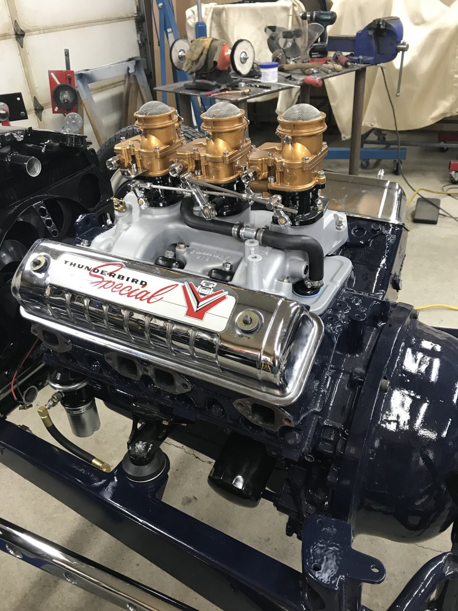

    Because my Edelbrock intake sits over top of the Mummert valley pan’s baffled PCV outlet I also had to cut down and modify a stock Yblock
    PCV valley pan outlet to fit.
    Turned out nice :cool:

    And then the beauty shot ;) :D
