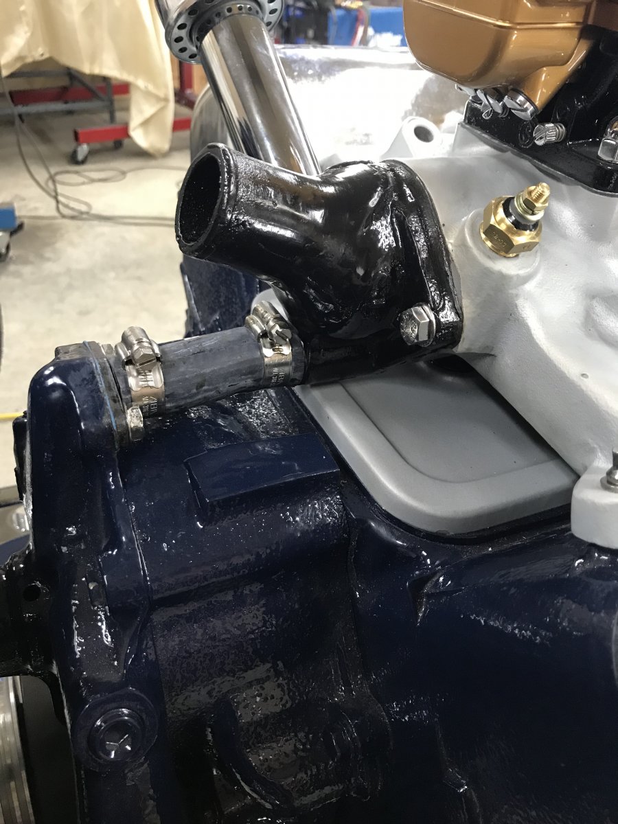

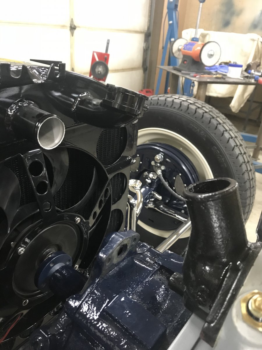

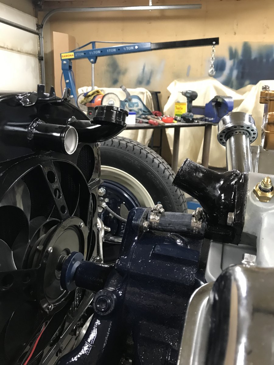

    I have 2 different thermostat housings, one that tips the outlet off to the side and one that points up.
    Neither one is ideal, the one that points up is the best however it’s not far to the rad and it’s pointing at the sky :D
    So, I cut it apart and I’m changing it so I’ll be able to have a decent top rad hose.
    Stay tuned :D

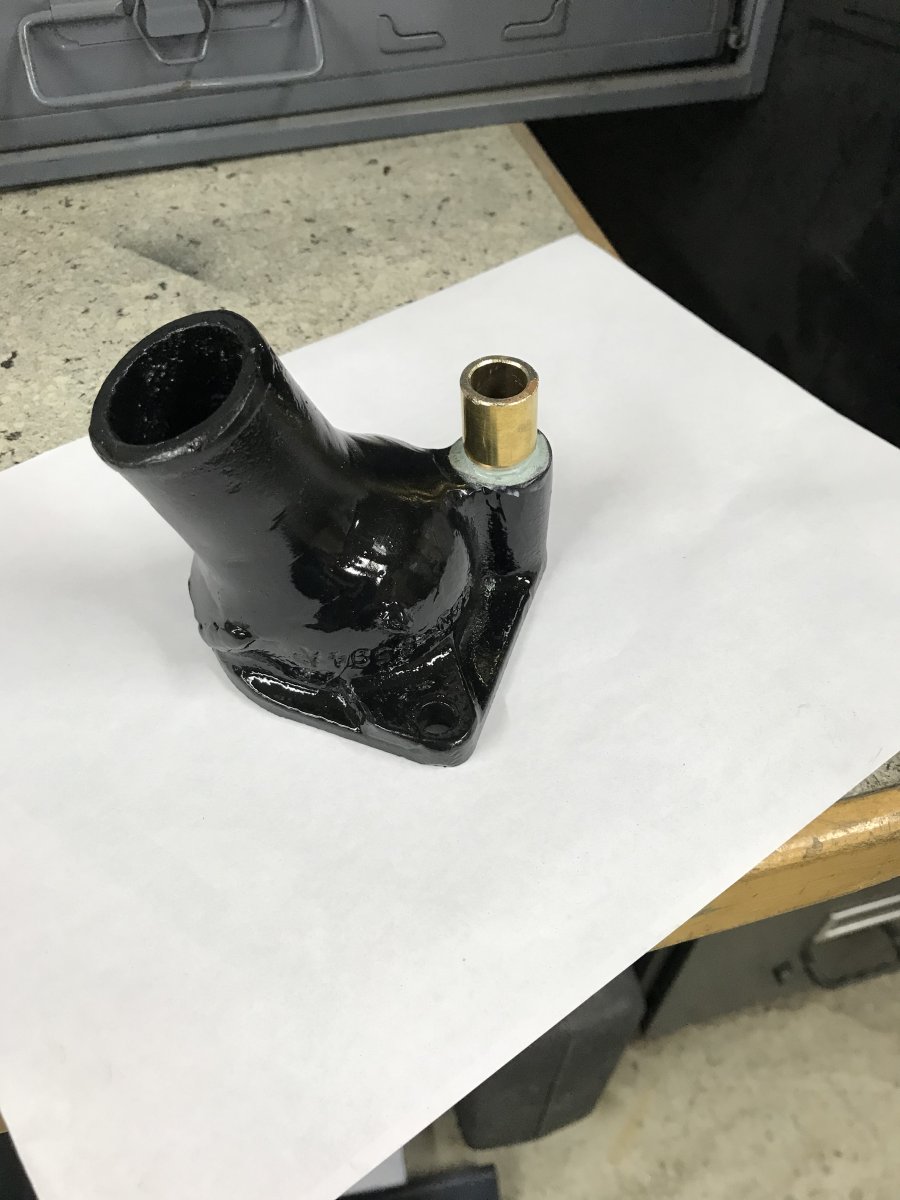

    So, here’s how a seemingly simple modification of one little piece can take up the better part of 2 plus days :D
    Cutting apart a casting made in the 50s was interesting to say the least.
    Welding it back together with nickel rod was challenging given that it constantly wanted to crack :mad:
    After 4 tries I finally got it done.
    The final solution was nickel rod welding followed by a slow cool wrapped in insulation and then a sandblast followed by a coating of handi flux for a coating of silver brazing alloy to fill in all the pits that kept coming up from the **** coming out of the old cast.
    Whew.
    Then I had to do something about the corroded byp*** hose tube connection.
    That involved removing it and tapping the hole out to 3/8 NPT and threading in one end of a br*** pipe ******.
    After all that I’ll at least be able to have a decent top rad hose.:cool:

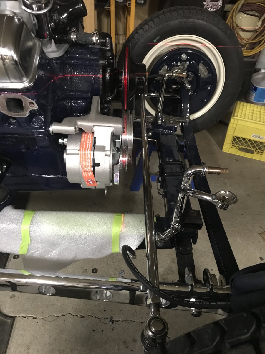

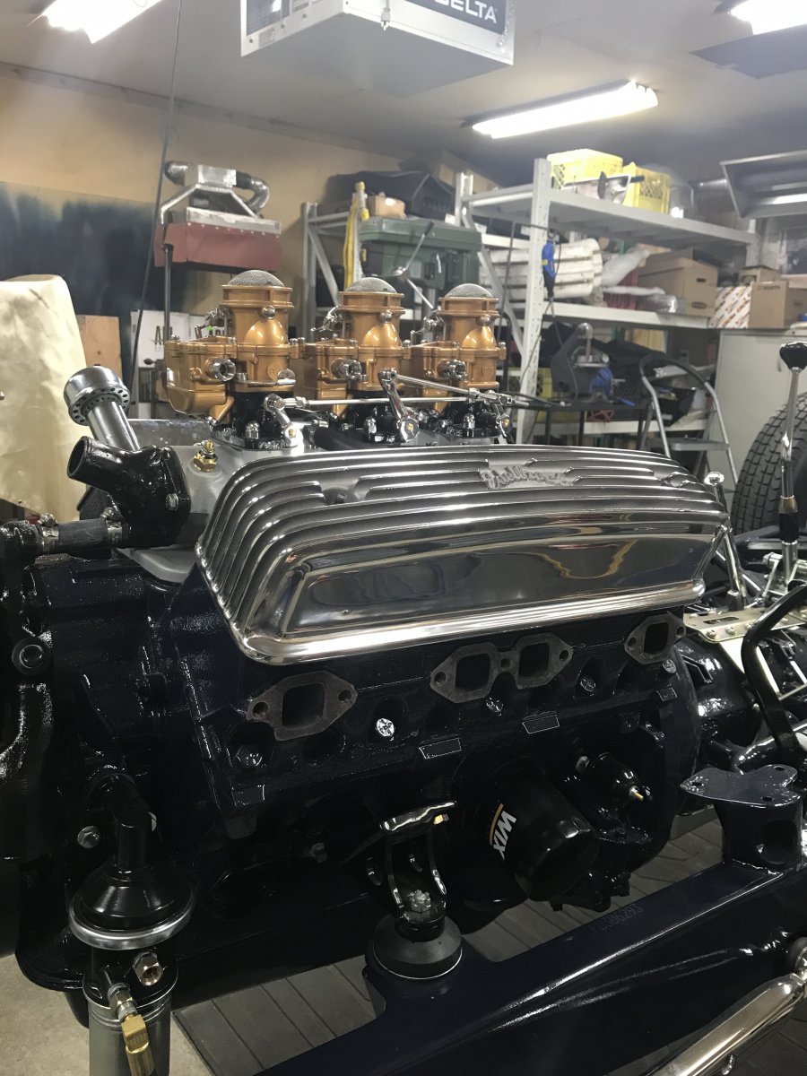

    Installing my water pump pulley and the Mummert alternator mount has proven to be interesting because I had Tim Mcmaster put a custom harmonic balancer and pulley on the engine when he built it.
    That required a bit of adjustment of the water pump pulley mounting flange and also meant that I had to space the alternator mount a very small bit from the engine.
    I got a little technical in setting up my laser to confirm that I had the pulleys all lined up properly.
    Once I get it sorted out I’ll paint everything before I ***emble it for the final time.

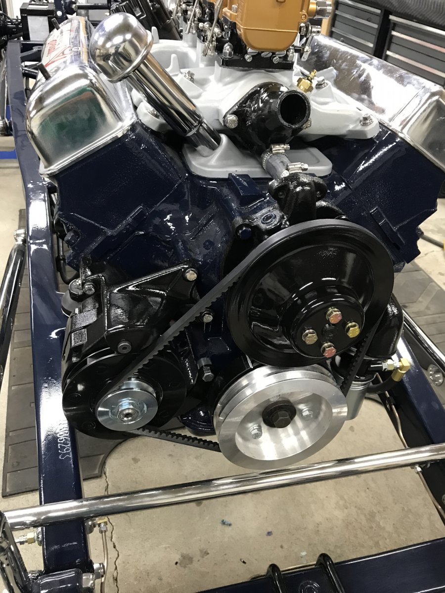

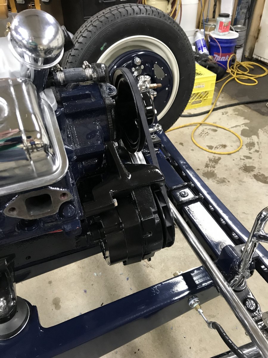

    I wrapped up the alternator installation, that Mummert alternator mount is really a nice piece.
    I painted the alternator just like the starter and I found that a handful of foam earplugs works well to plug up all the holes and keep paint out of the internals.
    A few trips to the parts store and I finally have the right size belt. :cool:

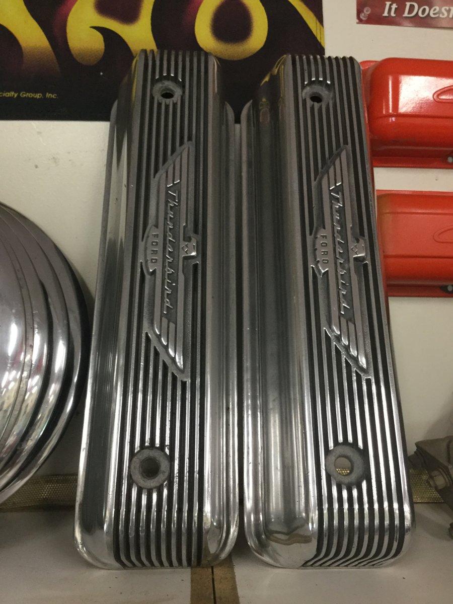

    I think you need these! PM me if you’re interested.
    Allan

    Thanks Al. I appreciate the offer, those are nice valve covers but I already have a pair of vintage Finned Edelbrock script covers waiting in the wings.

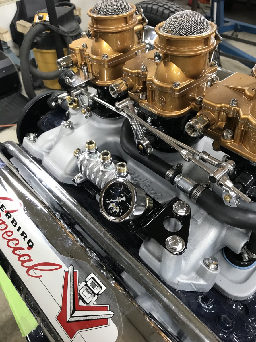

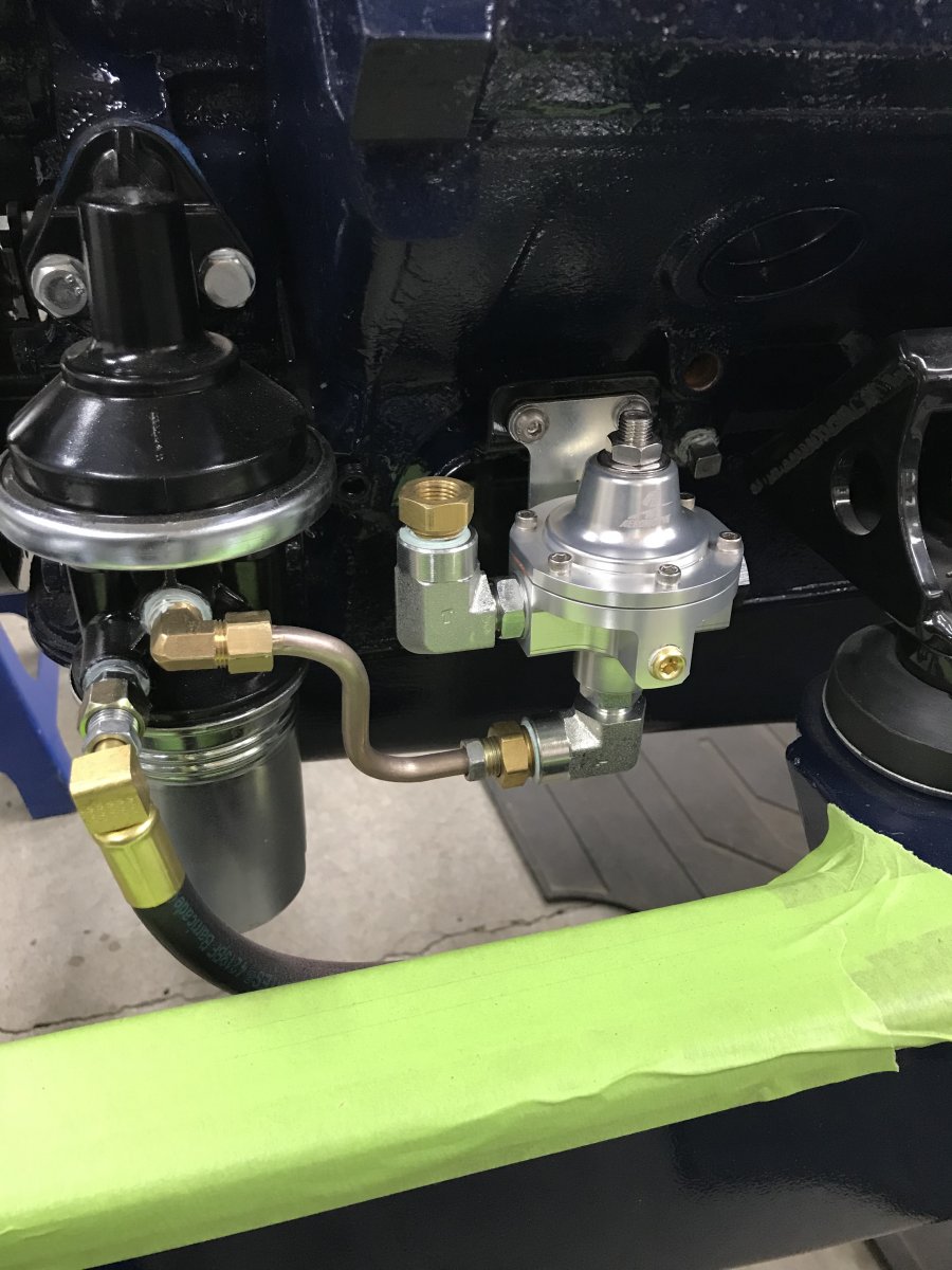

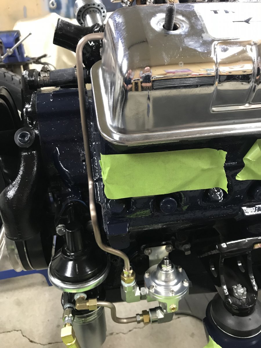

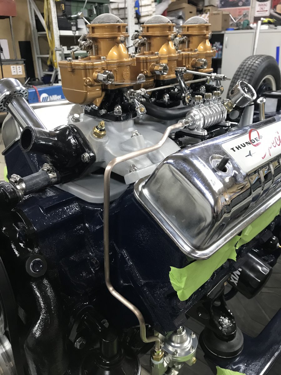

    I mounted the 1-5 psi Aeromotive fuel pressure regulator and then fabricated a bracket to mount the fuel log.
    Then I made the fuel line from the fuel pressure regulator up to the fuel log .
    Next will be the lines to the carbs.

  30. loudbang
    Posts: 40,346
    Great looking bends.
    brad2v and Blue One like this.
