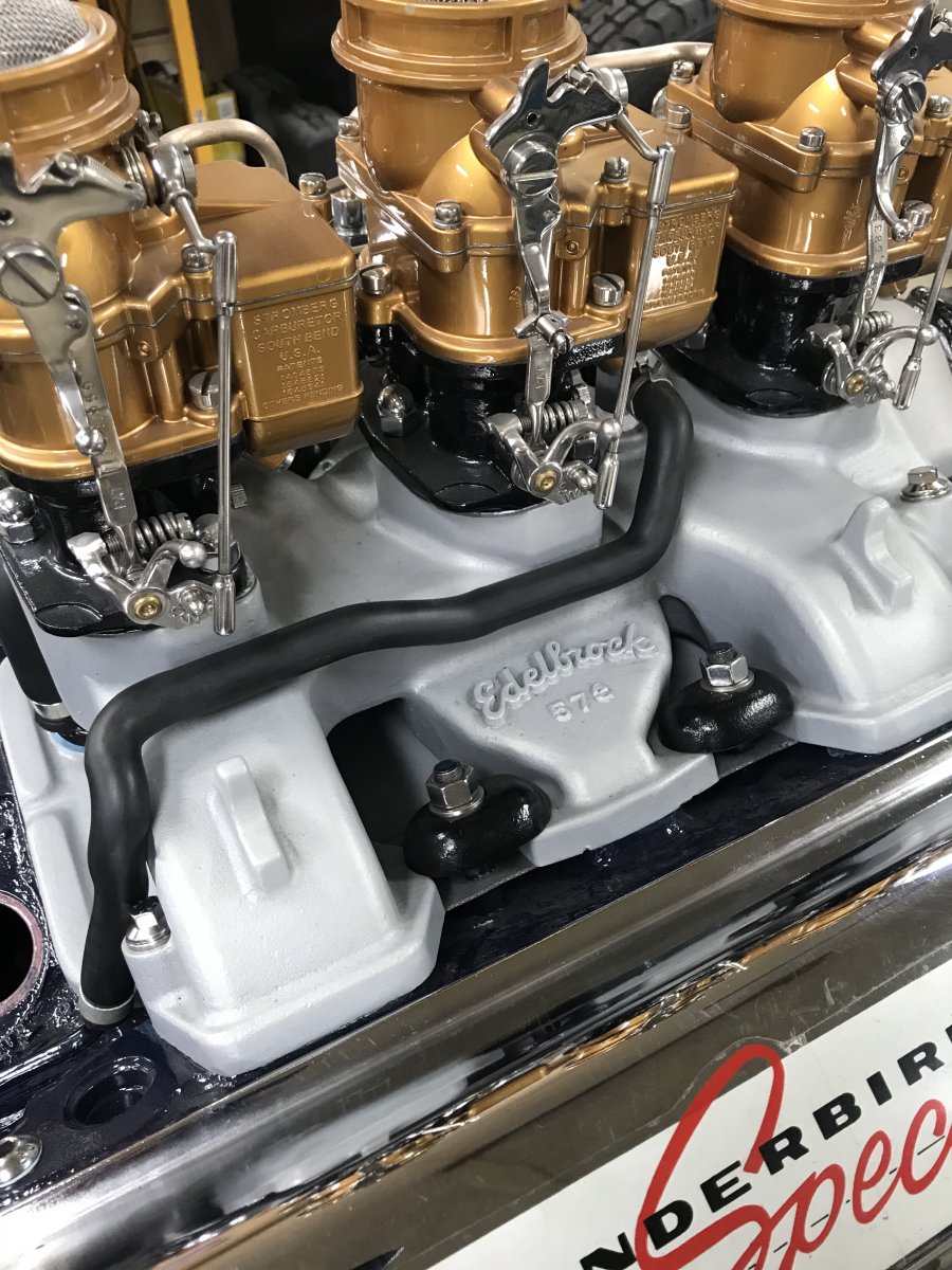

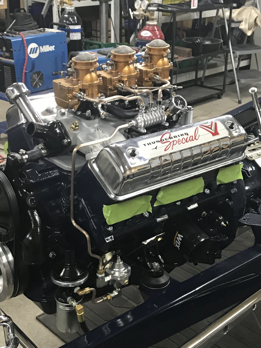

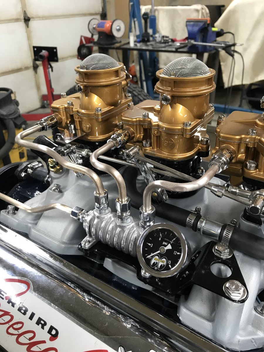

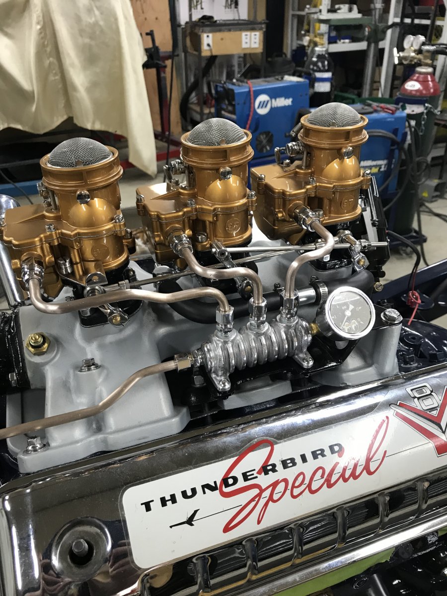

    Today I bent up and installed the 5/16” hard lines to the carbs.
    I only had to make them twice to get it done right :D

    Looks great Larry! I thought you were running a ****'s fuel pressure gauge?
  12. Blue One
    Joined: Feb 6, 2010
    Posts: 11,512
    Blue One
    from Alberta
    Yes I will be, that one is just threaded in loosely for the mock up until my package from **** arrives.

    The line on the front carb looked wrong to me until I saw the last photo, the jog I don’t like in it mirrors the jog in the line going into the fuel block.
    Like many things sometimes you’ve go to take a step back so your nose isn’t right up against it to get a real good look.

    I had the same thought when I saw it at first!

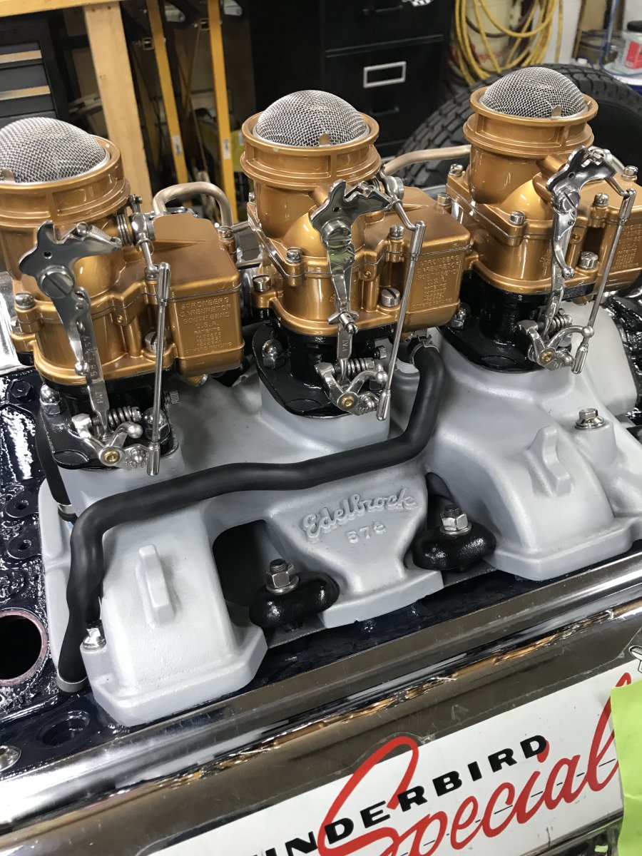

    A step back look.
    I’m happy with it :cool:

    You guys :D You got me thinking so I went out early this morning and took it apart and shifted things around to see what alternatives there were.
    I decided that it stays the way it is, because of the carbs positioning there was always going to be a compromise either with at least one of the lines or the location of the fuel log.
    If I positioned the fuel log where the lines would be more symmetrical then it would look funny.
    Another alternative would be a longer fuel log with wider spaced outlets but I like the little short log with the ribs that will sort of match my valve covers and the coil cover I have coming.
    No wonder this is taking so long to get done :D

    I was thinking you could , on the font carb, flatten the jog and then basically do two 90 deg turns into the carb. One up and then one into the carb. But I don’t know how reasonable that would be to physically bend it.
    Might have to scribble a picture of what I mean
    Like I said I think it works when viewed with that lower line.

    I can picture what you mean, I’m using an imperial tubing bender and they bend to a fairly small radius but even so it is difficult to impossible to put two 90 degree bends really close to each other.
    I had to get creative with the bender to get my bends as close together as I did.
    I’m pleased with it and it’s time to get on to something else :cool:

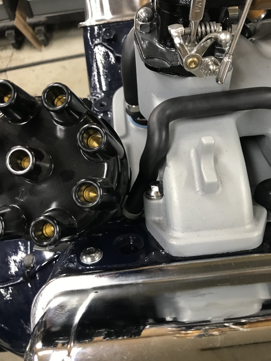

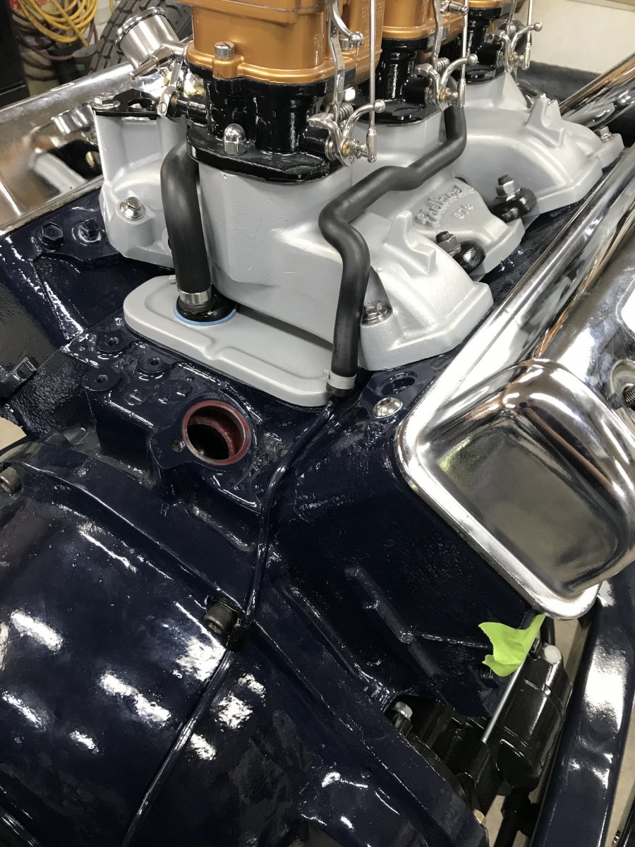

    I needed to plumb the vacuum to my C4 for the vacuum modulator.
    First I installed some 1/4 “ hard line and snuck it up behind the distributor.

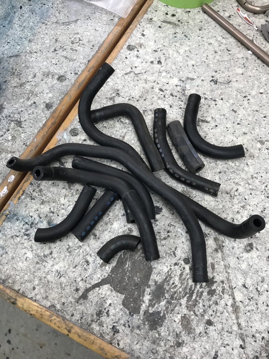

    A trip out to my favourite parts yard netted a bunch of different formed vacuum hoses and I used the splice and glue method and then covered it with shrink tubing to form another custom hose.
    I painted the tubing where it will be visible coming across the bell housing blue so it sort of hides :D
    The distributor just touches the hose very lightly and won’t be an issue as it turns easily to set the timing. :cool:

    Do you have any pix of your "splice and glue method" that you would share with us?
    I can think of several, but the one that strikes me as most practical would be to slice both pieces on an angle, baloney style, and glue together. Am I anywhere close to reality?
    For glue did you use rubber cement? Rubber weather strip adhesive? Epoxy? Something else?

    I should have taken a few pictures of the cut and glue but it’s pretty easy.
    I just mark the hose where to make the cut and then cut it with an olfa knife.
    A trip to my little 1” belt sander cleans ,flattens and squares the cut ends and slightly scuffs the rubber.
    Apply Loc***e 404 , or 495 industrial super glue and bond the ends together, like any super glue the bond is instant so get it right or try again :D I use a silver sharpie and make a line across the joint for lining it up when I glue it.
    Even though it bonds instantly it’s advisable to hold a little pressure on the joint for a minute or so just to be sure.
    The cuts are done straight, nothing fancy.
    Once that’s done slide the whole thing into a length of 1” Dual wall ( glue lined) heat shrink and have at it with the heat gun.
    I wear mechanics gloves as it gets hot ;)
    Just keep in mind this will only work for hoses like vacuum or PCV.
    This method is my own, hatched up in my head after experience making our own rubber o rings on industrial jobs for years.
    It was quite common for us to cut a piece of o ring rubber from a bulk roll and super glue the ends together for custom o rings.
    The Loc***e super glue was the best we found for the job.

    Thanks for sharing. That transmission vacuum line - wow! Looks like it grew there.

    No problem it was a repeat of the PCV hose on the other side just a little smaller.
    I’m happy with how it works.
    I think it’s a lot cleaner than just running a length of loose hose. :cool:
