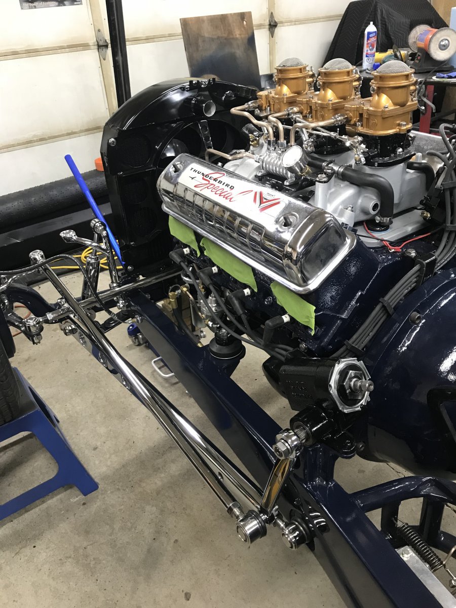

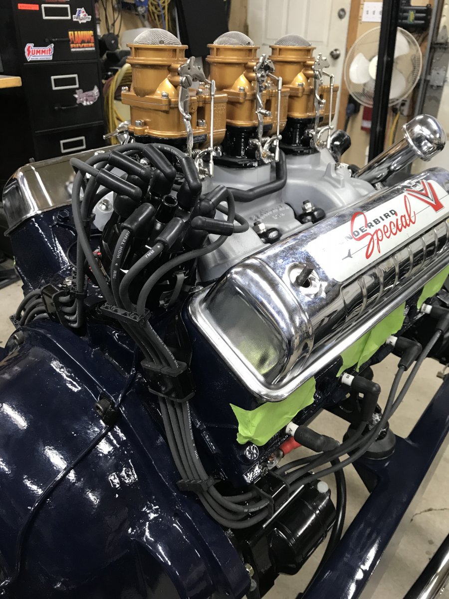

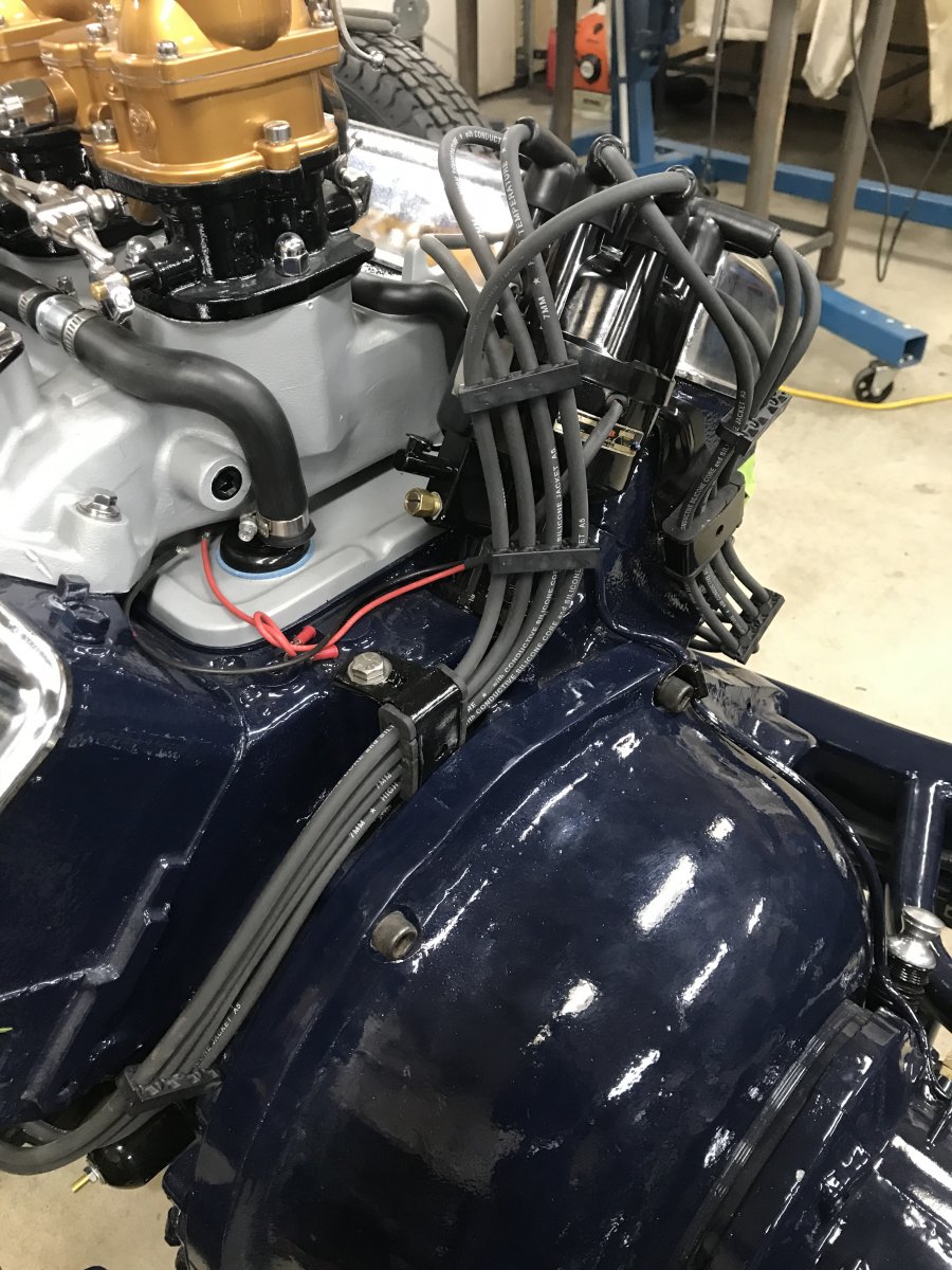

    Today I installed my spark plug wires. I’ve always liked the way the wires were loomed in the stock configuration on Y Block engines.
    With that in mind a while back I ordered a reproduction loom kit.
    It turned out to be a good purchase.
    I also didn’t like the wires coming up straight out of the distributor cap so I picked up a set of Taylor 90 degree boots and changed them.
    While I was at the wrecking yard last time I came across a newer Chrysler 300 ( Hey this thing has a Hemi :D )
    On top of the engine I noticed a whole bunch of little 4 space ignition wire loom retainers.
    I snapped off a half dozen of them :cool:
    They snap together and are quite nice.

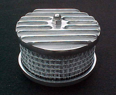

  7. Blue One
    Joined: Feb 6, 2010
    Posts: 11,512
    Blue One
    from Alberta
    I have a set of these from Vintage Speed.

  8. Tim
    Joined: Mar 2, 2001
    Posts: 20,343
    Tim
    from KCMO
    Hey I don’t hate that! Been trying to figure out something for our model a project.
    I love a frog mouth scoop but they are basically impossible to get a real filter to work. Some helmet style cleaners look cool but block a lot of air.
    Got a link to those? Could be a good option
    Never mind super easy to find via google ;)

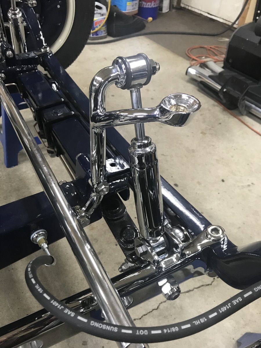

    The front shocks and the front panhard bar found their way onto the car today. :cool:

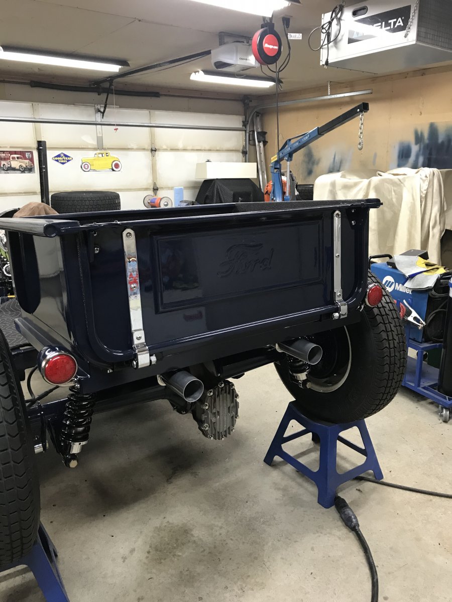

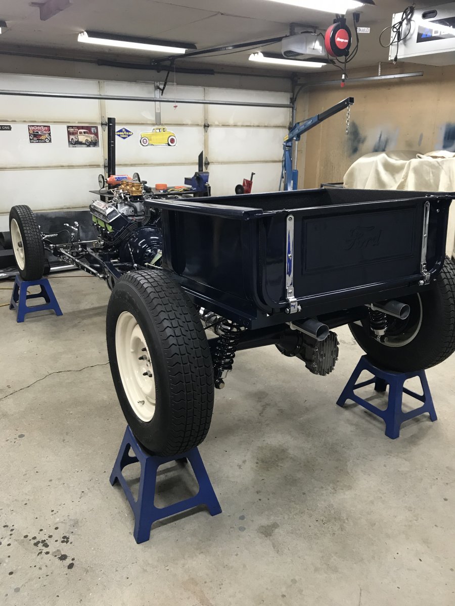

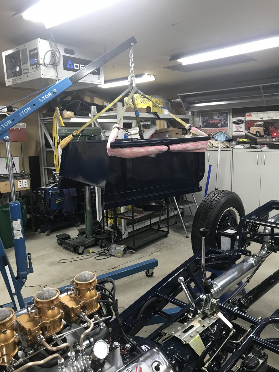

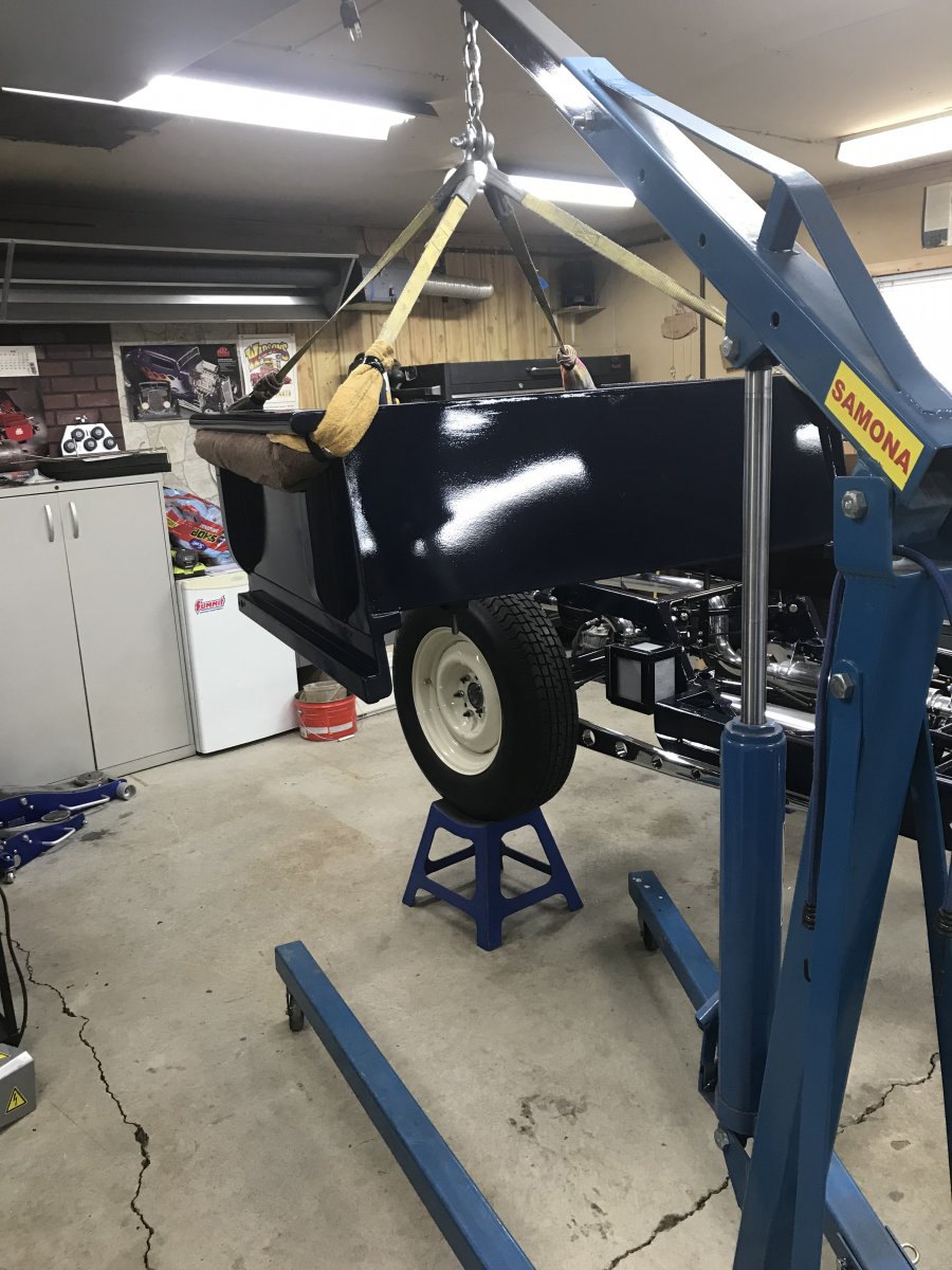

    A rather momentous occasion took place today.
    I hung the bed from my engine picker and had my beautiful wife help me position it and lower it carefully into place.
    It’s bolted down and I’m now working on installing the fuel tank and the rear section of the fuel lines. :cool:

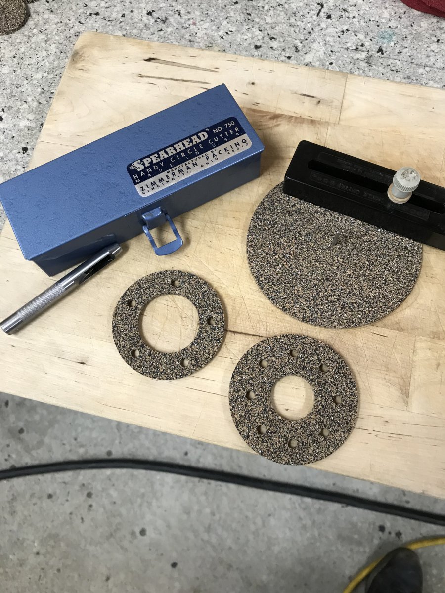

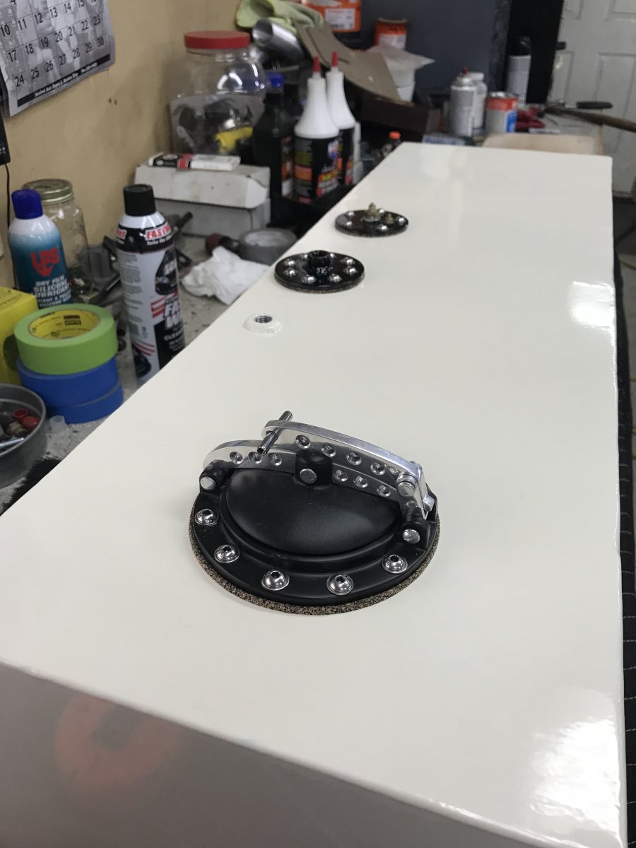

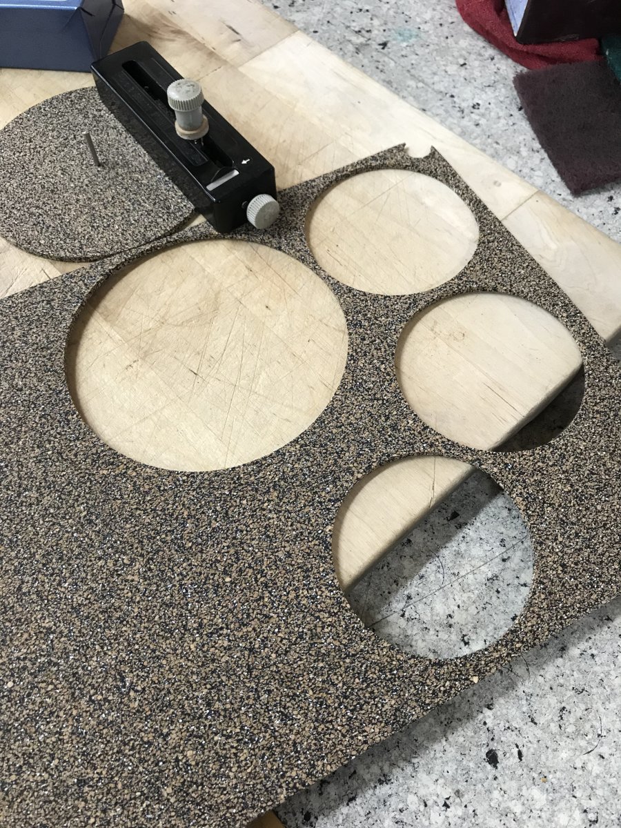

    Another little bit of a delay while a few parts go back to the powder coating shop.
    I had to slightly change my tank mount and the straps to a better design.
    In the meantime I cut some nitrile-cork gaskets for the fuel sending unit and the fuel pickup along with the fuel cap.

  18. GearheadsQCE
    Joined: Mar 23, 2011
    Posts: 3,670
    GearheadsQCE
    Alliance Vendor
    Boy, does that make some nice gaskets. I see that cutter is pretty expensive. can you show it at work? A video would be excellent.

  20. Blue One
    Joined: Feb 6, 2010
    Posts: 11,512
    Blue One
    from Alberta
    Sorry guys no video from me on this one.
    These Zimmerman gasket cutters are not made anymore, the company is gone out of business.
    There are some available through Allstate along with parts while they last.
    I used these cutters for years on the job working on industrial sites with the pipefitters.
    A while back I found this one NOS and had to buy it.
    They’re really nice tools they can also cut other shaped gaskets, not strictly round.
    Here’s a video of a similar (larger) gasket cutting tool.
    The principal of how they work is the same.
    brad2v, Stogy, loudbang and 1 other person like this.
  21. Blue One
    Joined: Feb 6, 2010
    Posts: 11,512
    Blue One
    from Alberta

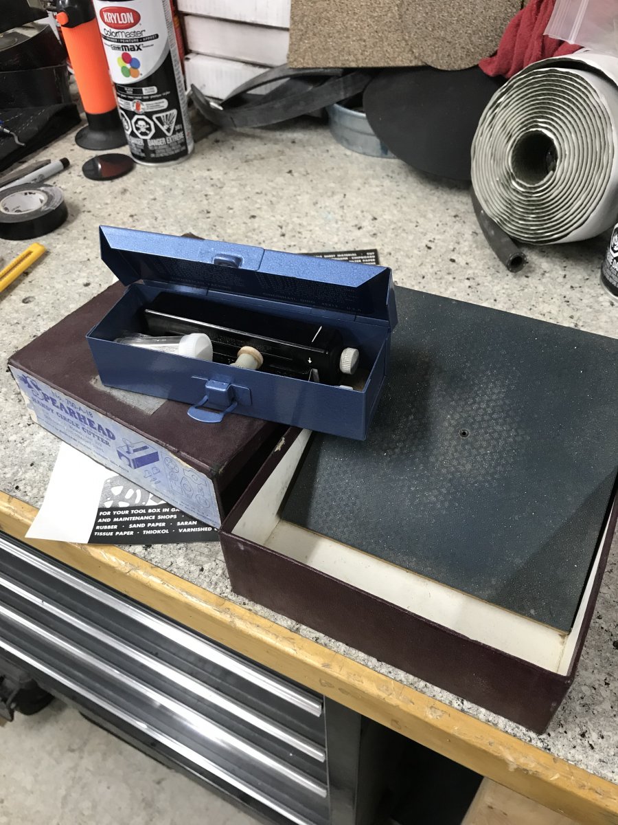

    It’s a nice little tool, here’s the paperwork that came with it.
    I bought it basically new in the box (old)
    and never used. I also got a bunch of blades etc.
    It only cuts 1/4”- 6” but I know how to make an extension arm to cut whatever size I want. :cool:

  22. GearheadsQCE
    Posts: 3,670
    GearheadsQCE
    Alliance Vendor
    Thanx for that.
    I envisioned a cutting wheel like a tube cutter. I suppose a guy could fabricate something like this but the details of the manufactured unit would be time consuming.
    I'll keep a lookout for a used one.

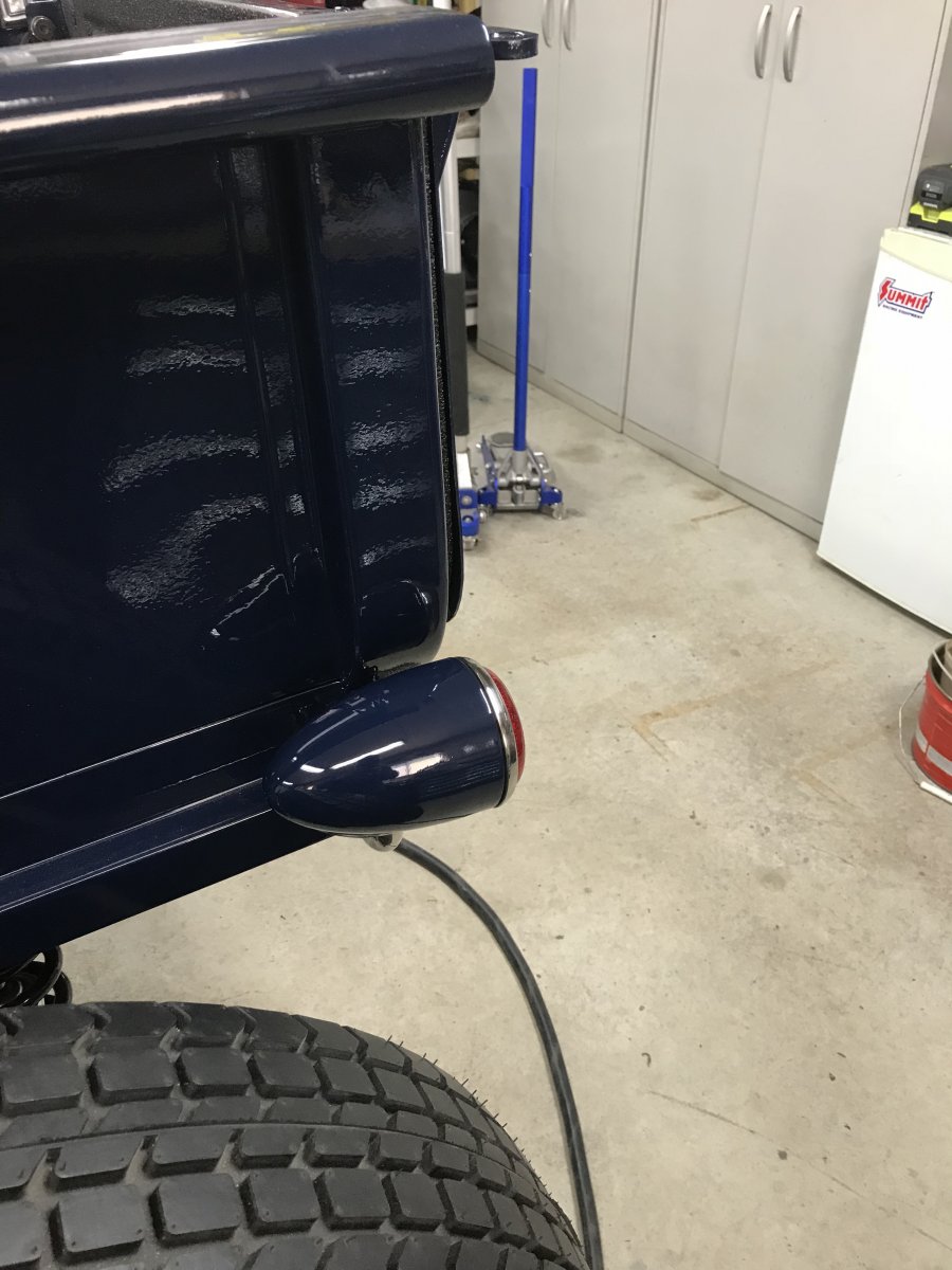

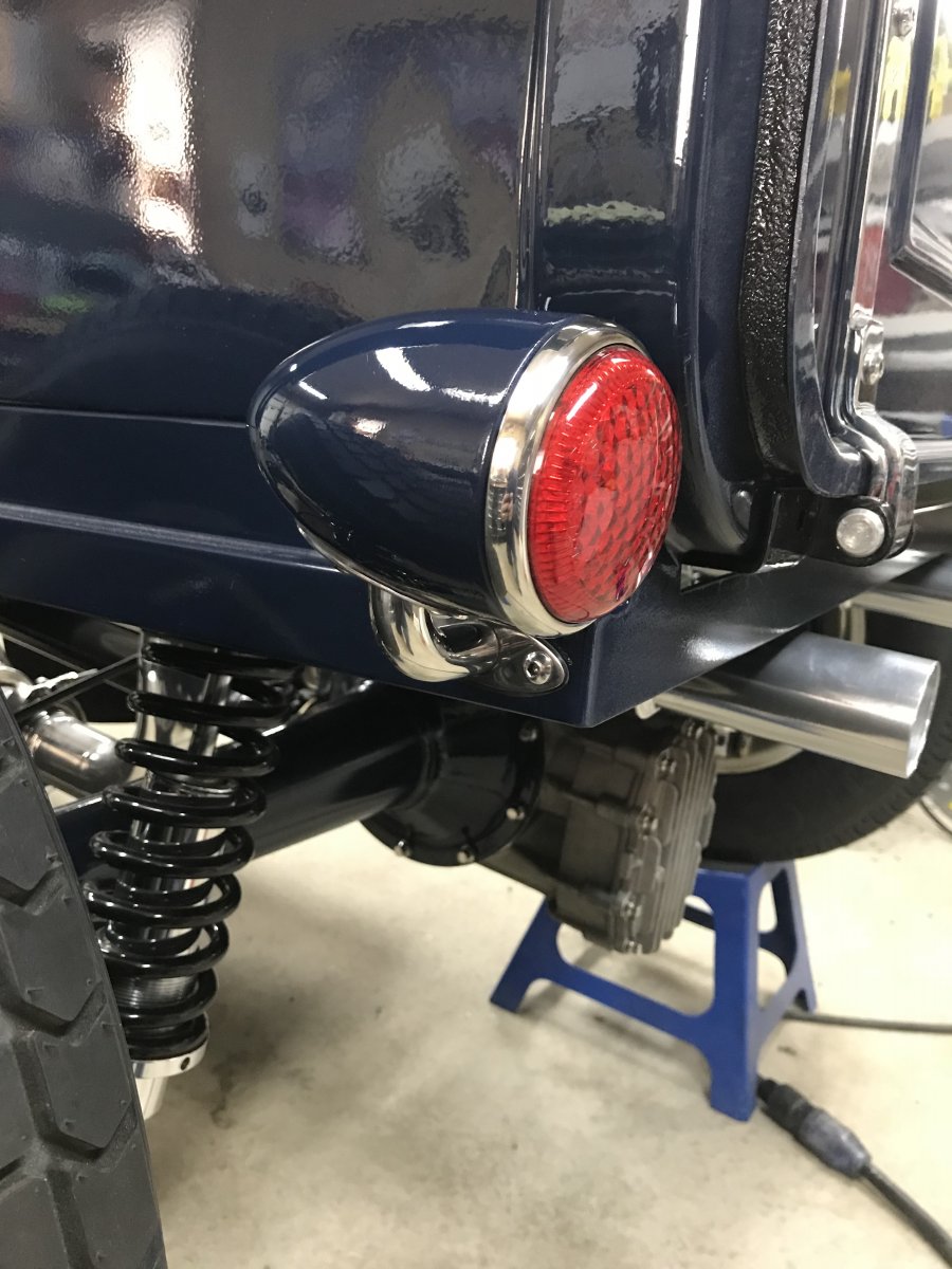

    Tail lights mounted :cool:

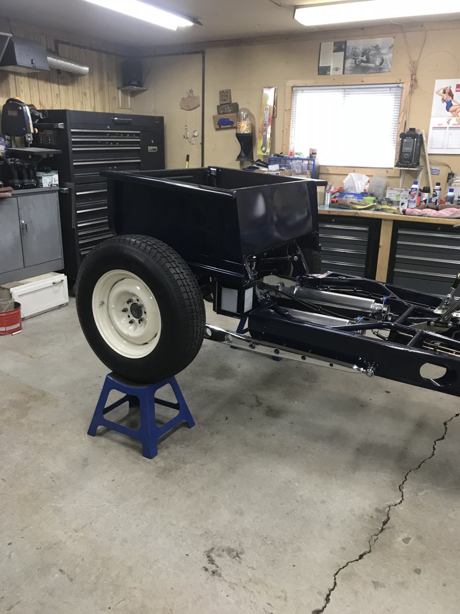

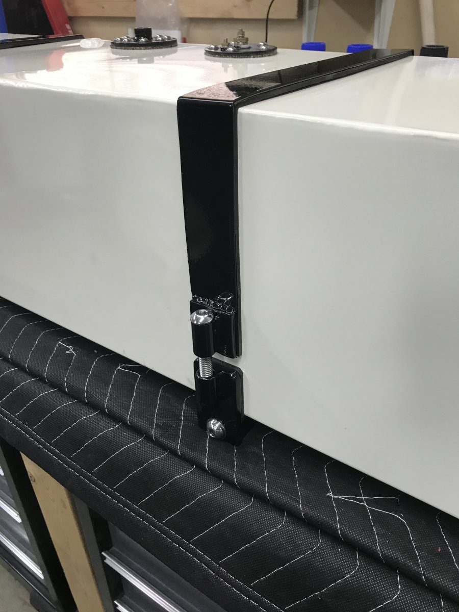

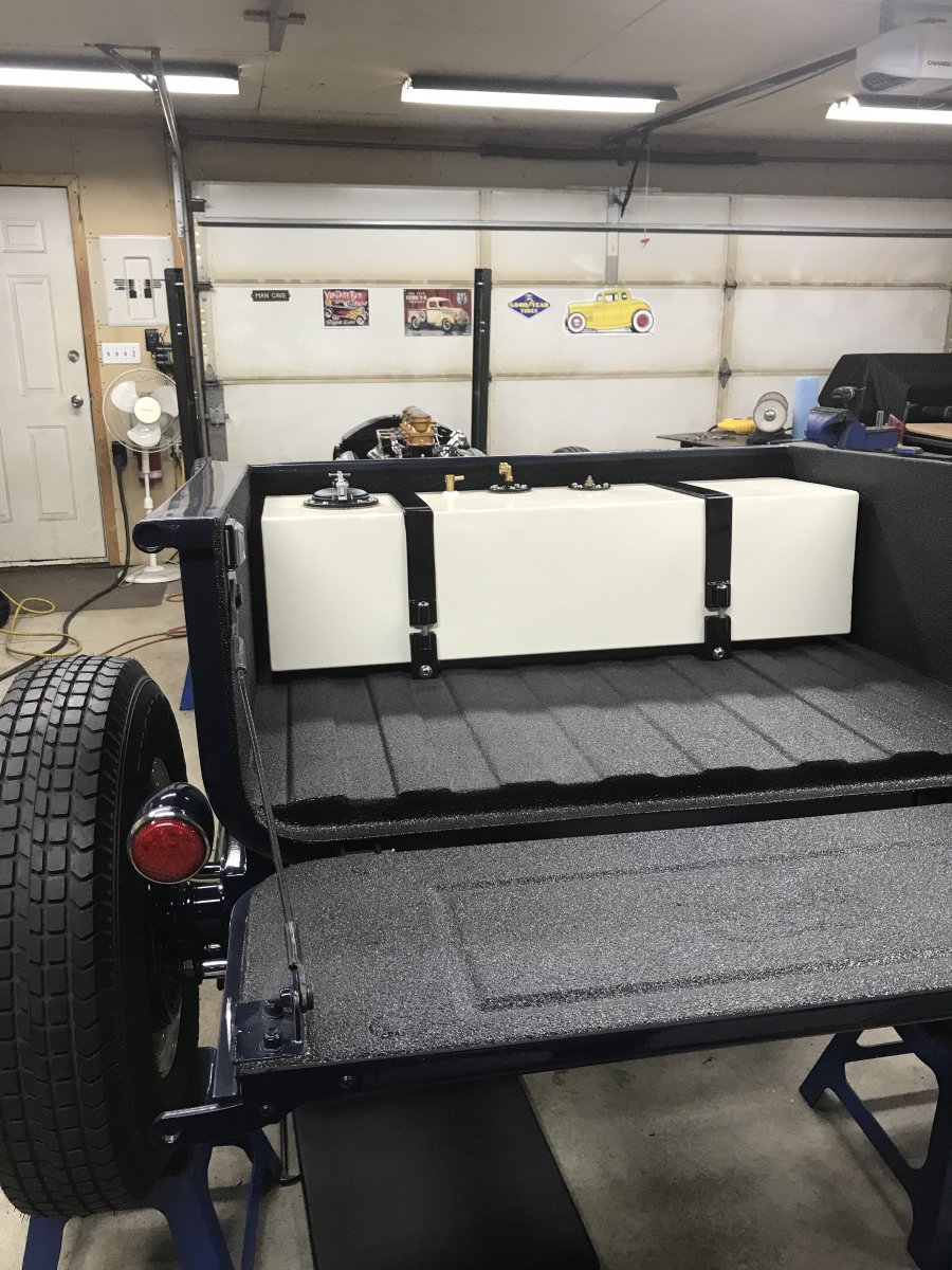

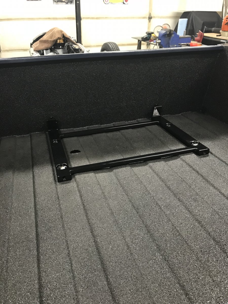

    I got my parts back from the powder coating shop and started getting my gas tank ready to mount.
    I had modified the way it was bolted into the bed and changed the strap securing method to the 3” stainless bolts from the top down to secure the tank.
    Better than my previous design so with the welding came the need for redoing the powder coating.
    The tank is cradled sitting on 1/8” thick rubber secured to the cradle with contact cement and the straps are also lined with 1/8” rubber.
    So the tank is completely secured with rubber all around and the cradle is bolted from underneath with 4 — 1/2” bolts.
    I just have to install the fuel line and then I can bolt it in place for the final time .:cool:

    How it looks sitting in place.
