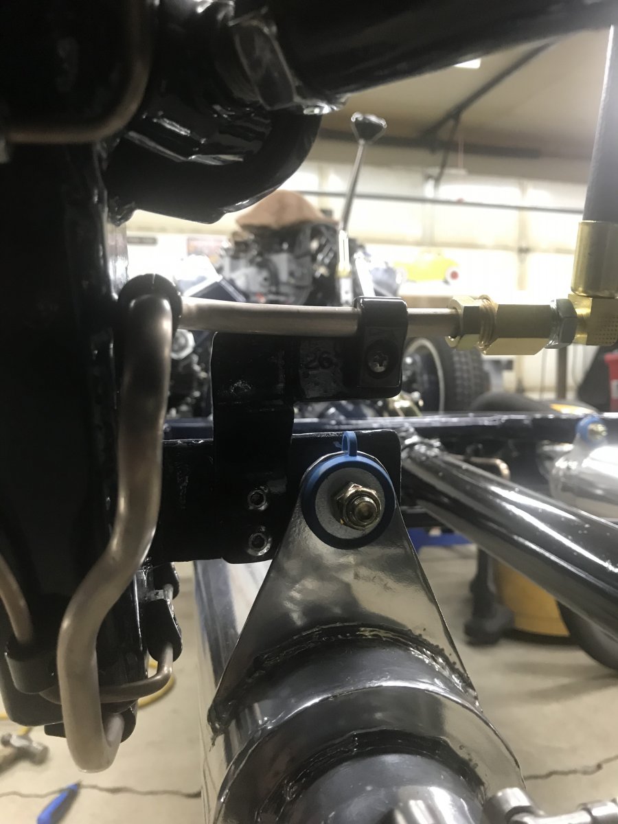

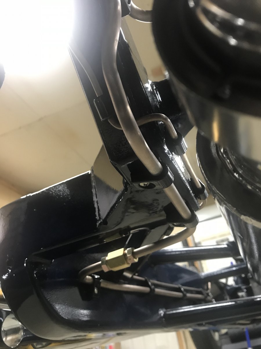

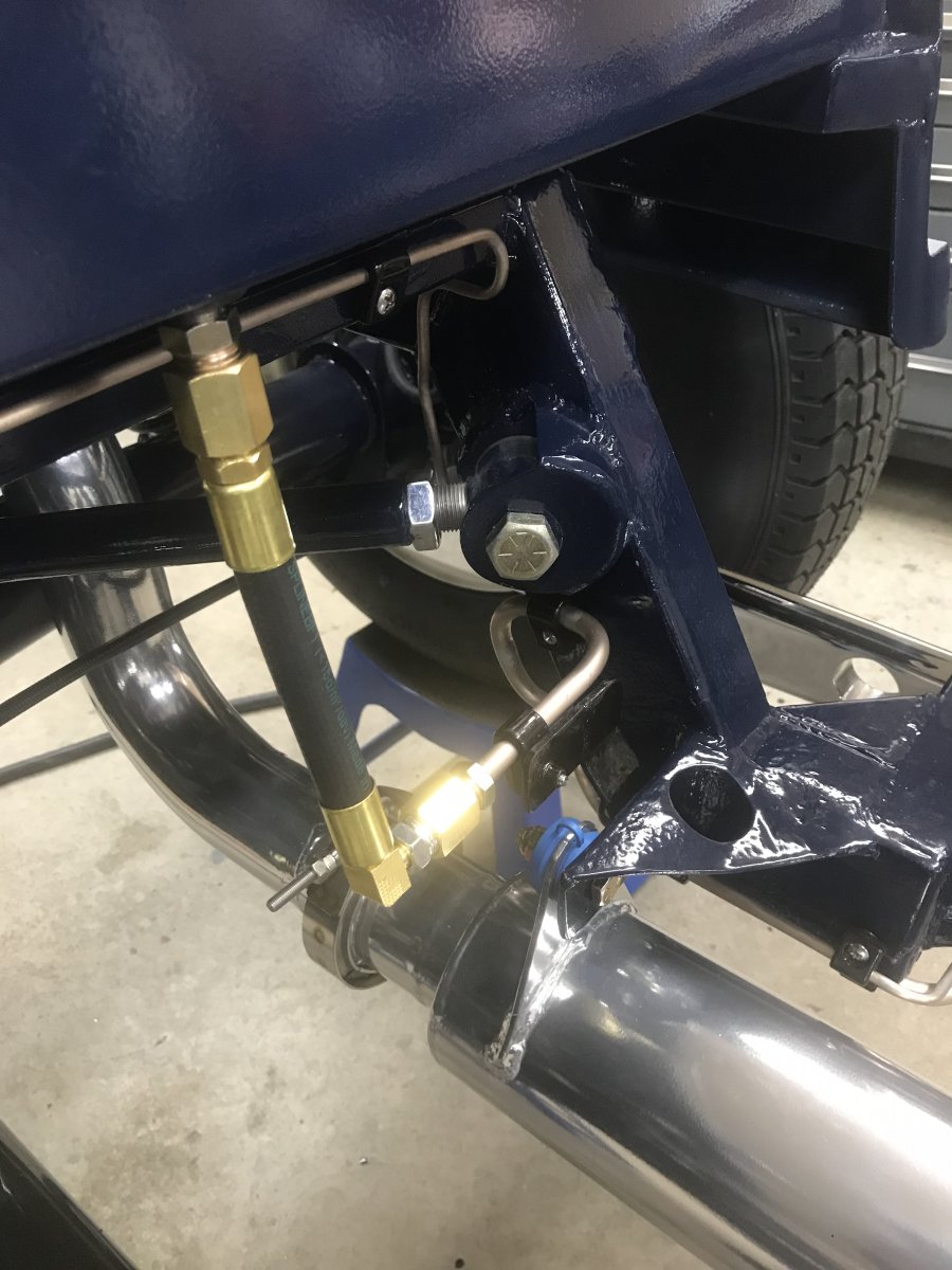

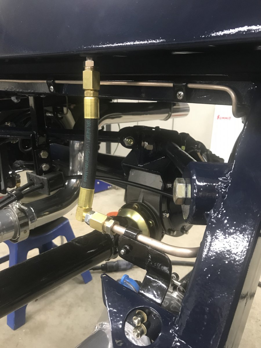

    Today’s project was to get the tank connected to the fuel line that I had previously installed on the frame.
    It involved some more creative tube bending and mounting using more of the Made for you t clamps.
    Like the rest of the fuel line it’s all 3/8” inverted flare ni cop line and fittings.
    The line off the tank comes through a rubber grommet in the bottom of the bed and from there it’s connected to the frame line with a small hose about 5” long with fittings like I used up front no hose clamps at all.
    I just have to get it crimped at the hose shop.
    So, now the fuel system is fully plumbed from tank to carbs :cool:

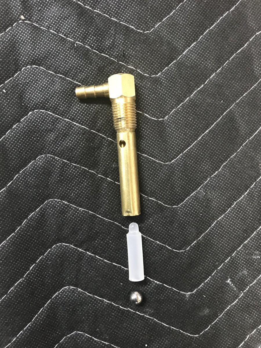

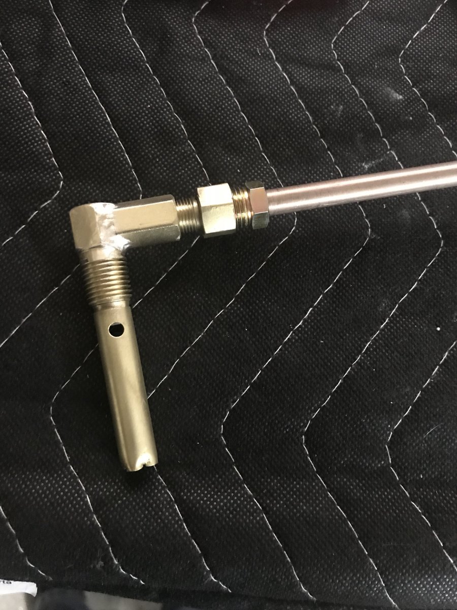

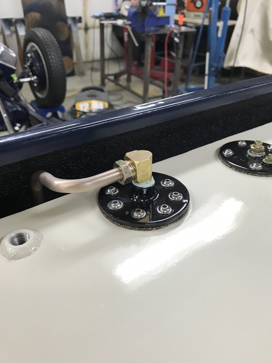

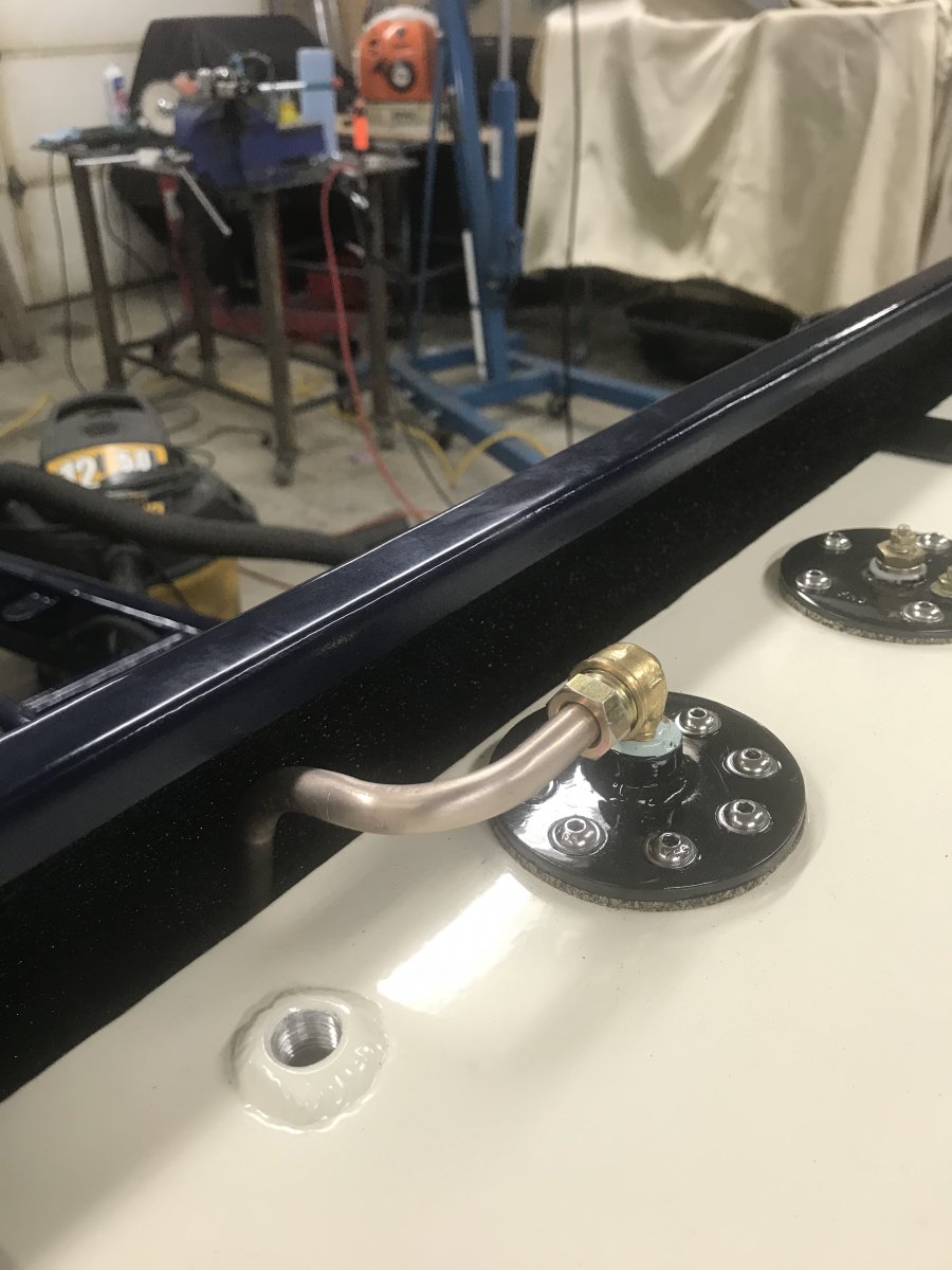

    I didn’t really like the fitting I had used on top of the tank so I found another one and changed it out.
    Then I decided that I didn’t want to use the hose barb on my rollover vent.
    I picked up a br*** 1/8 NPT coupler and took the valve apart for silver brazing.
    Now I can plumb the vent with hard line. :cool:

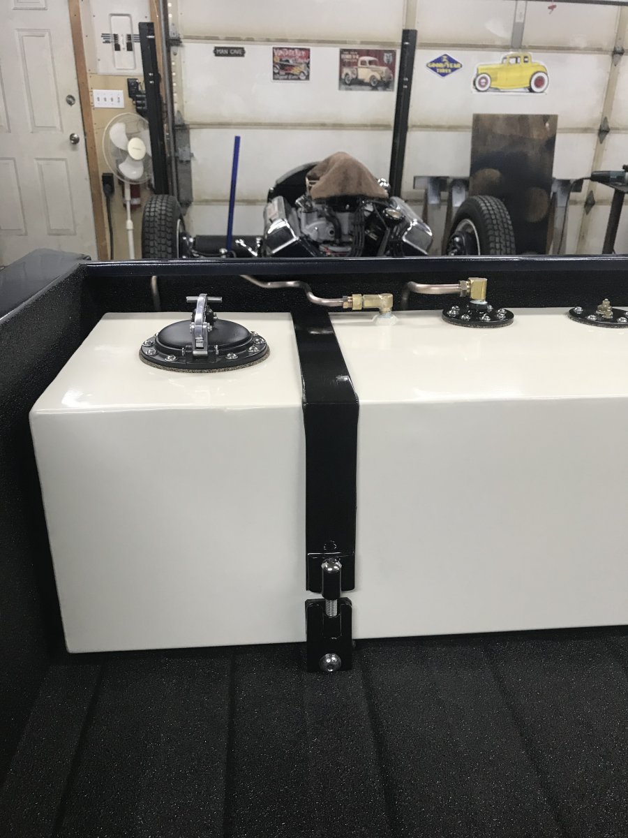

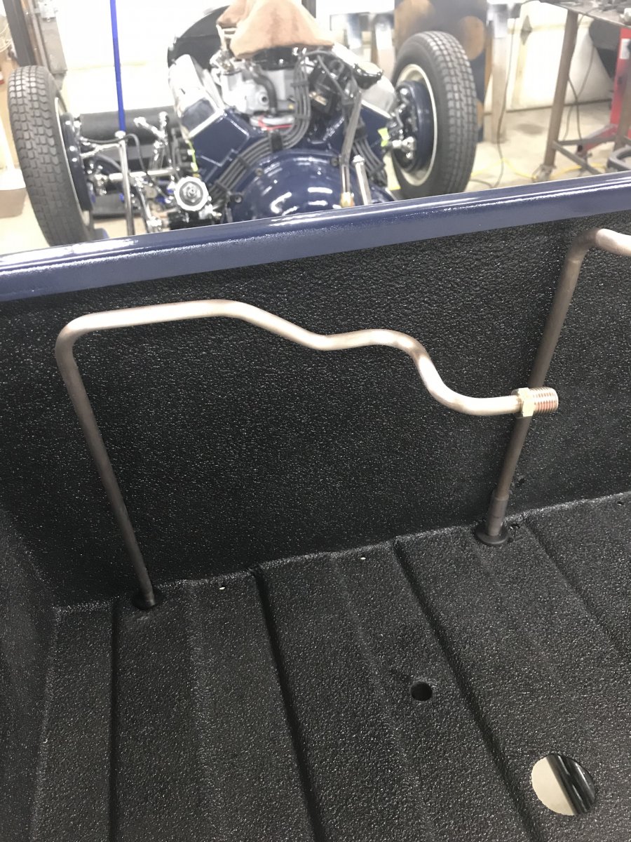

    And now the vent is finished and the tank is bolted in for the final time.
    Ready for fuel when the time comes. :cool:
    As you can see I made the vent line go up as much as I could and then down thru the bed.

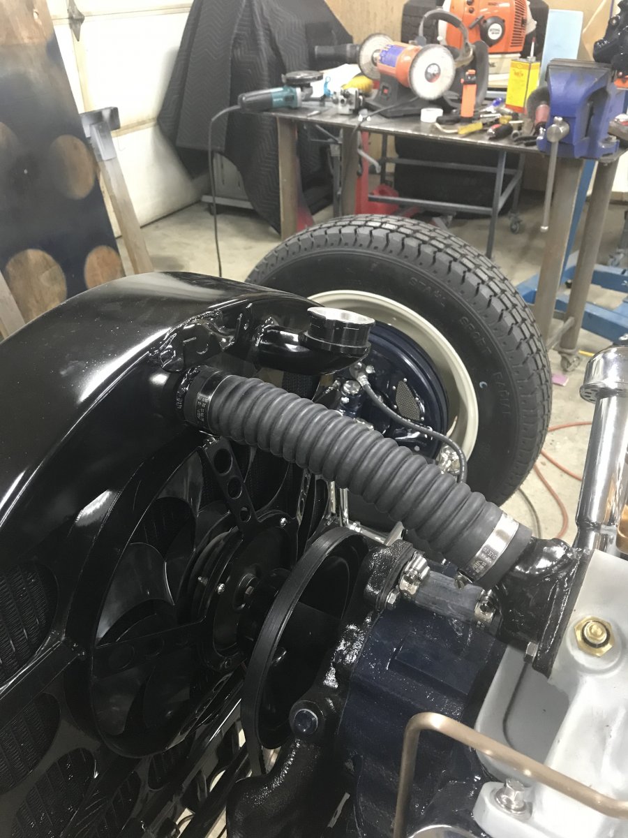

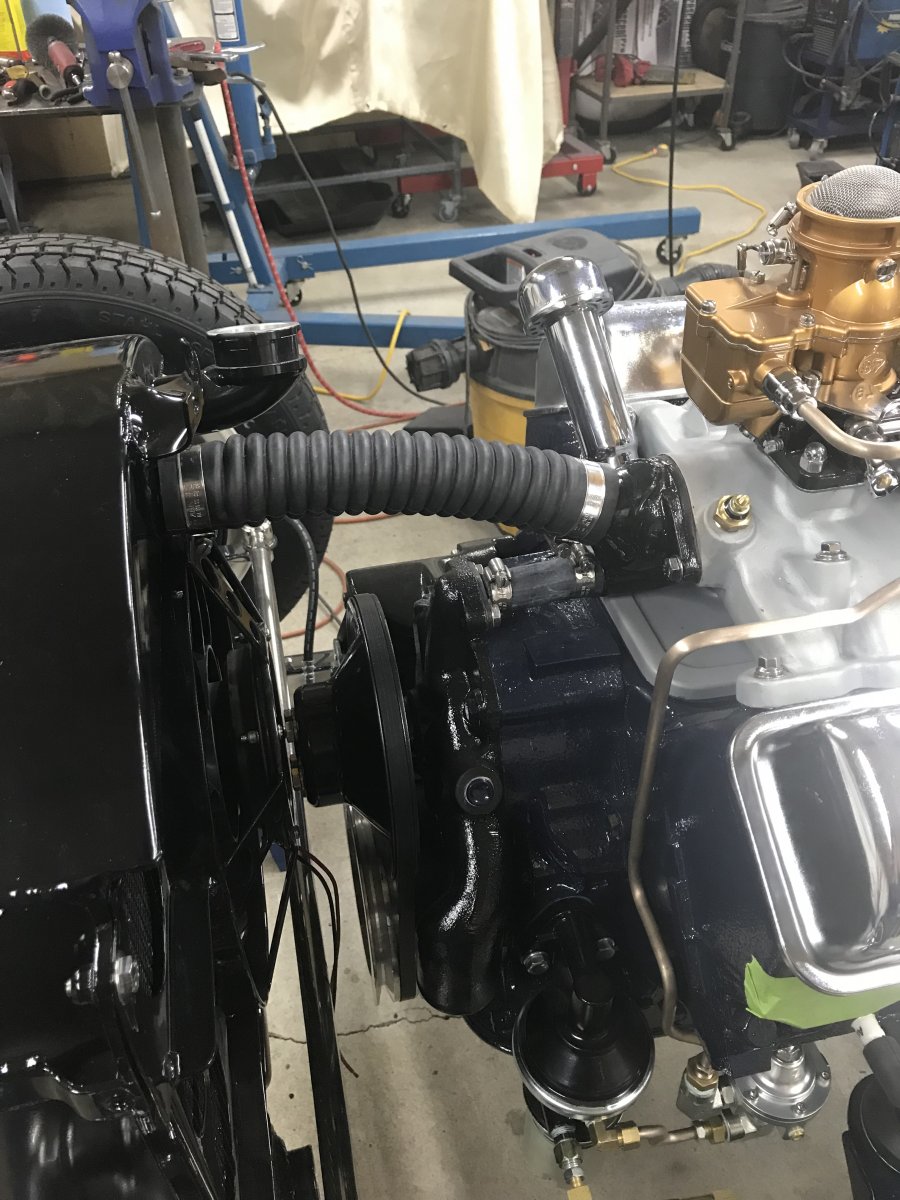

    Since I modified my thermostat outlet for my top rad hose it made the radiator hose adventure a little bit easier.
    The bottom hose will be a different matter with the radiator outlet being 1 3/4” and the water pump being 2”.
    Being old enough to remember walking into the local repair shop garage or parts store with hose shape mocked up and in hand and being able to browse through hundreds of molded hoses looking for something that would work,
    I thought I’d try it again :D
    Good luck :rolleyes: nobody has a lot of hose stock anymore and if they do, it’s way back where customers will be shot if they attempt to get there :D
    So after that frustrating experience , at the suggestion from my buddy I started looking at the listings for flexible hoses.
    I’ve always liked them despite the other old thread on here where some guys posted their disdain, opinions and other ********.
    Fact is that a lot of hot rodders over the years have used them and I know that from personal experience as well.
    There are times when a molded hose can be found and works good.
    Otherwise a flexible hose is the answer.
    I started looking at what Dayco offers for flexible hoses and found a perfect one for the top hose.
    The bottom one remains to be seen when my parts gal gets it in.
    If that doesn’t work I’ll move to plan B for the lower hose.
    Oh by the way I only use high quality stainless gear clamp hose clamps, they don’t have the usual perforations that can cut the hose.
    205AA93E-8D05-4F67-8A1A-98C94F528FFA.gif 777E00D1-C450-46BC-A1E1-69EFE0376D63.jpeg E82A750F-4A62-4BA3-840A-0A1615ABE8EE.jpeg

    Man that ****s Larry where did you go? The NAPA out here in St Albert let me go into the back and check what they had, wasn't a ton (50 or 60 hoses maybe), but I found a bottom hose that I could cut down and ended up being perfect and then I had them look through a catalogue that gave pretty good dimensions and pictures for my upper hose and they ordered it in for me and a couple of cuts latter I had a perfect upper hose as well.

    I tried bumper to bumper, they let me in back to see what they had, 15 hoses.
    Then I tried Napa same thing, limited stock.
    So I tried Part source and Canadian tire their first question was year and make of the vehicle :rolleyes: :D
    It’s not like it was when I was growing up anymore and another thing is that even when they have hoses a lot of them are smaller diameter or metric, stuff that doesn’t fit our old stuff.
    You were lucky, I’m quite happy to use the flex hose.
    loudbang and Stogy like this.

    Your's works well with the flex hose as you have a pretty straight shot. Mine both had sharp 90 degree bends so flex hose wasn't an option. I don't mind the look at all.

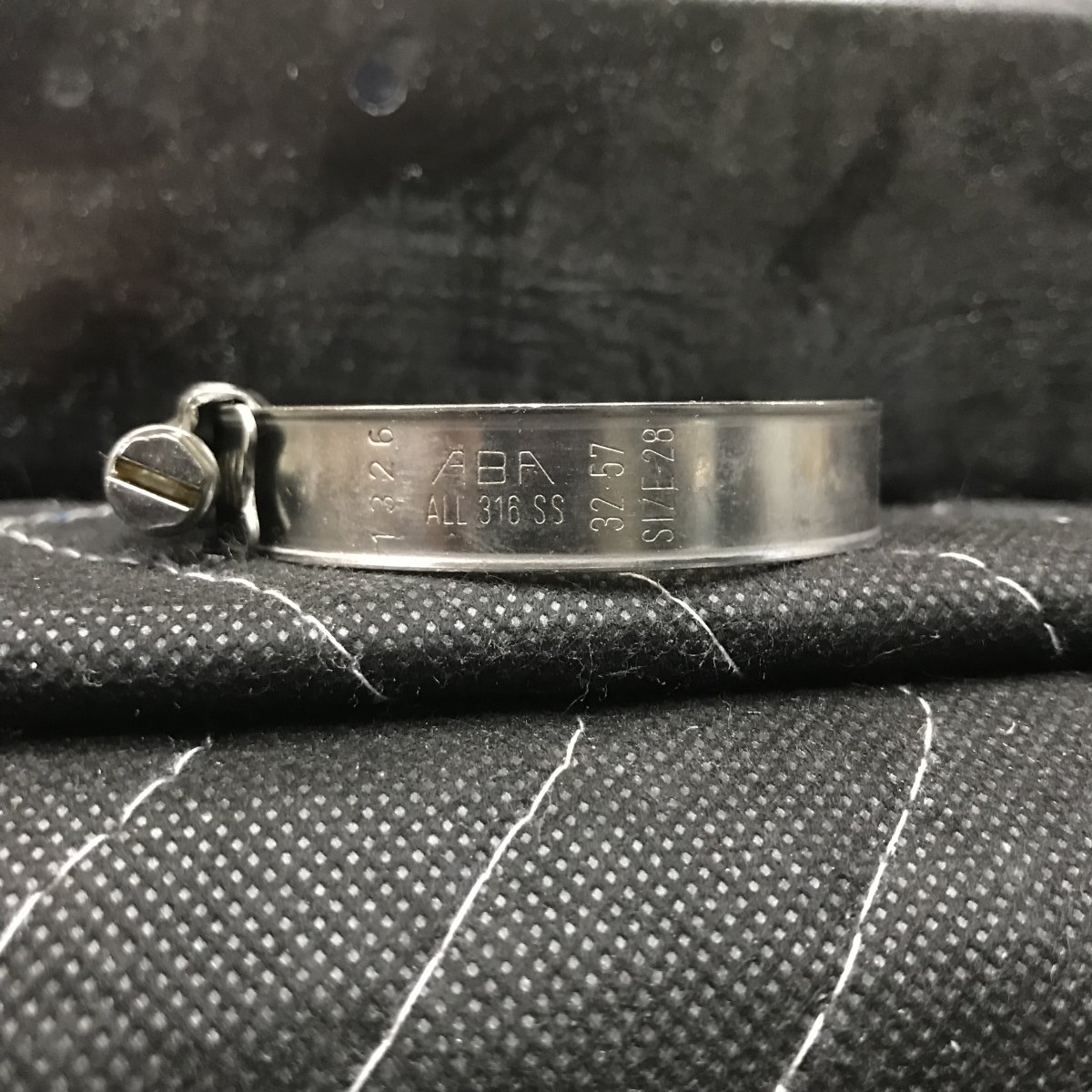

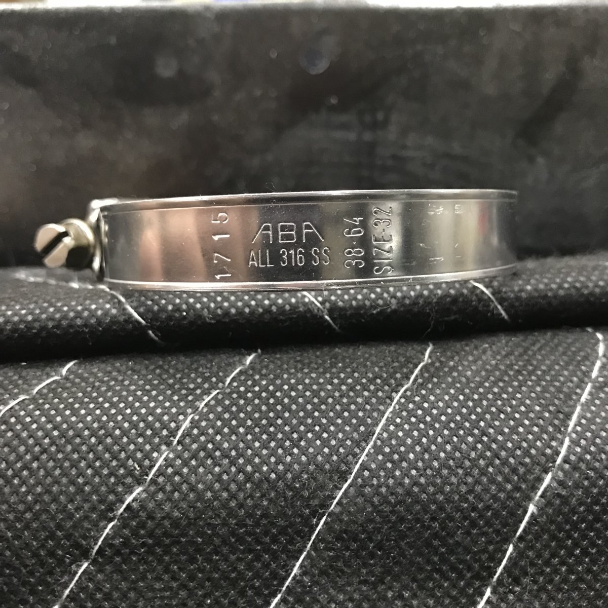

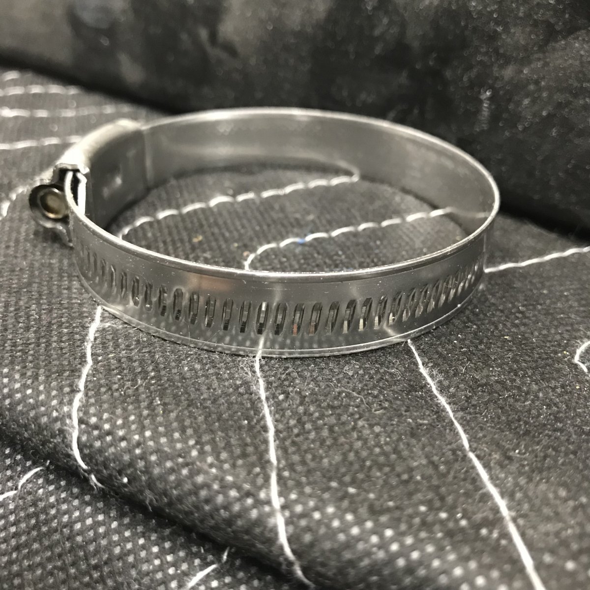

    Who makes the hose clamps that you use?
    Stogy likes this.
  19. Blue One
    Joined: Feb 6, 2010
    Posts: 11,518
    Blue One
    from Alberta
    A Swedish company
    http://www.normaamericasds.com/brand/aba
    I buy them locally here at Greenline hose, but they sell them on Amazon and that auction place.
    Any industrial hose supplier should have them.
    0BA8B9F1-CE53-4269-9DD2-DB170525DC7F.jpeg B54149D7-1816-4649-B673-BB76A0CF453B.jpeg B20AE97A-53FD-4B86-8819-FC3001040F8F.jpeg

    Those are some nice looking clamps. I agree about the holes.

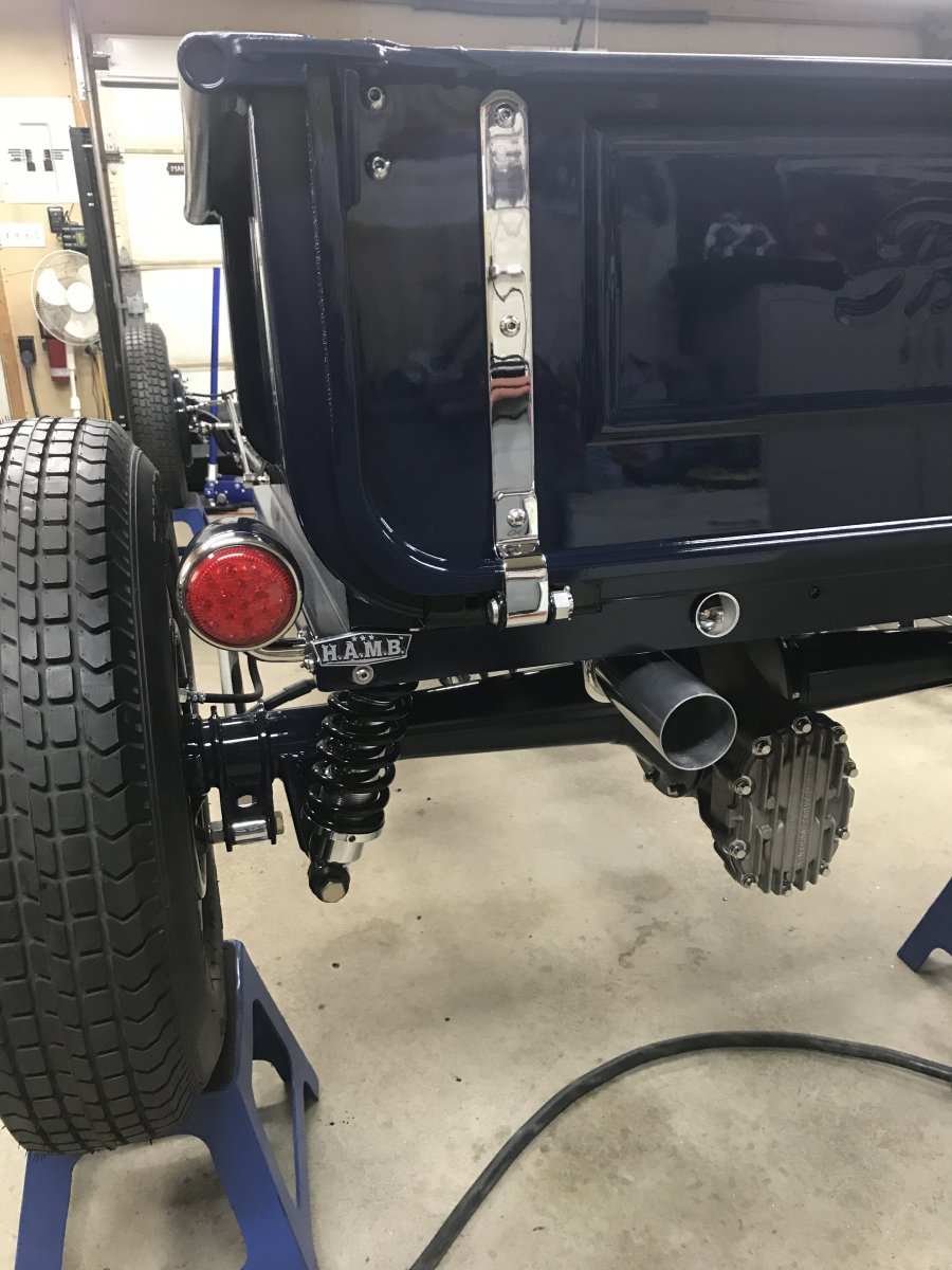

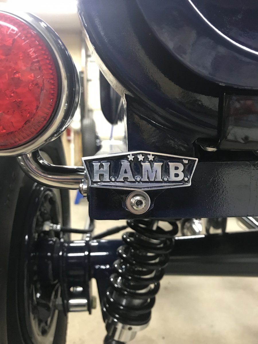

    So, yesterday I mixed up a tiny bit of blue paint to do some touch ups under the car.
    While I was at it I used a little to detail one of my HAMB tag toppers.
    I installed the threaded inserts and installed license plate lights.
    There’s no room above the plate for a light and once I installed one off to the side, I realized that for balance I needed one for the other side.
    I polished up the tag topper and because it wasn’t going to be possible to mount it on top of the plate I picked a spot on the drivers side lower corner of the bed. :cool:
    Larry

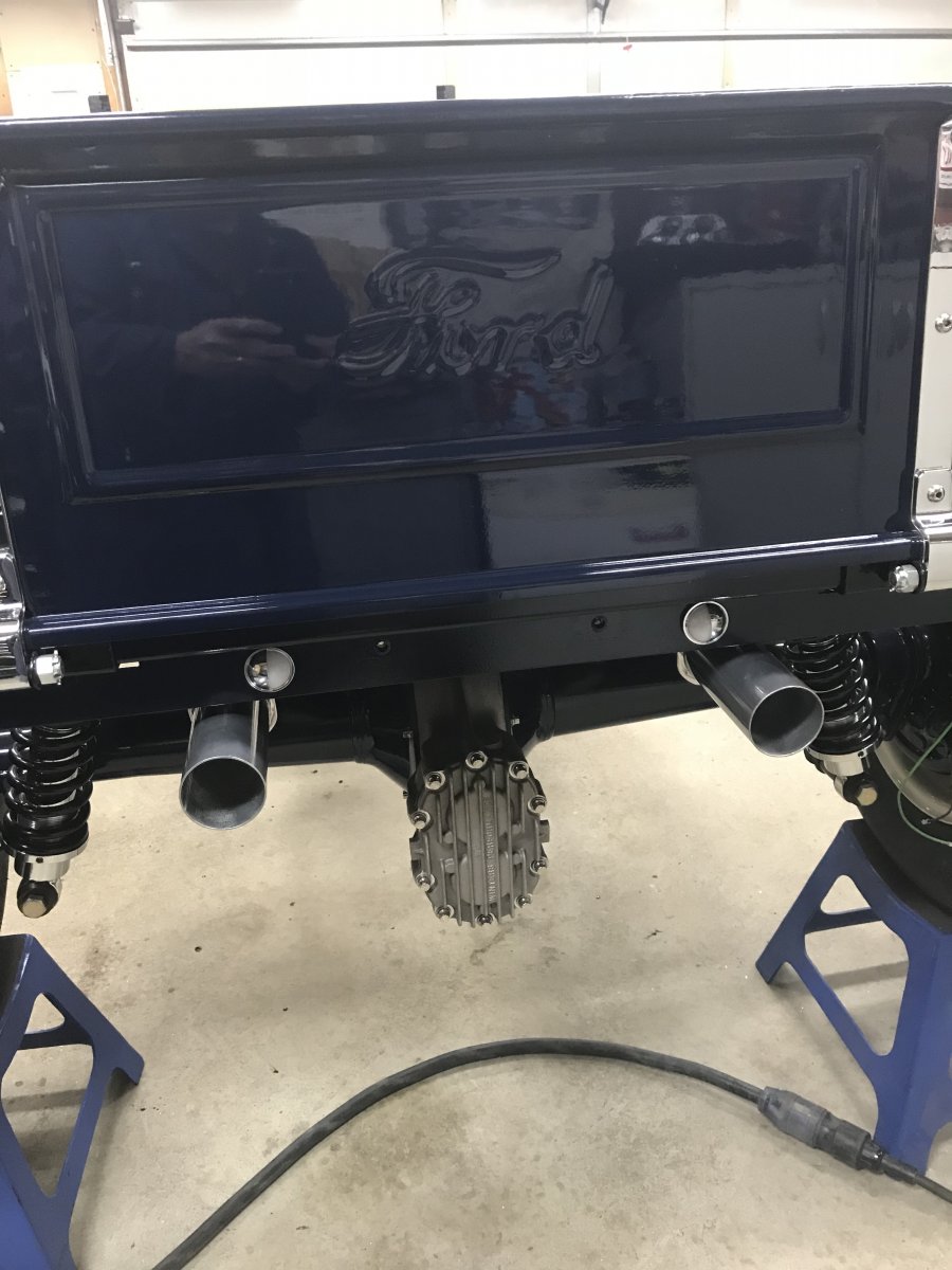

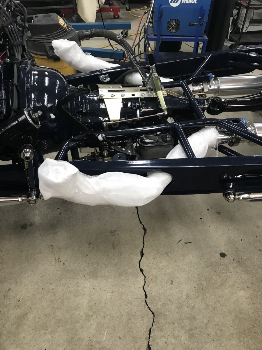

    Front portion of the exhaust system in place, we’re getting really close to installing the body :cool:
