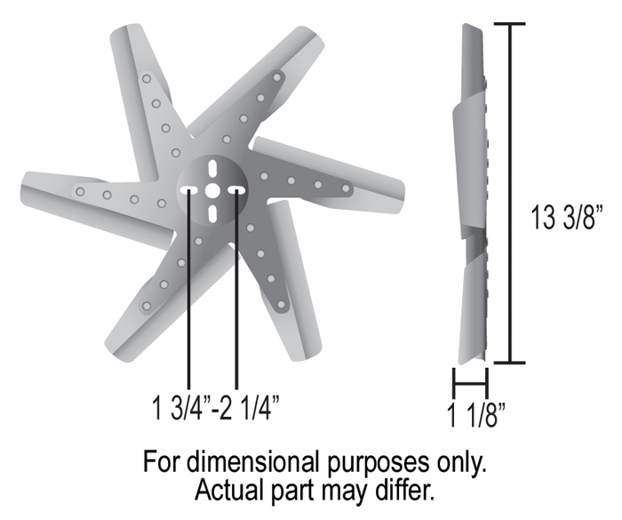

    Not to be picky but. The mechanical fan fits the build way better than the electric unit but that flex fan just doesn't look right for the style of your truck. Isn't there a steel fan that fits the style of a fiftys build? Just my humble opinion, don't take it the wrong way. It's all in the small details.
  6. Blue One
    Joined: Feb 6, 2010
    Posts: 11,512
    Blue One
    from Alberta
    Unfortunately not, that fan is the smallest and thinnest mechanical fan I could find.
    In all honesty it’s the only way I was able to fit a mechanical fan at all.
    I think that once I’ve got the shroud built it will
    be less obvious.
    I think it’s going to work well.
    https://derale.com/products/belt-dr...2-electric-rad-fan-aluminum-shroud-kit-detail
    Description
    Rated for engine speeds up to 8,000 rpm, this high performance 13" standard rotation flex fan includes 6 stainless steel blades and a black powder coated hub. A very good choice for applications with limited space between the radiator and water pump.

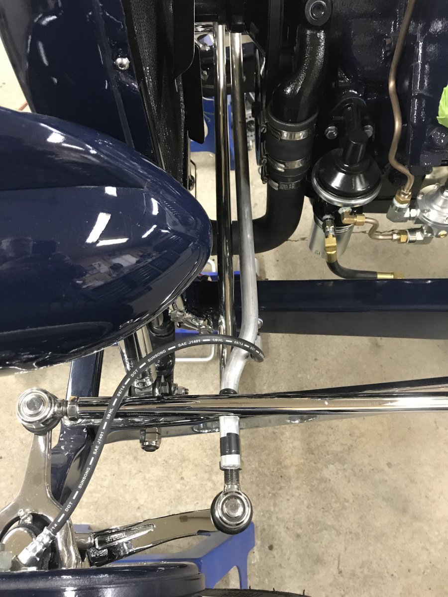

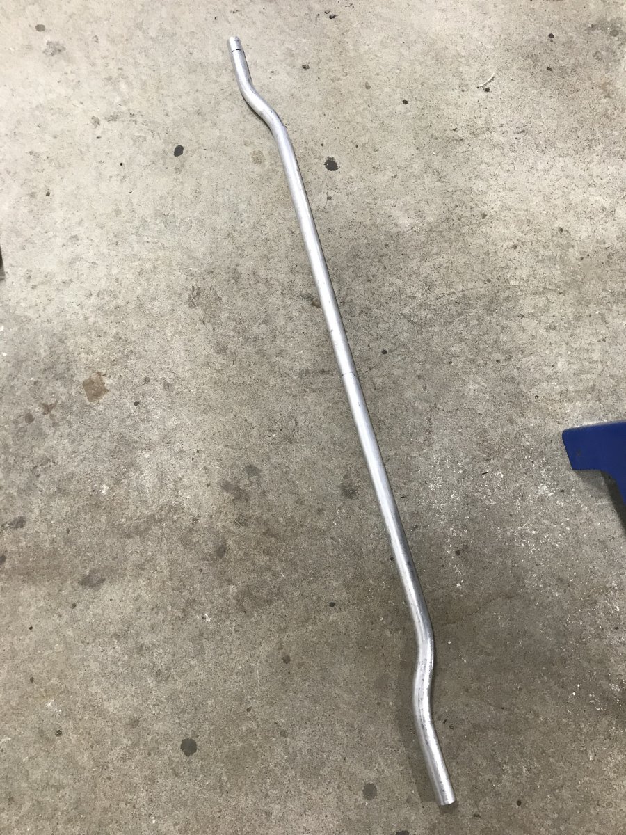

  7. Blue One
    Joined: Feb 6, 2010
    Posts: 11,512
    Blue One
    from Alberta
    Today I spent a little time with my JD2 tubing bender and used some 1/2” aluminum conduit to determine a pattern for my offset tie rod.
    Some nicely placed 30 degree bends worked out perfectly.
    Once I get the double adjusters for the ends and my new tie rod ends I can bend my new tie rod using the 7/8” x .156 Stainless tubing I got.
    Then I’ll get to the fan shroud.:cool:
    9E7B6A6D-7585-4EF3-93FC-77B19BA84C18.jpeg 690C8E18-3965-4A1E-86E1-F3B734957F8A.jpeg 8DC42E78-397A-4FF9-AC90-C7829F4A7D12.jpeg 8ADD1CBF-0E5F-4A81-A0A4-945F72D38699.jpeg 1E602C60-3B13-431B-9206-5EEC72DCE8EB.jpeg
    Inked Monkey, brEad, Stogy and 3 others like this.

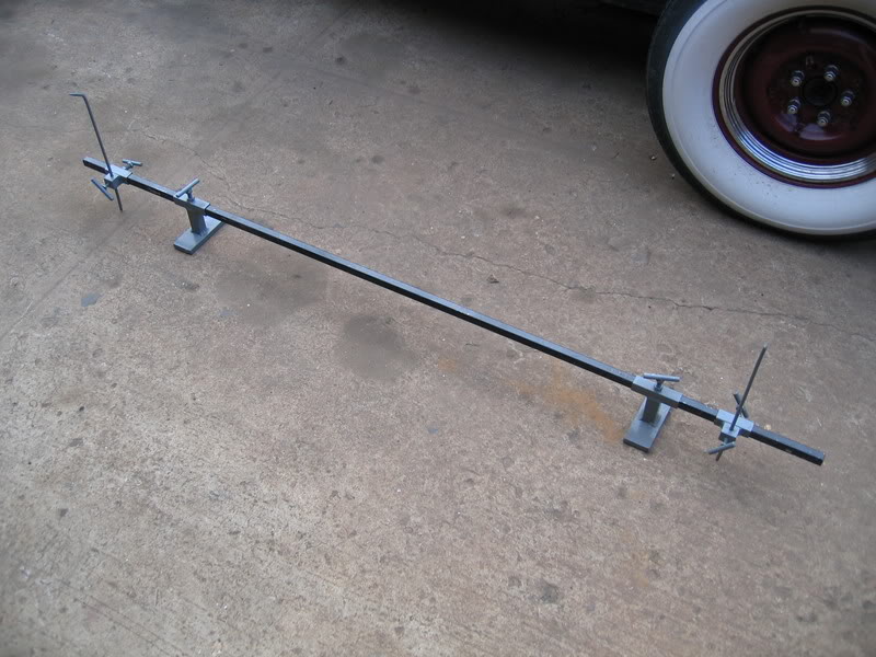

  9. Blue One
    Joined: Feb 6, 2010
    Posts: 11,512
    Blue One
    from Alberta

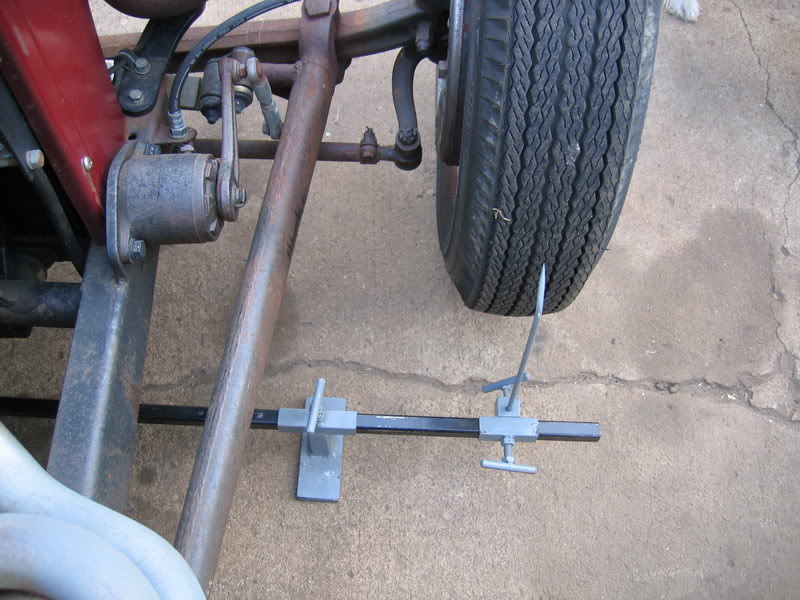

    While I’m waiting for the double adjusters to come I’m going to build a front end alignment toe in gauge this week.
    Then I will set the car down on the floor and set the toe in when the tie rod is all done.
    84F51326-9127-4EEA-AA11-9C5E0AE752BB.jpeg 709F9146-8122-495D-9A5D-C4A9490964D5.jpeg
    Stogy, Tim and loudbang like this.
  10. 26 T Ford RPU
    Joined: Jun 9, 2012
    Posts: 12,595
    26 T Ford RPU
    It will work well but the offset will cause it to pivot on the tie rod ends and hang down lower toward the ch***is rails. JW
    loudbang and Blue One like this.
  11. Blue One
    Joined: Feb 6, 2010
    Posts: 11,512
    Blue One
    from Alberta
    I don’t think it will hang down that much really.
    I guess we’ll see but I think it’s going to work well.
    I can adjust to compensate for it I think.
  12. Tim
    Joined: Mar 2, 2001
    Posts: 20,343
    Tim
    from KCMO
    That stuff moves a lot less than people think it does. How many fords came with bent up drag links? Lots of them. How many shoe box fords with a sbc have a Z shaped tie rod? Almost all of them.
    We aren’t going rock crawling with these things lol. They’re about one step above bolting it solid with a rubber cushion between pieces
    brad2v, loudbang and Blue One like this.

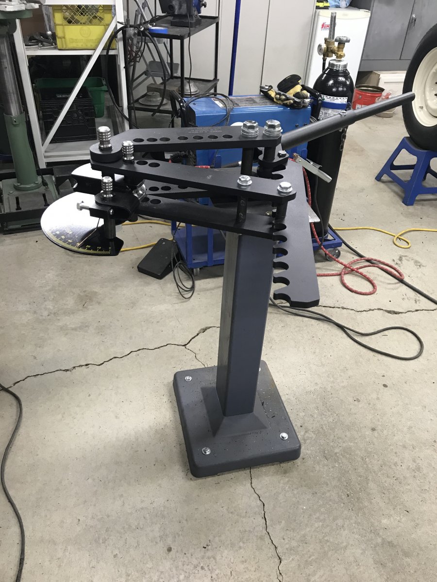

  13. If you dont mind me asking, how do you like your tube bender? You made some clean bends on your new tie rod. Thanks, ty
  14. Blue One
    Joined: Feb 6, 2010
    Posts: 11,512
    Blue One
    from Alberta
    No problem, that JD2 model 3 bender is a really nice piece of equipment.
    Easy to use and the dies are machined perfectly.
    It’s not cheap but well worth it.
    Those bends are only in the aluminum conduit so far for testing but the actual tie rod tubing will bend as nicely or better.

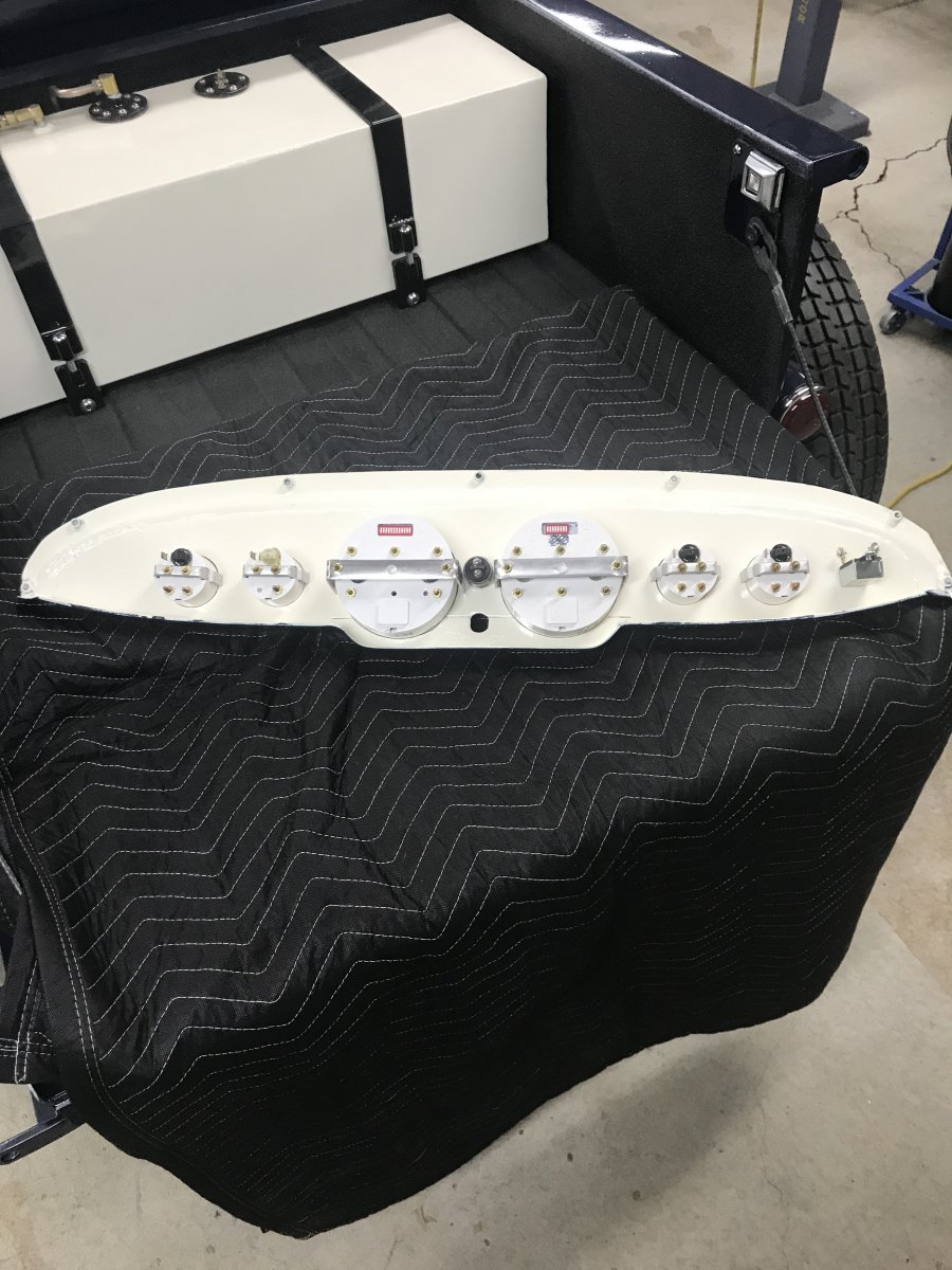

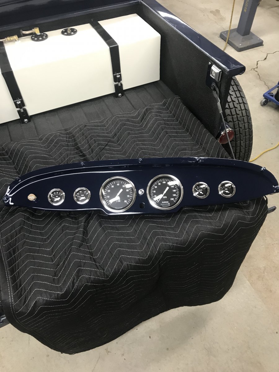

    So while I’m waiting for some parts to carry on I decided to get to my dash and install the Cl***ic Instruments gauges to get ready for wiring.
    The push ****on you see between the speedometer and tachometer is an old push ****on momentary switch that I grabbed from an old Lincoln portable welding machine that was being s****ped.
    The machine was built way back in the early days of Lincoln welding machine manufacturing, heck it might even be as old as my T.
    It once spun the welders starter and now it’s my horn ****on. :cool:

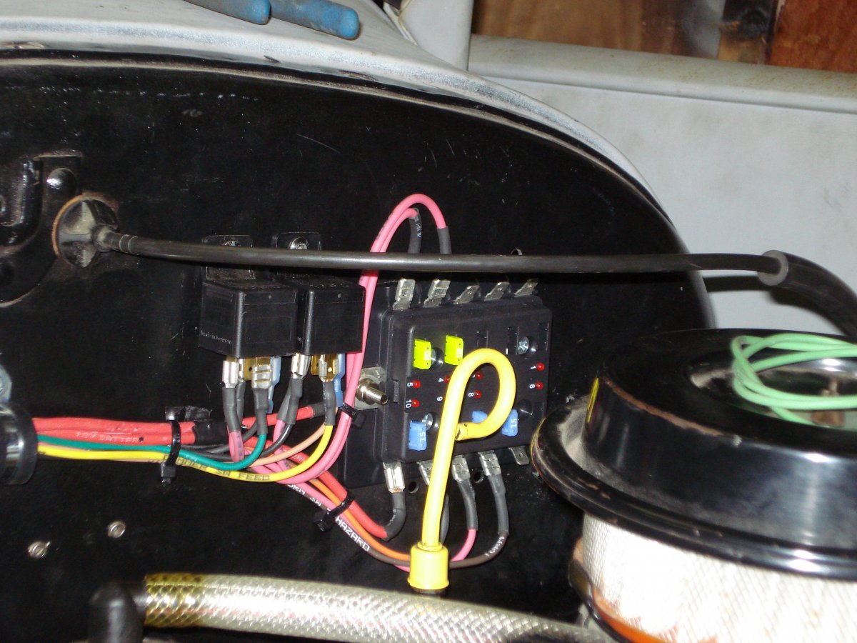

  18. trollst
    Joined: Jan 27, 2012
    Posts: 2,104
    trollst
    You'll want to add a relay to that headlite switch, or you'll burn it up quick. They're cool little switches, but they don't like to have any amperage going through them. Just a thought.
    LeRoy.
    26 T Ford RPU likes this.

  27. trollst
    Posts: 2,104
    trollst
    I have the same switch in my T, I installed a relay after wrapping my hand around a very warm (but not hot) switch, now the switch is cold as ice, and yes, the lights are brighter, as they take power directly from the battery. No matter, I'm not a fan of night driving, too many deer around here, even in town. Get that wreck on the road man, its almost february.
  28. RICH B
    Joined: Feb 7, 2007
    Posts: 5,963
    RICH B
    Not to distract from Blue's thread; but while I understand the circuitry; I was wondering how you laid out your components and sourced your power.
  29. trollst
    Posts: 2,104
    trollst
    Power for the switch comes right off the fuse box 2 feet away, 12 gauge wire feeding it, 12 gauge to the dimmer 1 foot away, before adding the relay. I know what I'm doing when it comes to wiring. DSC05738.JPG DSC05739.JPG
  30. Blue One
    Joined: Feb 6, 2010
    Posts: 11,512
    Blue One
    from Alberta
    I've said it before, while that is a very functional looking wiring job it would not be appropriate for an exposed firewall hoodless car like mine.
