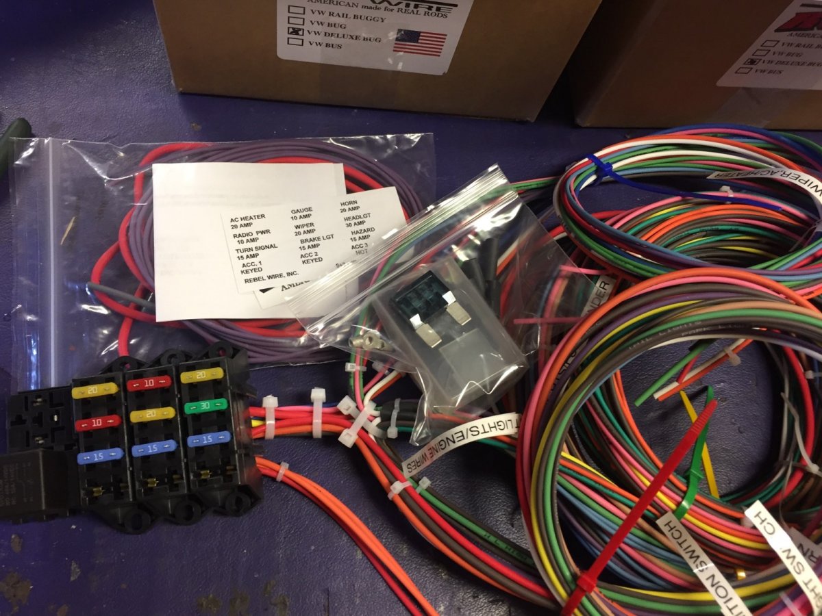

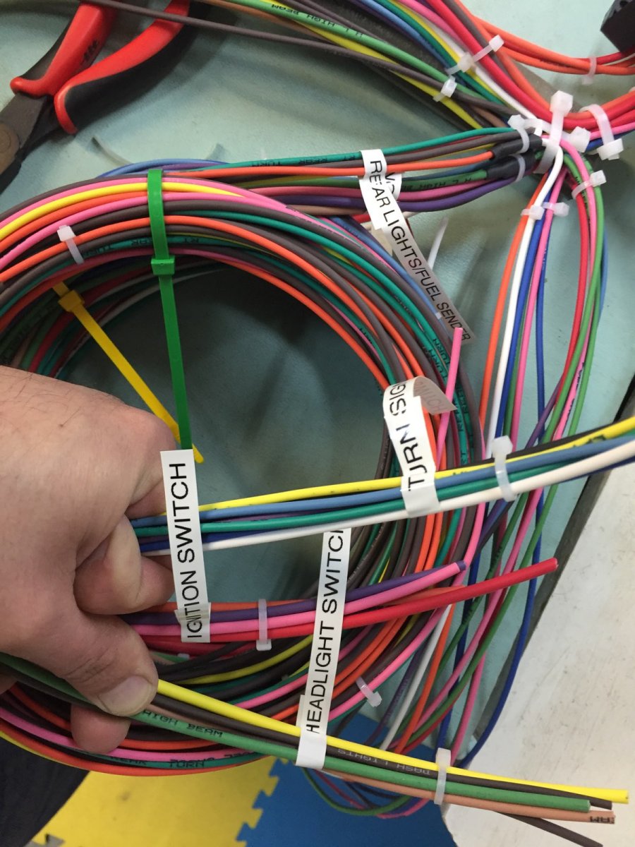

    This build has been and continues to be a learning experience and changes have been made mostly for the better :D
    The wiring harness is no different so it seems :D

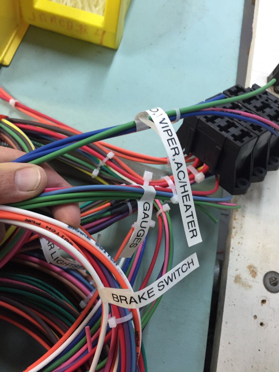

    After getting the American Autowire Hiway 15 wiring kit I realized that it is way more kit than I need for my RPU.
    So back it went to Summit.
    Then I contacted Jeremy at Rebel Wire and after some discussion involving all of my components he came up with a modified 9+3 kit for my RPU.
    A great guy and I’ll be getting my kit very soon.
    Then I’ll be able to get this thing electrified. :D
    He added some things and deleted others and modified systems to what I needed for the components I’m using and added some extra labeling to the wire bundles for me.
    Here’s what he came up with based on my components. :cool:
    -9+3 setup for a keyed hot 3 pin flasher
    -longer brake switch wires
    -extra long neutral safety switch wire, 10ft
    -no turn indicator wires in the dash section
    -single turn indicator wire in the switch bundle for the Pilot wire on the switch
    -60 amp maxi fuse with holder and cover with 10ga terminals
    -high and low beam wires bundled into headlight switch bundle, no dimmer switch wire
    -extra labeling tagged on switch bundles

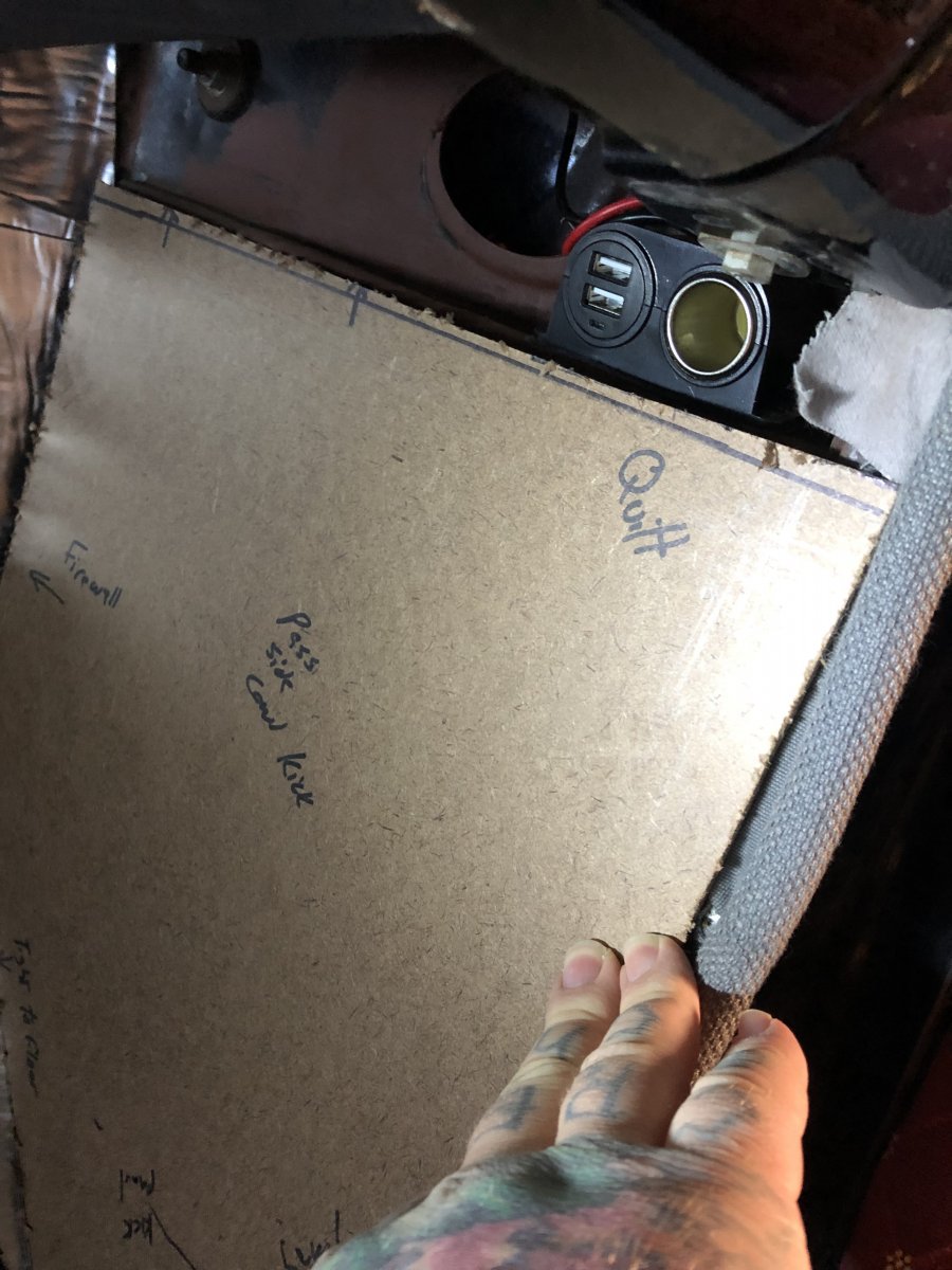

    I’m thinking about finding a combination sort of thing with a lighter socket and a couple of USB ports if I can. And then find a good place to hide them where they can still be used :)
  13. atch
    Joined: Sep 3, 2002
    Posts: 6,415
    atch
    I don't know where he's getting them, but Ryno (on here) is putting some of those in Clarence this winter. I'm sure he's got it totally scoped out and can tell you the best source.
    Blue One and loudbang like this.
  14. 26 T Ford RPU
    Joined: Jun 9, 2012
    Posts: 12,598
    26 T Ford RPU
    I put mine in the front of my seat riser of which you don't have, but you will sort that. I just use a USB adapter if needed. JW
    loudbang, Blue One and bobbytnm like this.

    0E822FF9-F57F-4E31-81CE-D281626174B1.jpeg Tucked this one under the dash above the kick panel. Easy to find online, this one is pretty weather tight outside of no caps. I was seeing them used on boats and off road trucks so I figured it was worth a go.
    The only thing I’d add is that when I was looking up how to wire and properly fuse it it seems the chargers take barely any amps but a lighter take almost 10x so you might want to ask more about that combo.
    I will add that it was actually kind of hard to find decent information even though it’s an extremely common part. Maybe I call it something odd and it made my searches come up light. Either way my information is a little pieced together from several source so I’d just take it as a generalities.

    image.jpg IMG_1867.JPG When you do your wiring DYMO makes heat shrink tape so you can label the wires.i got mine from Amazon, and it prints from my Ipad or IPhone.
    Yours is my all time build to follow. Thanks for letting me tag along. Frank

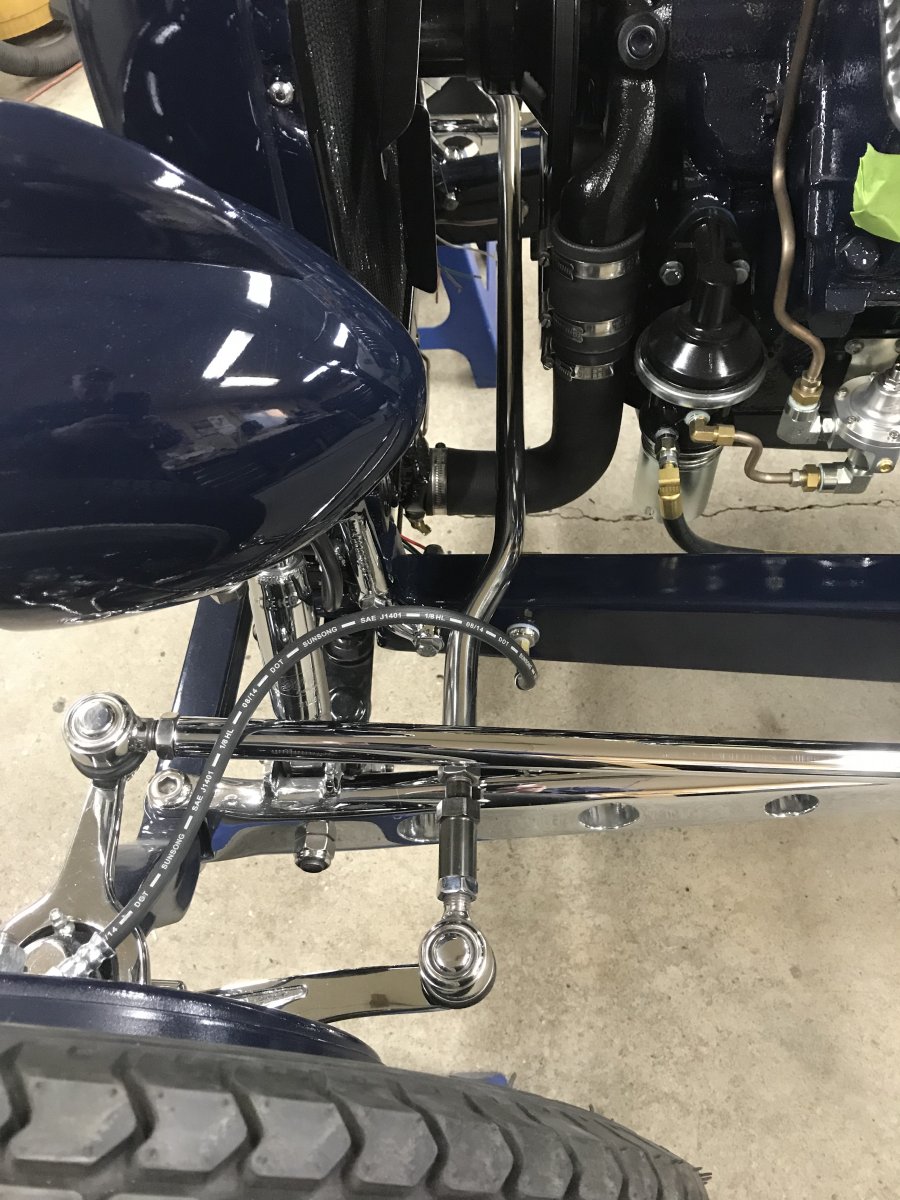

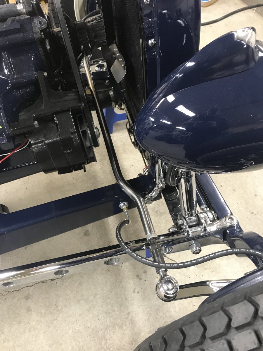

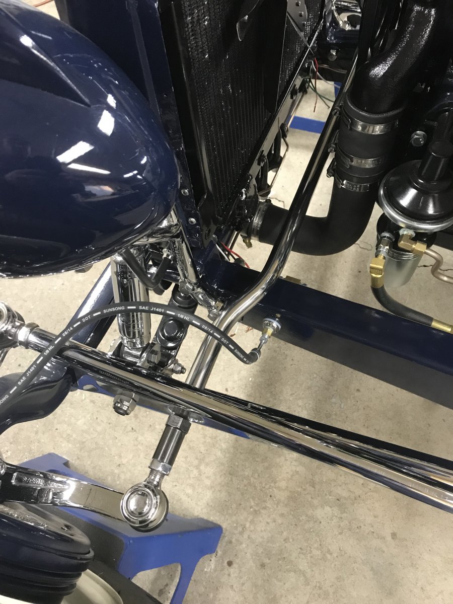

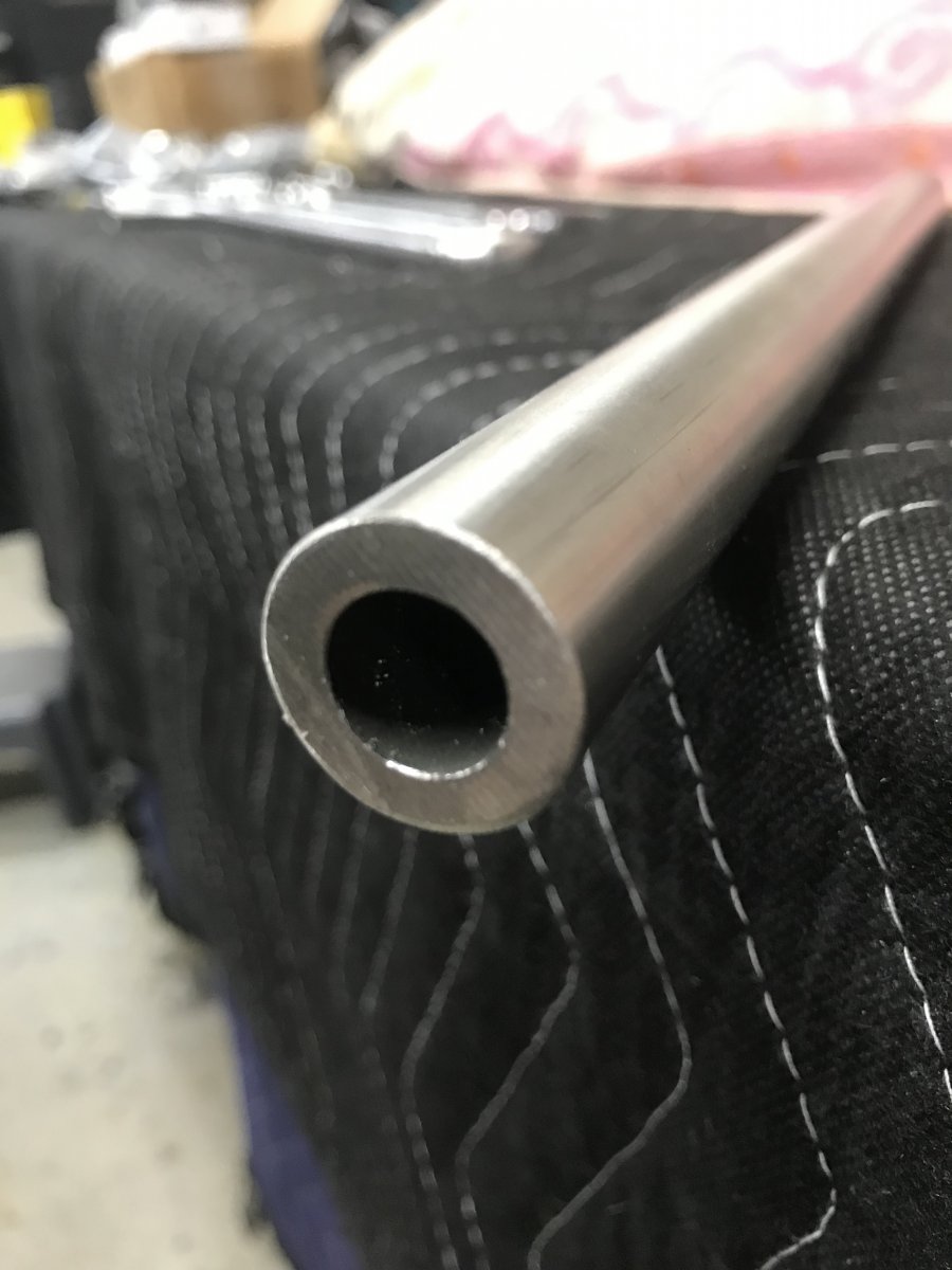

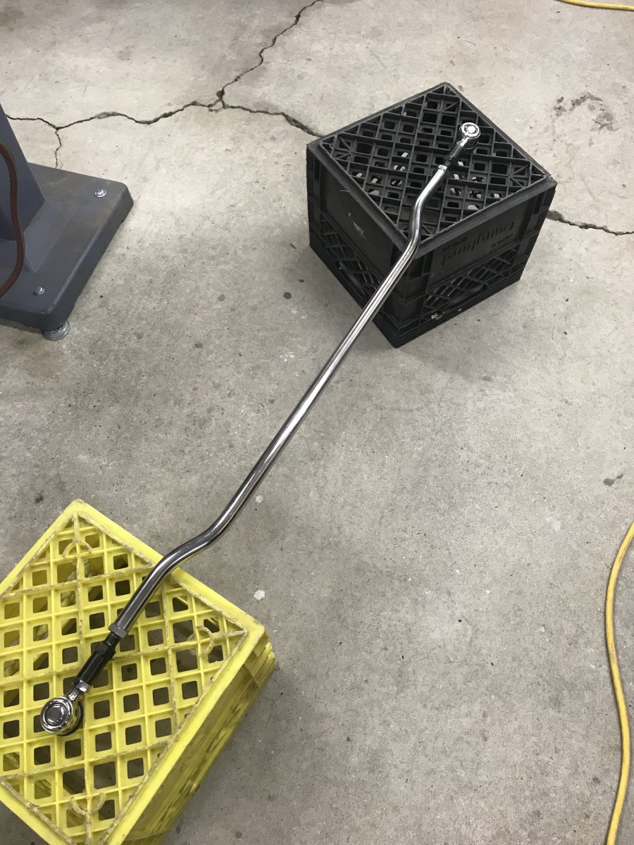

    So today I spent the day bending and then polishing my new tie rod tube.
    I had figured out the length I needed and how much I would lose with the bends and had the tube cut and re-threaded on the right hand threaded end at a local machine shop.
    My wife helped me out with getting the bends set up and oriented properly it was a two person job.
    Then afterwards when I had it installed she helped me dial in and measure 1/8” of toe in.
    The gauge I made worked great so did having the double adjusters on each side.
    So now there’s lots of clearance for the mechanical fan and the clearance for turning is good like it was previously too.
    Tomorrow I’ll work on the shroud. :cool:

    This is a great and even a period compromise and or solution...to your former dilemma...
    I just want to present a scenario I experience with metal bent in a similar manner and what I presume is related to what I am going to mention.
    My radiator support struts are bent in a way like your steering link...why to clear engine related matter...
    What I see happen is most of the time is when cruising the rad sits still and Firm...many times however the rad rattles sides to side and I believe the bent rods allow a flex that straight struts would not allow.
    Obviously your bar is a much heavier stock and strength may stymie this potential weakness in running an offset or not straight bar...
    I am just thinking out loud and thought I would share this...I have researched replacing my struts with straight ones as it may eliminate my discussed rad shaking...and there is room to reposition the cowl support bracket.

    I don’t believe this tie rod is going to do any flexing.
    It was advertised as being Stainless Steel 7/8”x .156 wall tubing.
    I just measured the extra piece that was cut off and it’s actually 7/8” x .1875 , that’s a full 3/16” wall thickness.
    That’s really stout stuff.
    brEad, loudbang and Stogy like this.

    No doubt...I was just thinking with road activity pounding away at the wheels it could exert a fair bit of force to that component possibly opening up possibility of bump or wobble issues...
    I actually replicated my struts out of a larger dia. bar but the problem in my case didn't go away.
    You have driven your ride prior to your redo here so at this point in time I can't recall what changed to cause the change we are discussing.
    I know you will be giving it a driven workout so any issues that arise you will be noting them.

    Having the mechanical fan versus the electric fan will make all of this worthwhile.
    I have a front panhard bar and if I have any issues later on I have the room and ability to add a steering dampener from So- Cal.
    And NO this is not an opening for anyone to start a discussion on the merits of or drawbacks to steering dampeners.
