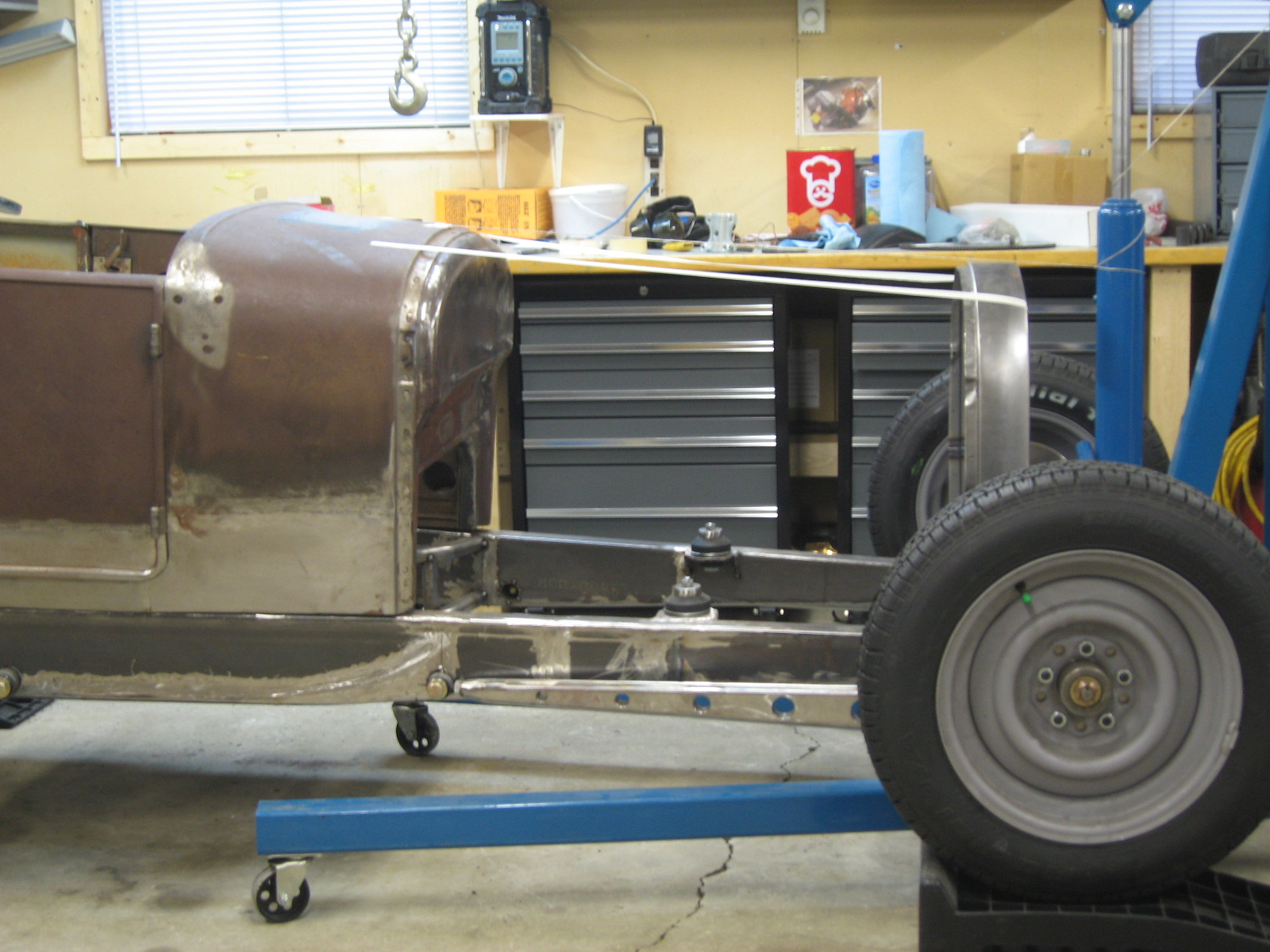

    Went out and chopped 1 1/4" out of the height of my A shell. Broke out the Tig and welded it back together.
    I think it looks good to me. Tape and string are handy :)
    Now I can order the new Griffin aluminum model a rad which will be 21.5" tall overall height.
    Short as it sits right over top of the spring crossmember.

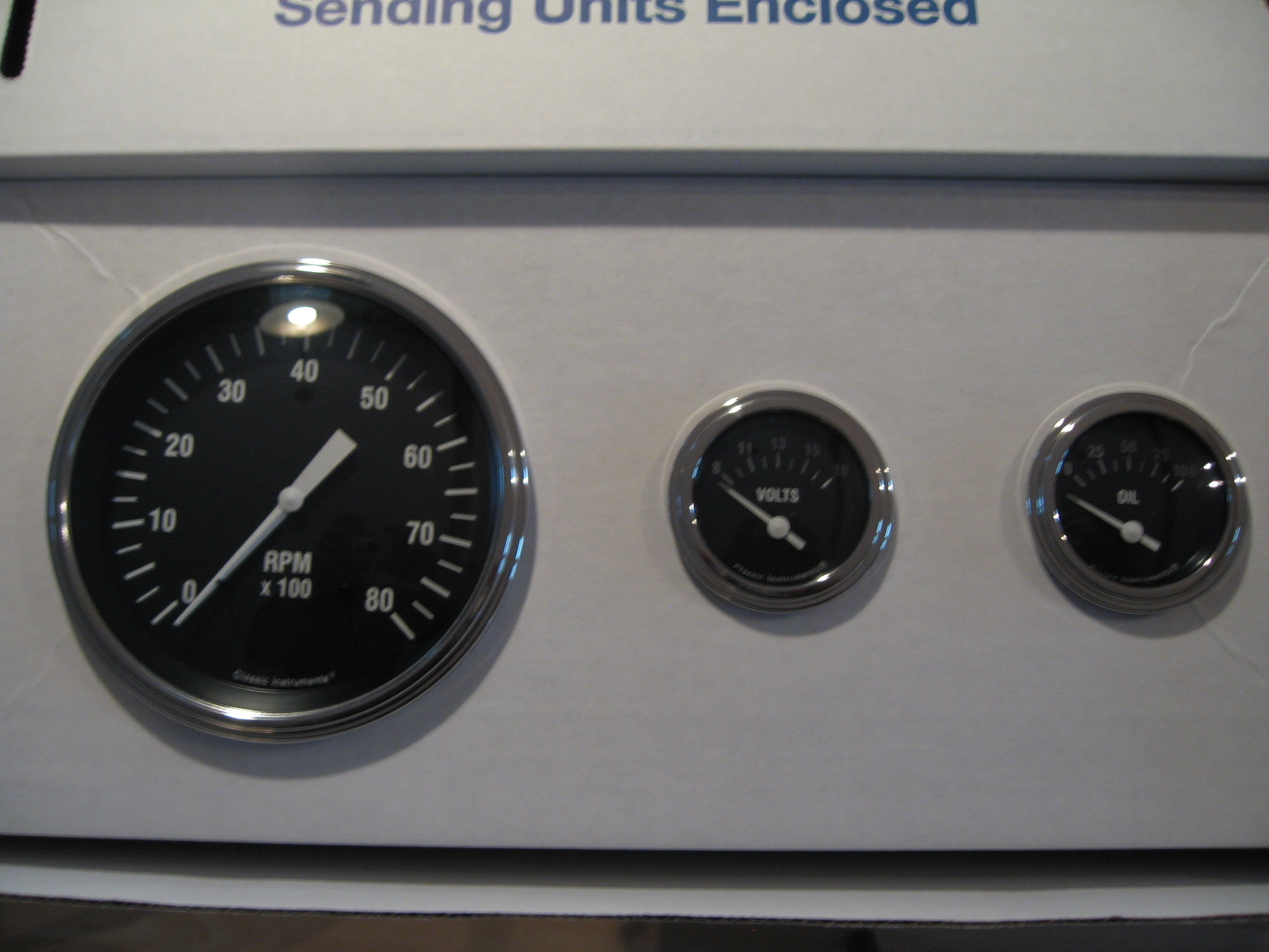

    Also picked up the Cl***ic Instruments hot rod series gauges for the dash, 5" speedometer and tach etc. :)

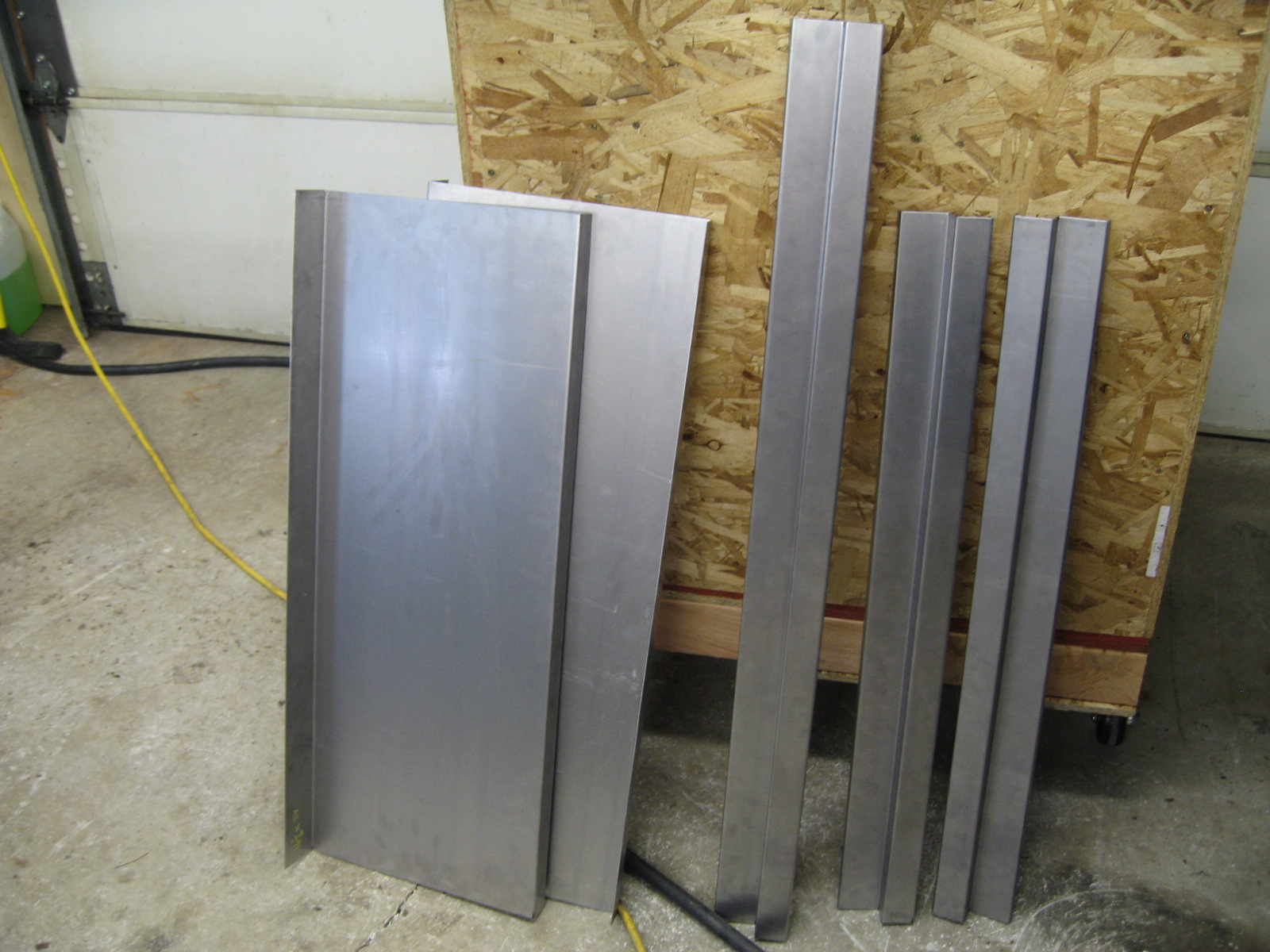

    Bought the metal and spent part of the day messing with the brake.
    The parts are already looking like a box :)
    Repro tailgate will be narrowed 4".
    Stay tuned :)

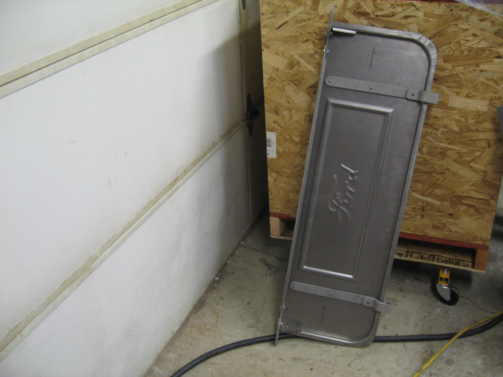

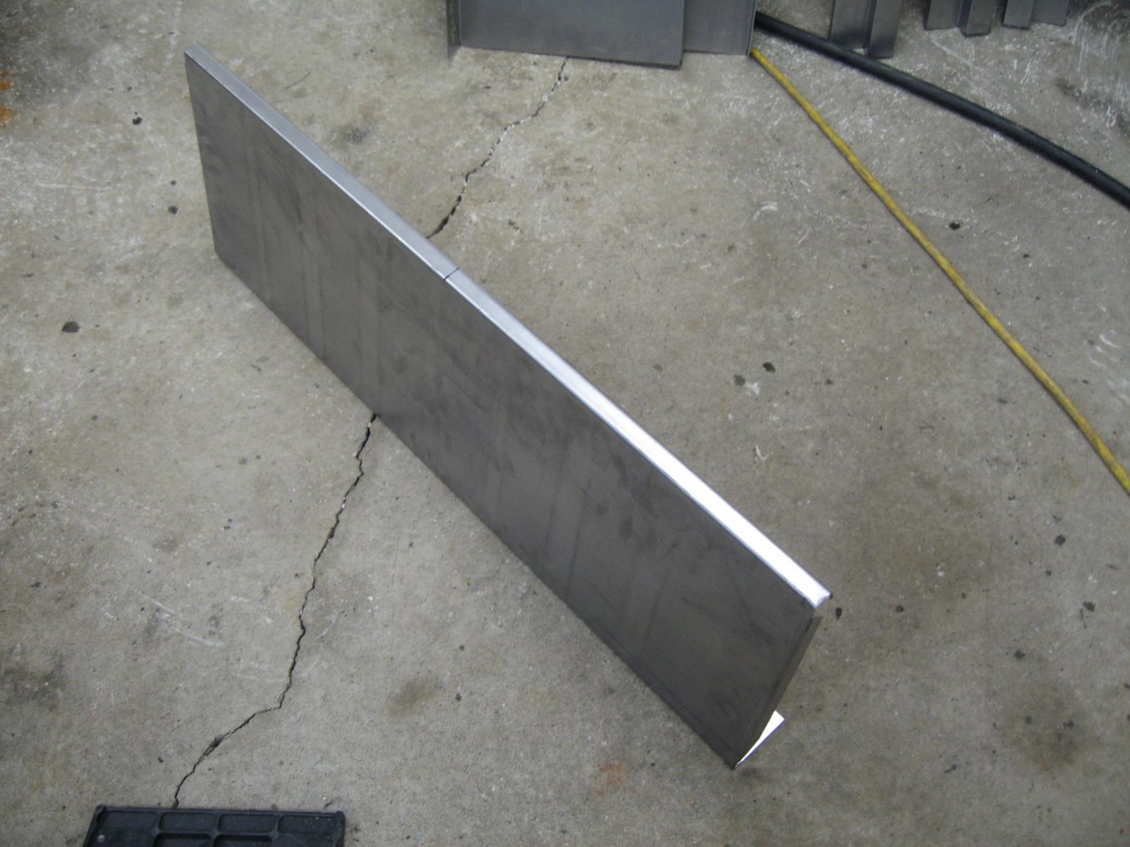

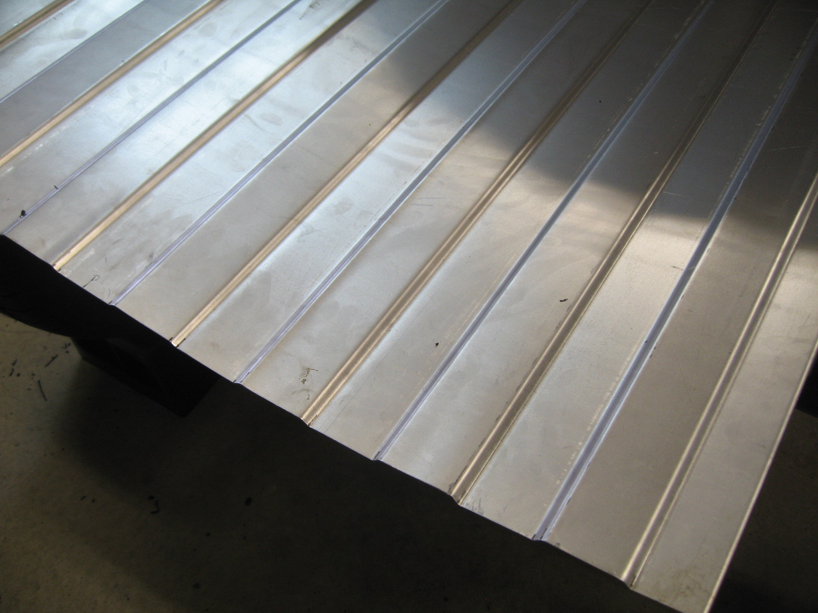

    Update time. :) You saw the pieces of metal I bent up. I used 18 gauge and the bed is 34" long total length. The bed is 12" deep. The width inside, side to side is 36 3/4".
    I used the repro tailgate (Model A) and the rear curved stamped piece that it mounts to. The rest I fabricated.
    I narrowed the tailgate 4" to make the bed fit better to the scale of my T body.
    The top of the rails was done with 1 1/4" x 1/8" tubing welded and ground smooth.
    Enjoy the pictures , you are looking at 7 days of fabrication averaging 6-9 hour days.

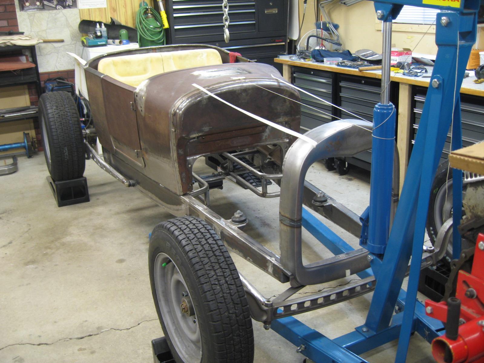

    Some more pictures including the finished bed and an overall shot. :)
    The 26 is now officially an RPU. :)
    I will fabricate a stainless gas tank for the front portion of the bed and will still be left with a little space for whatever :)
