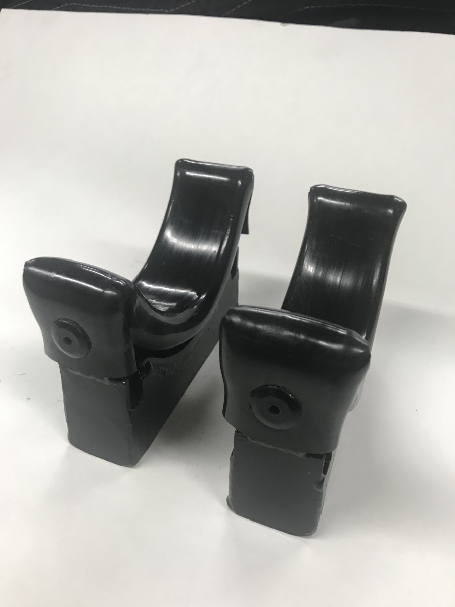

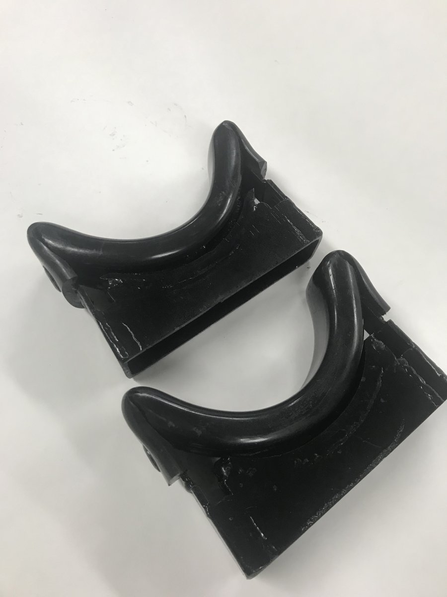

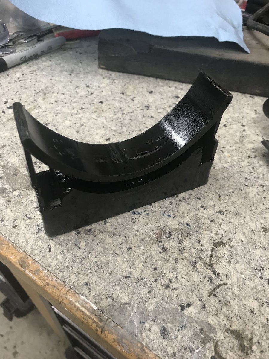

    The saddles for the top of my jack stands to hold the rear end were failures in regards to my attempt to glue rubber into them.
    Even using the strongest contact cement available was no good.
    So plan B :D

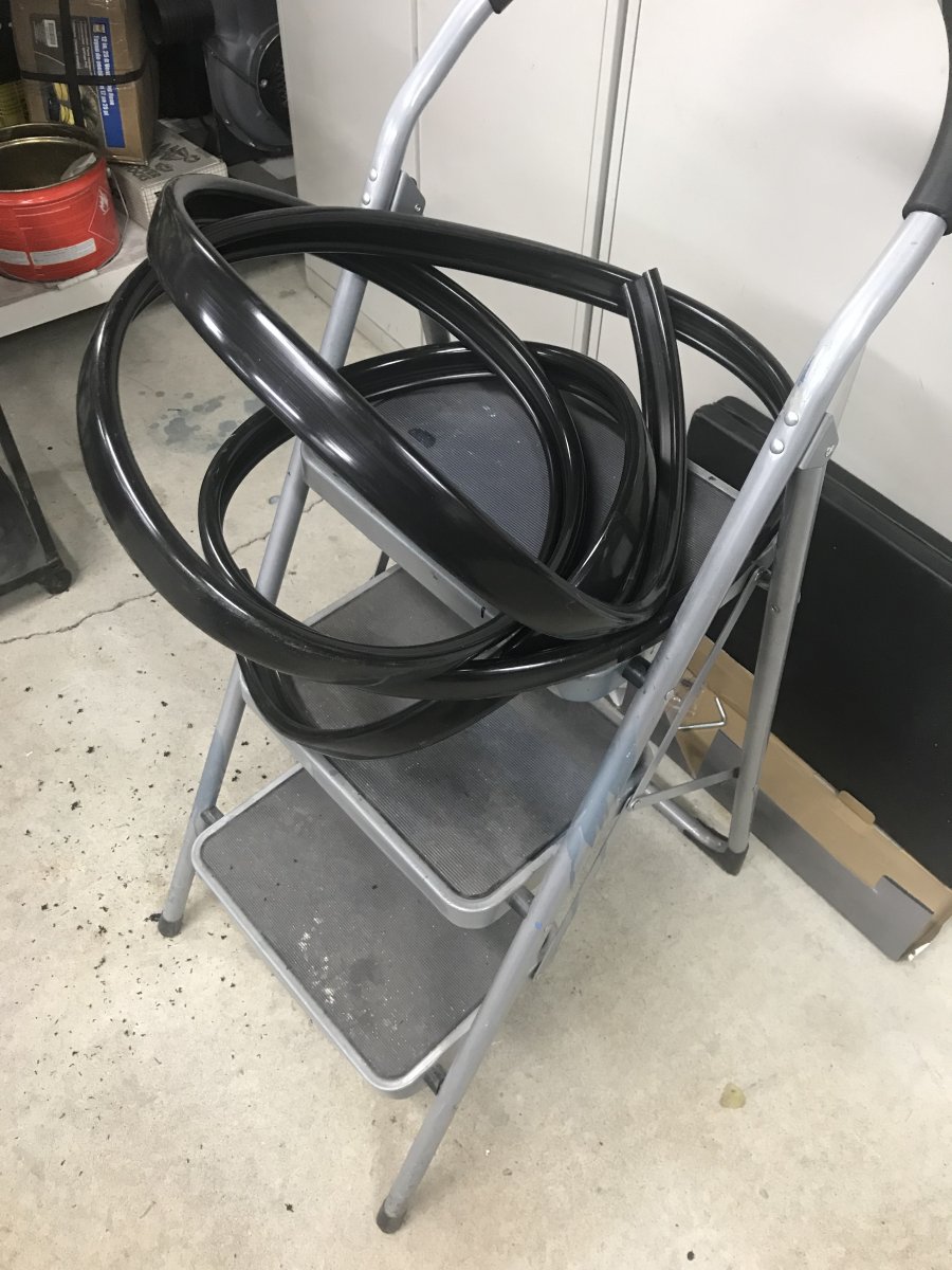

    A trip to the ornamental iron shop netted me some thermo vinyl handrail cap material.
    I had to modify the saddles so that I had the lip required for the plastic to hook around.
    See photos.
    After that the heat gun and some large diameter rivets and we’re good to go.:cool:

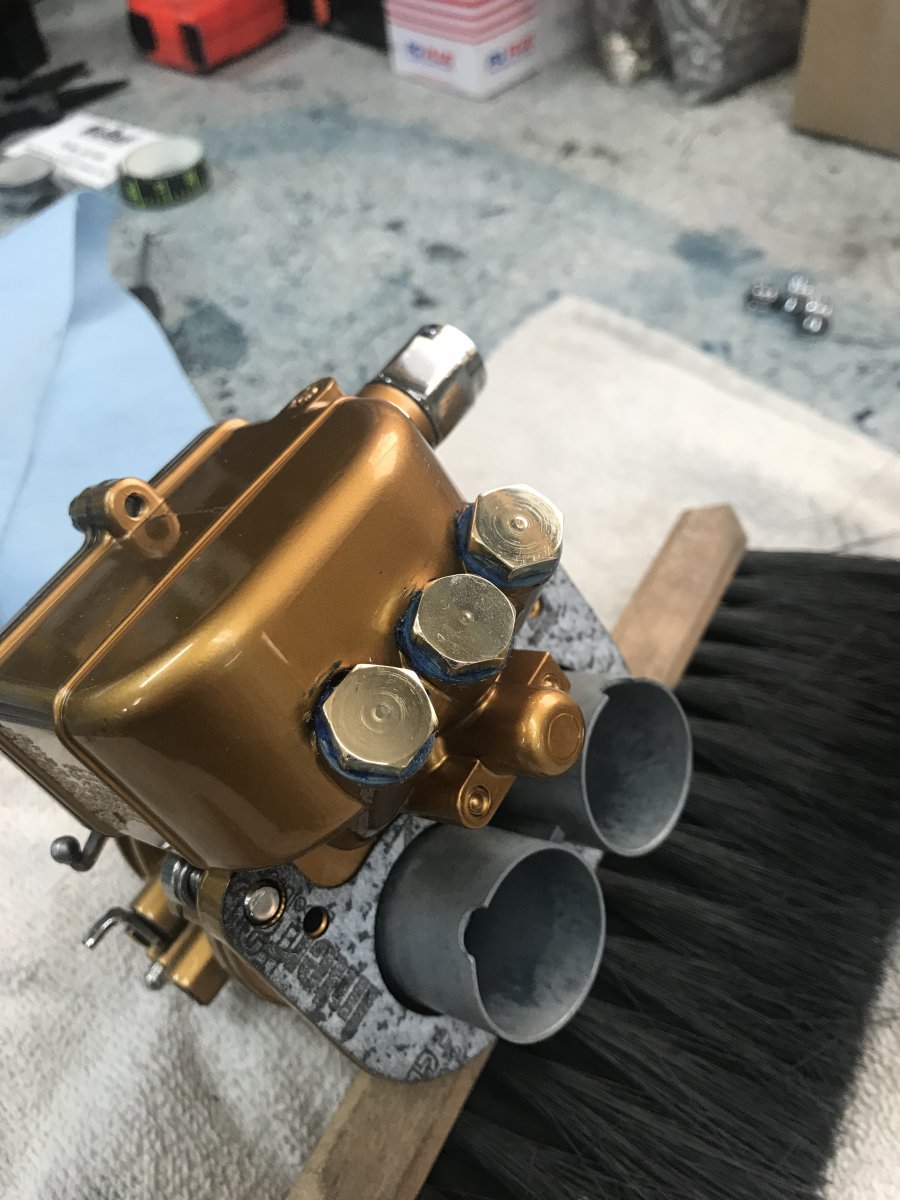

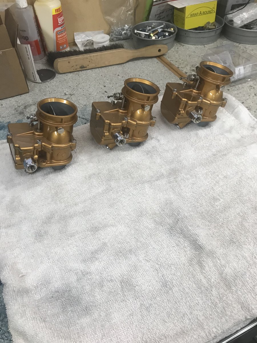

    Carbs apart for the new bowl plugs and seals
    I’ve also realized that since I have mechanical carb linkage including from the pedal that I really need a throttle pedal stop so that I don't try pushing the pedal through the firewall and bend and tweak the linkage. :eek: :D
    I could make one but looking at Summit I saw a nice one so I ordered it.
    I’ve also discovered that I need to put the Stromberg throttle shaft return springs on all three carbs.
    In my brief fire up I found that they are needed.

    First carb with the new plugs. :cool:

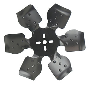

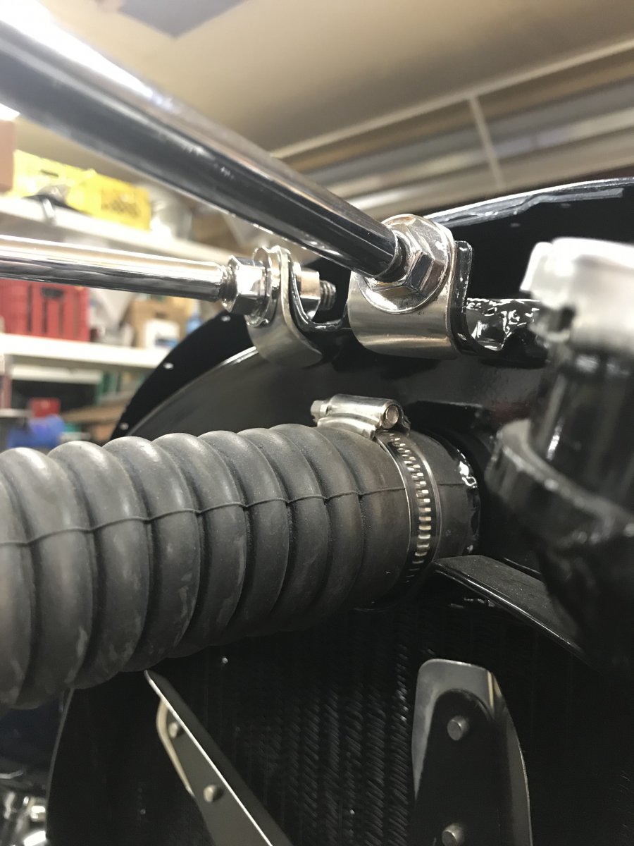

    On the advice of my buddy and also after talking with Tim in California I have decided to remove the fan shroud and run without one.
    It’s too close to the rad to be effective and is blocking air flow causing heat buildup even at idle.
    I’ve also ordered a more aggressive cooling fan a Derale 17313.
    The first one I installed does practically nothing.
    I took the carbs off again and removed the hex plugs, went back to the original chrome plugs supplied by Stromberg with the new nylon sealing rings. Perfect.
    Then I set my Aeromotive fuel pressure regulator to 1.5 psi.
    Seems that I was also going about setting up the carbs incorrectly with my linkages all installed.

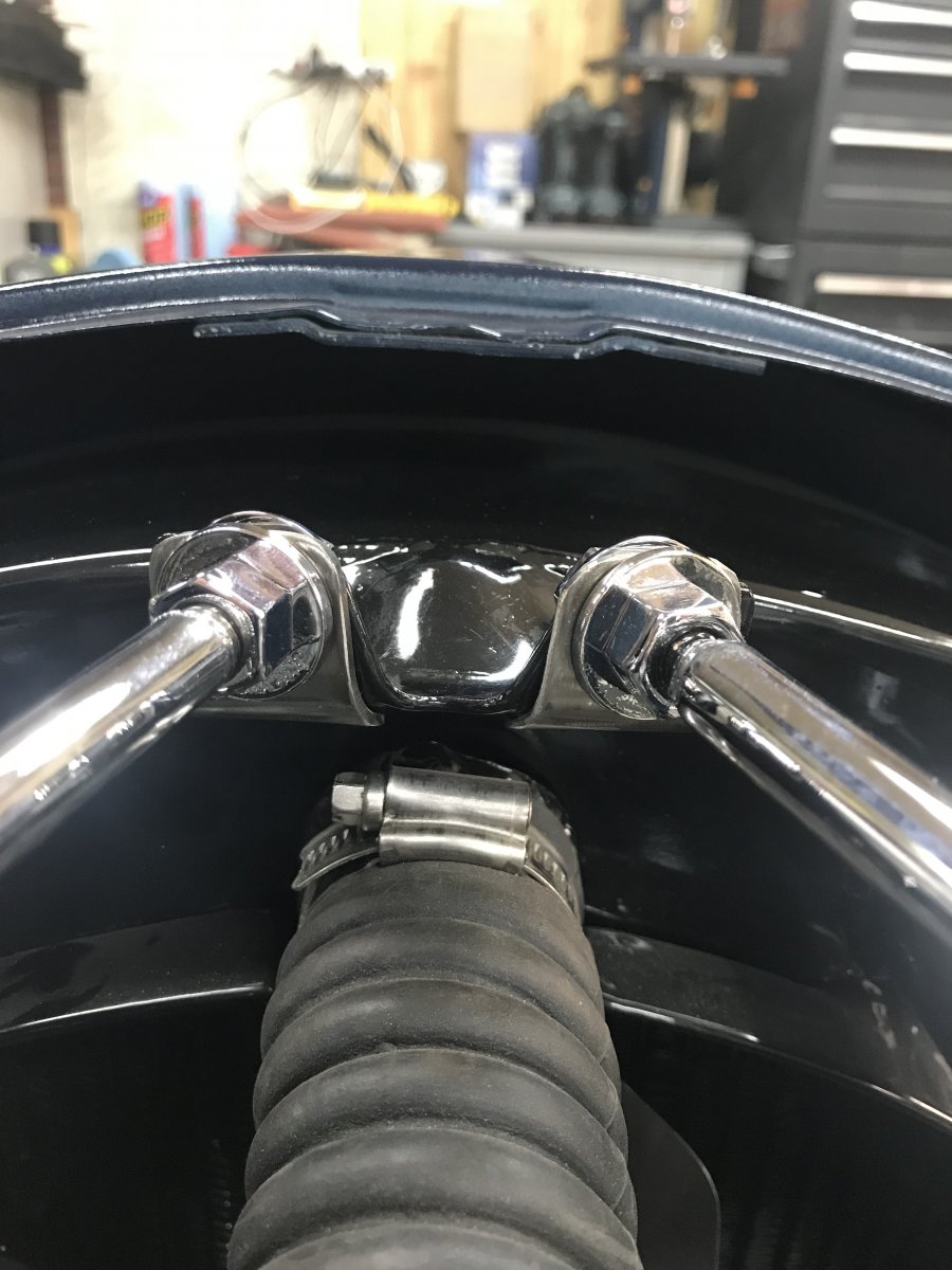

  29. I'm using rose joints on the end of my rad support rods - M8 are just right for the 12mm thick wall aluminium tube I am using.
    Sent from my moto g(6) play using The H.A.M.B. mobile app
  30. atch
    Joined: Sep 3, 2002
    Posts: 6,406
    atch
    Would you mind to throw up a pic of this installation?
    Thanx.
