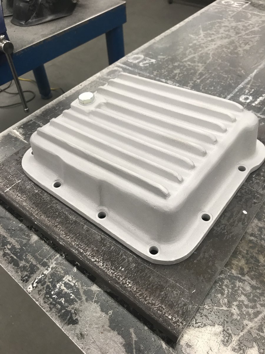

    I mentioned that transmission pan gasket leak earlier and it is still leaking :mad: another thing that’s my fault :D
    I know that the chrome stamped steel pans typically leak.
    Heck even the stock steel pans leak eventually.
    I installed one because I couldn’t find a stock depth aluminum pan anywhere.
    No extra depth pan for me to hang down on a already low car :eek:
    So I decided that I’ll take matters into my own hands in typical hot rodder fashion and order a deep pan and cut it down to suit my needs.
    ( Stock depth and capacity )
    A little bit of aluminum Tig welding and away I go.

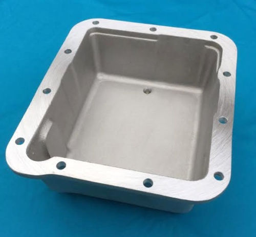

    Searching lead to a pan I think will be perfect made by LPW Racing (USA made)
    I also picked up a Moroso silicone pan gasket.

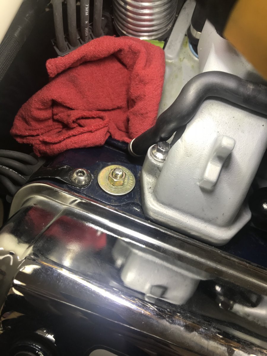

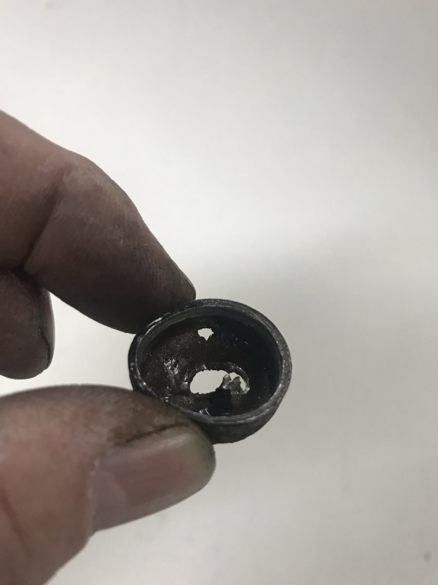

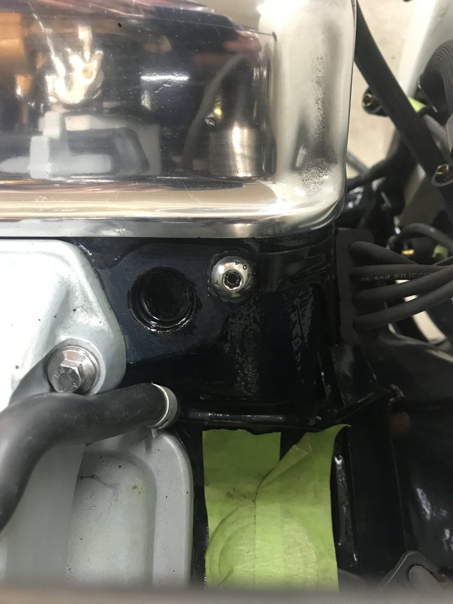

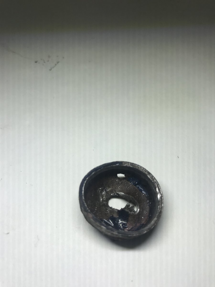

    This is an example that things can be overlooked at the best of times.
    I had a small weeping leak in the 29/32” core plug on the rear of the p***enger side head near the distributor.
    Couldn’t get it to stop. Looking closely it appeared to be leaking at the bottom of the inside of the cup not around the edge.
    So, I drained a jug of antifreeze and pulled it out.
    What I found was a thin rusty old plug that when pulled out revealed the pin hole leak when a piece of rust popped off.
    1425E8E8-5139-405D-B0A7-973443302480.jpeg EC3BB465-90D3-4A18-AFBD-E77D1E9252C8.jpeg B6314D95-D97A-43DE-B597-357889F90F59.jpeg
    So I ordered up some more core plugs which of course aren’t available locally. :mad:

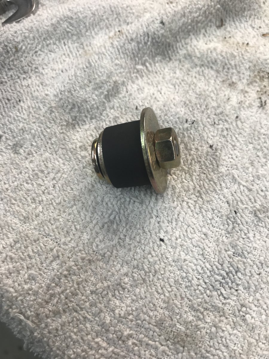

    In the meantime I took a larger (1”-1 1/8”) rubber expansion plug and spun the diameter down on the belt sander to fit the hole snugly.
    The small one was too small and the big one was too big :D
    I know some people don’t like them but I’ve used them with good success in the past having had one installed on a old daily driver for over 10 years.
    It’s in place and not leaking and I’ll keep an eye on it and if’s it’s ever a problem it’s easy to change.

    Those rubber plugs can be your best friend when on the road. My son and I replaced a leaky steel one some where in New Mexico on a trip from Nevada to Texas in his '54 Studebaker. It was in a spot that would have called fo some major dismantling to get another metal one in. It's been working for years. And yes the Right Stuff works but sometimes not fun to get things back apart.

    That rubber core plug is going away sooner rather than later as I got a package of new steel core plugs and decided to install one.
    I made a special tool to install it.

    Transmission pan is here and very soon will be cut down and ready to install.
    Goodbye rubber core plug and hello new steel core plug. :cool:

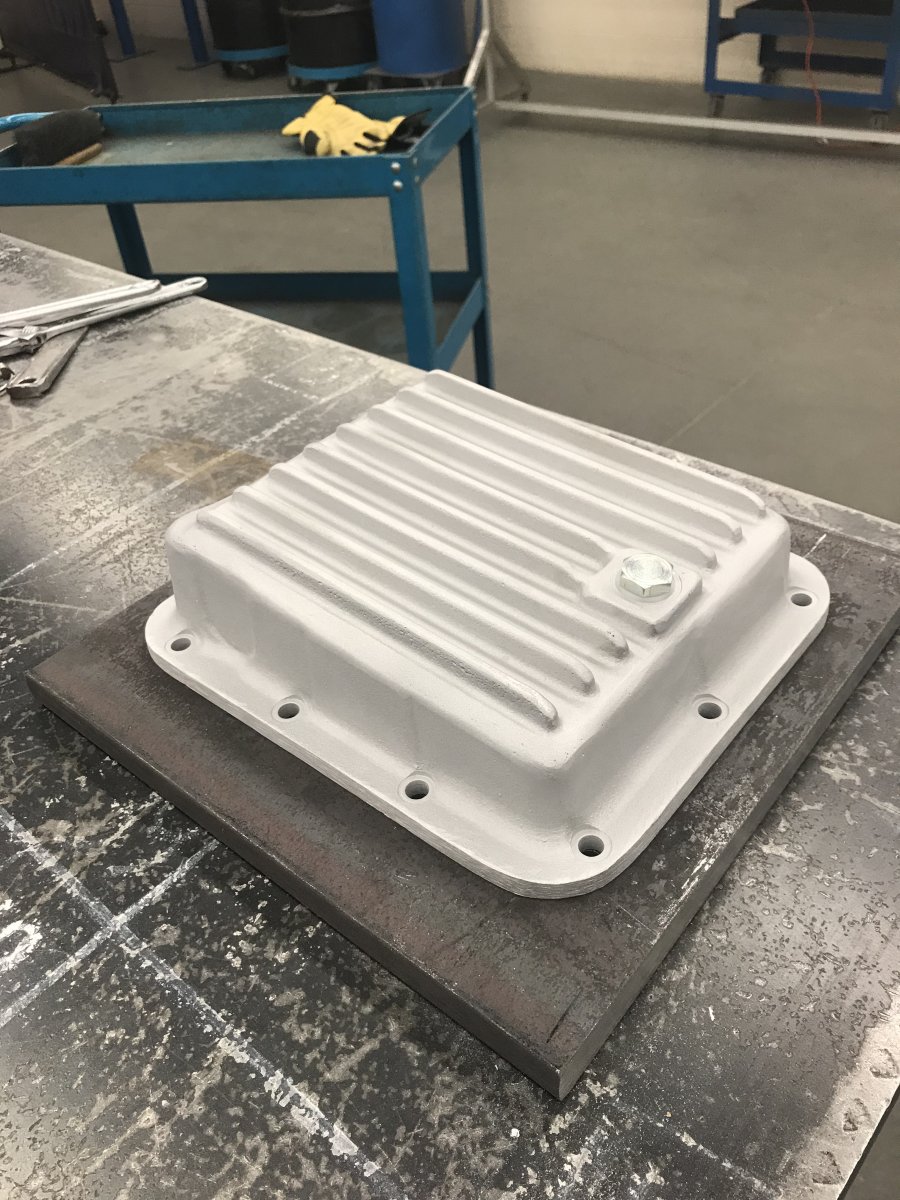

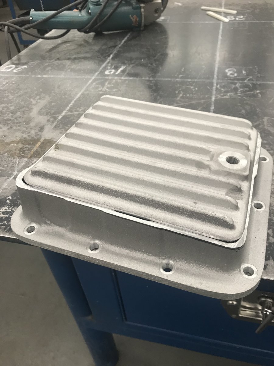

    :D I won’t be preheating the pan, but I have prepared a 12” square piece of 3/4” steel plate that I drilled so that I can bolt the pan down tight to it with the 11 bolts.
    That way it will keep the nice flat machined gasket surface.

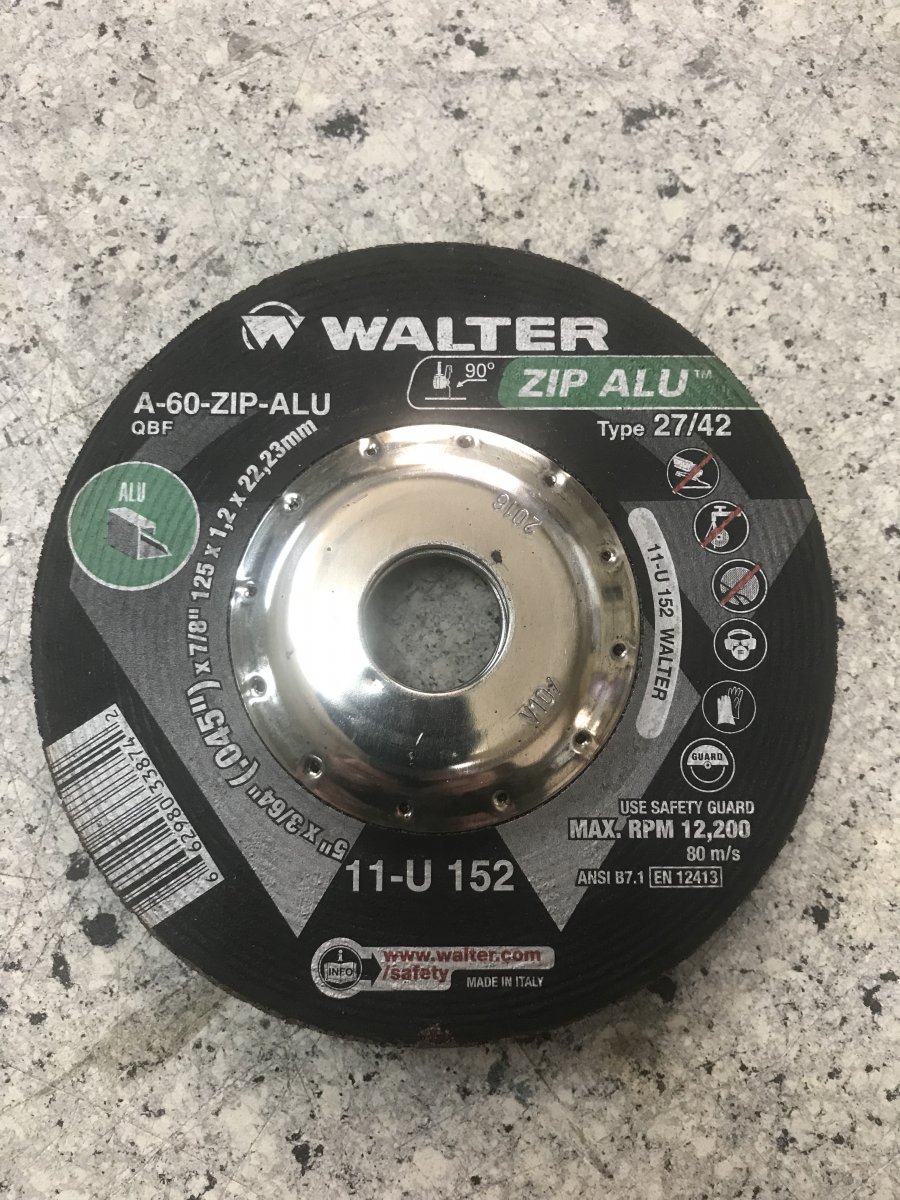

    I’ll cut it down with Walter Zip Aluminum blades.
    I’ll be welding it with my Tig machine. :cool:

    Merry Christmas! Thanks for that Aluminum disk tip, never knew they were out there. Bob
  17. DDDenny
    Posts: 22,481
    The Walter line of cutoff discs are premium, when I ran the toolroom I got no whining unlike some other brands.

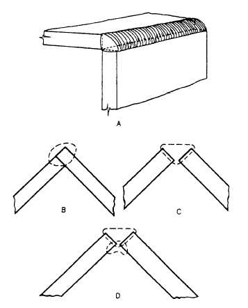

    Will you V out both sides, and weld inside and out? Belt & suspenders thinking I know. Bob

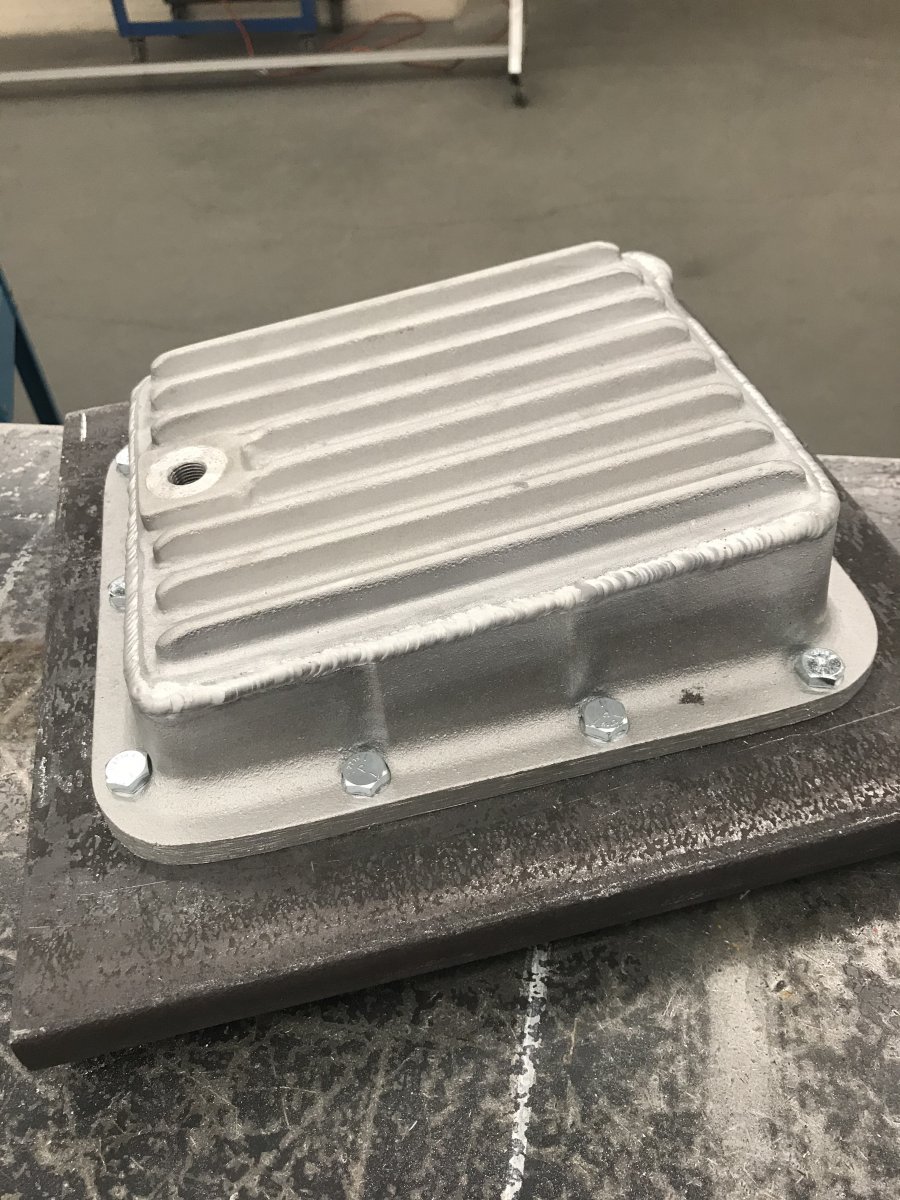

    I’m thinking that I’ll fit up the bottom (after cutting it down) using a corner joint all around.
    After welding I can just fuse the inside corner with a quick fusing p*** with the Tig

    That would be tough. I’m only doing the cut down because I couldn’t find a stock depth aluminum pan.
    This LPW pan is very nice and the design lends itself well to cutting down to stock depth and capacity.

    Ok, I had it pictured cut in the center and a section cut out, like a body top chop. Bob

    That would be one way to do it. I think I’ll have better success cutting the bottom off and then taking a section off and then putting the bottom back on because the pan has a very slight taper to the sides that you can barely see.

    Do those discs leave any abrasives in the cut or is it left clean of any contaminants that could effect welding? Vaguely remembering some problems we had when building aluminum block beds.
  27. Blue One
    Joined: Feb 6, 2010
    Posts: 11,512
    Blue One
    from Alberta
    No abrasive residue or steel contamination like you’d get using a steel cutting disc.
    The aluminum discs don’t load up like the steel discs do.
    Nice clean cuts ready for welding.

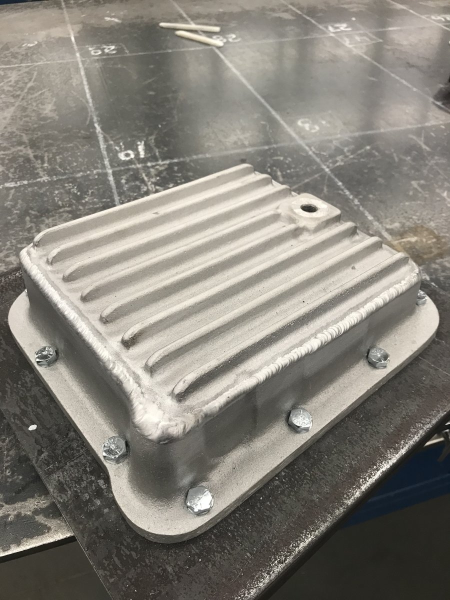

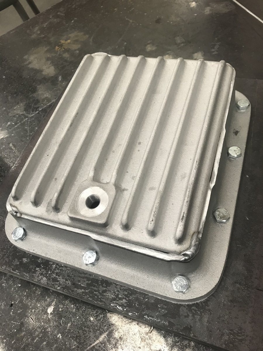

    Did some measuring and went ahead and cut the pan down.
    Welded it inside and out and then used a flapper disc and smoothed out the outside welds.
    That allowed me to take the pan to the blasting cabinet and make it look like it was never cut down.
    It’s now stock depth and capacity. :cool:
    Ready to install. :cool:

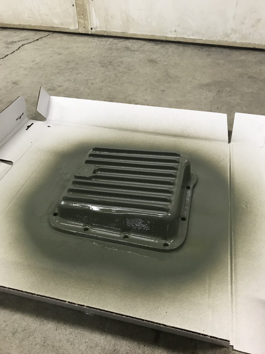

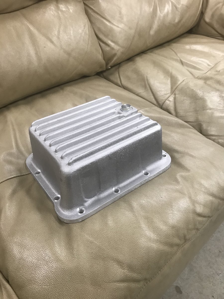

    I decided that since I have it all blasted and clean that I should paint it.
    First I went out to the garage and leak tested it with a little solvent just to be sure. As expected no leaks.
    Then a nice coat of etching primer (It dries to a dull flat finish) before the coat of black. :cool:
