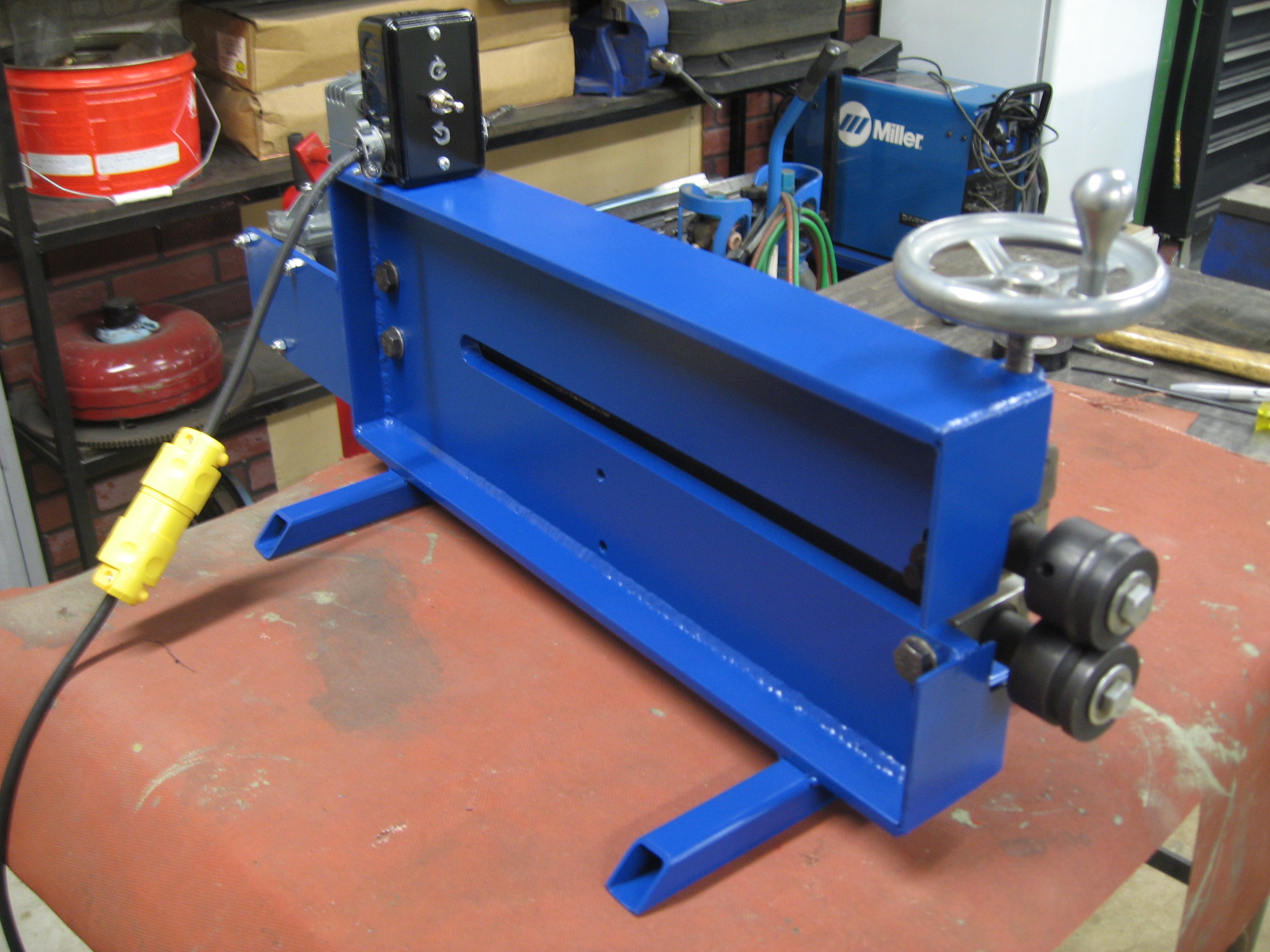

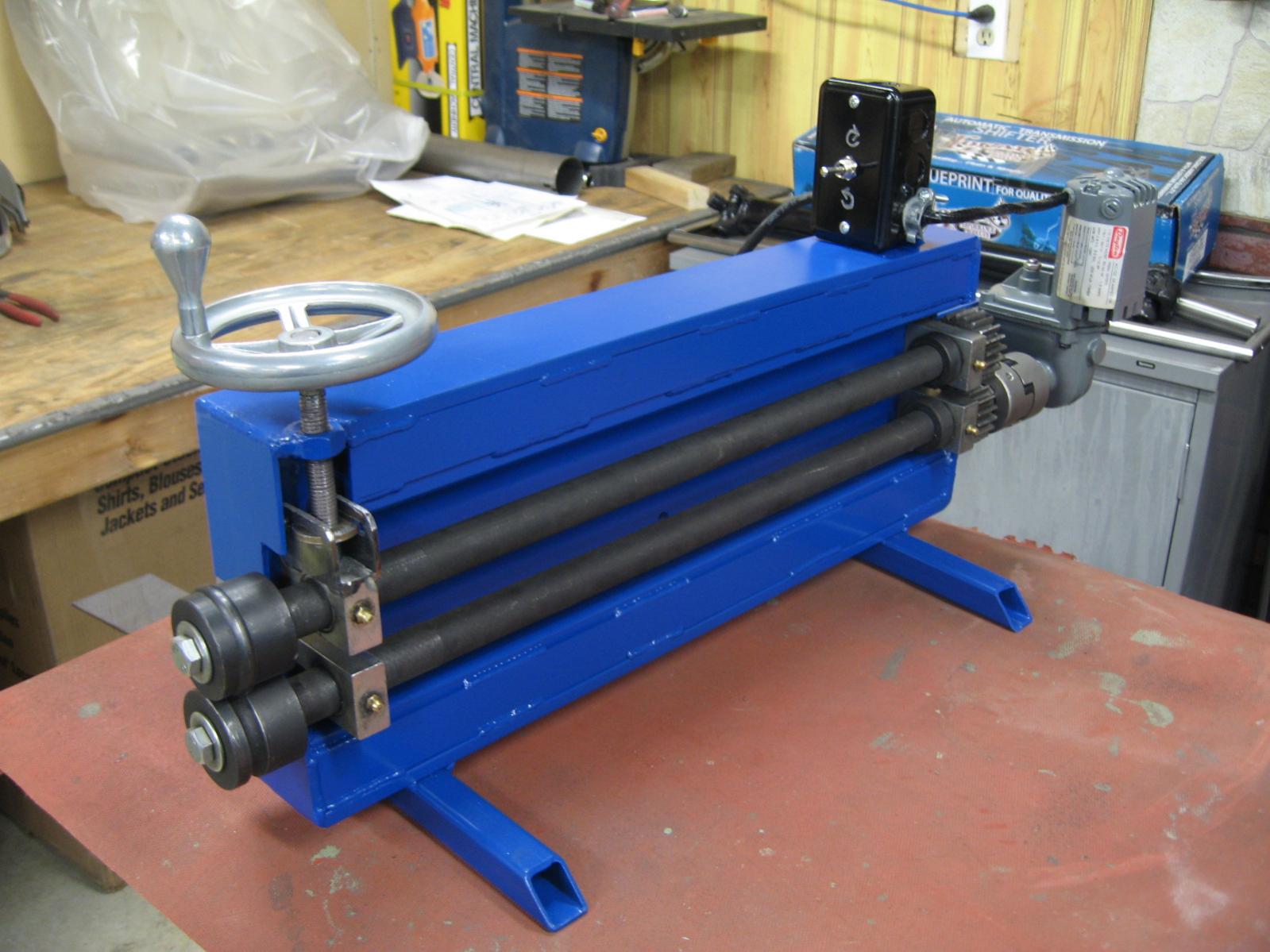

    Thanks, Just in the middle of beefing up my Magnum bead roller and powering it with a gear motor. Will use it for the floor panels and a few other things later :)

    For now, the bead roller :)

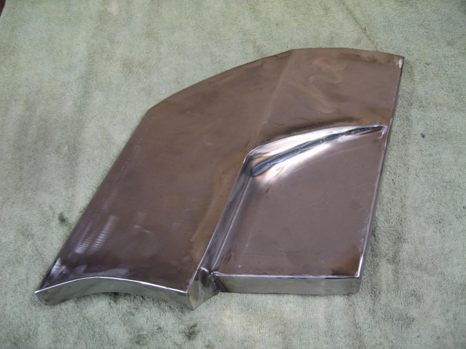

    An update :) I had an area below the bed and at the rear of the frame rails that I felt looked a little empty.
    Because I had ended the frame rails and kicked them in before going up, I felt it needed something there.
    My solution, a panel that is a bit of a fake out, making it appear that the frame sweeps up under the box (which it does just inboard.)
    I started with a poster board pattern and then made the real thing in 18 ga metal just like the bed.
    I like it, better than the hole there I think.
    juan motime and Jibs like this.

    Wow! Did you hammer form that, or make it from separate pieces welded together?
    Sent from my DROID device using the TJJ mobile app

    I put the pattern together with masking tape and when I was happy I cut it apart into 2 pieces that would lay flat and then cut it out.
    Used my brake for the bends and then welded the pieces together.
    Finished the welds with an 80 grit flapper disc on the grinder.

    WOW!! That bed is nuts! You have some killer fab skills.
    Nice job on the bead roller, also! What's the story on the motor and gear reducer drive?
    Grainger's?

    Great post on the bead roller mods!^^^^^^
    Thanks for the connection.

    I was pretty sure it was two pieces, unless that cool new bead roller had some SERIOUS tricks up its sleeve! :D

    Those fill panels turned out really nice. It looks much better than it did with nothing there. I may have missed it but are you painting the frame the same color as the body? If not are you going to paint the new panel to match both the frame and the body color?

    The frame will be done body color as will the panels and bed too. Washington Blue, actually an Isuzu color that is the same.
