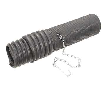

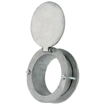

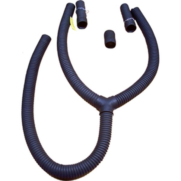

    Looking at options for exhaust hoses to vent exhaust outside I came up with this.
    $430 for 2 -11 foot hoses and the adapters for the tailpipes.
    That would allow me to run the hoses out under the door and still have the door down to within a few inches of closed.
    The next option would be to install door ports for the hoses. That’s another $80 or so.
    Its a lot of expense but the last time I had the car running for about 35 minutes and even with the 16x8 door wide open (the car sits about 7 ft from the door) and a fan running I still experienced a bad headache and I know that the CO was the reason because I just felt a little off too.
    I don’t know, just wait until spring or...spend some more money :confused::D

    :D Thanks guys, no dryer duct wouldn’t work it would probably leak and or melt.
    I could move the car outside if I liked the cold. Snow really isn’t the issue cold fingers etc would be the problem.
    I’m not sure what I’ll do right now thinking on it.

    Those kits are made for frequent wear of use, for commercial tuning so to speak. If your wallet is okay with that .. probably last you your lifetime, & then some.
    Your tip size being 2" or near, for dryer ducting you'd need to step up to 4" since that's minimum dryer duct size .. but you could easily make your cones with duct pipe, tin snips, & duct screws to cheaply go into a 4" adapter ring.
    Either buy 4" dryer duct exits, or exit .. & cut a 4" round hole thru your wall or door, with your choice of hole cover, or bulkhead fitting. Garage door critics may not like any such mod' .. especially for resale.
    Dryer duct max length is 35' ... straight shot. Believe you can buy 25' duct length. You may even get by with two ducts into a wye, & one exit. Terminal velocity into a duct-altor formula would be precise.
    I remember an HVAC guy on the HAMB. Anyone remember the 40 pickup, with removable roof top ? A Texas guy .. be interesting to shoot him an email for thoughts on DIY alternatives.
    Tuner guys like high temp silicone tubing, used in aircraft, & etc. Cheaper than the exhaust kit. It's out there .. search for cheaper.
    Interesting topic, likely attractive to many members.

    Before I clicked order I decided to check out Kijiji and there it was :cool:
    Brand new in the box for $175 Canadian and no shipping.
    A guy had bought it but never used it.
    I picked up the port to install in the door to run the hose through and I’ll be set to go :cool:
