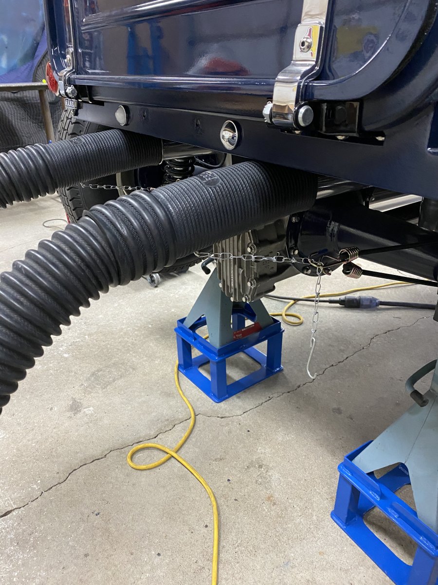

    Well I managed to get the hoses set up to vent my exhaust.
    My garage also now has a CO detector.
    I’ll open the window to bring in a little fresh air and then its run and tune time :cool:
    Note the safe use of a cinder block :D

    Actually, the cinder block should be rotated so the internal ribs are vertical.
    DON'T GET UNDER THAT HOSE WITH THE BLOCK IN THAT ORIENTATION!
    :D

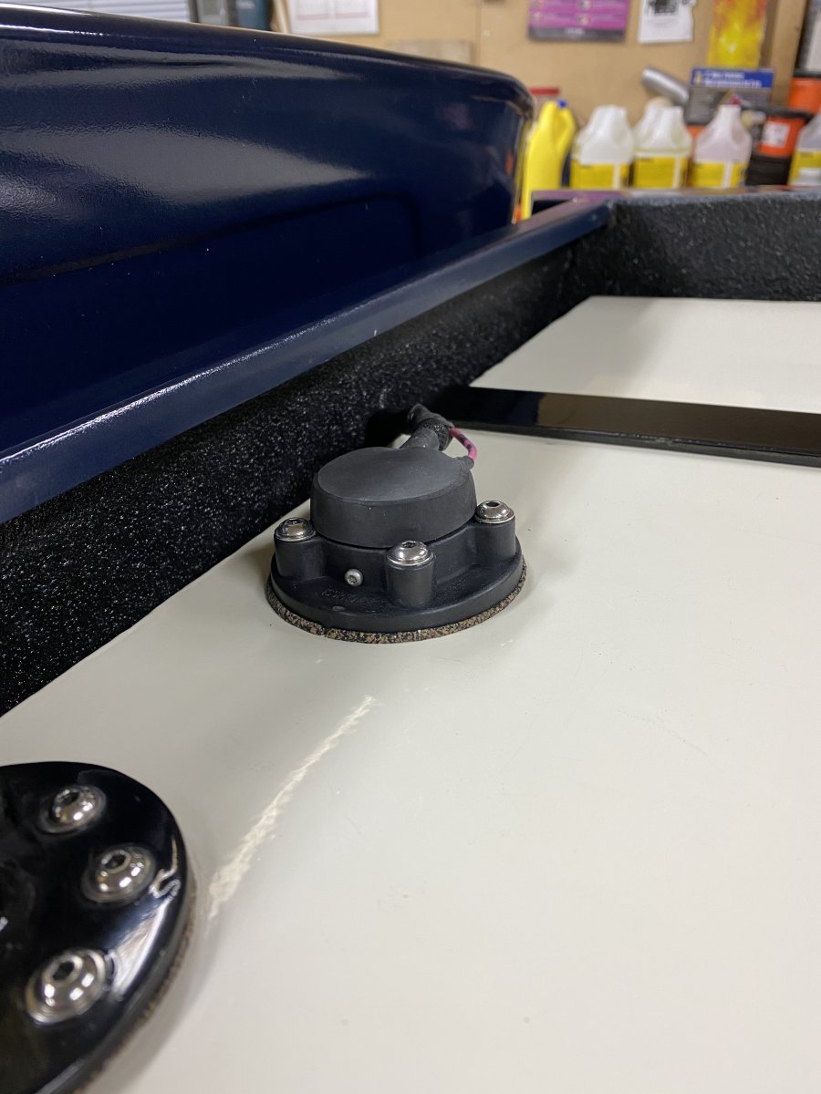

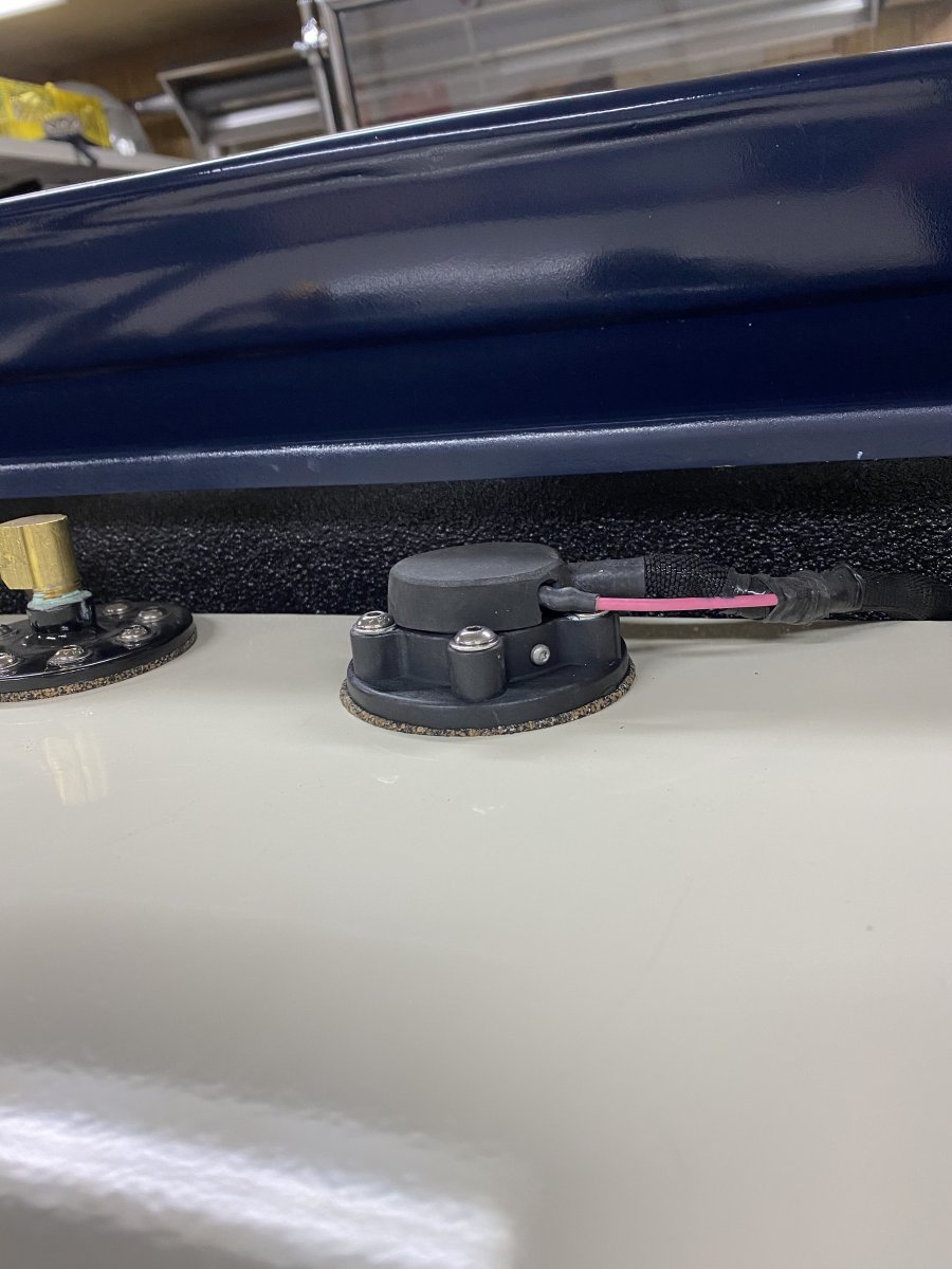

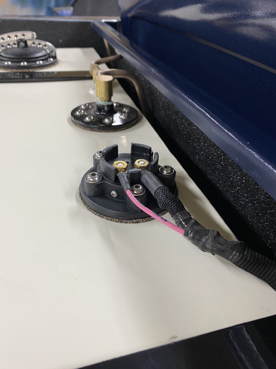

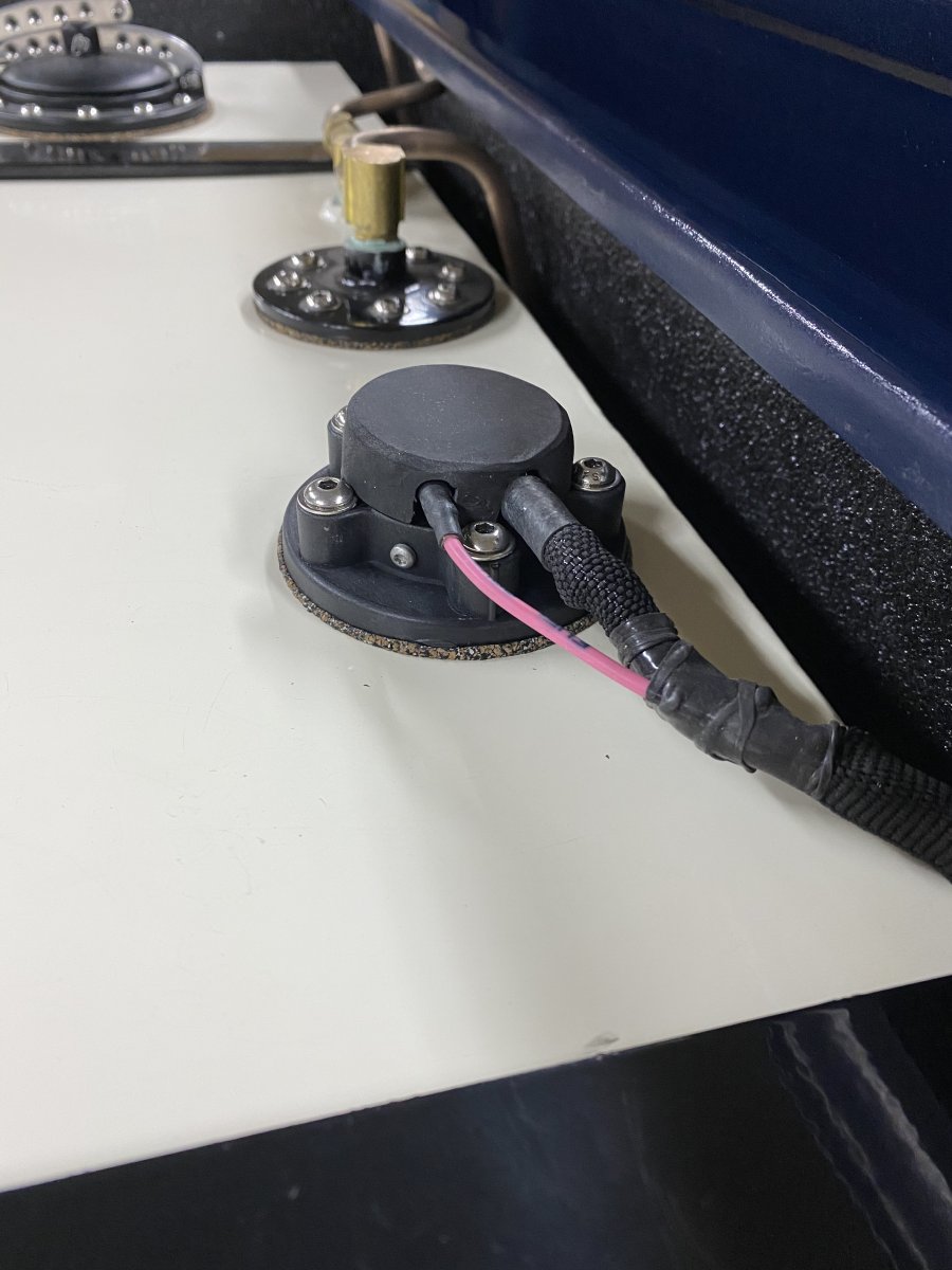

    My fuel sending unit just wasn’t giving a correct reading, probably my fault but I got tired of trying to get the float arm adjusted right.
    I ordered a tube type sending unit from Cl***ic Instruments and installed it today.
    I also made a little rubber cover for it.
    Works perfectly. :cool:

    Do those work with other gauges?
  18. Blue One
    Joined: Feb 6, 2010
    Posts: 11,512
    Blue One
    from Alberta
    I think they may, If you want to know for sure just call Cl***ic and get the tech guy. He'll be able to tell you if they offer one that will work with the ohm range of your gauge ( low to high ).
    It might help if you know the ohm range of the gauge first.

    Quick search found this
    https://www.tanksinc.com/index.cfm?ptype=results&category_id=159&mode=cat
    The resistance of your fuel sender should match that of your gauge. For instance the resistance of the stock gauge in a 55 Chevy has a value of zero ohms when empty and 30 ohms when full. The following list is for stock gauges and some popular aftermarket brands:
    • Ford up to 1986 - 73-10 Ohms
    • Ford 1987 & up - 16-158 Ohms
    • GM up to 1964 - 0-30 Ohms
    • GM 1965-1997 - 0-90 Ohms
    • GM 1998 & up - 40-250 Ohms
    • Mopar up to 1986 - 73-10 Ohms
    • AMC 1950-1977 - 73-10 Ohms
    • Autometer -240-33 Ohms is the most common however other ohm ranges are made
    • Cl***ic Instruments - 240-33 Ohms (excluding vehicle specific gauge kits which use factory ohm range)
    • Dolphin - 0-90 Ohms
    • Dakota Digital - Programmable to work with most Ohm range senders
    • VDO - 10-180 Ohms
    The first number represents the empty Ohm reading and the second number is the full reading.
    AndersF, loudbang and Six Ball like this.

    Curious how that sensor works. Not a big fan of the floats like your replaced as well
  21. Blue One
    Joined: Feb 6, 2010
    Posts: 11,512
    Blue One
    from Alberta
    Apparently it’s a pressure transducer.
    Really easy and very accurate.

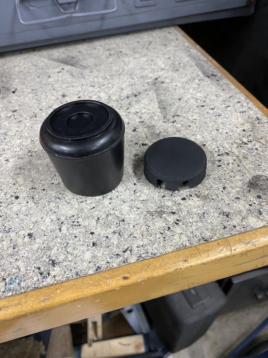

    That cap took a little head scratching and then a trip to the hardware store and then some time at the belt sander.
    One of these 1 1/2” rubber feet turned into this cap. :D

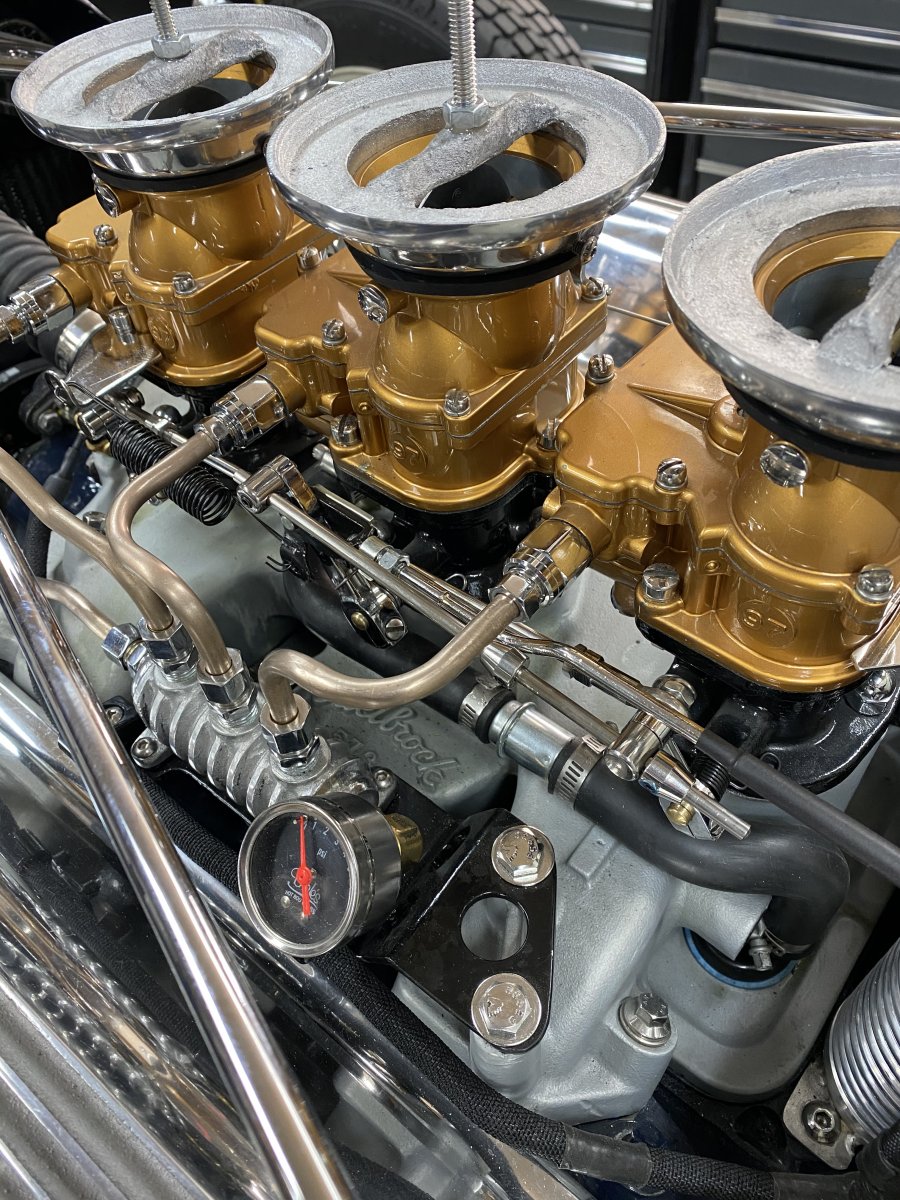

    Spent a little time today cutting out a few sealing gasket rings for the base of my air cleaners.
    Then I ran it and warmed it up to be sure it ran as good with them as without them when I balanced and tuned the carbs.
    Working good and sounds great.

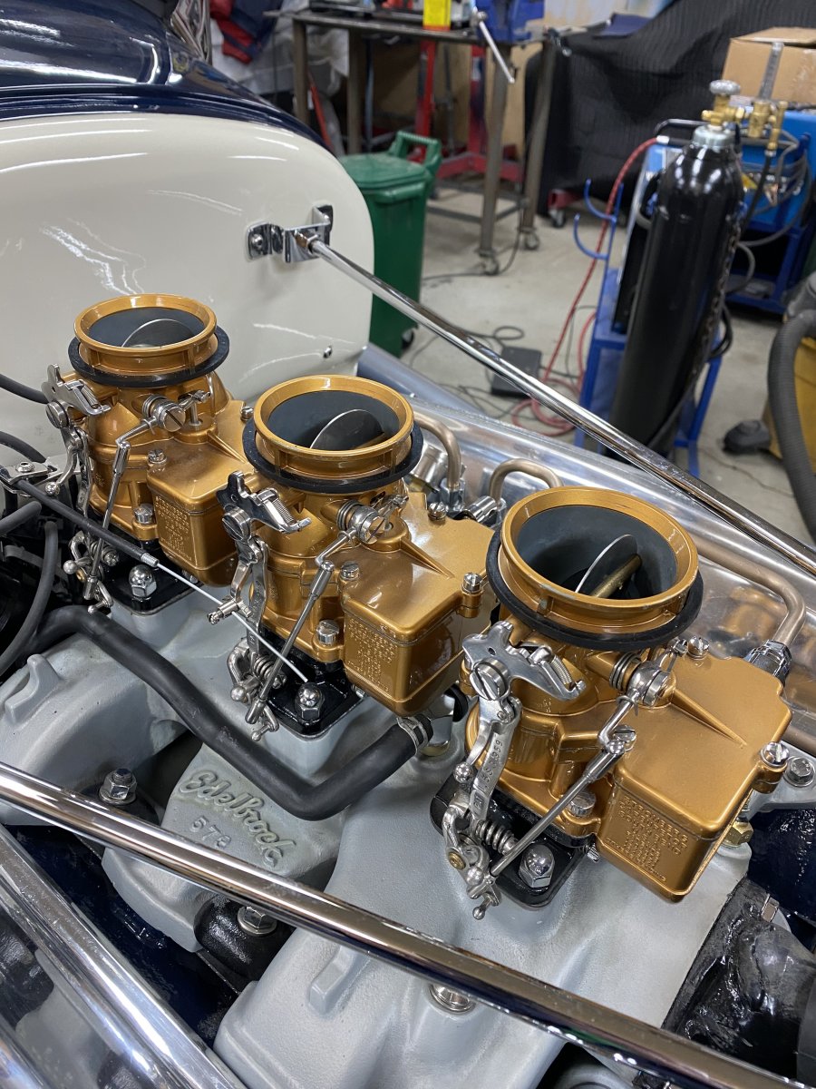

    Any reason why you left the chokes in the two end carbs?
  28. Blue One
    Joined: Feb 6, 2010
    Posts: 11,512
    Blue One
    from Alberta
    I was advised that they would be easier to balance and maintain equal flow during operation.
    That’s right from Clive at Stromberg.
    I just used a washer to allow them to be snugged tight in the open position.
    Only the center choke is operational.

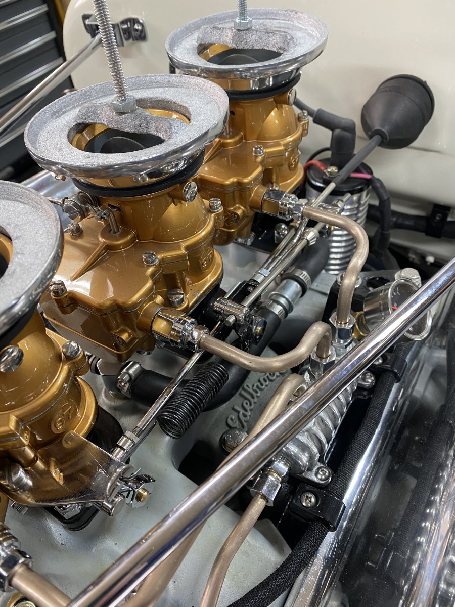

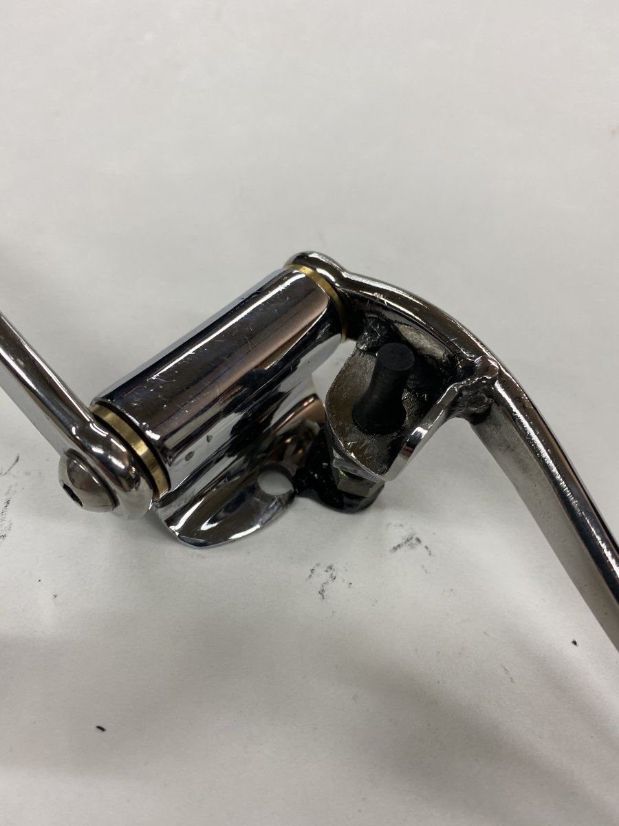

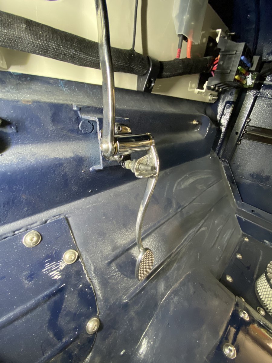

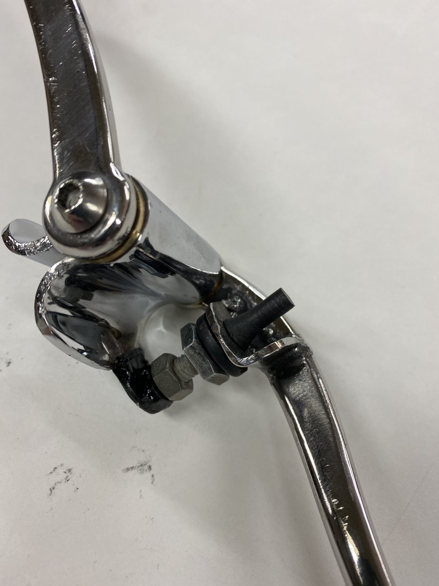

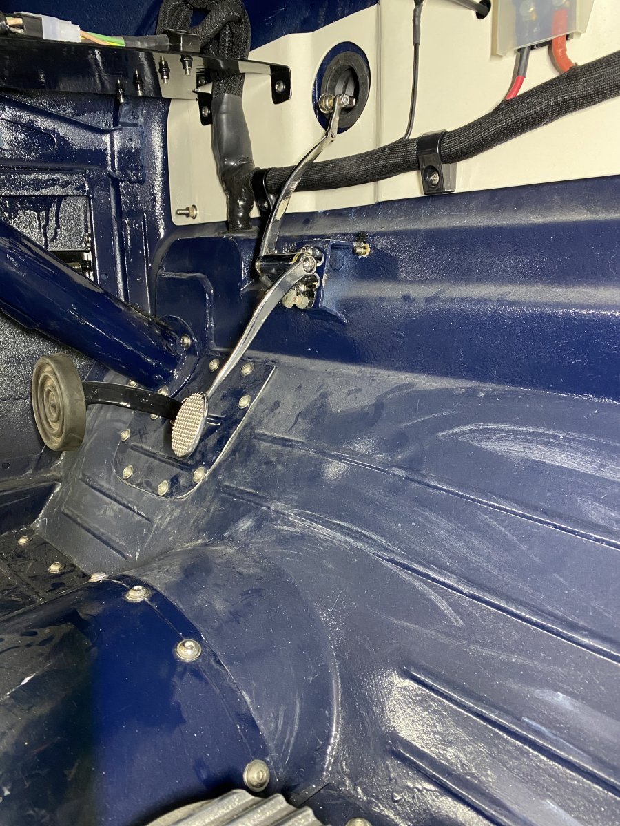

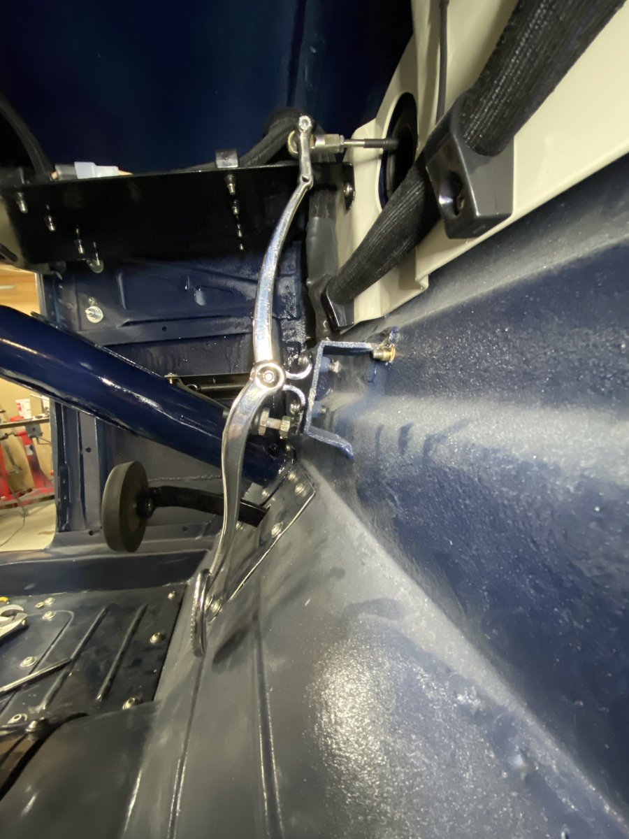

    Today the gas pedal and carb linkage finally all came together.
    I fabbed a little stop (with a rubber pad) for full throttle on the so cal stainless s**** pedal so that at full throttle it won’t over-stress and bend the mechanical linkages on the carbs or the 3/16”
    Stainless steel throttle rod that operates it all.
    I also learned that for reliable and smooth operation all 3 of the Strombergs need throttle shaft return springs and then the whole linkage also needs a good double return spring.
    I had the throttle tie wired wide open for the adjustment of the stop and then tested it all.
    Smooth and no sticking spots from idle to wot and back :cool:
