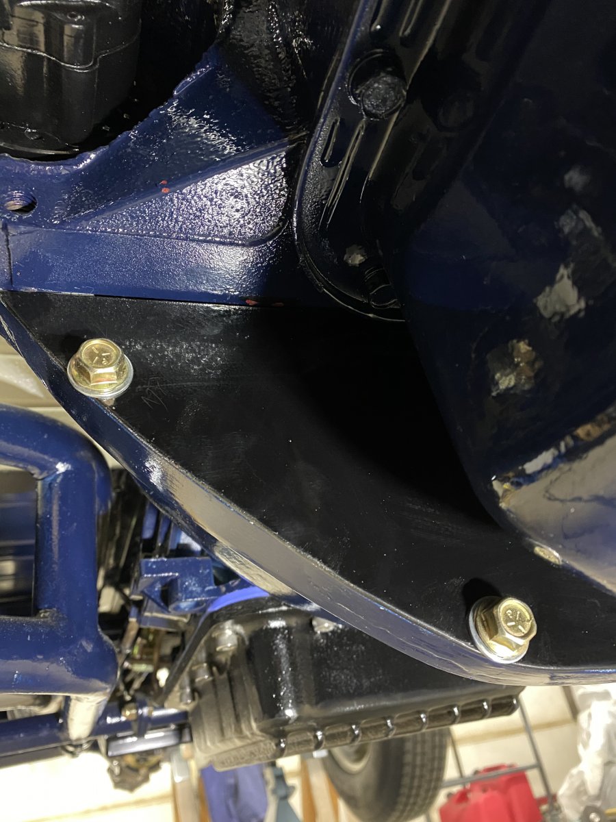

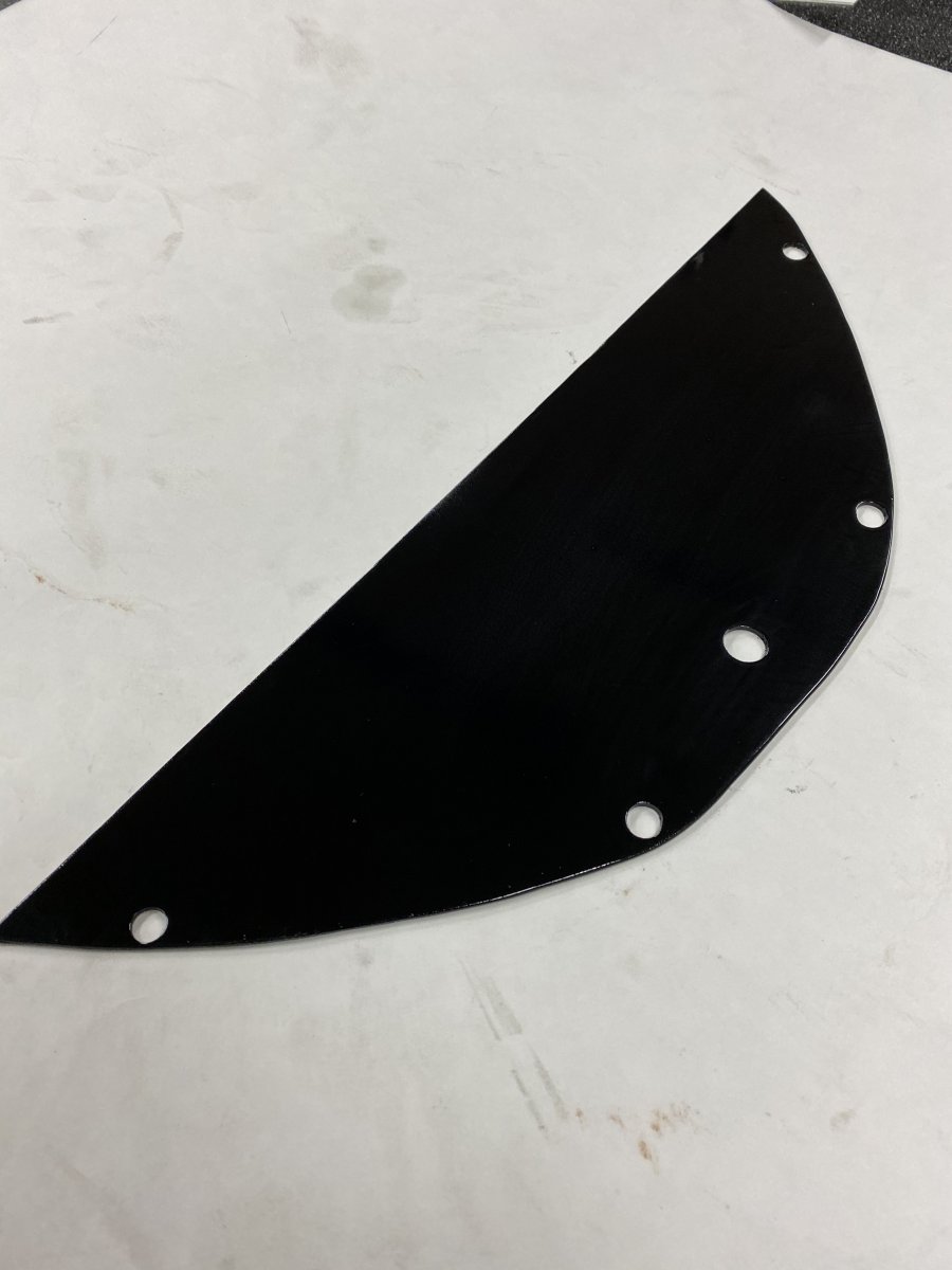

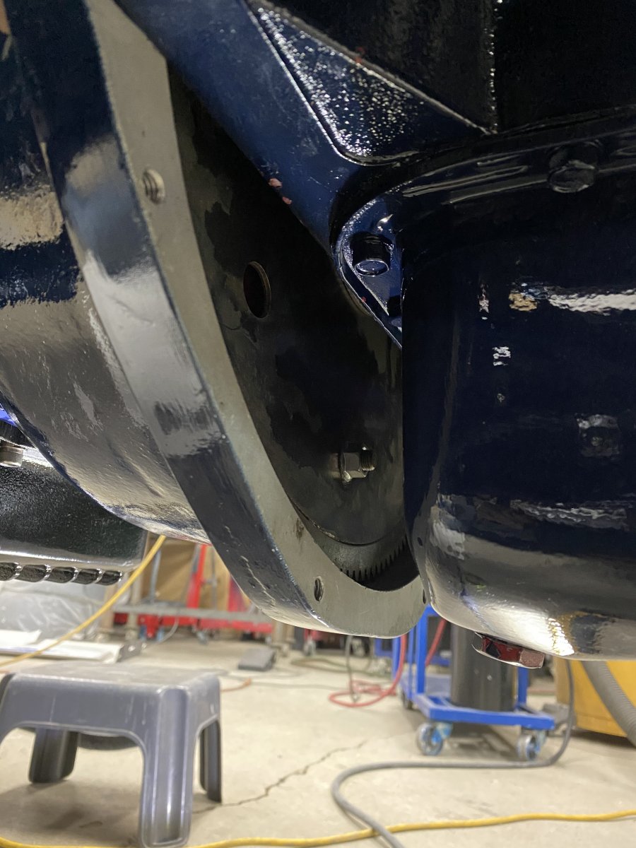

    So today I took care of another little item on the list.
    The bottom of the bell housing/ adapter needed a cover for the flex plate/ring gear.
    So I cut one out and painted it and then bolted it in place.

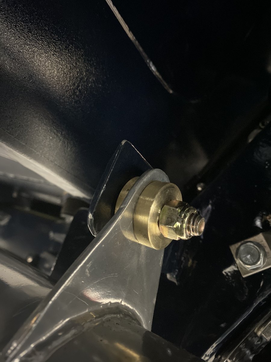

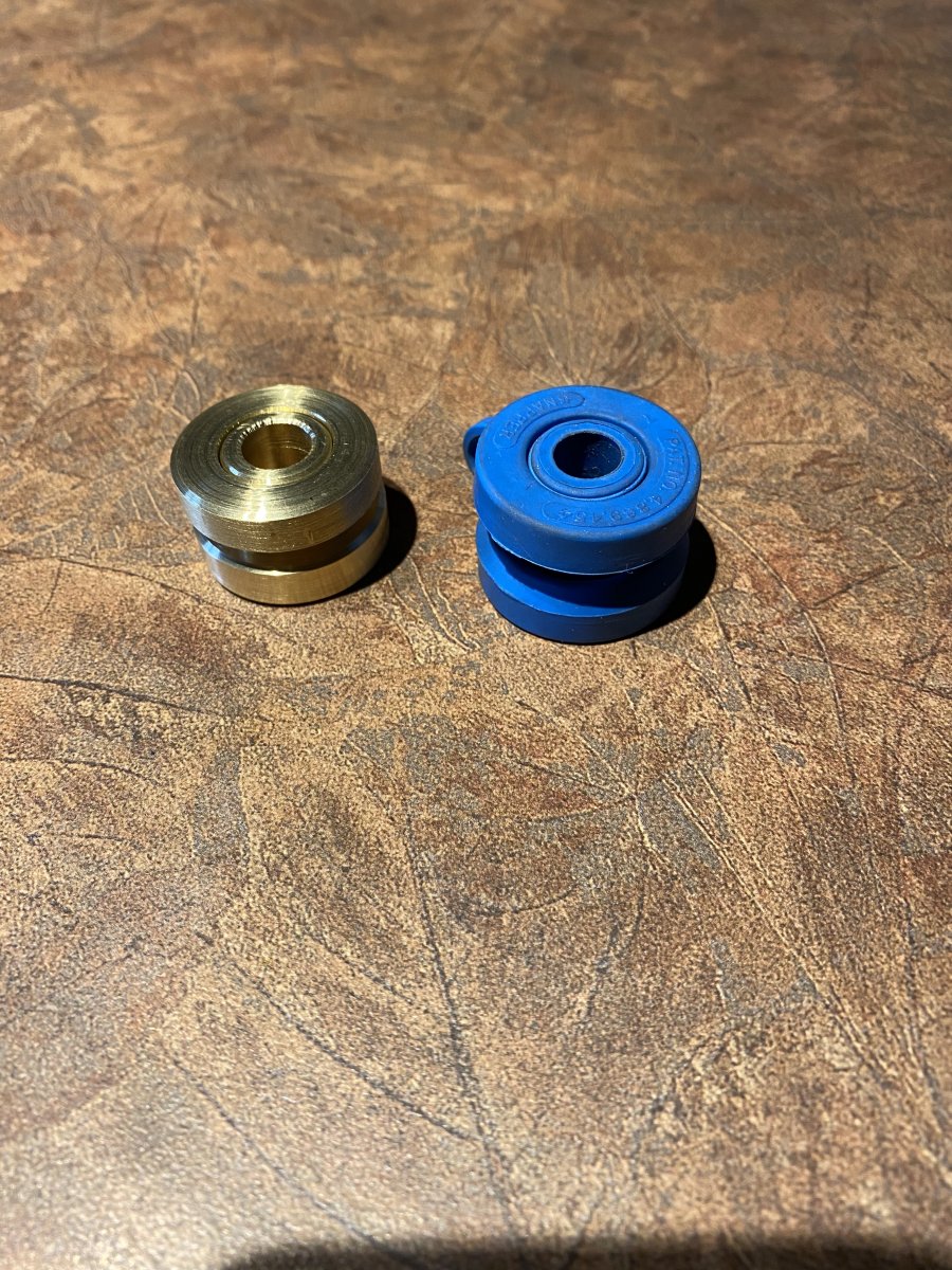

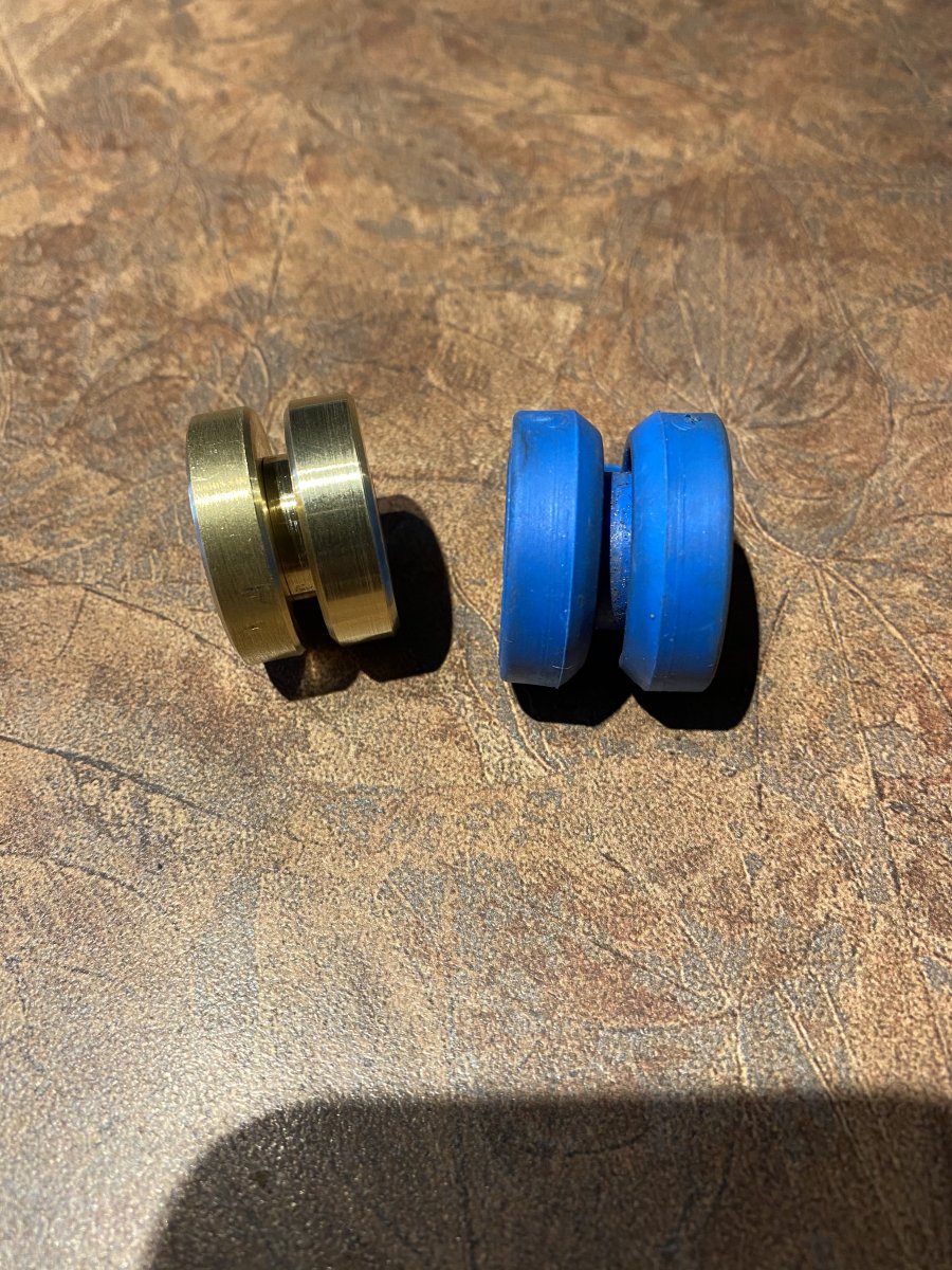

    Muffler grommets :D
    Not quite muffler bearings but close :D

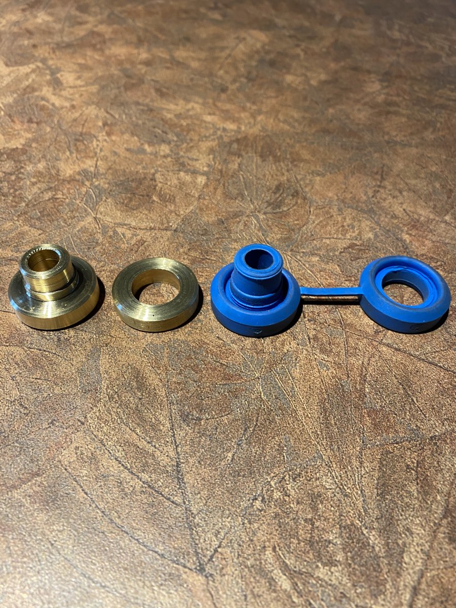

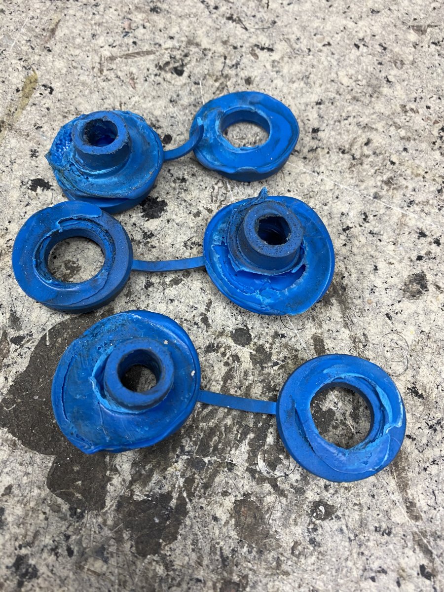

    You may recall that on my exhaust system I incorporated a hanger at each end of my Porter mufflers.
    In doing so I used the commonly used exhaust hanger grommets that sandwich the bracket and are mounted on a 3/8” bolt.
    They work good and look good however I have discovered that in locations like directly above the mufflers that they are less than ideal.
    Why you might ask?
    Because they melted :eek::(:D
    The two at the rear of my exhaust system are fine being hangers on the pipe portion of the exhaust system.
    They don’t get as hot as the mufflers.
    The grommets are available in black (low temperature) and blue (high temperature)
    and I used the blue.

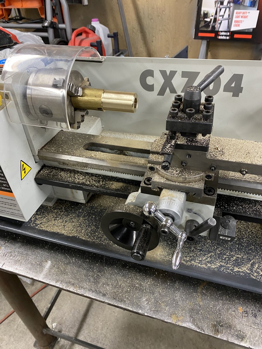

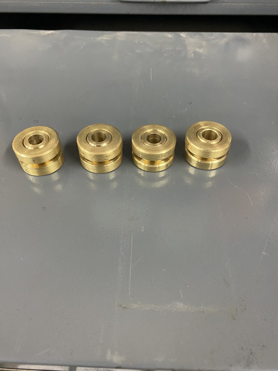

    Since the grommets mount the exhaust pretty solidly to begin with my solution was to break out my lathe and machine some br*** grommets.
    They work fine.
    Before you get excited about the solid mounting I will point out that my buddy with the 27 RPU has had his exhaust bolted tight with metal to metal hangers due to clearance issues and his system works great and has for over 20 years now with no problems.

  20. bobbytnm
    Joined: Dec 16, 2008
    Posts: 1,808
    bobbytnm
    Cool
    I guess if flex as an issue you could always had a piece of this stuff in there somewhere
    loudbang, 26 T Ford RPU and Blue One like this.
  21. Blue One
    Joined: Feb 6, 2010
    Posts: 11,512
    Blue One
    from Alberta
    I can add one of those on each side if need be. There’s a spot just inboard of where my pipes p*** through the frame rails where they would fit provided they were about 6” long and not too large in the O.D.
    I’m going to keep an eye on it but I may not have to do anything.
    loudbang, Six Ball and 26 T Ford RPU like this.
  22. Tim
    Joined: Mar 2, 2001
    Posts: 20,318
    Tim
    from KCMO
    I doubt you’ll have any issues. Nice fix
    loudbang and Blue One like this.

    Maybe you could find a high temp rubber bolt for the br*** grommets?

    Or, spring mount them like gas engine big trucks use to be (like radiator spring mounts; but sideways).

    I’m in agreement with that.
    o_O :rolleyes: :D I don’t think so :D
    I really believe none of that will be necessary.

    I agree, I don't think you'll have any problems with the current set up.
    Run it and forget it...woohoo

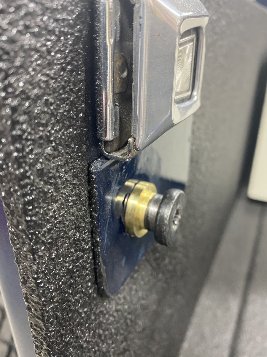

    So I finally finished with the exhaust system mounts and then found something else to machine.
    There’s always something more to do on this project.

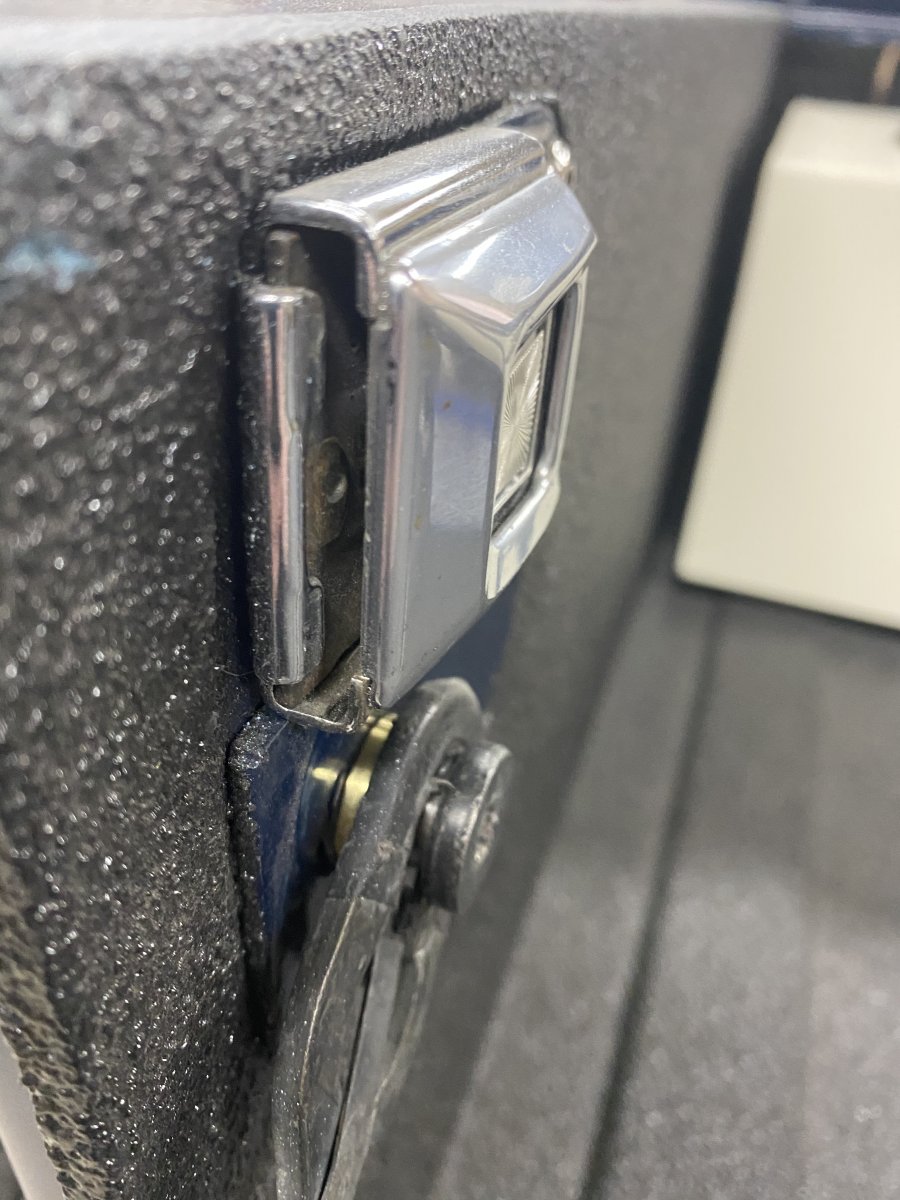

    I had discovered previously that the shouldered bolts for the tailgate cables would not allow the cable to rotate on them when closing the tailgate.
    If the bolts were tightened then they snugly grabbed the ends of the rubber coated cables.
    So I machined a couple of shouldered washers to solve the problem.
    Now they work as they should. :cool:
    Details :D
