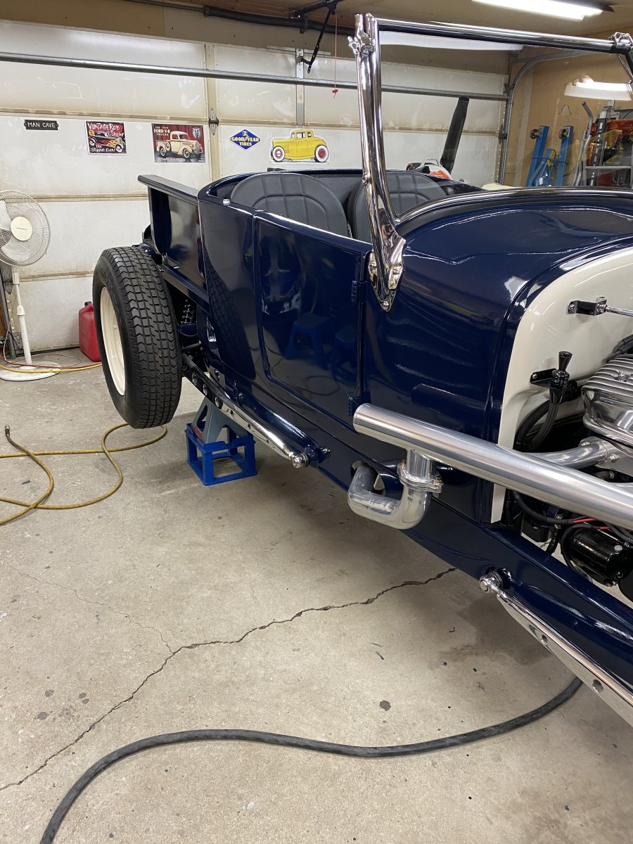

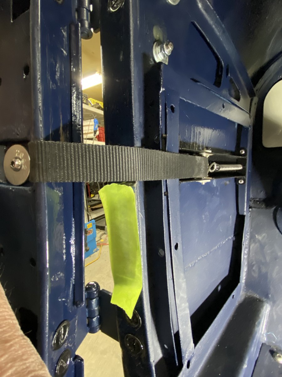

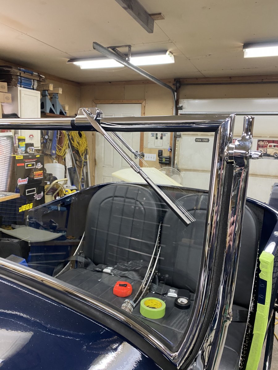

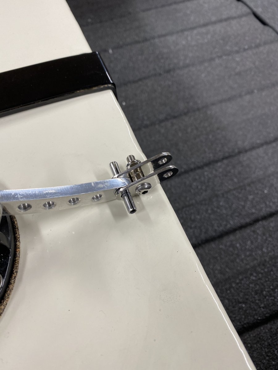

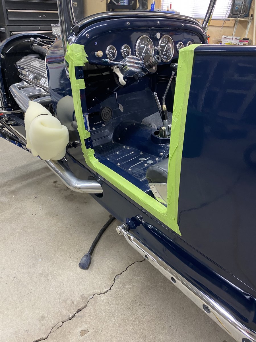

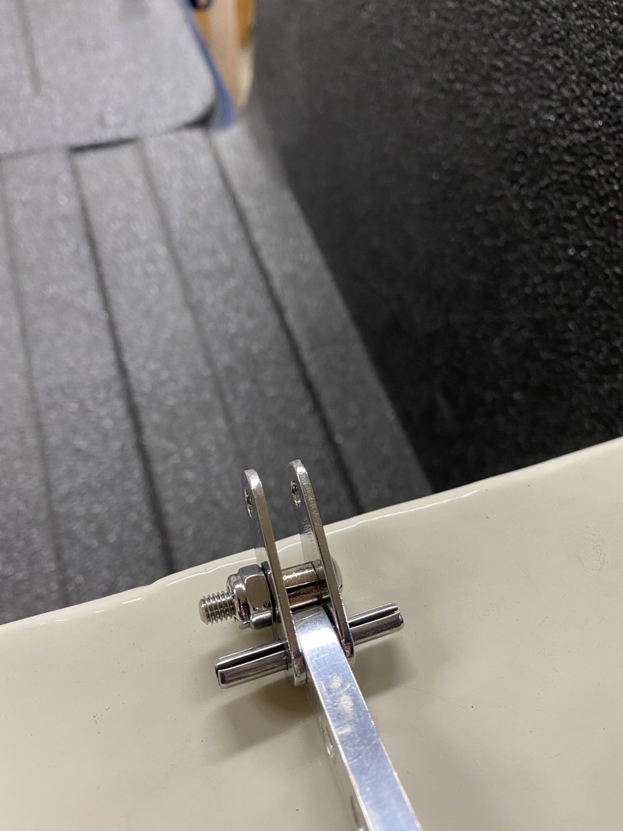

    Doors are going on. And a temporary windshield wiper for inspection. :cool:
    And also a couple of pictures of the retractable door check straps finished too.
    8D2DB356-E200-4BF3-B601-02202DB9559F.jpeg 92C90AE5-E020-4D45-9278-FB8603FEF68E.jpeg E9173800-D2D1-4C29-B99C-C7108FA031C4.jpeg BE8B9629-1115-4ED7-81E5-5F95F8B8434E.jpeg 96741F15-8B4A-4B2E-A17B-CB4CBF33204C.jpeg 29F014E0-BF4E-4966-BB79-75F2FDB85C2F.jpeg 827E598A-DA5C-49B1-A8A4-D7B56C5F429B.jpeg
    Lil'Alb, fiftyv8, The 39 guy and 12 others like this.

    P***enger door is on and opens and closes as nicely as the driver’s door.
    Getting so close to inspection ready I can actually see it :cool::D
    I have some nice ribbed closed cell foam weatherstrip to install around the doors and also the mirrors have to be installed.

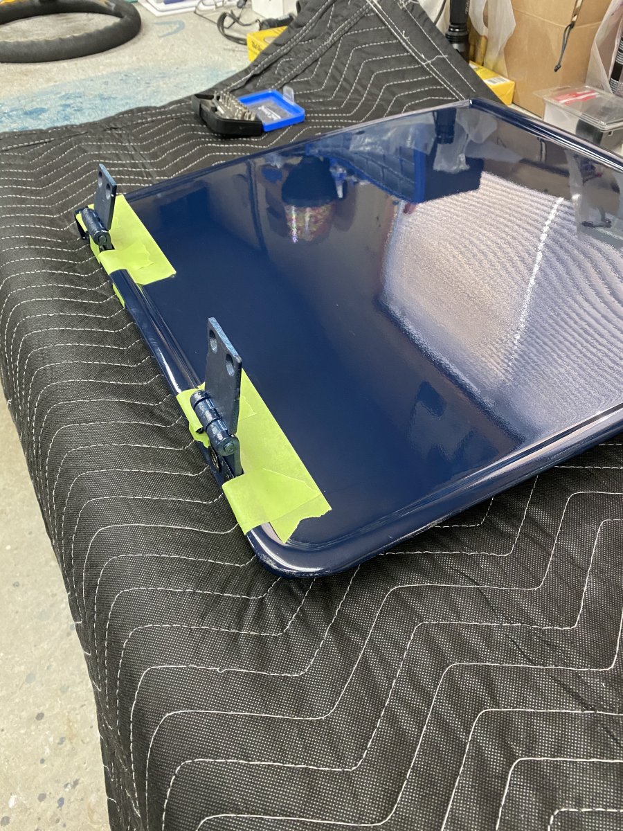

    Went out to the garage and took a look at the doors.
    The plan was just to look for today ;):D
    Oh no, the fit around the outer flange where they overlap the body was not good.
    Too much in places and then too close in other places that would lead to chewed up paint when driving :eek:
    What to do ?
    A couple of hours of terror :D
    Tape the edges of the doors with about 4 layers of masking tape and then proceed to pry and m***age the door flanges using a taped up flat vice grip sheet metal tool for bending in and a soft blow hammer for adjustments when the flange had to be moved out a little bit.
    Where was the terror? We’re talking about finished painted doors. :eek:
    Thank God for the toughness and durability of acrylic urethane paint.
    It all went well, no paint damage or unwanted dents cracks or wrinkles :cool: Whew! :D
    Now once the weatherstrip is on they will be snug and secure.
    It tells me that I probably should have fit them better but honestly I think that’s how it goes sometimes after bodywork and paint.
    They seemed to fit well beforehand.

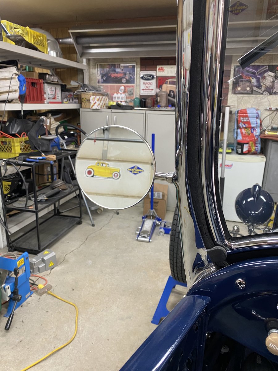

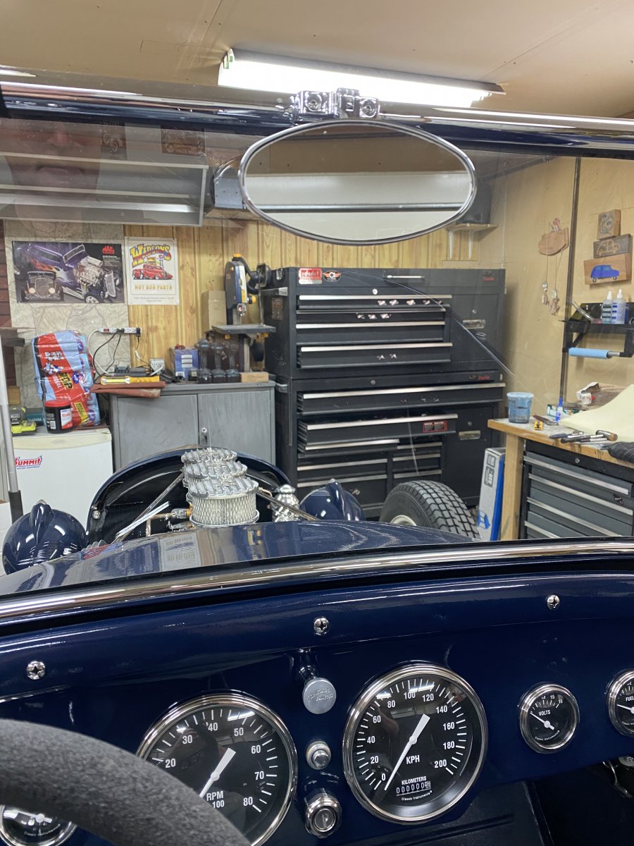

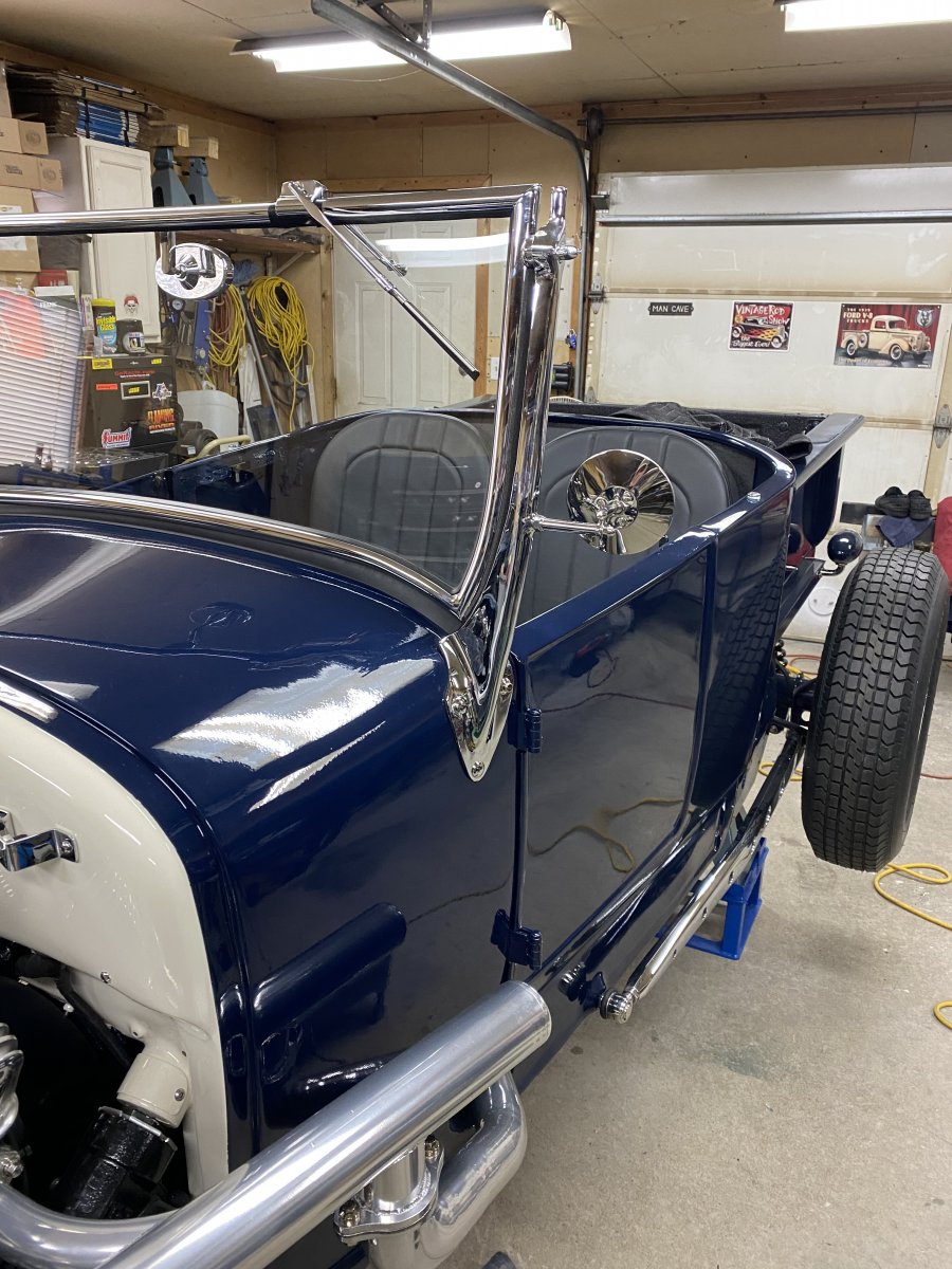

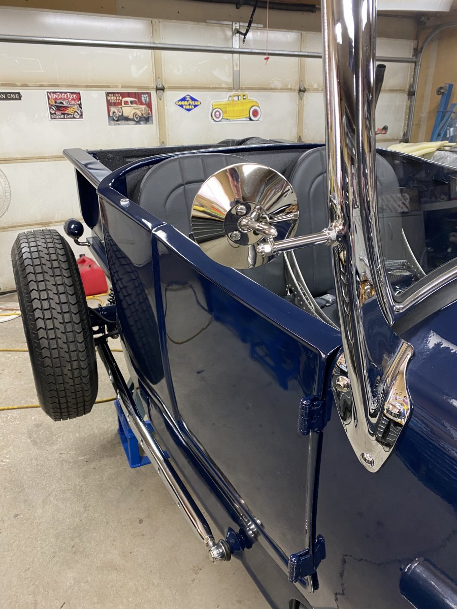

    Spent some quality time in the garage today and installed the mirrors.
    Oval rear view and 2 Brookville chopped 32 mirrors that I welded bungs into the windshield posts for before I had them chromed.
    Then I sat in the driver’s seat for a little while.
    Once the snows gone I’m ready for inspection :cool:
    Pictures of the view out the windshield and the mirrors too :D
    73DA6B61-83CA-4AE4-825C-6CDFB44925C2.jpeg 753B33CD-CC99-4F99-87C7-6578BEEF1B9A.jpeg DE42FB9B-31CF-40C5-8002-C9A0752B2D0E.jpeg 1F9BFB99-4C71-4DBC-A7DF-D2E8DAD2F46B.jpeg

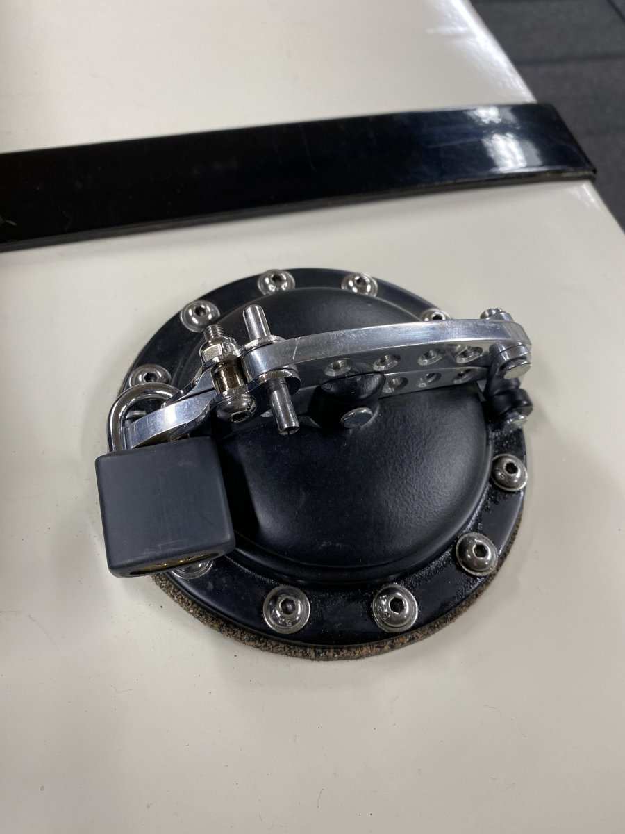

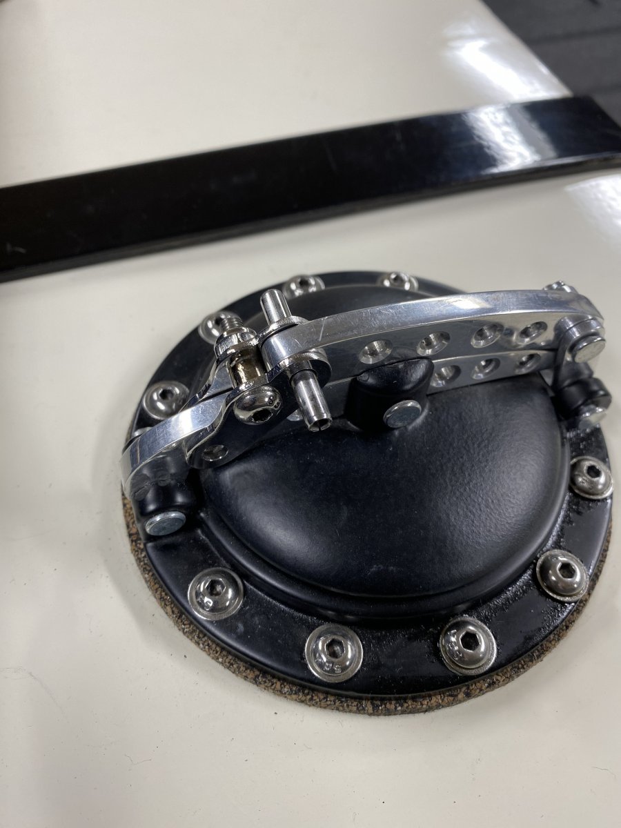

    So today I took a look at my gas cap.
    I wanted to come up with a way to lock it so I made a couple of little stainless steel plates that go over the roll pin that serves to open the cap.
    A little stainless tube spacer to allow it to pivot when bolted snug with a stainless 10/32 machine screw and a nylock nut.
    Then a small padlock covered with shrink tube does the locking duties. :cool:

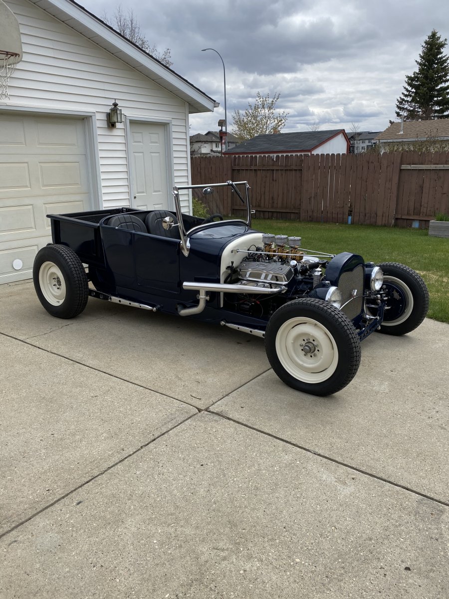

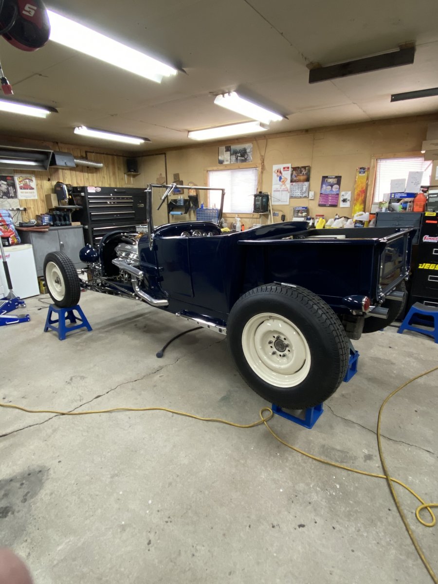

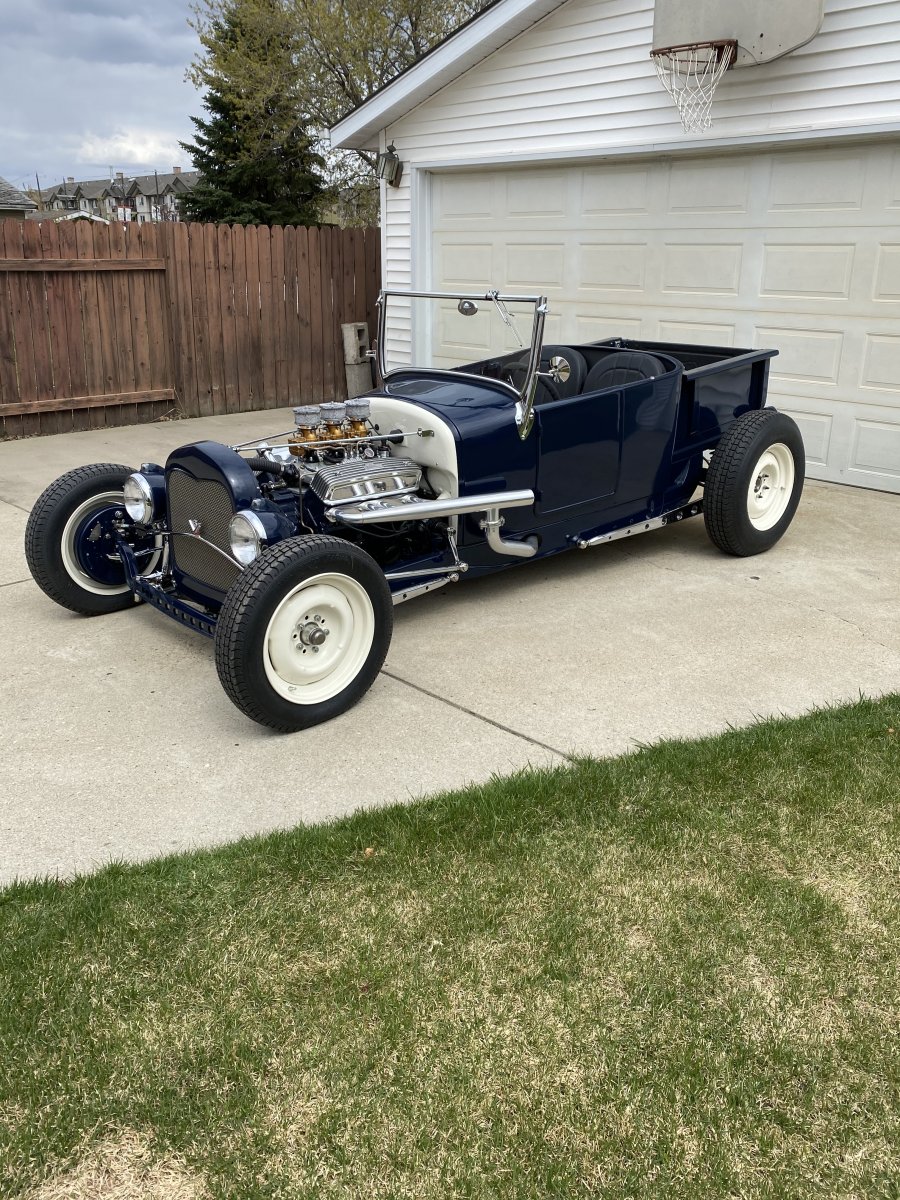

    I had it outside today for setting up the tire pressure and tightened the lug nuts.
    Warmed it up and drove it forward and back down the driveway :cool:
    I’m going to have to do some adjustment on the brakes but that’s to be expected.
    Backed it back into the garage.
    Inspection appointment is set.
