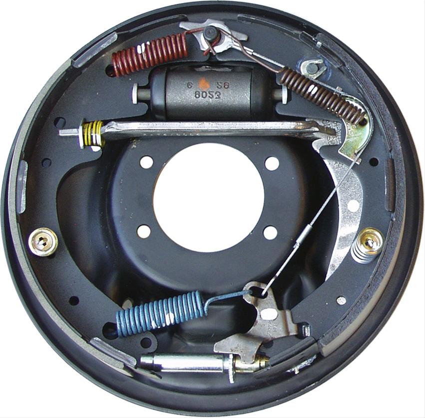

    During the brake adjustment I looked at a problem I’ve had with my rear brakes that existed since they arrived with my quick change.
    They’re new 11” loaded drum brakes from Currie.
    I couldn’t seem to get the self adjuster arm for the left side (drivers side) to contact the Star wheel so that it would work properly.
    The right side was fine and worked well.
    Finally I decided that somehow it didn’t look right, it looked poorly stamped and deformed and dimensionally wrong.
    I picked up a Raybestos self adjuster repair kit and installed it. Perfect :cool:
    Comparing the new piece to the one that came with the left brake it was obviously a manufacturer defect. But it’s fixed and only cost me $20 :D
    Brakes are adjusted now and should be much better.

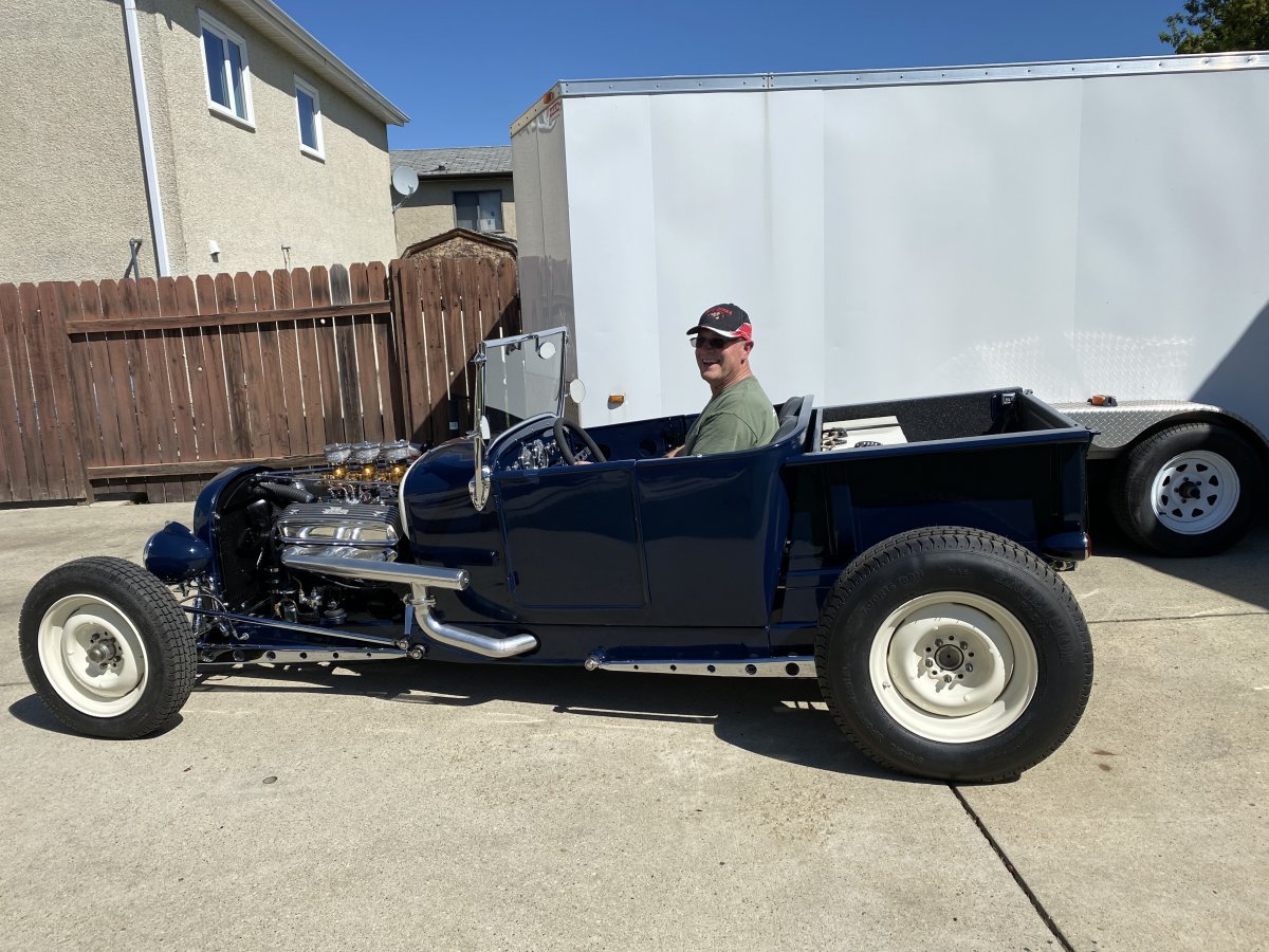

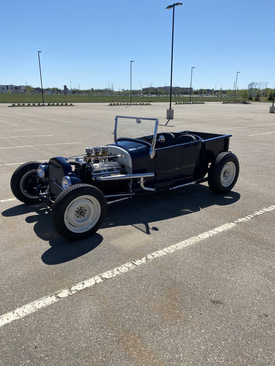

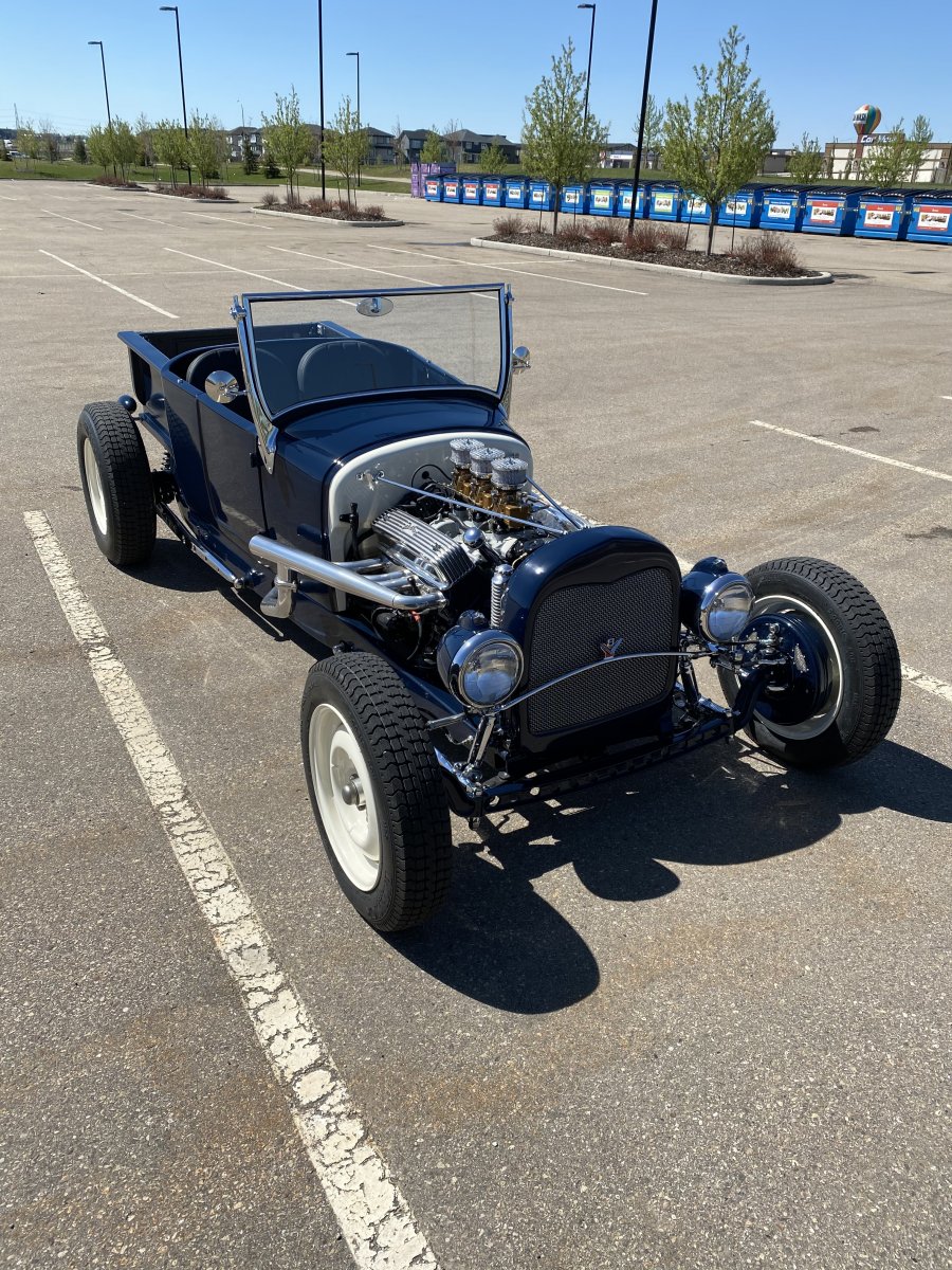

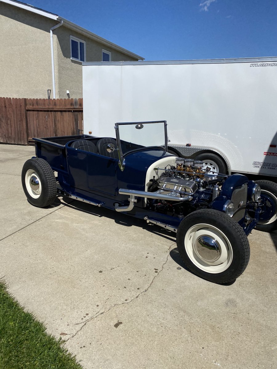

    Thanks guys. I’m over the top happy with my adventures today.

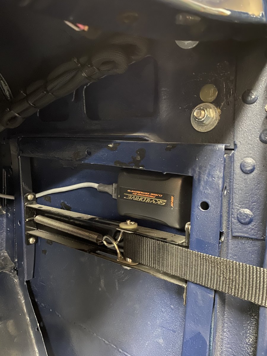

    First I plugged in my GPS speedometer sky drive antenna module ( Cl***ic Instruments) and did the simple calibration.
    After that I stuck it on the inside of the body just under the dash on the p***enger side with some 3M mounting tape and when the upholstered kick panel is in place it will be hidden out of sight and protected from the weather.
    Then I tightened the lug nuts and took it out for a short test drive and came back home.
    Adjusted the idle and added a little more transmission fluid.
    Also had to replace the connector to the brake light switch which wasn’t making good contact.
    After that I headed over to the other side of the city to visit my buddy Dave.
    Wanted to show him the finished car.
    He loved it.
    I’m really pleased with the way it drives.
    No wobble no bump steer at any speed.
    The Excelcior radials are really good and it handles like it’s on rails.
    We got the alignment right on judging by the way it’s handing.
    The suspension front and rear work really well and the ride is better than I thought it might be.
    I had it rolling along the ring road hiway heading to Dave’s place at 120 KPH.
    No problem at all smooth and steady.
    The quick change is loud like I knew it would be, between wind exhaust and that ear plugs
    are required for the hiway.
    Overall it has come together as a great little hot rod.
    I may try a set of helical gears in the quick change just to see what they’re like.
    I can’t stop smiling. Put 65 kilometres on it. :cool::)
