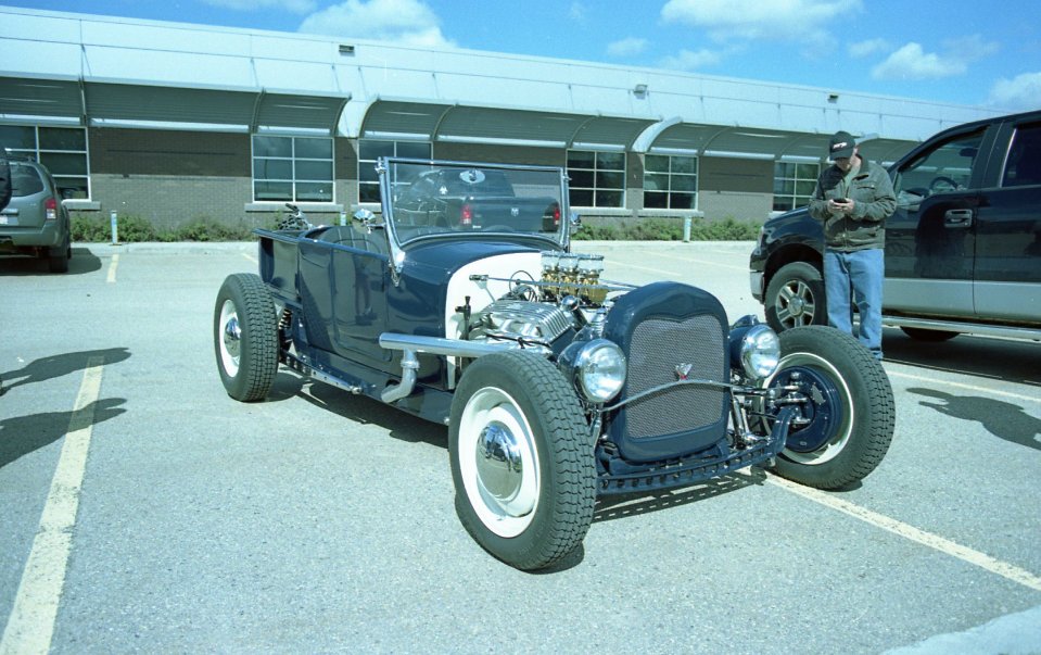

  10. Blue One
    Joined: Feb 6, 2010
    Posts: 11,512
    Blue One
    from Alberta
    I had the RPU out to a little gathering of friends and one of them snapped a few pictures with 35 mm film.
    Definitely a different look to digital pictures.
    Funny how soon you forget things from your earlier life :D
    I got my helical gears and the parts to replace the input seal and O ring there’s a tiny little leak probably the seal dried out while it was sitting dry during construction and being rolled around too.
    I’m standing there trying to find a picture to show one of the guys :D
    Stogy, mctim64, loudbang and 9 others like this.

  12. loudbang
    Posts: 40,346
    The V-8 emblem on the crossbar was an inspired touch. In that photo if it wasn't put on there would be a lot of open space. :)
    Six Ball and Blue One like this.

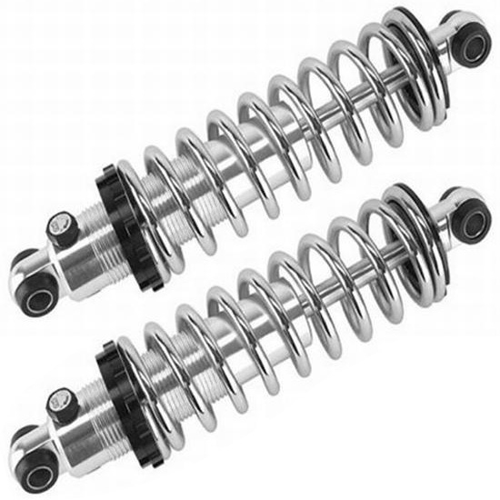

  18. Blue One
    Joined: Feb 6, 2010
    Posts: 11,512
    Blue One
    from Alberta
    Driving around yesterday enjoying the day rather than changing gears in the quick change, I finally decided that the TCI All American coil overs are gonna be replaced.
    When I bought them I did so because they were new on the shelf at the local rod shop and they were a good price.
    I suspected that they would be a little stiff with 250 lb springs and they aren’t adjustable for dampening or rebound.
    So, I’m going to head out to a weigh scale and weigh the car and then weigh the rear weight by itself sitting 1/2 way on the scale.
    Then I can call QA1 and get a recommendation on the right spring rate.
    I’m probably going to order a pair of these
    https://www.speedwaymotors.com/QA1-Adjustable-14-Inch-Coil-Over-Shock-Kit,39192.html
    As for the helical gear swap I’ll probably get to it later today because it’s raining :D
    Besides swapping the gears, I also have to replace the input seal and o ring as there’s a tiny leak probably from a dried out seal sitting dry during construction.
  19. GearheadsQCE
    Joined: Mar 23, 2011
    Posts: 3,670
    GearheadsQCE
    Alliance Vendor
    Larry,
    You might want to check how much the spring compresses now. Along with the rear weight QA1 can probably dial you in darn close.
    I had a Corvette drag car that was pretty light in the rear. Wound up with 110 lb/in springs. I'm guessing yours will be pretty close to that.
    While you have the yoke off to replace the seal, make sure you put RTV on the splines, under the washer and around the lower shaft bearing. That darn gear lube can find it's way out through the tiniest gap.

    Joined: Feb 6, 2010
    Posts: 11,512
    Blue One
    from Alberta
    While out driving around the other day I hit a couple of bridge expansion joints at 60 mph and the rear bottomed out on my bump stops.
    I originally had 3 1/2” of clearance travel there and now it’s 2 3/4”.
    I have room to move everything up through spring preload adjustment as they’re at the bottom of the threads on the collars now and they are also on the bottom of the 3 holes in my lower shock mounts.
    That won’t solve the harshness though because the springs at 250 pounds are not giving me the compliance that I think they could with a better spring rate.
    The rear is jumpy even over regular road joints and normal pavement flaws.
    On top of that the QA1s have the adjustable dampening that isn’t there now.
    The TCIs are 13 1/4” mounted at ride height the QA1s are 14” so I’ll gain a little there too.
    I anticipated having to do this once I had it on the road.
    loudbang, Tim and Stogy like this.

  23. 26 T Ford RPU
    Joined: Jun 9, 2012
    Posts: 12,594
    26 T Ford RPU
    Dont forget to take off the un sprung weight of the rear axle and wheel/tires from the overall rear weight.;) :) JW
  24. Blue One
    Joined: Feb 6, 2010
    Posts: 11,512
    Blue One
    from Alberta
    I’ll have to try to guess what that is.
    I could probably figure it out.
    The tech guy at QA1 or maybe even Winters might be able to help with that.
    loudbang and 26 T Ford RPU like this.

  28. Blue One
    Joined: Feb 6, 2010
    Posts: 11,512
    Blue One
    from Alberta
    So this morning I headed out to the weight scale and weighed the hot rod.
    With me sitting in it the scale said 2600 pounds so 2400 without me :D
    That’s with a full tank of gas too.
    I then rolled ahead and got the rear weight sitting 1/2 on and 1/2 off the scale.
    The scale said 1433 pounds. Again with me sitting in the car.
    I called the QA1 tech line and had a really informative chat with the tech guy.
    We talked about my present TCI shocks and their shortcomings and then using my numbers and details on my RPU he was able to tell me what I needed.
    He said that the 14”( Mounted length at ride height) shocks with single 18 position adjustment was the right choice.
    They provide a 5” total range of compression and rebound where the TCI shocks only have 3”.
    Based on my numbers and allowing another 200 pounds for various p***engers he determined that a 150 pound spring rate was what would be needed.
    Quite a bit less than the TCI which have 250 now.
    So, a visit to Summit racing online and the order is in :cool:
    loudbang, AndersF, Tim and 5 others like this.
  29. Dick Stevens
    Joined: Aug 7, 2012
    Posts: 4,126
    Dick Stevens
    Now to determine if you hit the bump stop or hit the bottom of travel in the TCI shocks!
  30. Blue One
    Joined: Feb 6, 2010
    Posts: 11,512
    Blue One
    from Alberta
    Maybe both :D There are definitely bump stop marks on top of the axle tubes.
    I’ll gain some room and better ride control with the new QA1s
