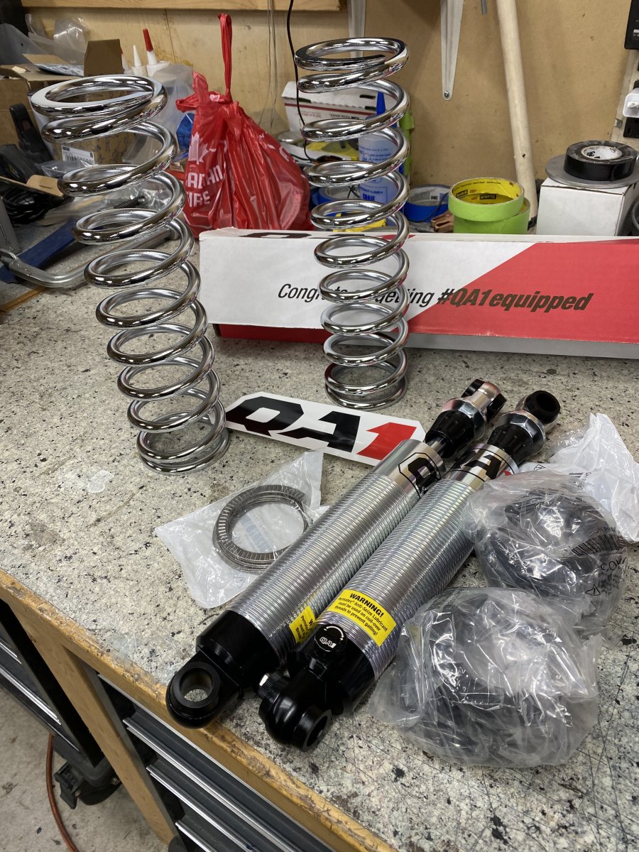

  5. GearheadsQCE
    Joined: Mar 23, 2011
    Posts: 3,670
    GearheadsQCE
    Alliance Vendor
    I'd call QA-1 back and at least ask about the progressive rate. If you've bottomed out a 250, that 150 might be too light. I believe that having an adjustable shock will slow everything down and hopefully not allow bottoming out, but it costs nothing to ask.

  6. Blue One
    Joined: Feb 6, 2010
    Posts: 11,518
    Blue One
    from Alberta
    Done, another call this morning and we discussed the merits and shortcomings of progressive springs.
    He didn’t think that for my application that they were a good choice.
    He was confident that the adjustable shock with the 150 springs would work.
    I’m going to be gaining travel from the longer travel of the shock and the longer at ride height mounted length.

  8. Blue One
    Joined: Feb 6, 2010
    Posts: 11,518
    Blue One
    from Alberta
    Yes that’s true enough. If I’m not happy with the results I can always try another pair of springs maybe 175 pounds.
    Springs are the cheap part of the whole deal at $60 each.
    I’m going to trust him for the first go, they work with this stuff all the time.
    I’m looking forward to not having my spine compressed every time I encounter a few bumps.:D
    I don’t expect a perfect ride after all it’s a hot rod however the rear suspension should be able to smooth out some of it :D

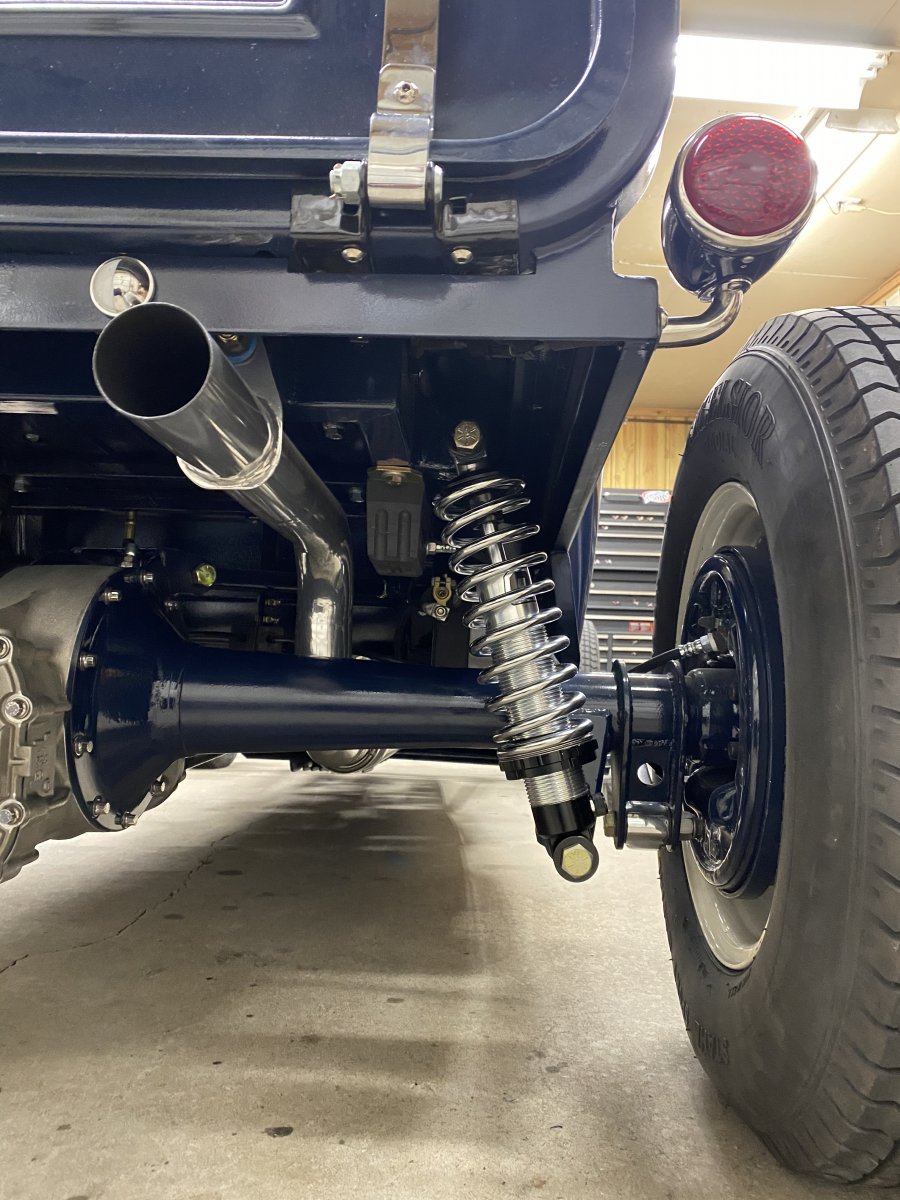

  13. atch
    Joined: Sep 3, 2002
    Posts: 6,431
    atch
    blue,
    The only place I've ever seen coil overs is actually installed.

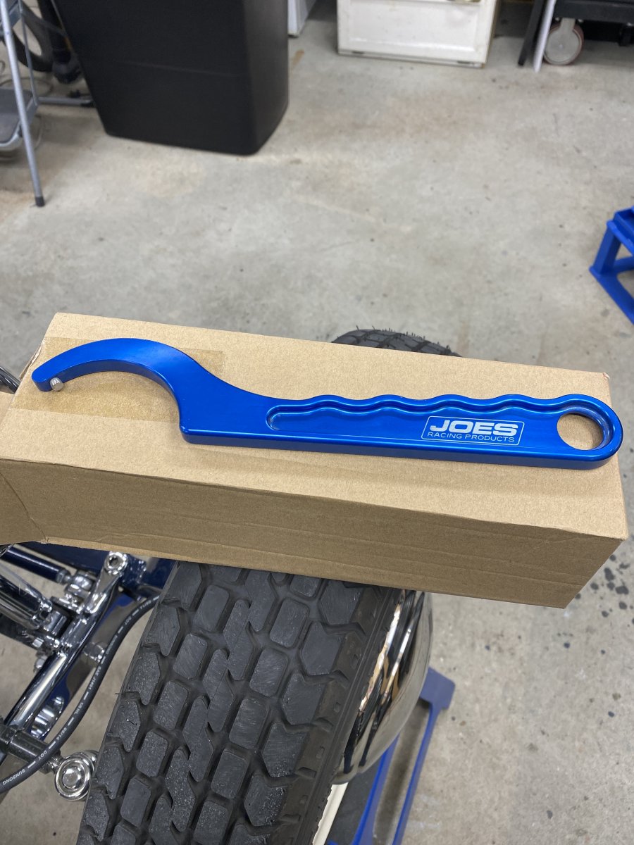

    1. Do they come with a spanner to adjust with?
    2. Do you have to get the weight of the car off of them before adjusting?

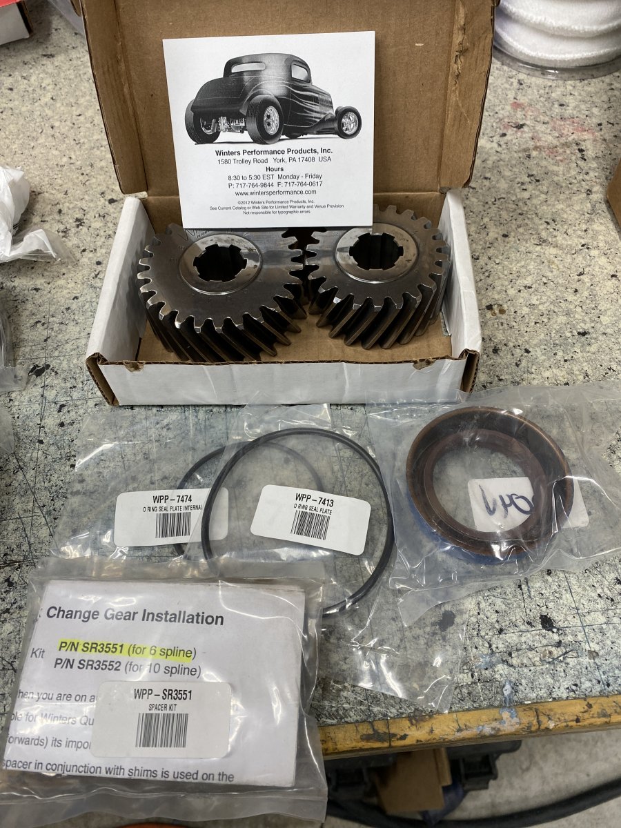

  14. 26 T Ford RPU
    Joined: Jun 9, 2012
    Posts: 12,618
    26 T Ford RPU
    What is your Winters ratio and can yo flip the new rears and go racing? JW
  15. Blue One
    Joined: Feb 6, 2010
    Posts: 11,518
    Blue One
    from Alberta
    I bought a spanner wrench previously they don’t supply them.
    And yes they are easier to adjust with the weight off.
    I did install the needle thrust bearing set they recommend for the adjusters.

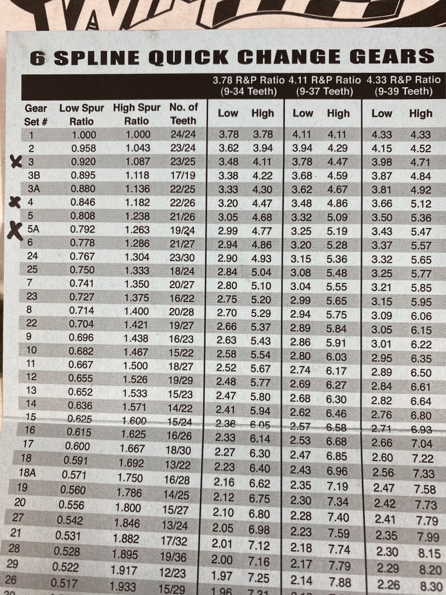

    My ring and pinion ratio is 3.78
    The ratio of the helical gear set I just installed is 3.19 for street driving, that’s with the large gear on the bottom and the small gear on top.
    If I swap them around I will have 4.46.
    I also have a selection of 3 different sets of straight cut gears so if I want to race I can easily pull the helical set and pop in a different set.
    I have the 3 sets marked.

  23. GearheadsQCE
    Posts: 3,670
    GearheadsQCE
    Alliance Vendor
    I'm sure that this has been beaten to death somewhere here already:
    A high numerical ratio is actually a lower gear ratio. Think of it this way; if you put the transmission in 'Low' it multiplies the torque, say 2 : 1. In traditional 'High' the ratio is 1 : 1. So, a 4.11 is lower than a 3.73.
    Just because Winters got it wrong and put it in print does not make it right.
    This bugs me because I was an Auto Shop teacher and spent a lot of time teaching kids to use the correct terminology.
    End of rant!
  24. Blue One
    Joined: Feb 6, 2010
    Posts: 11,518
    Blue One
    from Alberta
    You should call Winters and school them.
    Maybe they will change it. :)

  27. Blue One
    Joined: Feb 6, 2010
    Posts: 11,518
    Blue One
    from Alberta

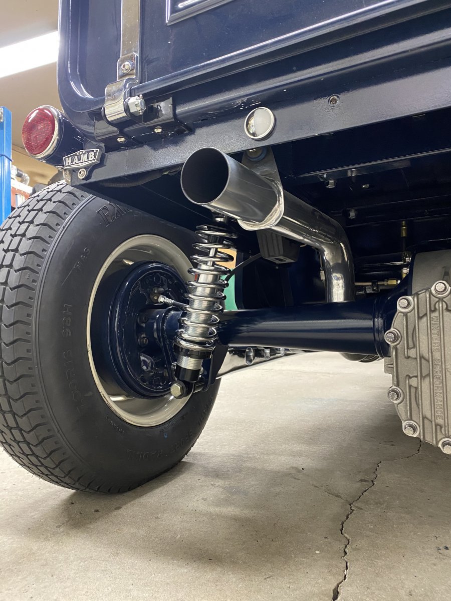

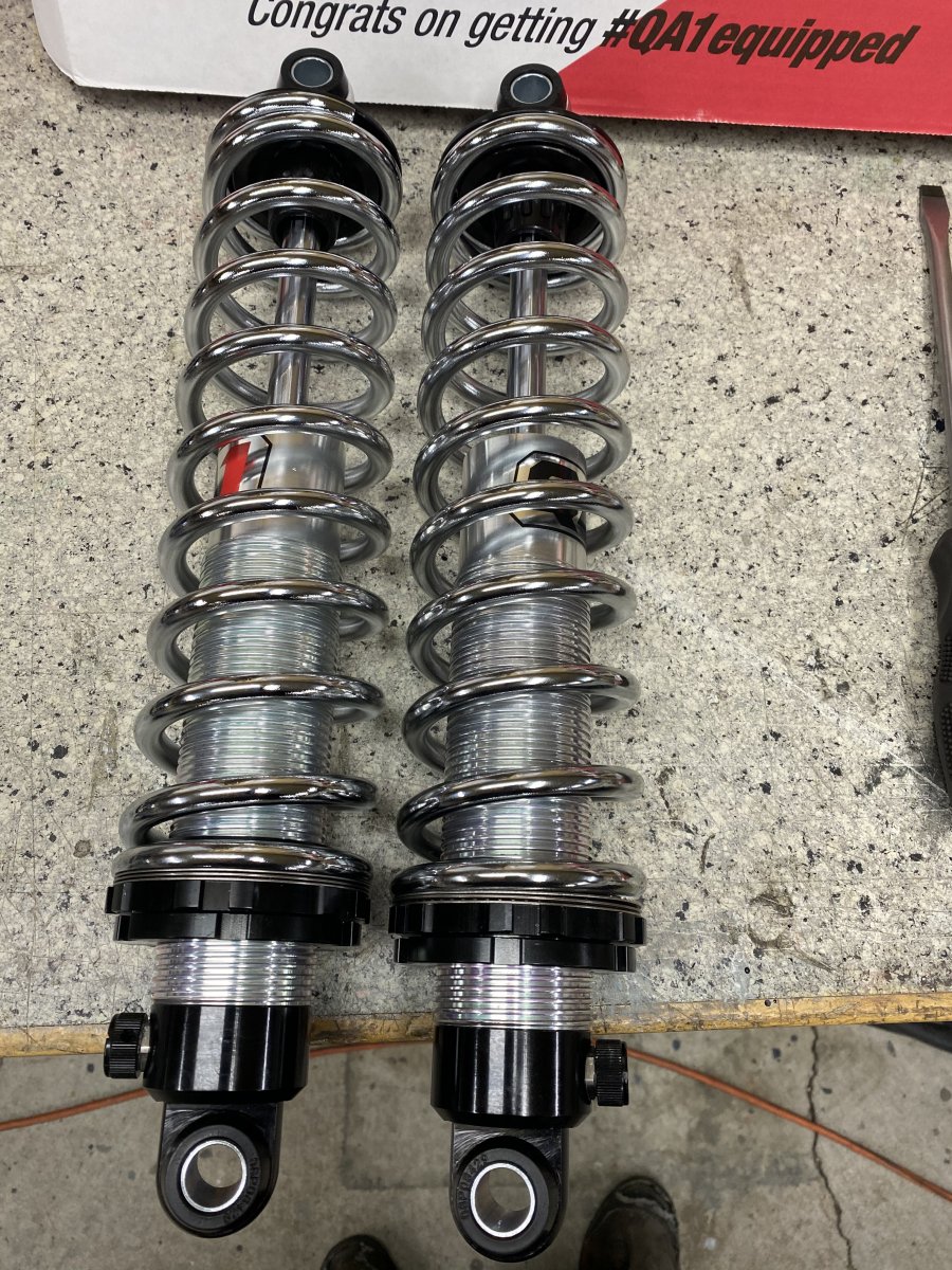

    Well the new coil overs are installed and I am really impressed and I haven’t even driven it yet. :D
    I have a feeling that they are going to be perfect.
    Point of reference. The TCI shocks with the 250 pound springs sat with a 13 1/4” length at ride height.
    Taking hold of the top of the rear tailgate and putting my whole weight on them I couldn’t bounce them :eek:
    With the QA1S adjusted to 14 1/4” eye to eye mounted length I gained that extra length and clearance and with the 150 pound springs I can actually make the suspension work :D
    The dampening adjustment is also going to be nice.
    I think it’s going to be really good. :cool:
    I’ll let you know when I get out for a drive.
