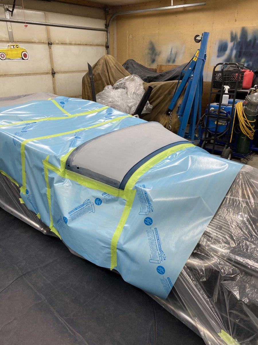

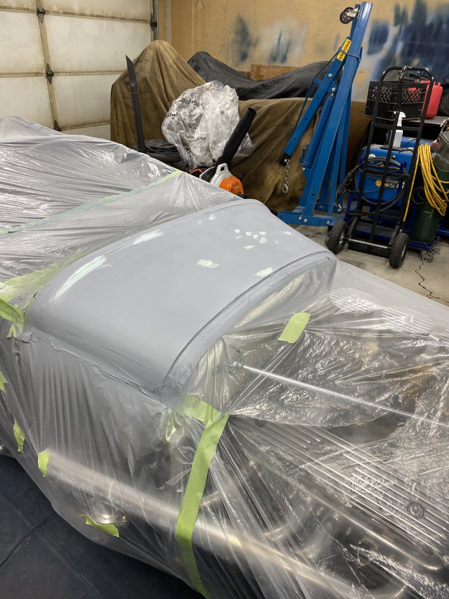

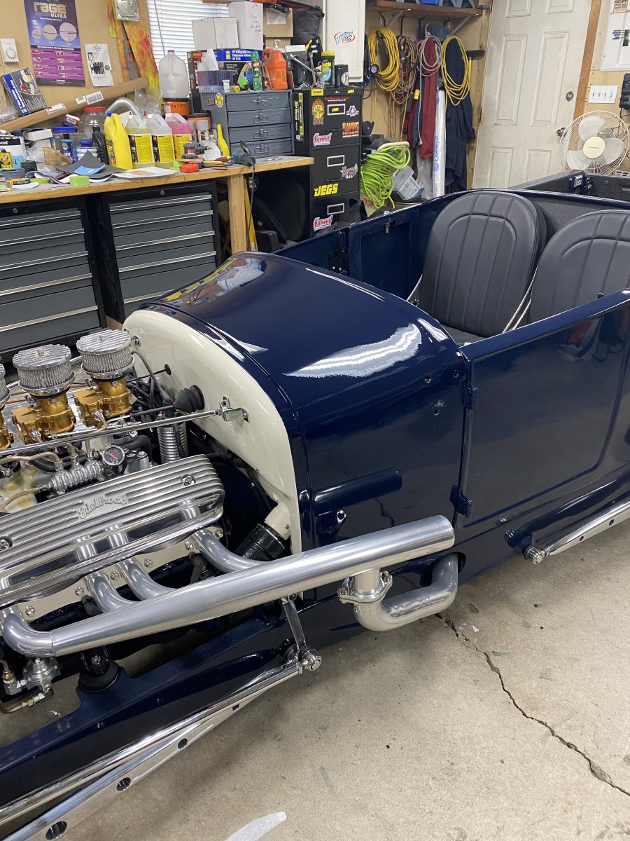

    Well the verdict is in on the helical gears and the new QA1 coil overs.
    I had the RPU out today after an interesting number of weeks.
    We finished with the shed project and then I was able to get my garage back.
    After that I spent a good week first of all removing the windshield and posts then wrapping the whole car up in poly.
    After that came stripping the entire top of the cowl to bare metal to fix an epic screw up and oversight that I knew was wrong from the beginning.
    During building the cowl suffered some damage to one side and on top of that I hadn’t really spent the proper amount of time with the metal work to get the proper finish.
    In my defence I knew better and should have paused and got it right however by that time I was suffering from bodywork fatigue as you may recall I had spent every day from early morning until late afternoon for the entire summer prepping for paint.
    So now it was time to get it done right I metal worked it for about 3 days hammer and dolly and borrowed stud gun and shrinking disc got it to the point where a skim of filler about 1/16” or less levels it out nicely.
    I put the skim of filler over the primer I shot after the metal work and when it was sanded down and blocked before the high build it was thin enough to see the gray of the primer through it with no burn throughs
    Then a little high build and some blocking and then paint.
    1A014EDC-D8D0-4BDE-A4E7-860D6F08146A.jpeg 6F0394AF-7BAA-410D-B5E7-B014B8D2618A.jpeg 604B4020-BA32-4F12-B58D-AB5D240C9D6F.jpeg A0B43E39-C5F2-4D94-99D5-35DF598D8882.jpeg 154299AB-B537-4A15-A24C-B513C09EB765.jpeg

  12. Stogy
    Joined: Feb 10, 2007
    Posts: 27,218
    Stogy
    @Blue One congrats on that putting that thorn in thy side to rest...The Force of Correction must have been Atomic...looks Awesome and great turnaround...Premium Cruise Weather Happening, Now get out and enjoy it...;)

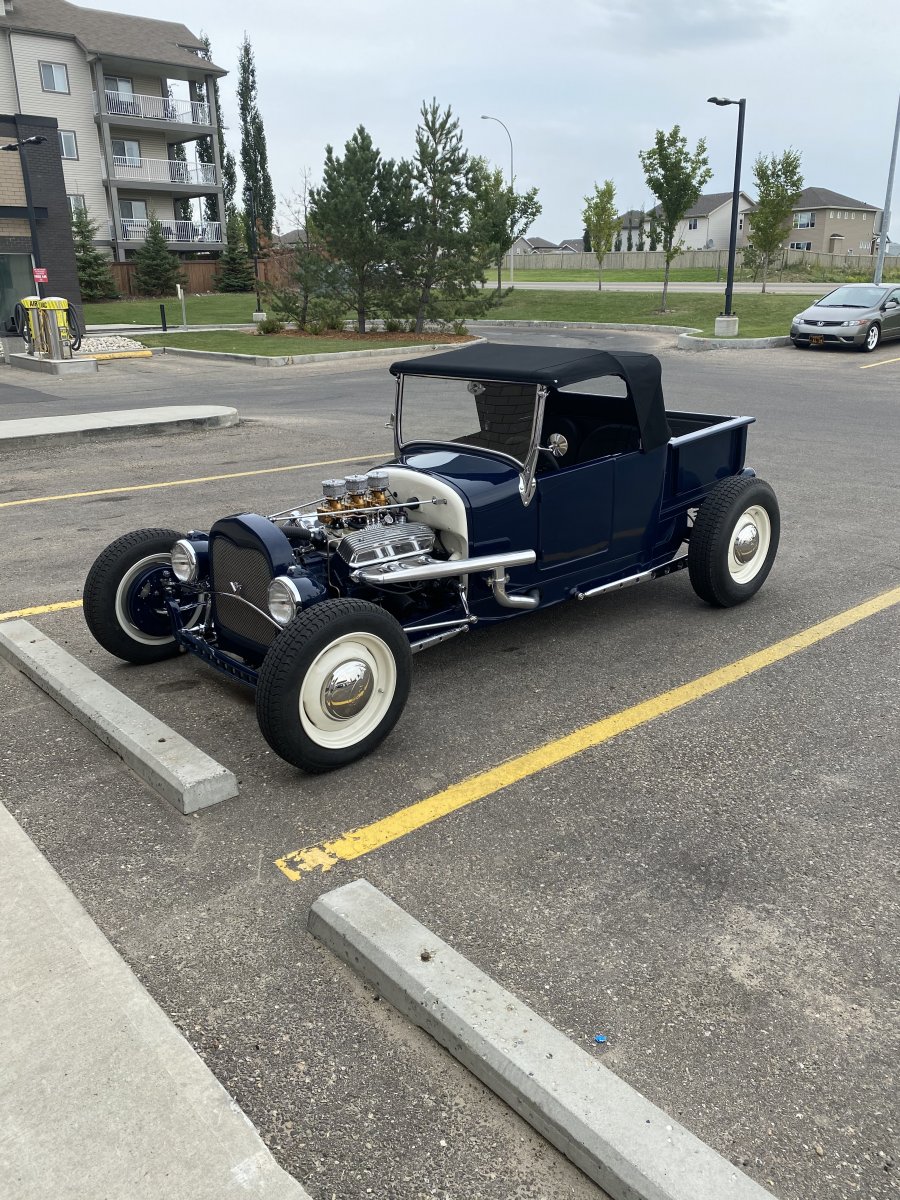

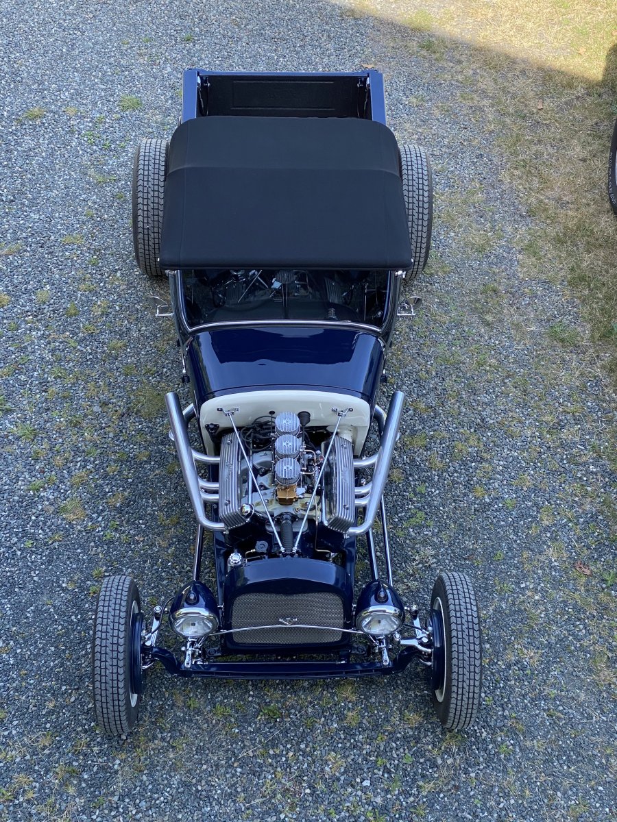

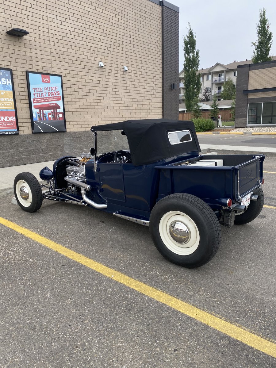

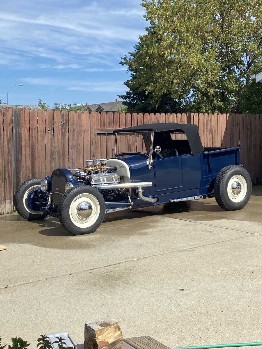

    After some time spent running around without the top, enjoying some open air and also being sun baked I dug out the top and put it on for the first time since paint and ***embly.
    As you know I’ve been sorting out some small stuff getting the rear suspension and other things dialed in so now that everything works it was time to put the Rod Tops top into action.
    Driving over to my buddies place today it proved to be a great top.
    No issues at hiway speeds even driving over the limit ;) :D
    AC9693F7-9243-49FC-A8AC-95D876F1B254.jpeg E3AA5DDD-3A36-4A97-A81F-5788BFAB0CE3.jpeg
