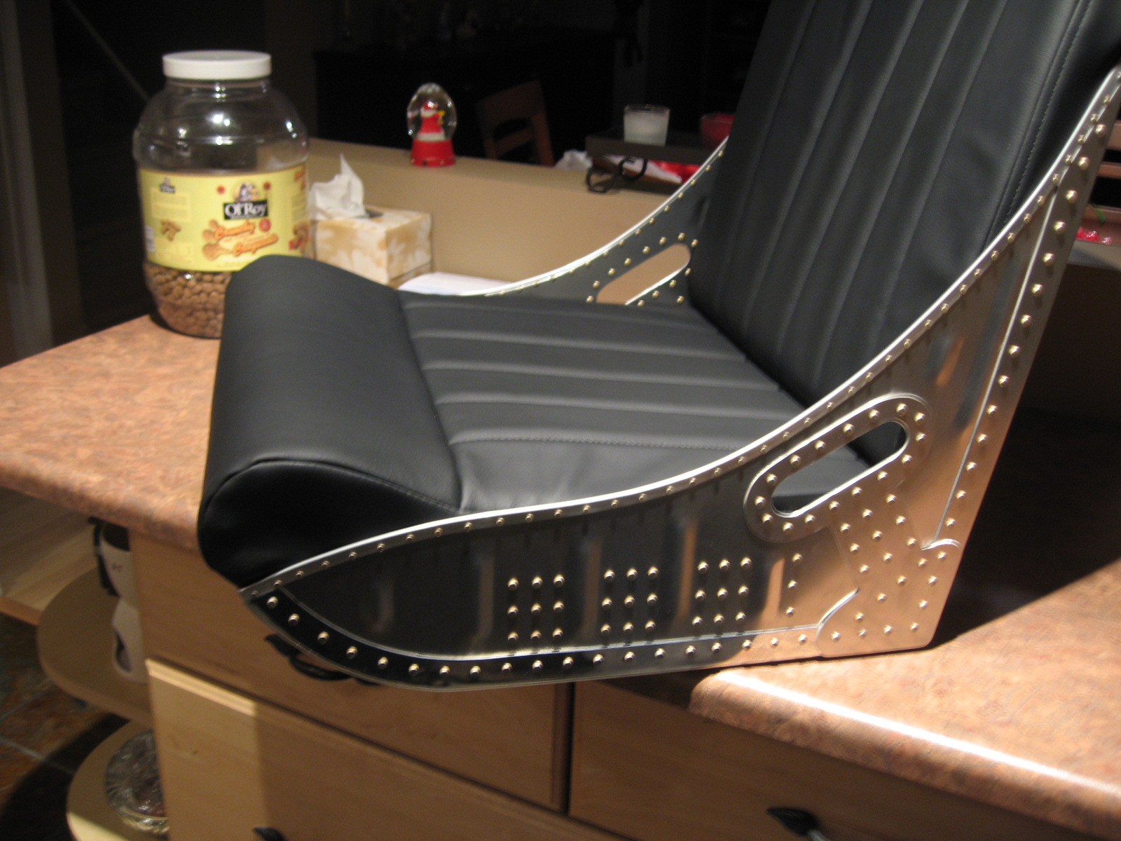

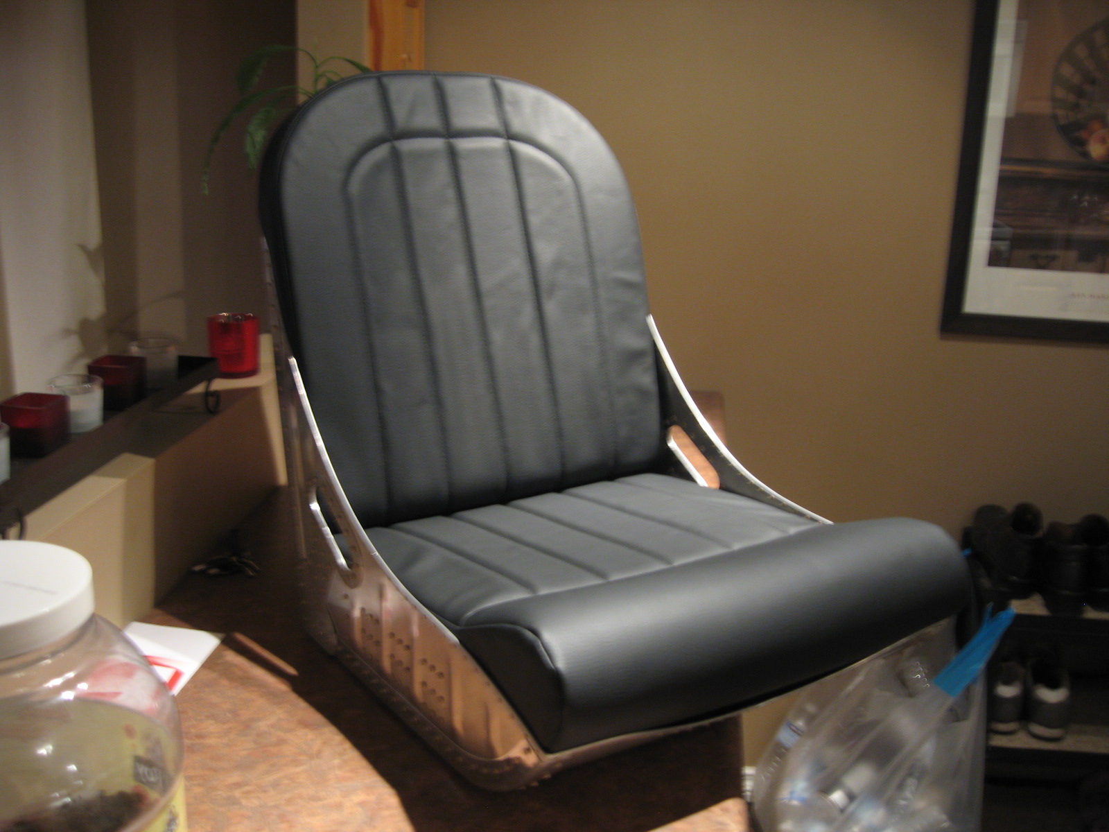

    I made the panel for the drivers side.
    Also drilled and bolted them is place ( 2 bolts to the bottom of the box and 1 bolt into a nutsert insert in the frame) so they are where they will be after paint later on.

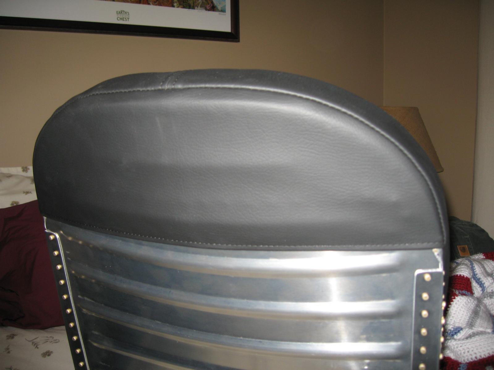

    I had some drop in seat pads made for the bomber seats, black textured vinyl.
    The foam in the bottom and the slight bolster to keep your legs off the front edge of the seat.
    With 4" of foam on the bottom and 2" on the back they are surprisingly comfortable.
    The backs slip over the seats and are held in at the bottom with a couple small straps and snaps.
    The base cushion is captured by the seats shape.
    Of course the cushions are removable in case I want to show off the seats.
    I can mount the seats and see where the steering wheel and brake pedal etc. will be.

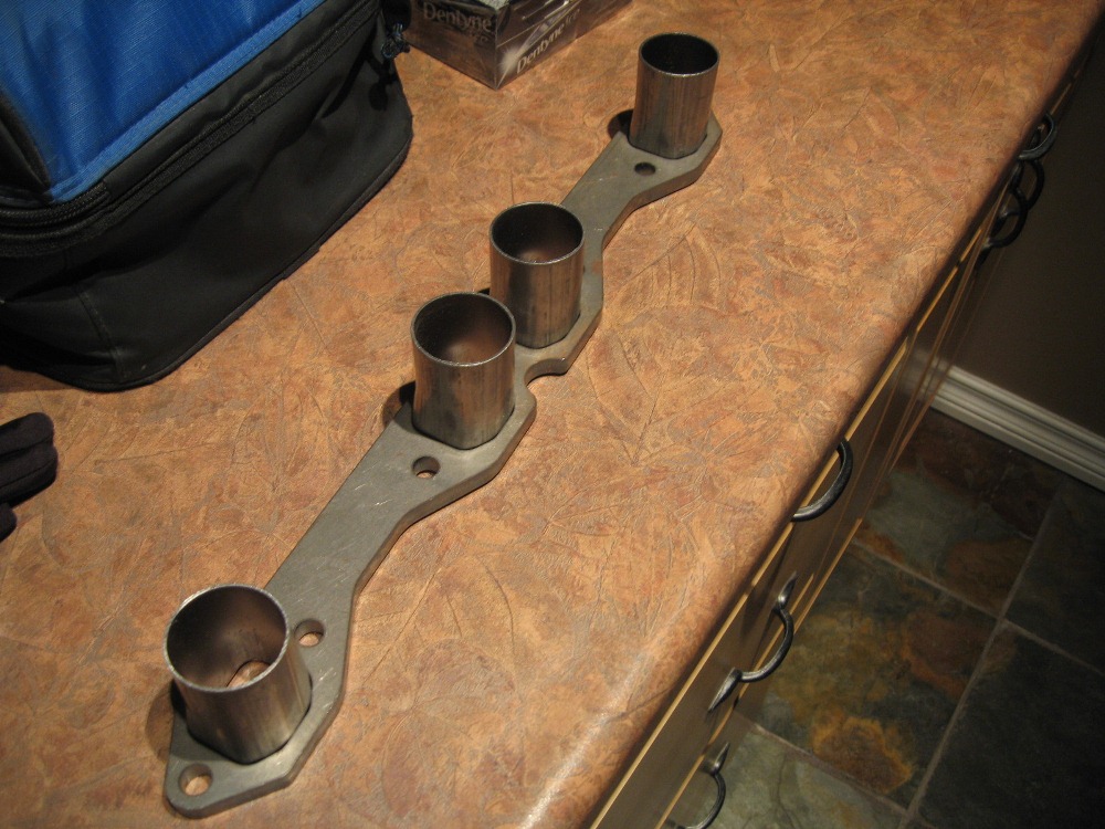

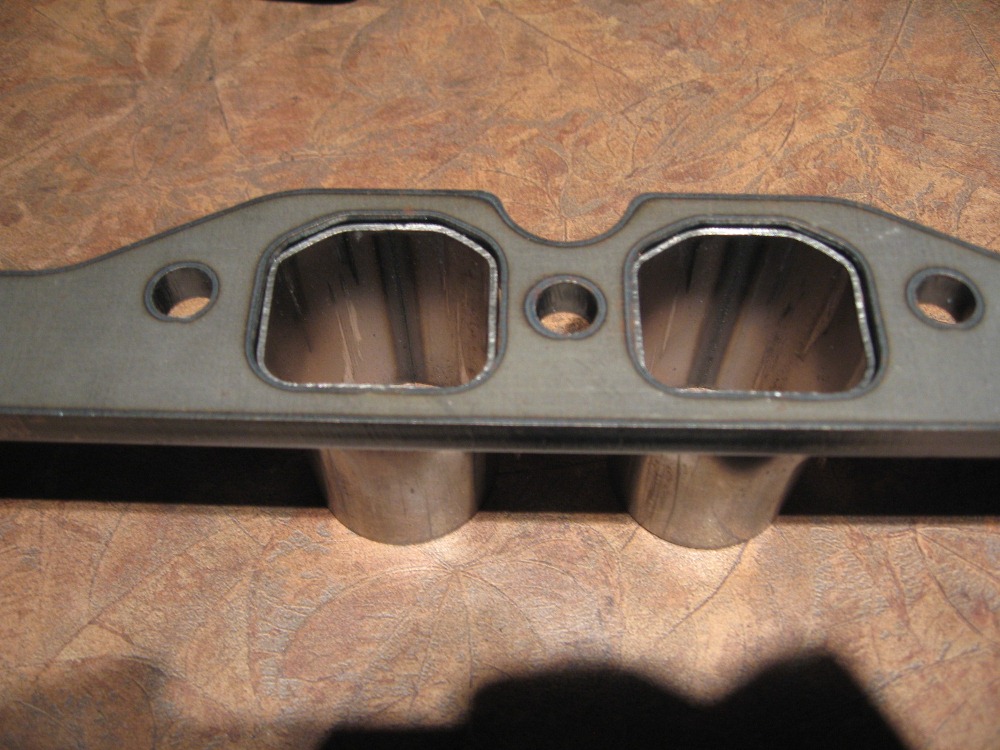

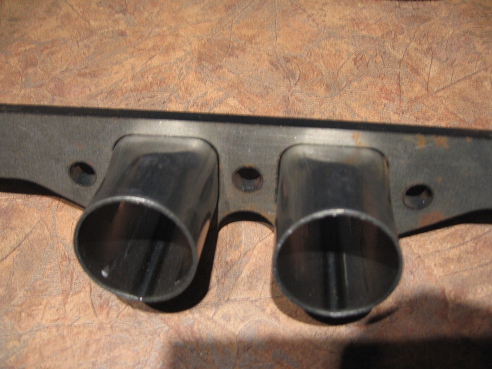

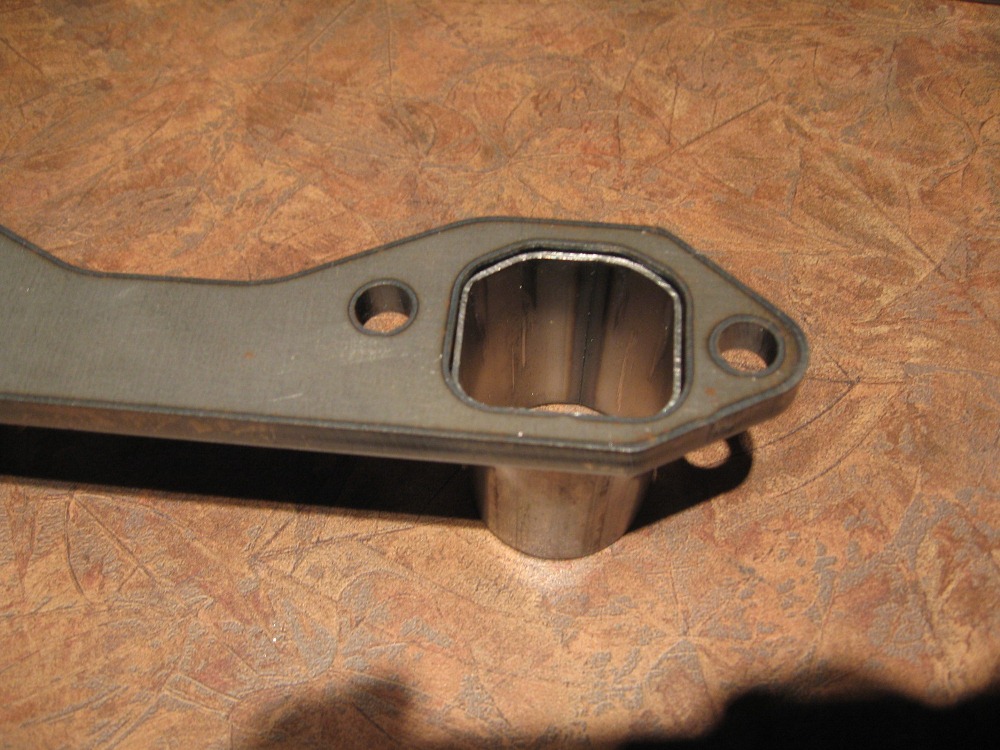

    I went ahead and ordered some header stubs to fit my Y Block header flanges from Tanson.
    Very nice fitting set of header stubs, they fit the flanges nicely.
    http://www.forwhatyouneed.com/exhaust_header_flange_sets.htm

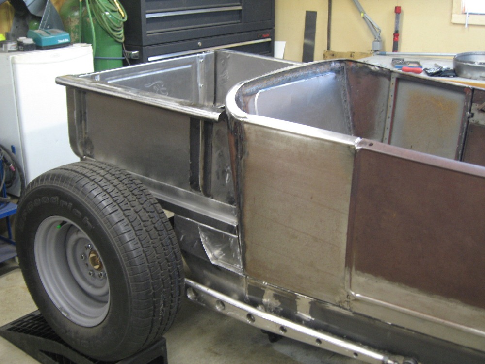

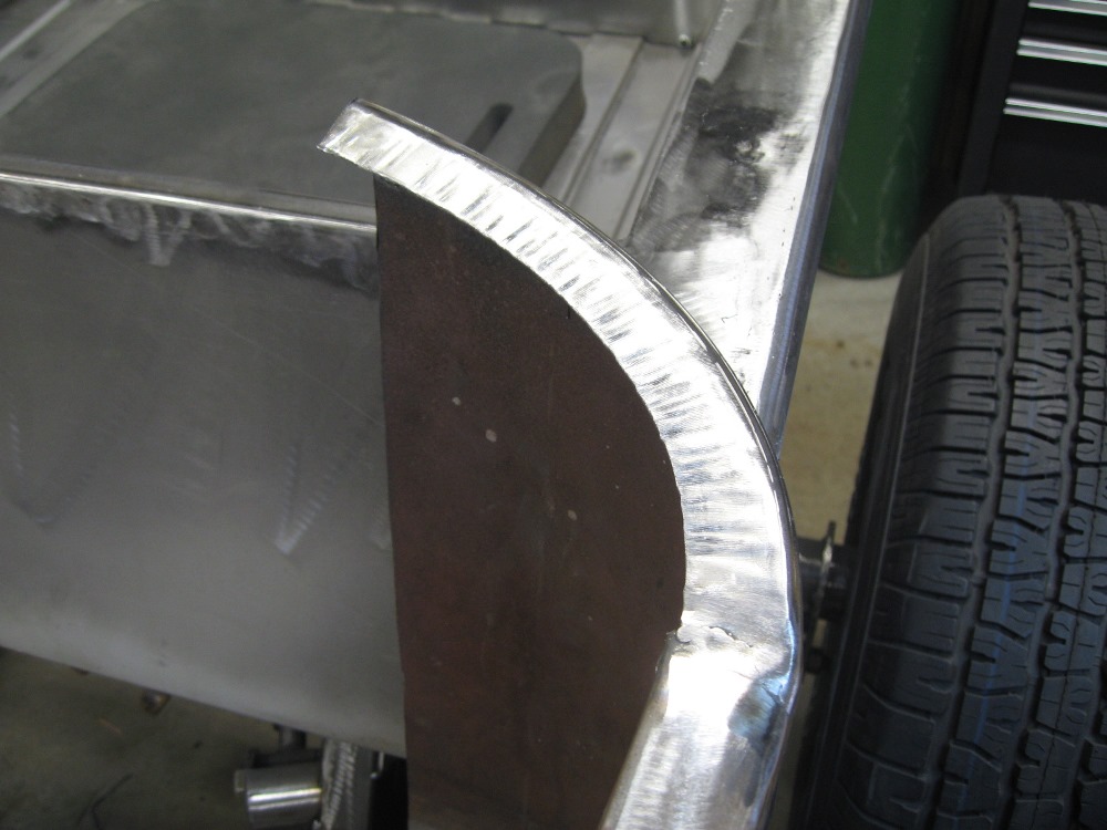

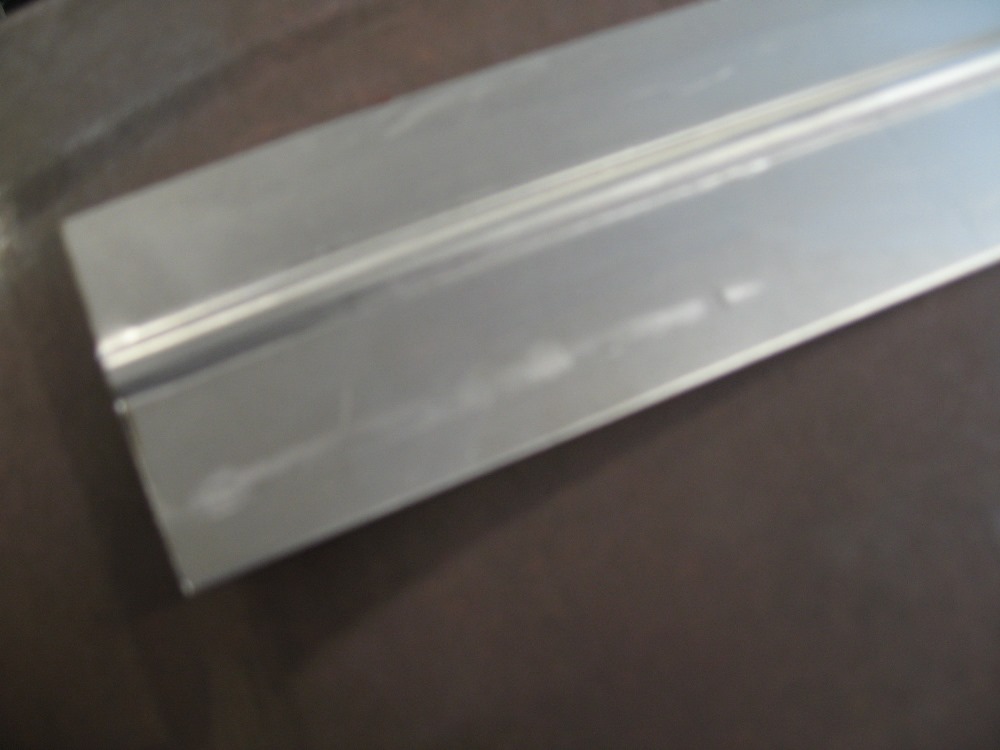

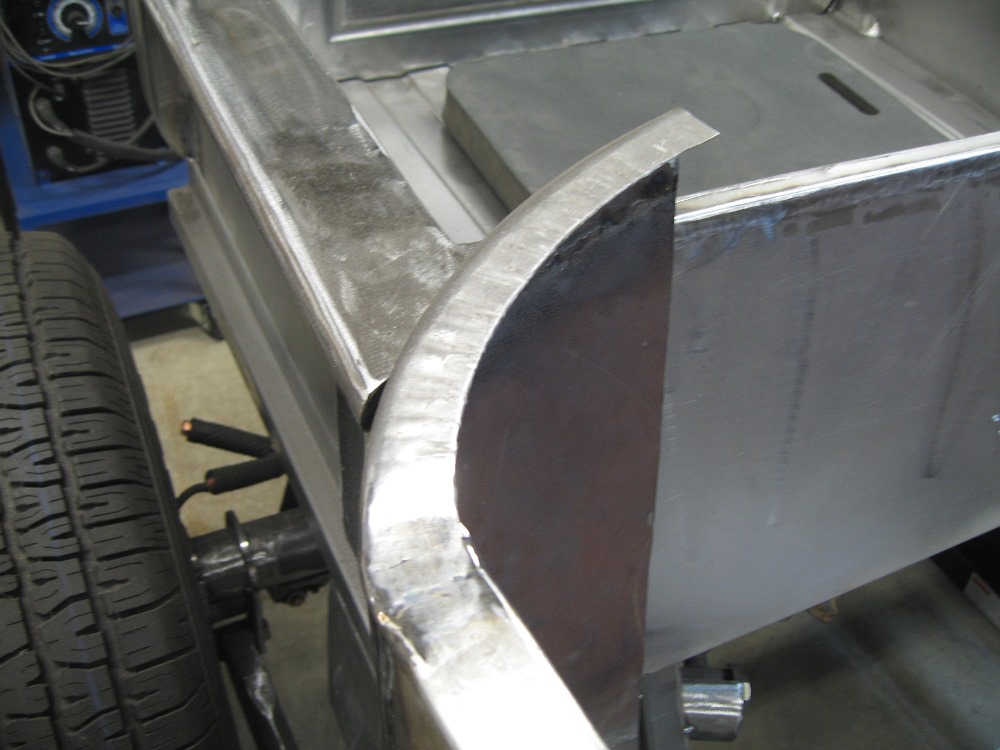

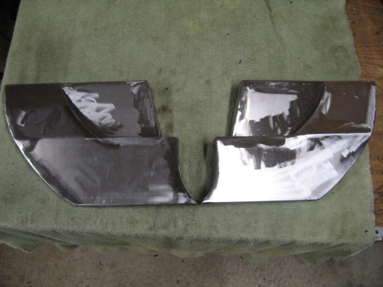

    Started on the back of the body.
    I cut off the top rail and then a big section out of the middle.
    Then I started building the new top rail for the back of the body.
    I rolled a bead into the metal and then bent it near the bead, just slightly more than 90 degrees.
    This formed the bead for the back of the top rail.
    I then went at it with my shrinker to curve the rail. I did the corners, then the center piece.
    I was going to have it go straight (flat across from the corners) but decided it looked better shrinking a little and curving it slightly.
    Next will come replacing the metal for the rest of the buckets back end. :)

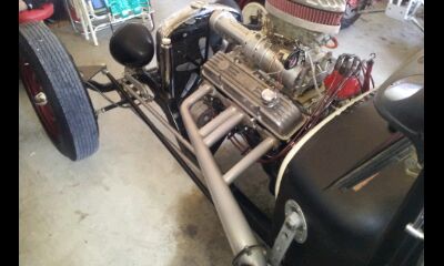

    Here are the headlight stands I was talking about

    I grafted the headlight ball mount on F1 shock mounts and mounted shock stud on the side... makes for a high headlight position... that is why SoCal does a shorter F1 mount behind and a headlight bar type mount in front... I have a lot more grill heigth on the 33 and by todays standard they are at nose-bleed heigth

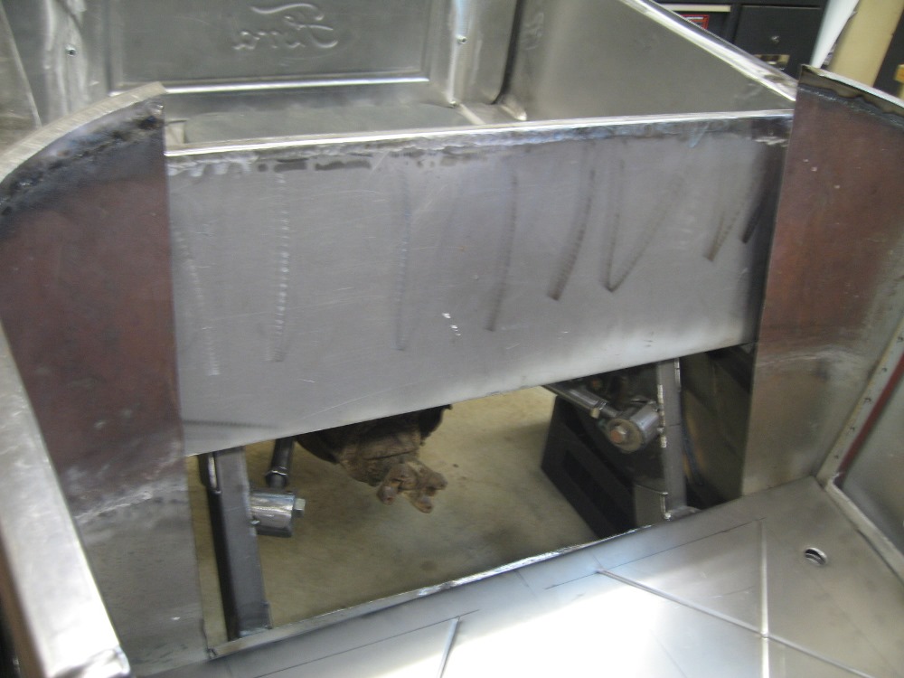

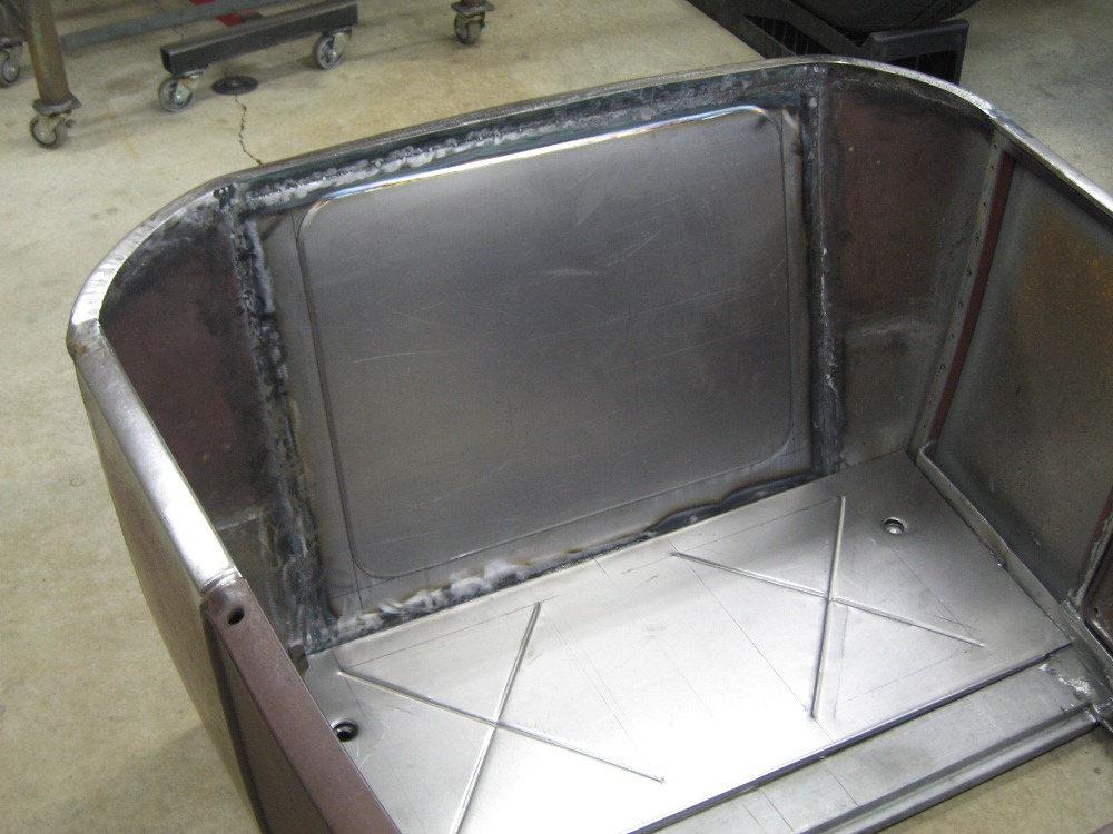

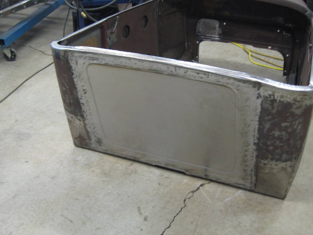

    Got the back of the body done, well almost. :) Still going to do something with the new top flange I built.
    I want it to be exposed and painted rather than covered with upholstery.
    I'll build a lip for it and a flange underneath to fasten the aluminum panel I plan to line the body with.
    I decided to use the bead roller to roll a step into the rear panel to stiffen it a little and give it a little detail even though it will mostly be hidden.
    Tacked it all in place with the mig using tacks close together and then used a sanding disc to knock the tacks flush and smooth inside and out.
    Grabbed my little jewelers torch and gas welded the seams.
    Then some weld smoothing with an 80 grit disc and a little dolly work.
    Then re-mount the body for the 100th time or so :D
    Larry.
