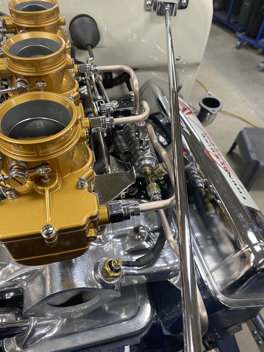

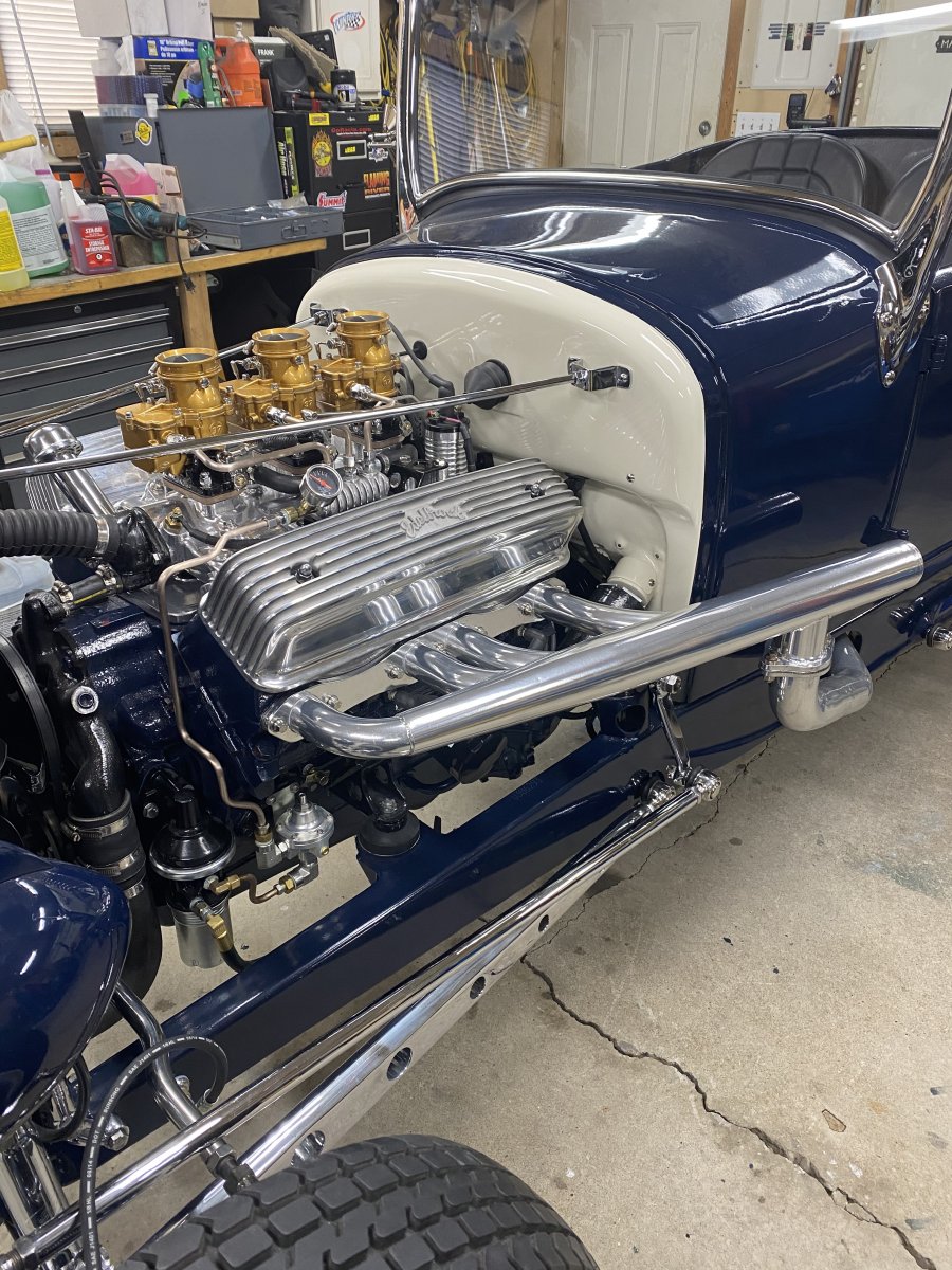

    So I spent a little bit of time in the garage again today and installed the radiator support rods and wouldn’t you know it :D again because the carbs now sit 13/32” of an inch higher I’m going to have to bend up another fuel line in a different configuration for the front carb.
    The fuel line which had adequate clearance before now comes to within an eighth of an inch of the rod where it bends to go to the carb inlet.
    Sitting there under the support rod that closely allows no room for engine movement at all.
    Another one of those 10 plus things to change from the original change. :D

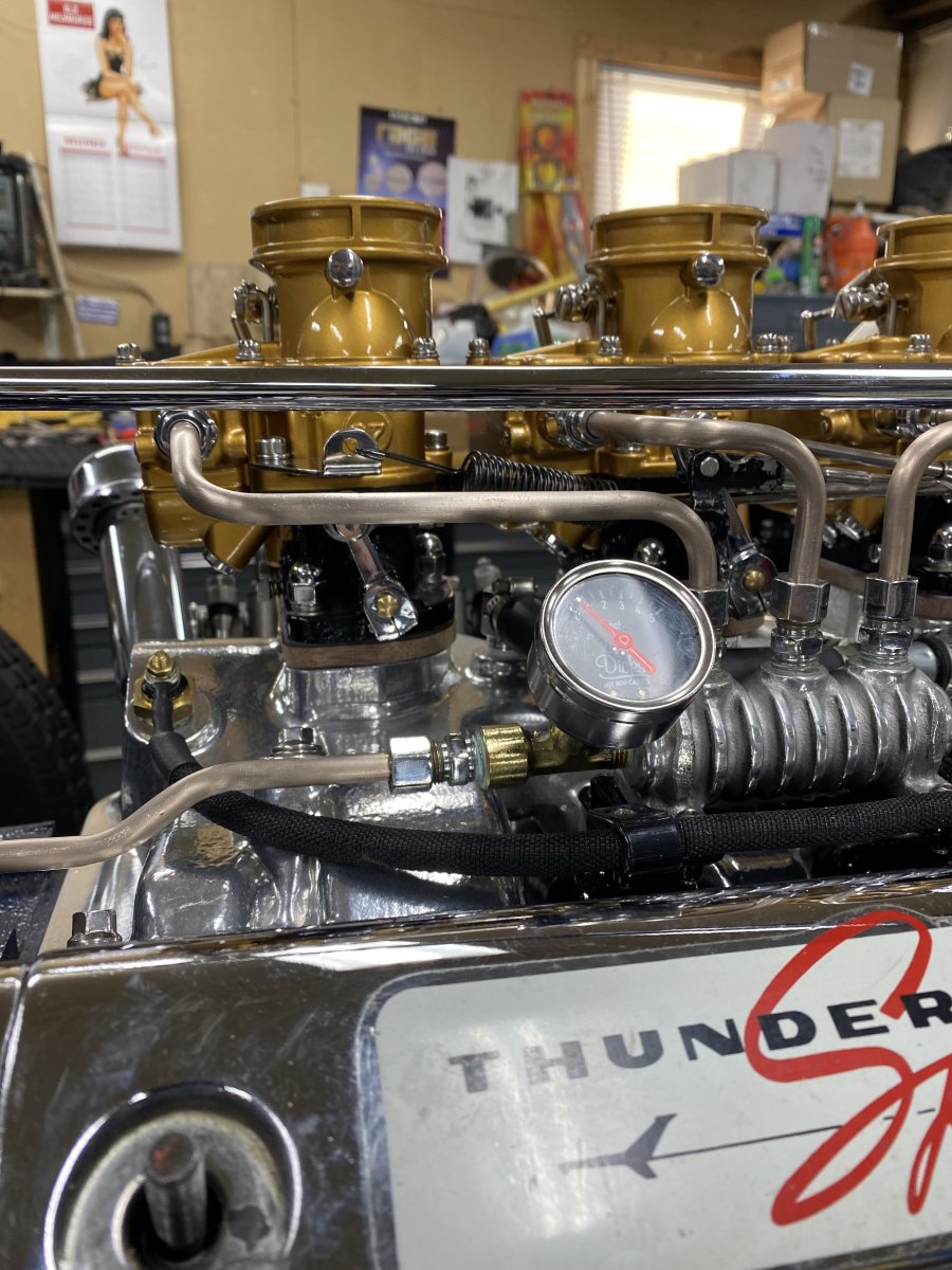

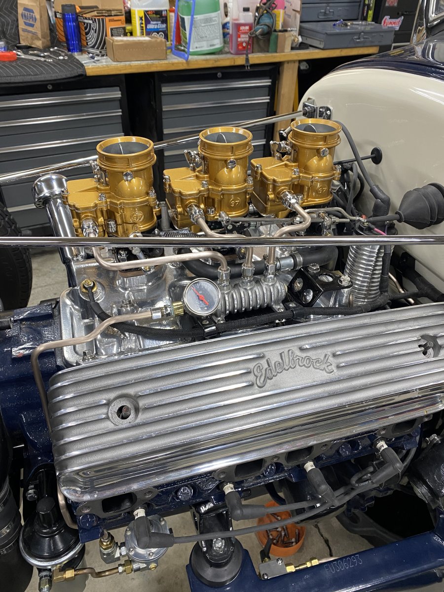

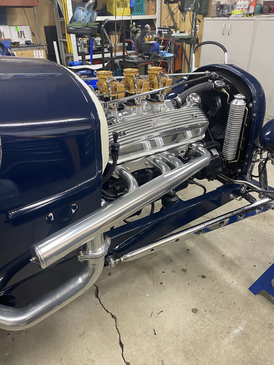

    The front carbs fuel line is redone and revised.
    It now drops down slightly to clear the support rod and then it’s a straight run and down to the fuel log. :cool:

  5. Six Ball
    Joined: Oct 8, 2007
    Posts: 6,981
    Six Ball
    from Nevada
    Beautiful! And you matched the number of bends in each one, simple yet perforce design.

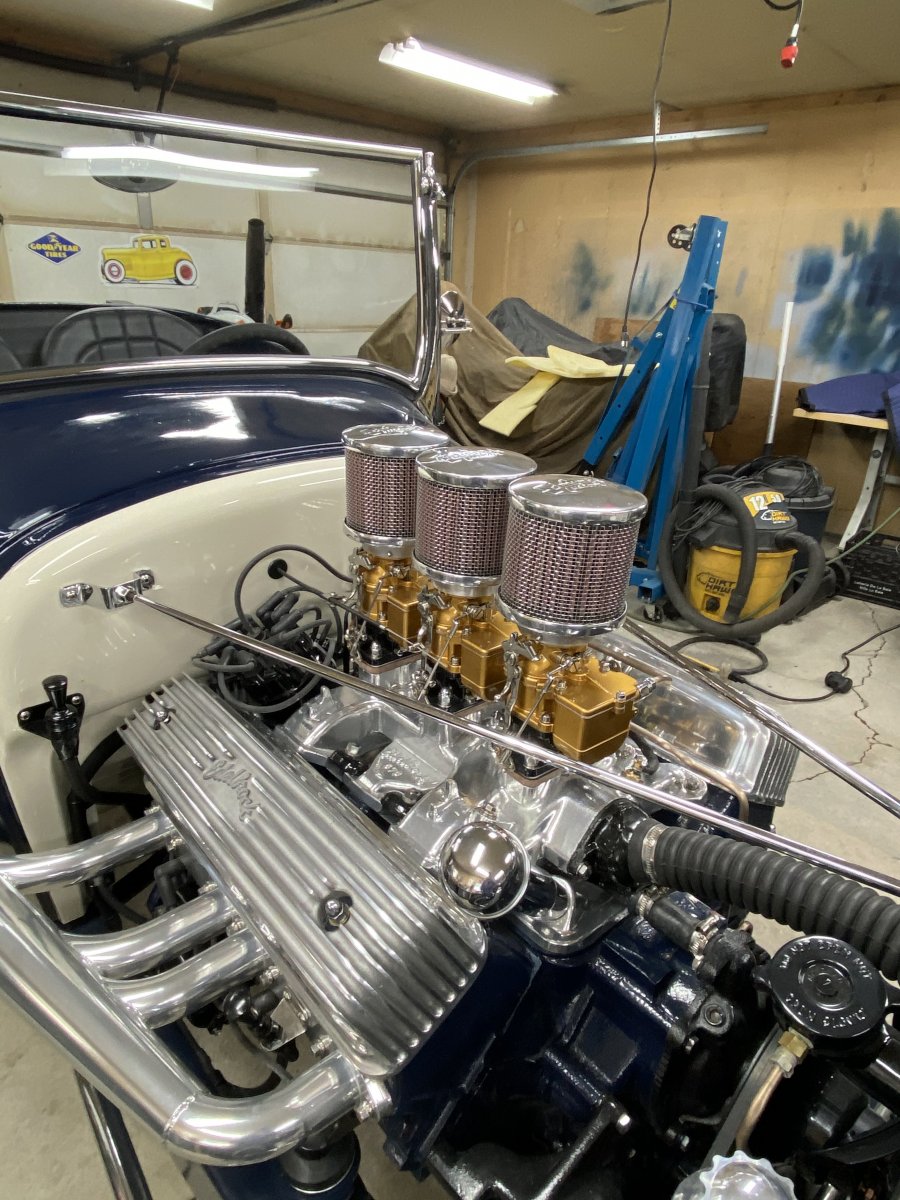

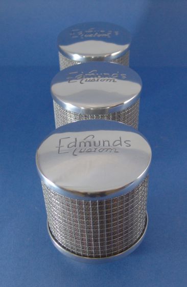

    In the department of more efficient breathing I’m going to ditch the small 4x2 air cleaners that I believe were limiting the power output of my engine and contributing to the rich running issue too.
    I contacted Dennis at O’Brien Truckers and ordered up a set of Edmunds 4 1/2” air cleaners that have the surface area and the elements are taller so they will breathe a lot better. :cool:
    2C372588-3DCF-44D0-947F-8D72345ED432.jpeg 010A3464-3AED-4CA9-8EED-005864B956D4.jpeg
  8. 26 T Ford RPU

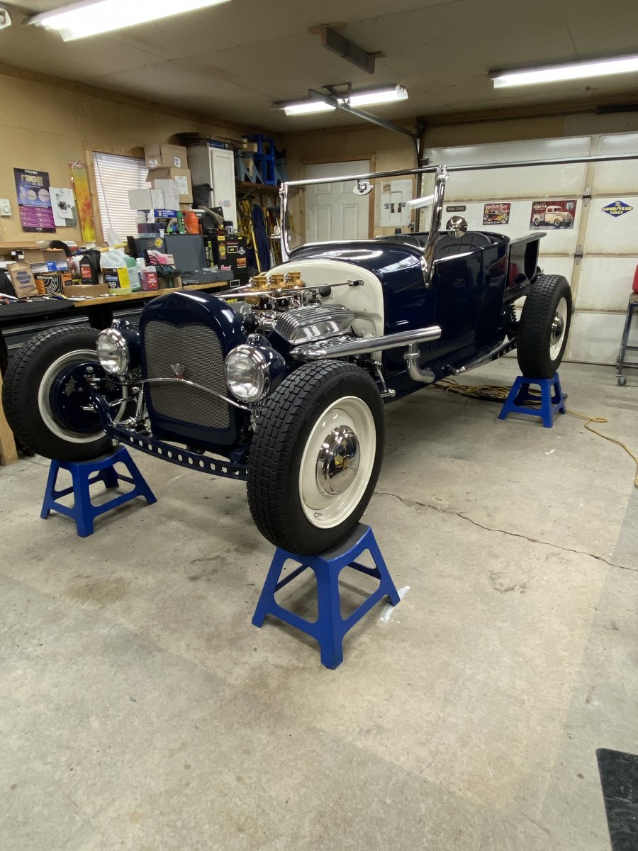

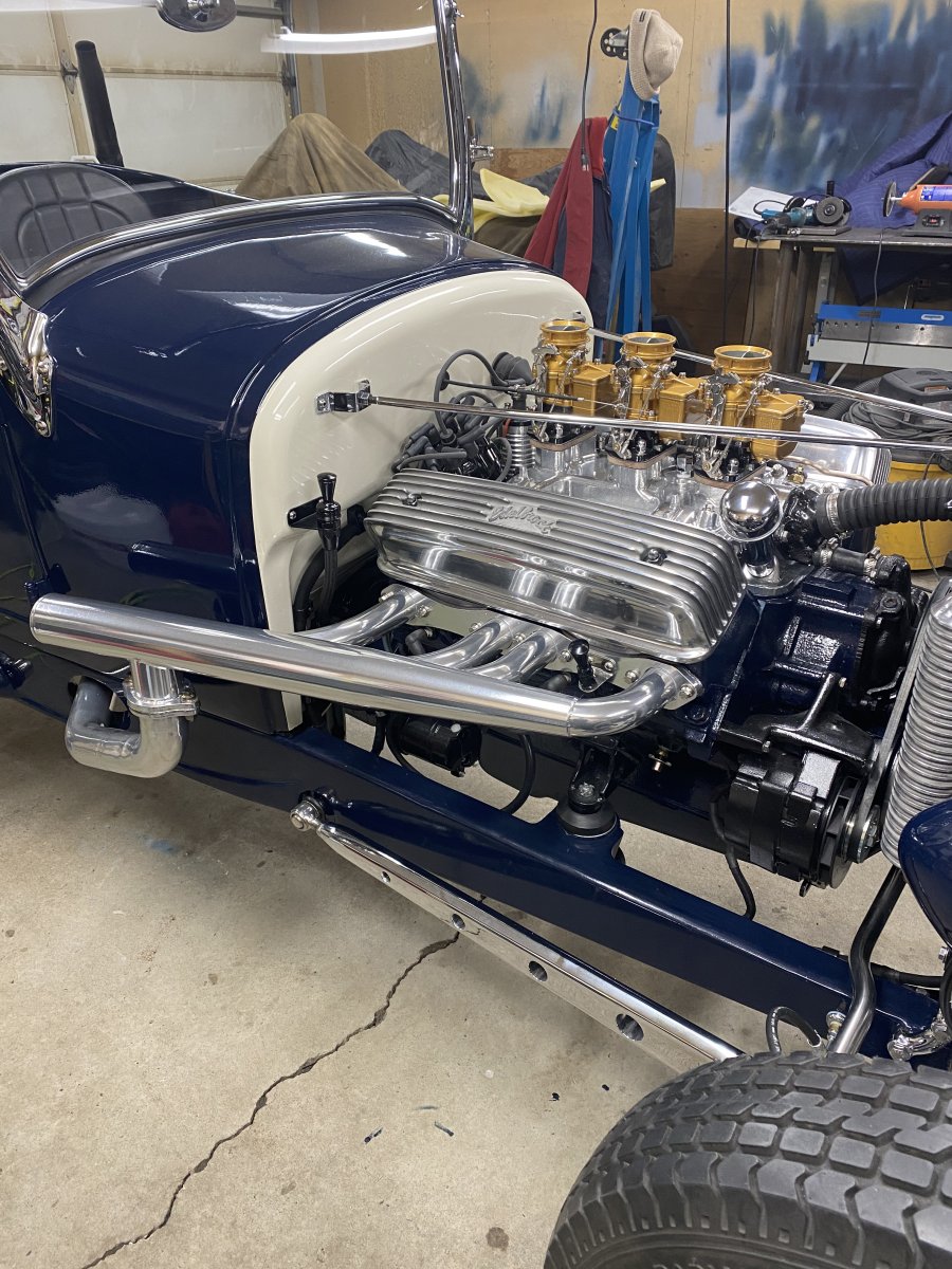

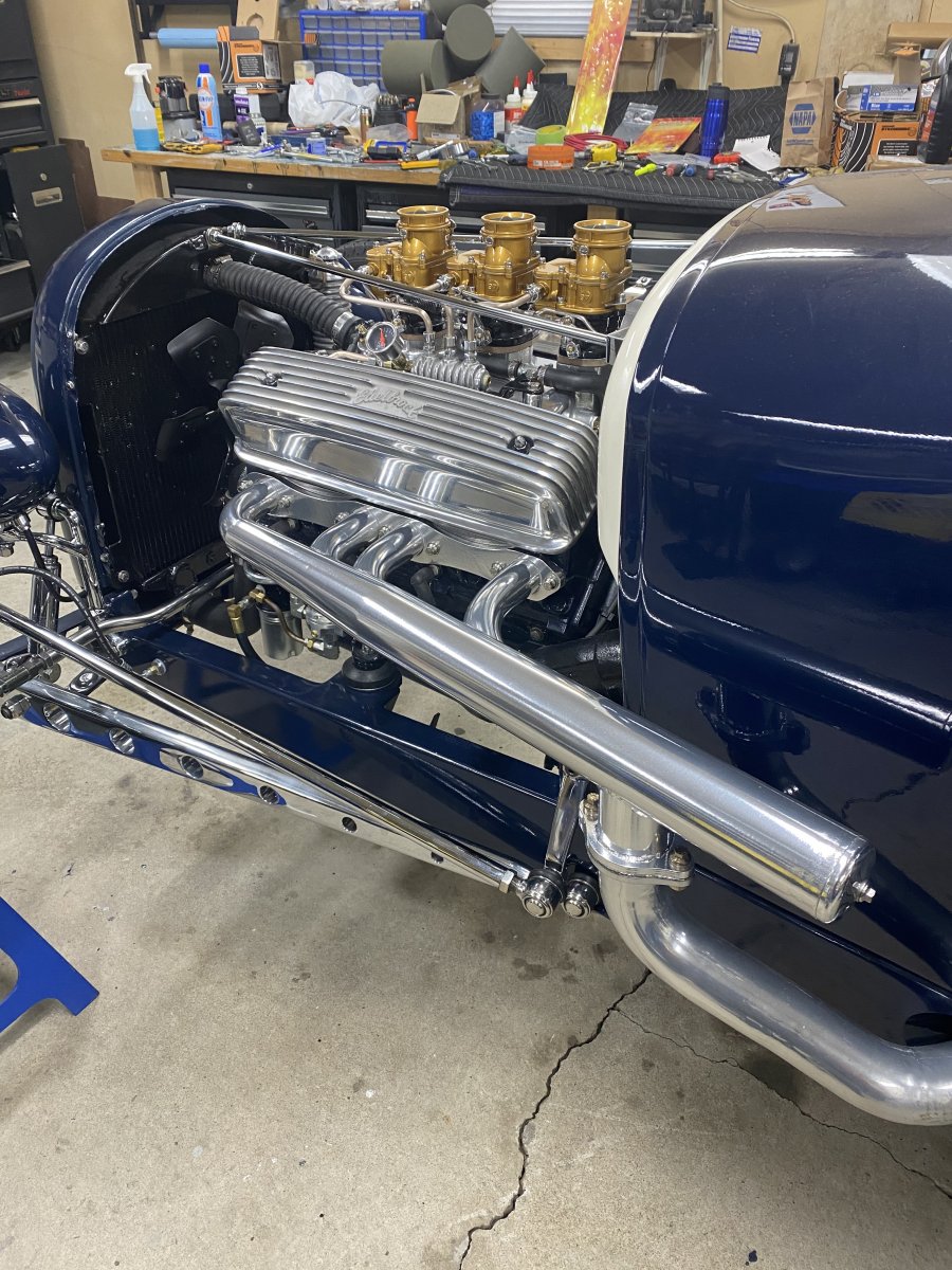

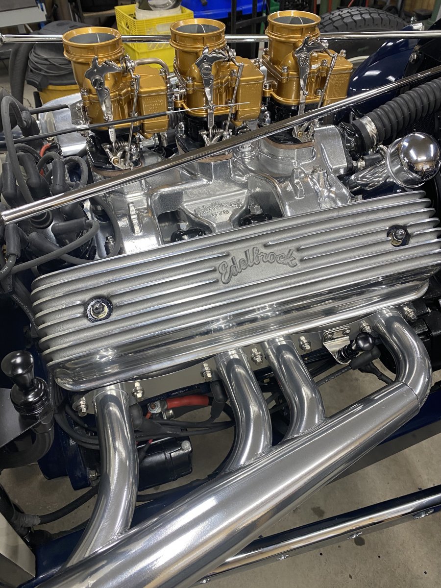

    Well here we are almost ready to get back on the road :D c’mon spring :D
    I have everything back together now.
    Transmission pan back on and new fluid in.
    Radiator filled up. Fresh oil and filter.
    And as you may recall I had the headers stripped and recoated with ceramic along with the intake manifold.
    All installed :cool:
    Now I’m just waiting for the delivery of my new air cleaners from O’Brien.
    Next on the list is to pull out the sewing machine and get after the rest of the upholstery on the panels.
    Pictures for your enjoyment :D
    DF3D754D-6260-4AF5-BBB0-B9419BE9EA02.jpeg 686FD62D-E9C9-4220-A7D9-3936629111D8.jpeg FA886213-D039-46D0-8EEB-6AE78B0CD42A.jpeg 65A18DDD-EDC5-4A9C-B2DE-F30CCFC921B1.jpeg ED10B751-BCD0-4E3E-B031-A1C4B80C6C17.jpeg A8BF02DA-C96A-4946-92B5-5C61B53E8CC7.jpeg 5B421BF2-0A25-4913-A143-903C0E47E47F.jpeg 8B336DDF-89FB-42CB-8E56-69828E240BDA.jpeg

  10. Six Ball
    Joined: Oct 8, 2007
    Posts: 6,981
    Six Ball
    from Nevada
    The quality and detail is just amazing. I hope you get to drive it a lot this year.

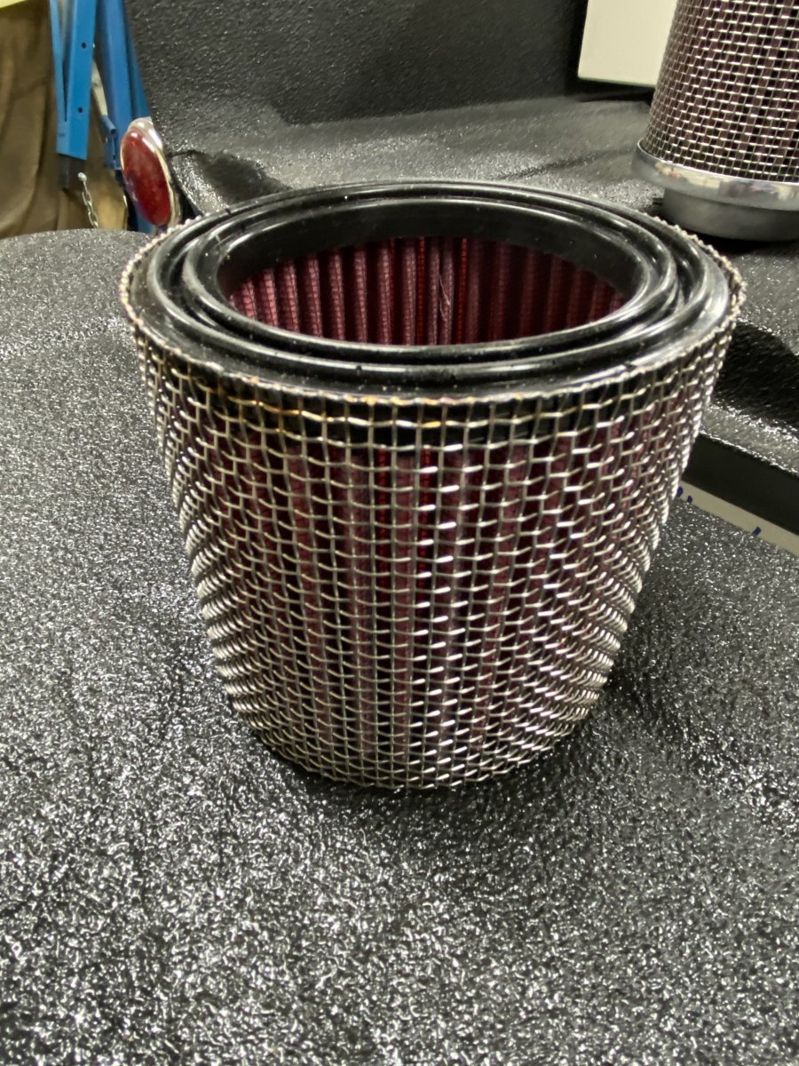

    I received my Obrien Truckers Edmunds air cleaners and they are nice looking but in my typical fashion I don't like the way they are put together and the screen the filters are wrapped with.
    They're wrapped with 2 layers of different screen and they are awkward to take apart and put back together which will happen when you want to clean the washable filters.
    So, I picked up some materials and will create something that will work much better. Details to follow :cool:

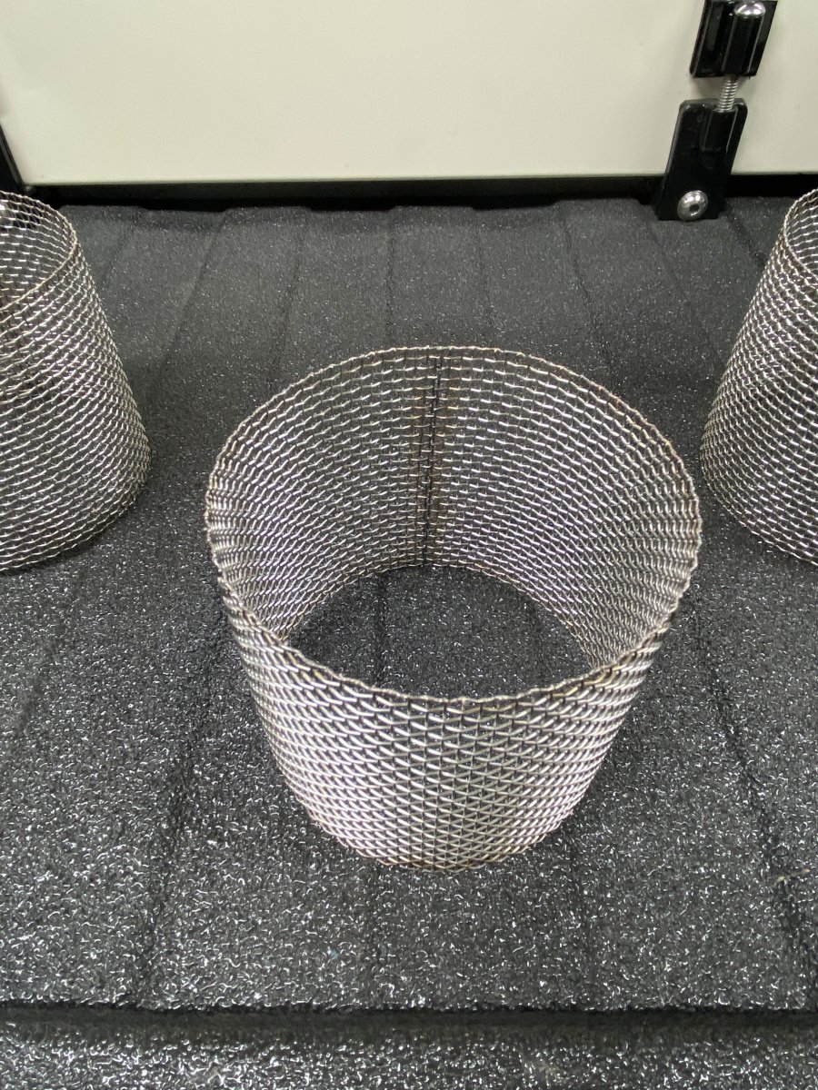

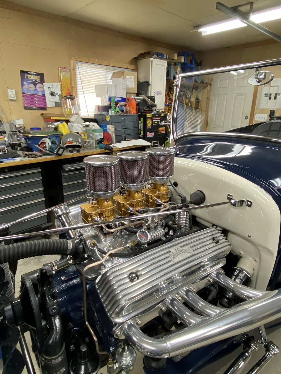

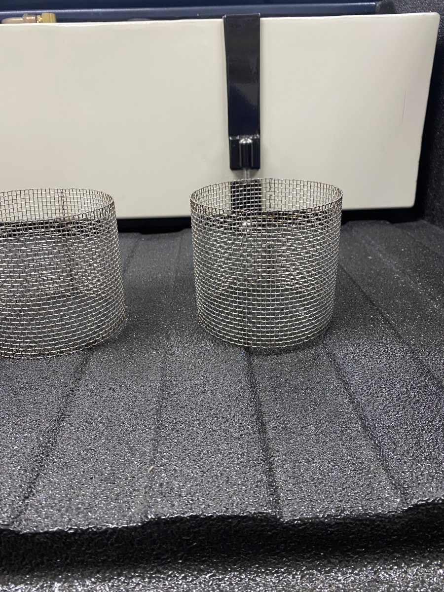

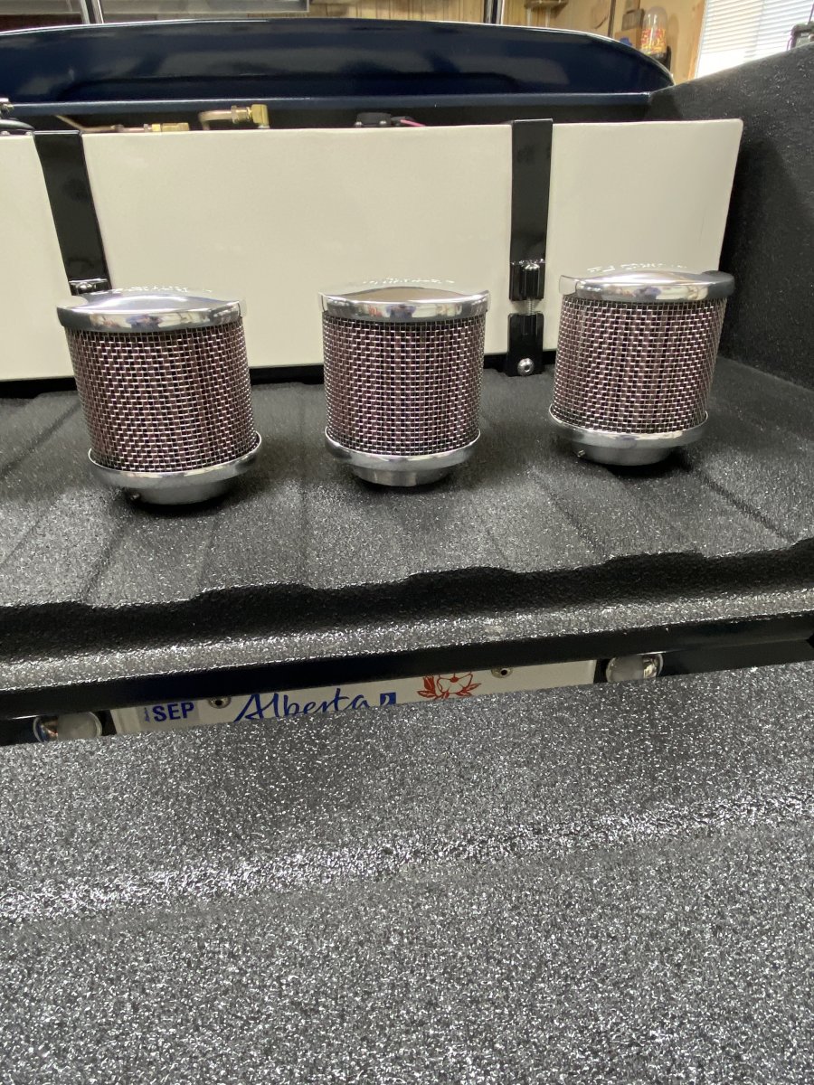

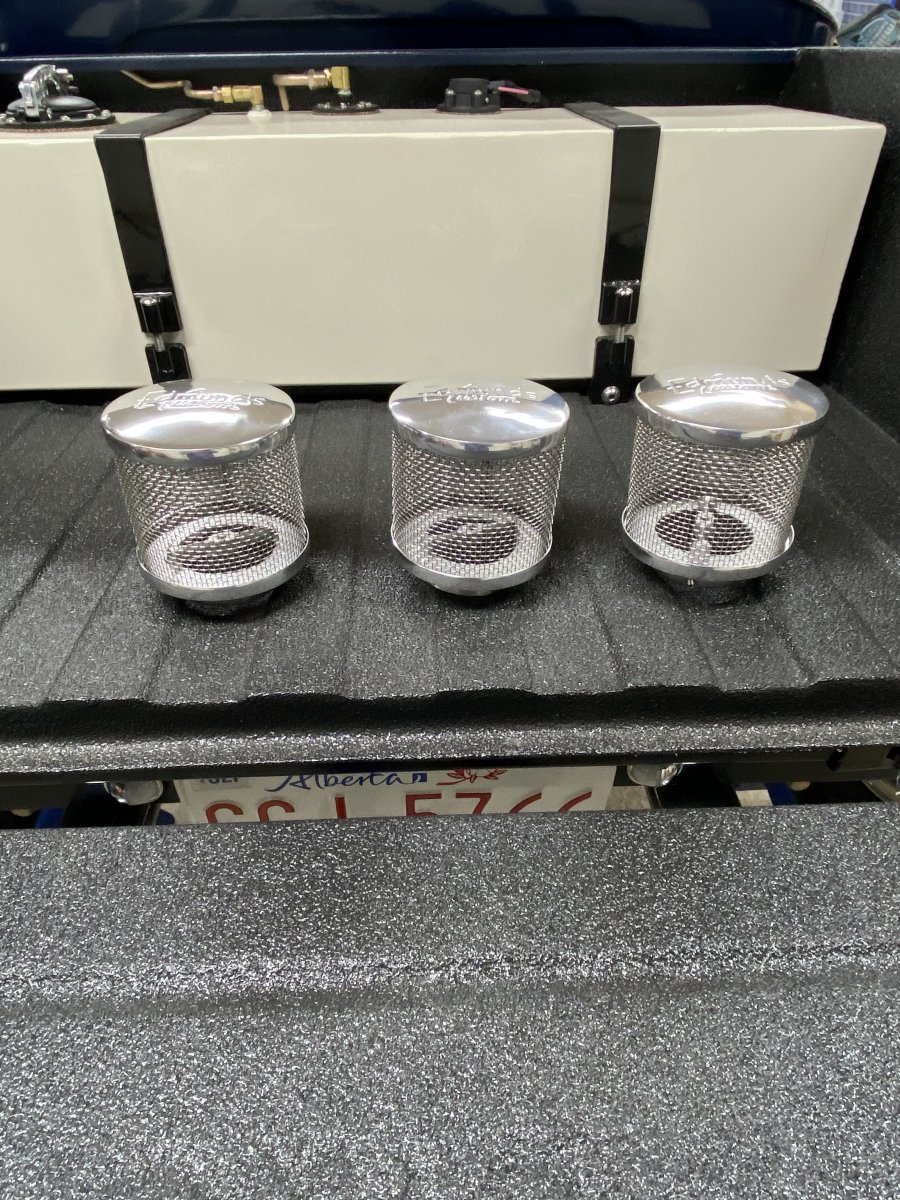

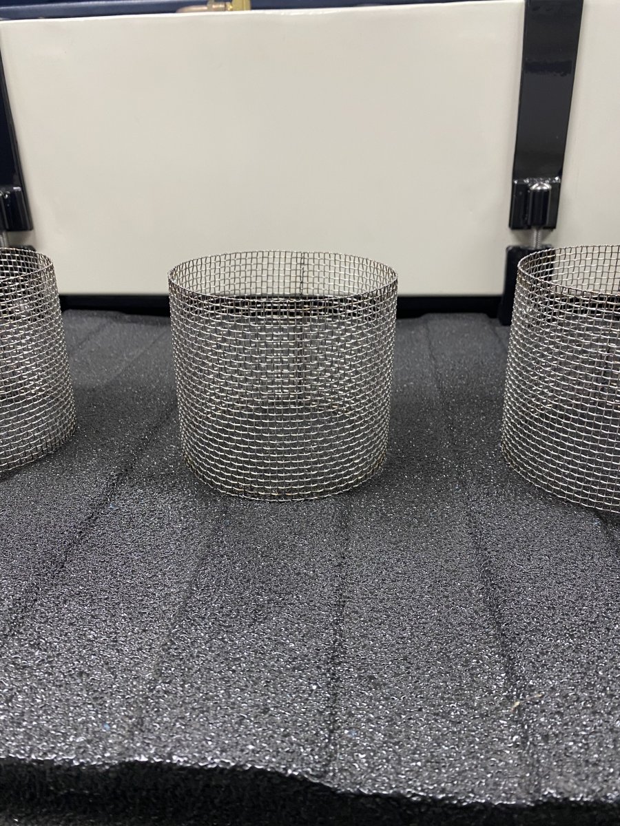

    Well as usual things always take longer than you think they will but I finally sorted out the air cleaner screen situation.
    As you may be aware I have woven stainless steel mesh in my grille as an insert and I also have stainless mesh in my Boling bros Lincoln front brake backing plate vents.
    So I picked up some woven #8 stainless steel mesh and proceeded to cut it and weld it into sleeves to cover the air filters allowing easy ***embly and cleaning the filters when needed.
    Anyone ever try to weld .023 wire diameter stainless steel mesh with a TIG machine?
    Are we having fun yet :D
    In any case setting the machine up for a low temperature pulse of about 15-20 amps at a very small duration pulse and a full arc off cycle between pulses every 3 seconds did the trick.
    And I do mean trick :D
    Almost like magic because do the wrong thing and there’s no mesh anymore :D
    Another thing about woven mesh is that after you cut it you can unravel it without too much trouble as the strands at the edges aren’t well secured.
    So if you look close you will see that each vertical wire mesh strand has been welded to the top and bottom wire of the sleeve making sure they won’t come unraveled.
    There are 109 vertical strands on each sleeve :eek::D
    I’m pleased with the results, here are pictures for your viewing pleasure. :cool::D

  28. 57 Fargo
    Joined: Jan 22, 2012
    Posts: 6,232
    57 Fargo
    Well Larry, that looks killer. Nice work as usual. I can’t imagine welding all of that fine material.
