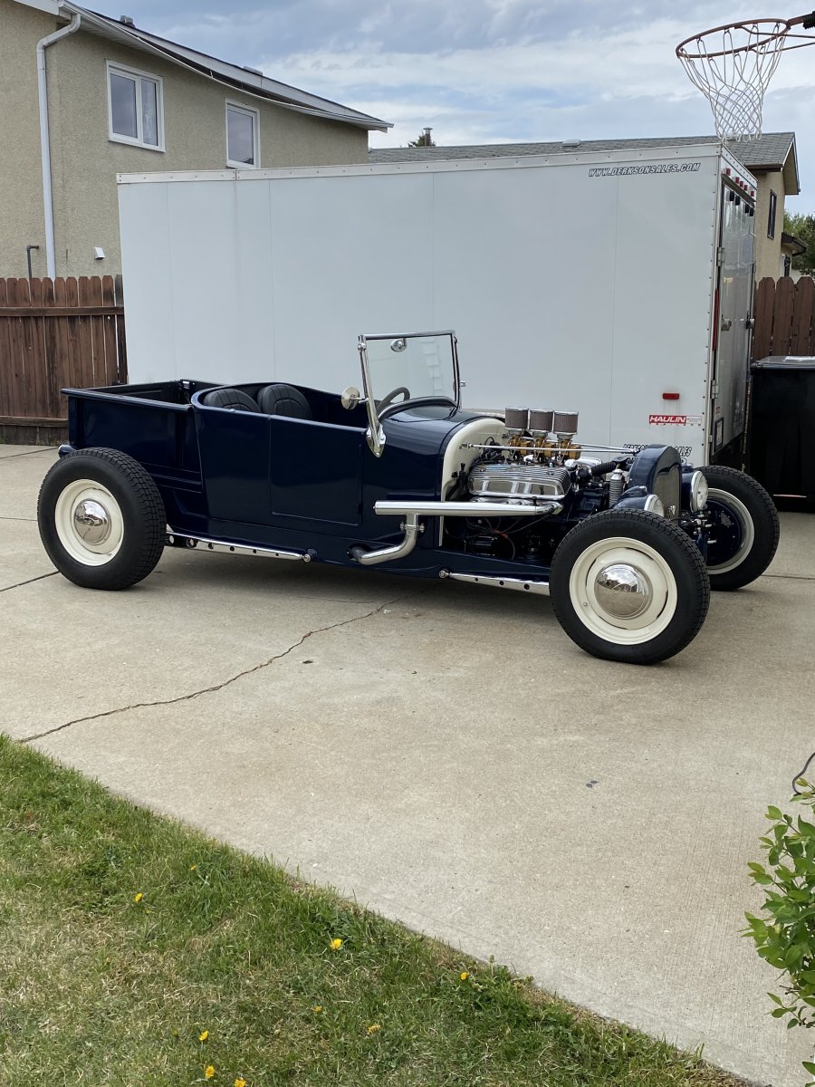

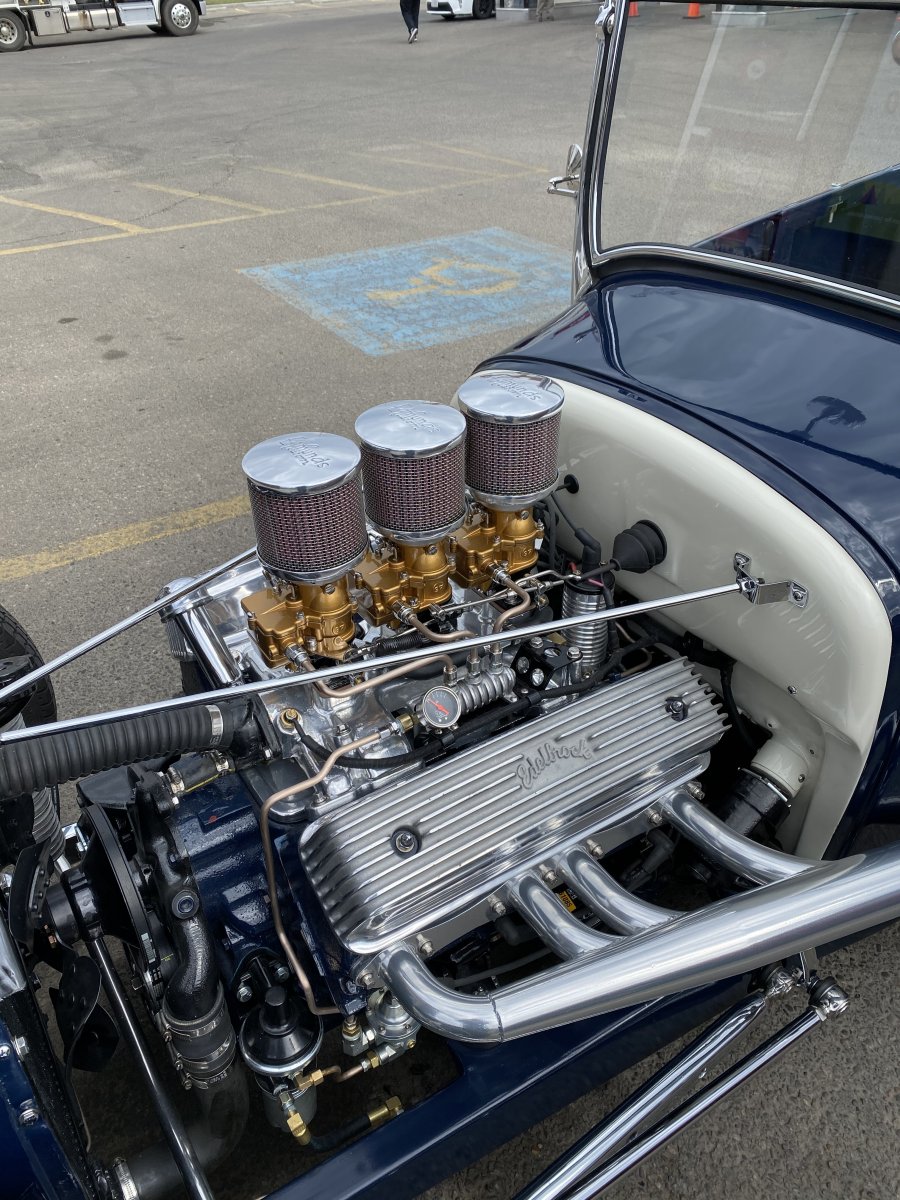

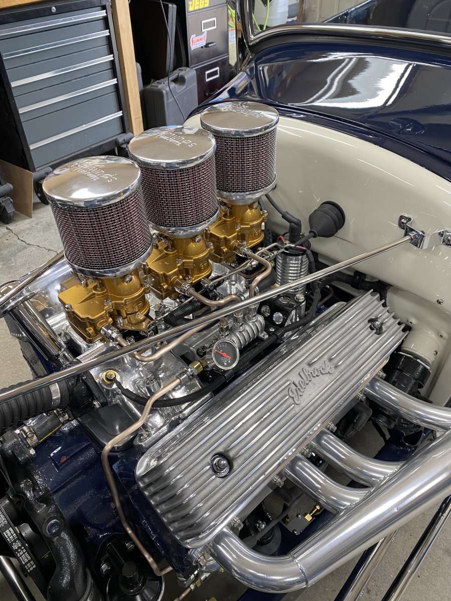

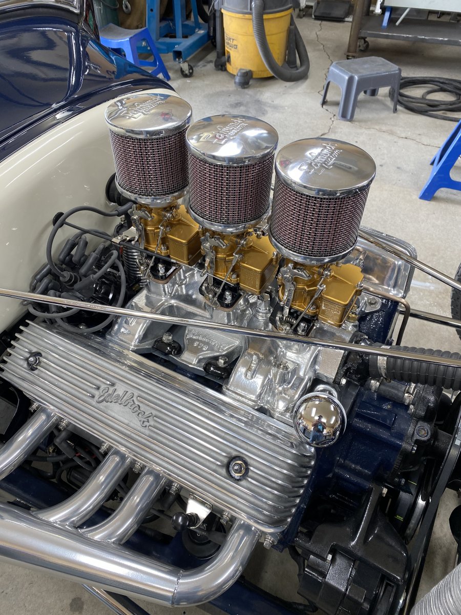

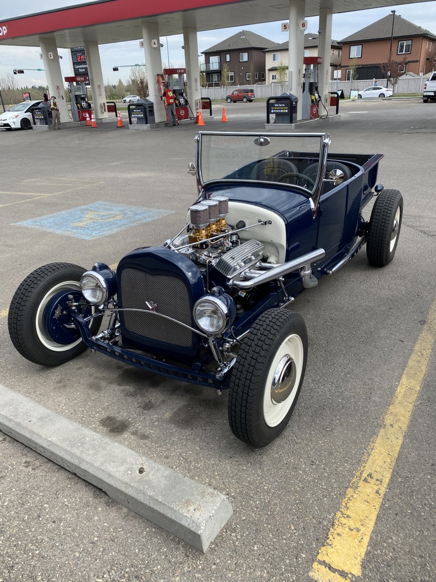

    Today was the first outing for the RPU this spring :cool:
    I spent the better part of the day sorting out little things from the dis***embly for the heads and refinishing the carbs and manifold.
    Once I got it running I realized that the rear carb was leaking out of the accelerator pump shaft and after shut down was leaking fuel onto the ****erflies.
    The front 2 carbs were working perfectly.
    So I removed the top of the carb and adjusted the float level lower and put it back together.
    Success :cool: Probably for the first time ever no leaks.
    Balanced the carbs and installed the Edmunds air cleaners and went for a little run.
    Runs better than it ever has. :cool:
    So much fun :cool:
