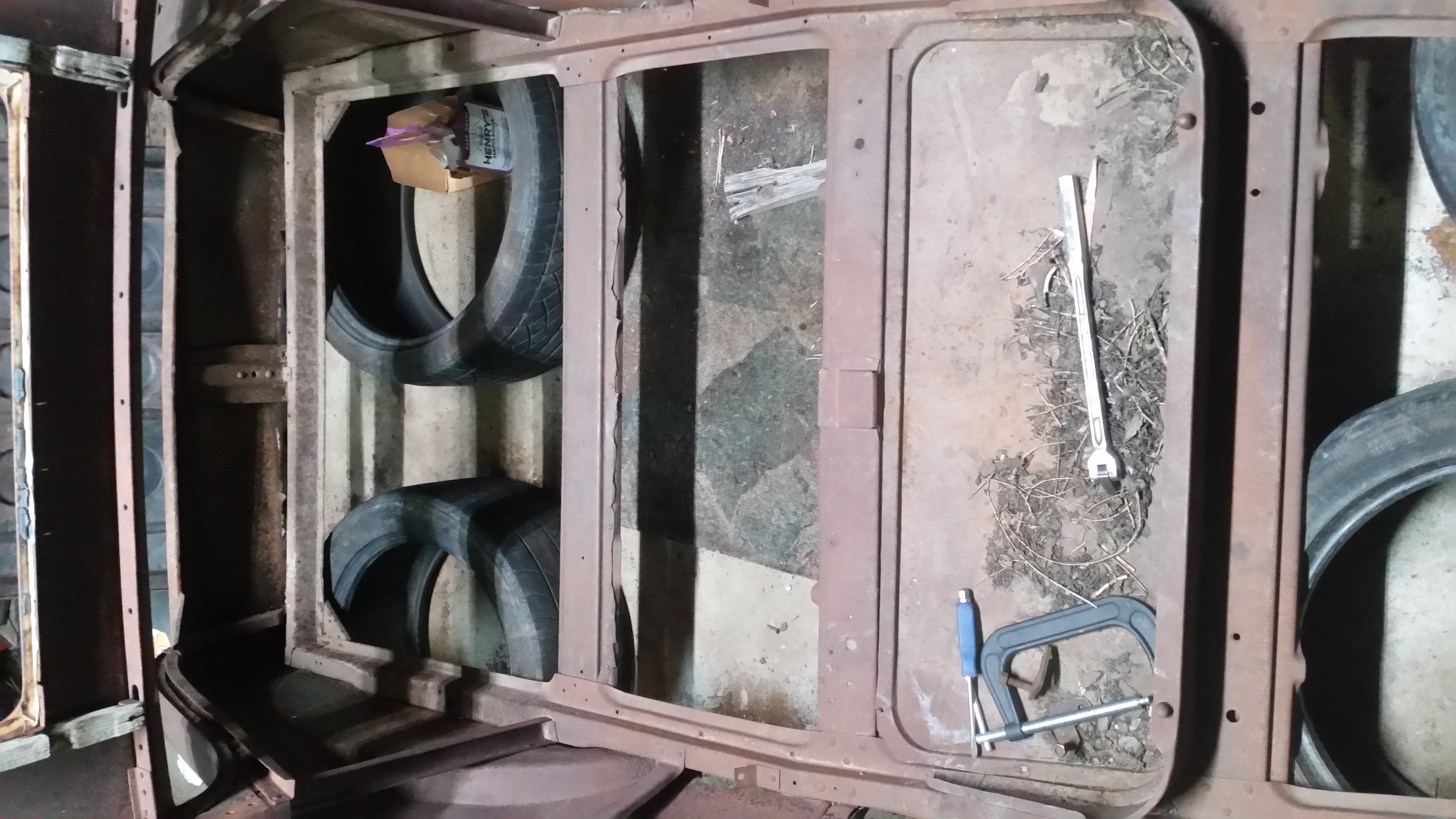

    Would that be where a wiper would go?
  2. 27Roadsterguy
    Joined: Jul 12, 2013
    Posts: 158
    27Roadsterguy
    That was my thought, but haven't had any luck searching the web for info.

    Hand wiper, probably an optional extra back then...

    Cool I mighty leave it there then and just make a rubber grommet to seal it off later. I'm planning to run an electric wiper though, maybe it'll fit in the same place.

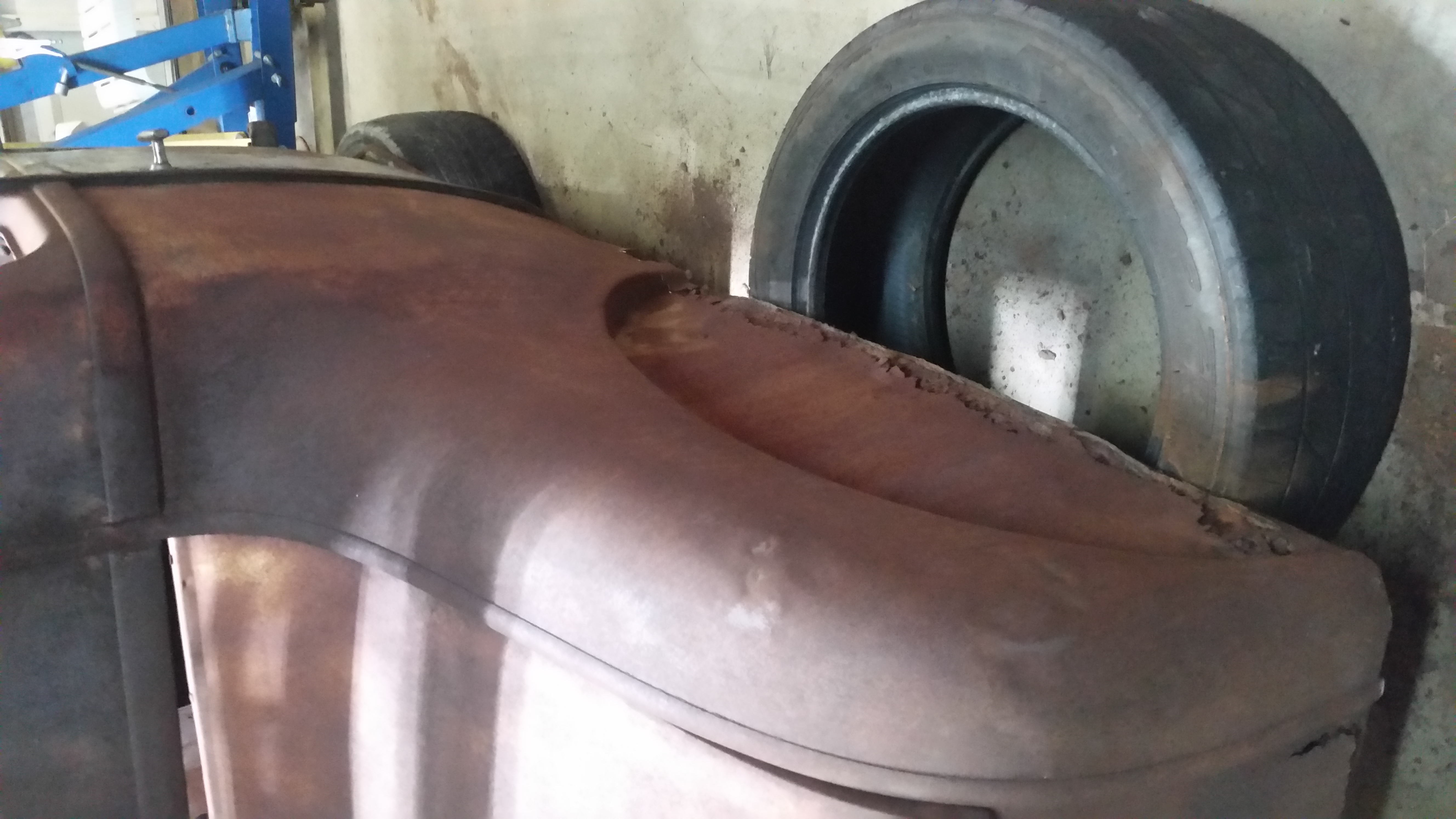

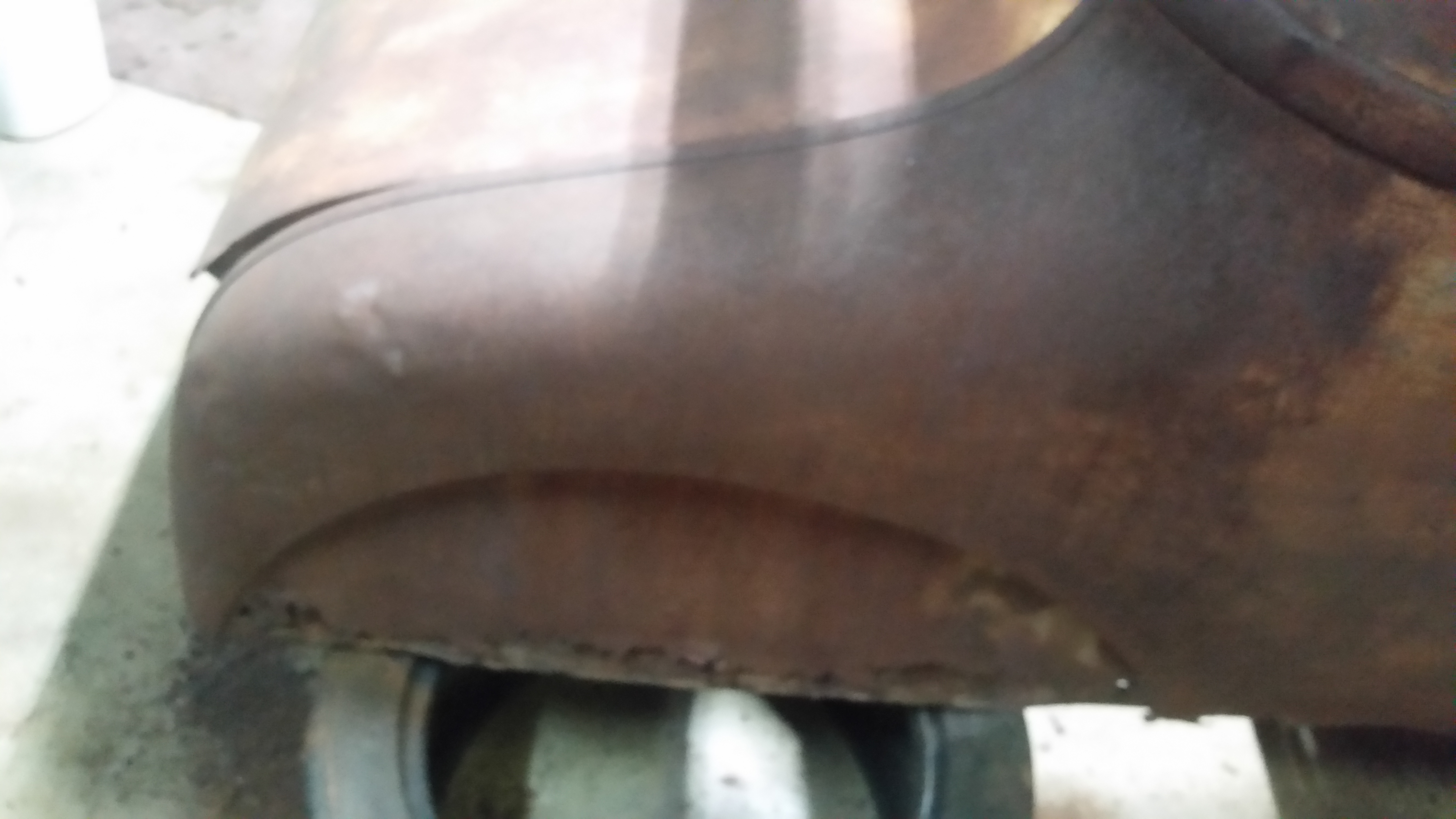

    Hammer and dolly work on the rear quarter panel turned out pretty decent today... Should be pretty good for the real body guy, when the time comes, but I still have plenty of rust repair to do yet...

  12. 27Roadsterguy
    Posts: 158
    27Roadsterguy
    Much better than the before...
