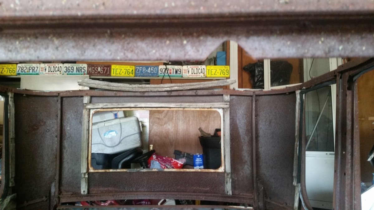

    look what Moose did to the cowl, looks correct to me, now tilt engine
    Stock Racer and exterminator like this.
  6. 27Roadsterguy
    Joined: Jul 12, 2013
    Posts: 158
    27Roadsterguy
    Yeah, I'd prefer to not cut the top of my cowl and doubt it'll be necessary, but if push comes to shove.....
  7. Nightheat Fab
    Joined: Jun 14, 2018
    Posts: 38
    Nightheat Fab
    I have that notch on my 27 it’s for the wiper that is attached to the window frame

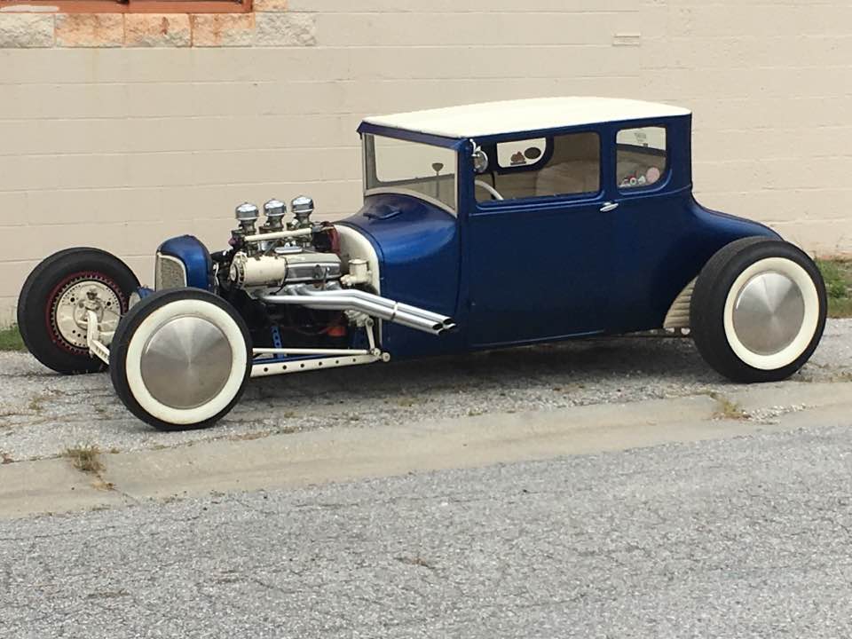

    Thanks. Some more advices from me.
    Theese cars run out of space quickly so keep the channeling to a minimum.
    So a angle on the frame is the right way to go.
    To keep the engine nice to the body you problaby need to modify the top of the firewall.
    I did reversed the upper part on my firewall to keep the engine where i wanted.
    Not the style you shooting for but this is how my mock up are today after many nights and weekends.
    kidcampbell71, cactus1, brEad and 5 others like this.

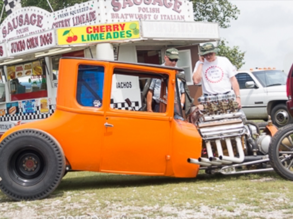

  26. 27Roadsterguy
    Posts: 158
    27Roadsterguy
    Just another "raked" T build that I love, this is a golden oldie...

    Almost forgot, I ordered that other Posies' rear spring (it showed up yesterday), I'm gonna be in much better shape now, for making everything sit the way I want it. My "hard to reach" goal, is to NOT Z the rear of the frame and to NOT make axle slots in the rear wheel wells. It's a real balancing act of measuring to get "the look" I am wanting. Keep in mind, I'm not trying to "duplicate" the orange car, I am just using that as a sort-of inspirational design. My plan all along, was to be able see the wheel wells and not have the back tire quite as far up the body line. I just hope I'm happy with it when it's bolted together...
    It's always a little unnerving building this stuff and "hoping" you're in love with the visions "of sugar plums" you've had dancing in your head. :)
