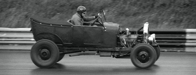

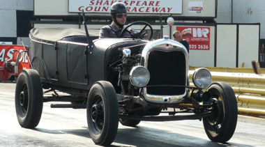

    Brilliant. I was hooning around in one just like that a few years ago. Great job. P1000549.JPG Nostalgianationals08009bw.jpg
