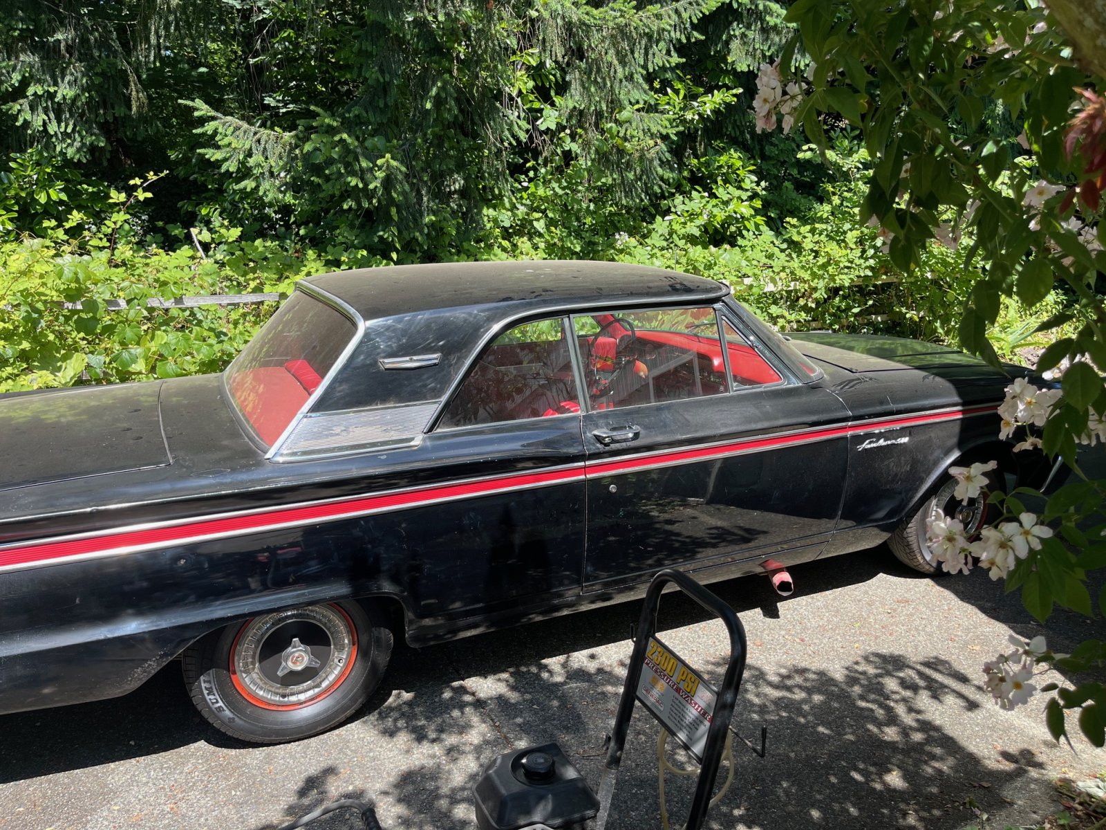

    Hi there, new to the forum and wanted a bit of advice. I just picked up a 63 Fairlane 500 - I had been looking for a new project and wasn't really particular about the make/model - cars of this era seem to come mostly in one of 3 flavors: restored / redone for crazy money, someone else's abandoned project / basket case, or a clapped out pile of rust. I just happened to find a complete original 2 door hardtop, complete down to the hubcaps, relatively unmolested and mostly rust free for a price I couldn't p*** up. I don't really have any immediate plans to "restore" it, just want to make it a cool old-school hot rod / driver.
    It was last on the road about 15 years ago so I've been going through it enough to get it on the road. It has what I ***ume is the original 260 SBF, and I did all the typical stuff: plugs, wires, points, cap/rotor and rebuilt the Autolite 2V carb. I've got it tuned and running pretty good - it starts with barely a touch of the key, idles nice at 800 rpm and has good throttle response. I cut off the old ratty cherry bombs and built a dual exhaust with Flowmasters the previous owner threw in, and it's actually got a great sound. I drove it for the first time today and while it runs good, it's pretty gutless ( I think the original HP spec when it was new was 160).
    I will say I'm not going to race it, don't need to make crazy power and I like the idea of keeping the original 260 but I'm going to need some more out of it to be happy with it. It does burn a little bit of oil so next on my to do list is a compression / leak down test, and I suspect dried out valve seals but we'll see. Which brings me to my question: What can I reasonably expect to get with the stock bottom end? I have a Wieand Warrior 4V intake and Holley 4160 4 barrel that will fit it, and I figured I could find some 60's 289 heads (the valves are a little bit larger) and have those worked over. Is there a mild street cam that with the above combination could get me 250-300 hp, or is that unrealistic and I should just build a 289/302 since there are a lot more options with that platform?
    Sorry for the novel, appreciate anyone's feedback...

    That’s a really nice coupe. It is by no mean a cheap car.

    Here are some more photos of the ol' girl...
    49Olds, Spooky, Aaron65 and 5 others like this.

    That’s a really nice car.
    Manual is a big plus.
    Being a manual car the 3.25 is decent.
