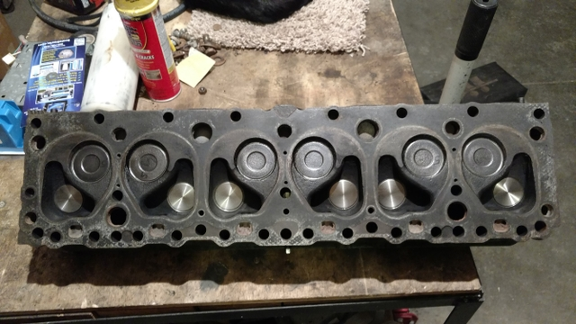

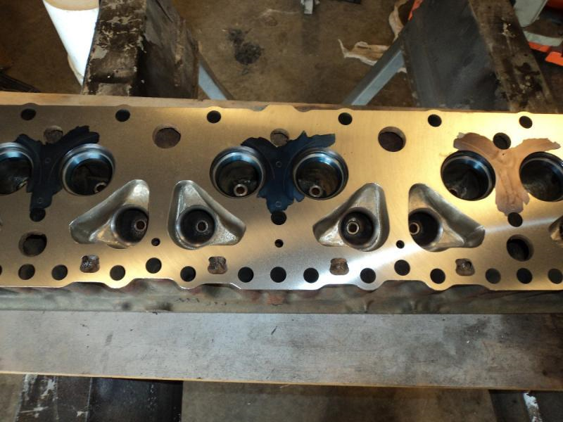

    There is no real difference in port or valve size between a 850, 913, or 848. Just the size of the combustion chamber. If you mill them, you lose the relief area from the intake valve into the combustion chamber. Top pic is a 850, bottom a milled 848. I'd rather use the 850 or 913 and use a pop up piston to get higher comp ratio. 850 head has the steam holes which must be drilled when adding an 848 to a 261.
