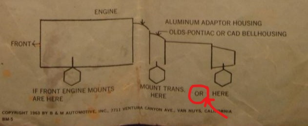

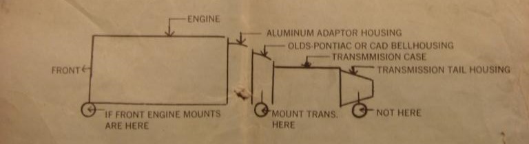

    I've been looking at MgtStumpy's posted B&M instructions and was surprised it says "OR" with the cast engine mounts
    this is closer to mine. but without large adaptor...
    Should I use all 3 mounts?
