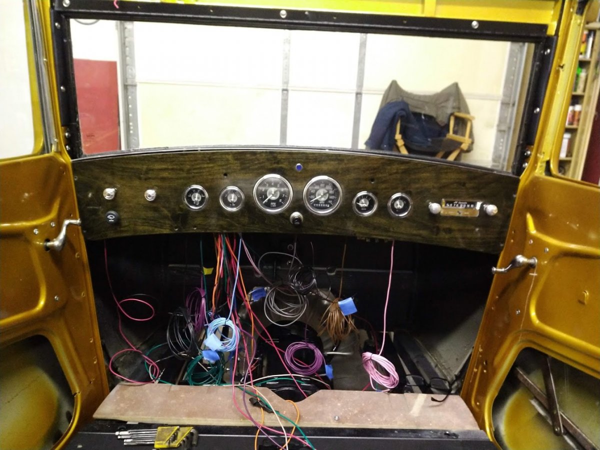

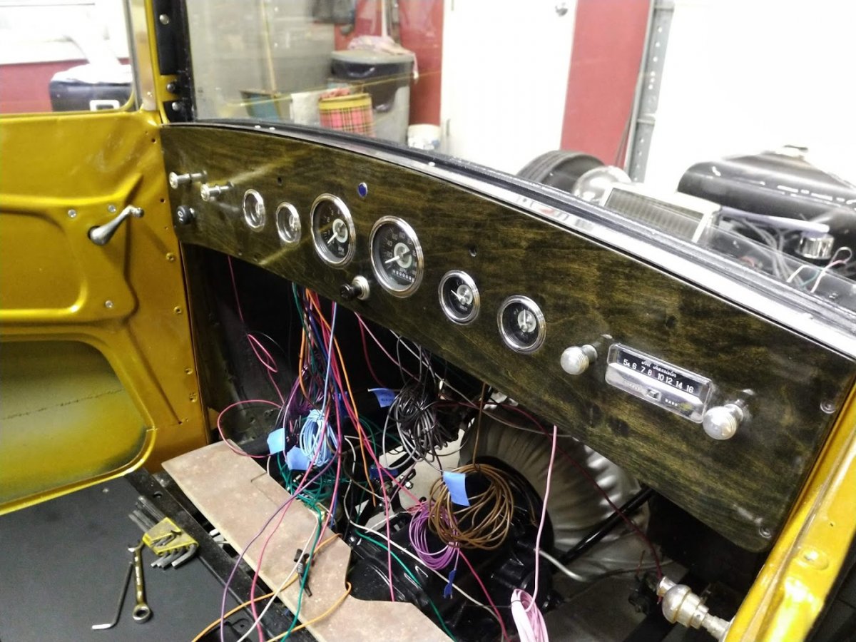

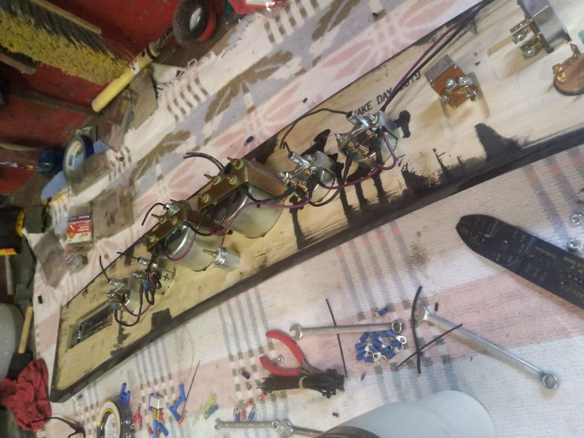

    Now for the part i hate most! I am way too OCD for wiring! It drives me nuts.

    Not much to report. Still pulling wires. Had to order a new blinker switch. It just came in. i needed it to run the wires to. should have most of it done this week. I did get all the trim around the doors in and found some NOS marker lights that match the originals that were used for the front signals.

    Almost completed with the wiring. Still have to install the flasher for the blinker and I have a couple gauge lights not working so I'll have to take care of that. other than that ready to finish installing the floor and start with carpet.
