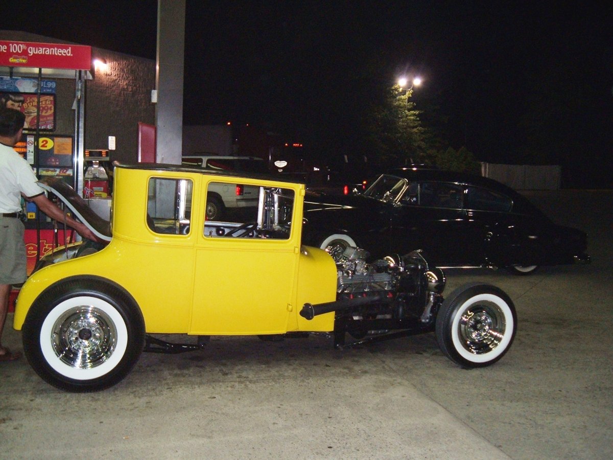

    Doubt anyone is interested (except maybe Ronnie! :) ) but I found these yesterday in box. Photos I took in photog cl*** in highschool. (1985) I traced the photos onto paper for a monotone sketch look. I eventually copied this onto the cover of my denim notebook. Which I still have. I'll have to go find that to add to the collection. I'm trying to put all of this together for my son so he'll have the complete history.
    Vic Walter, Tim, dwollam and 14 others like this.

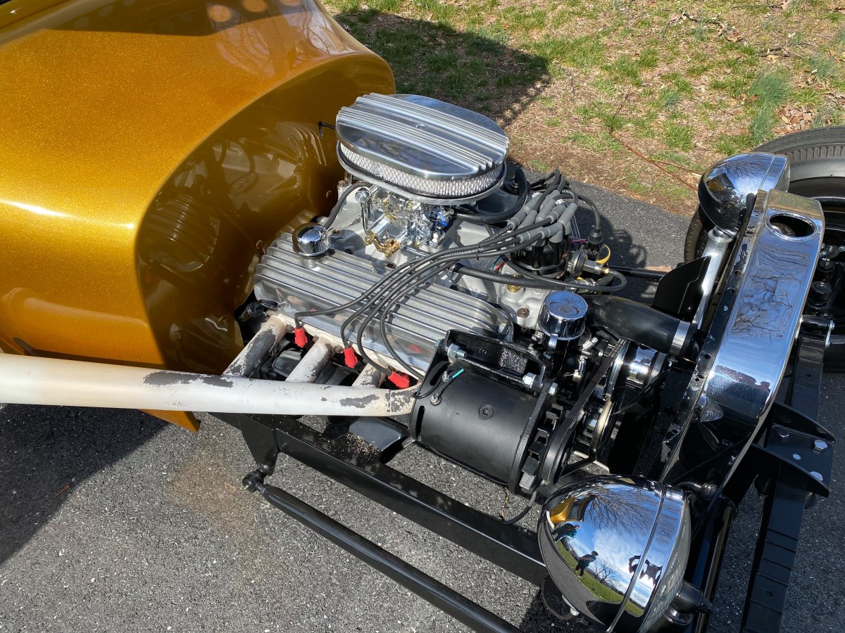

    Mee too Timmy!! Had it running yesterday! The acelerator pump wasn't working so I have to take carb off and give it going through.
    dwollam, loudbang and Ron Funkhouser like this.
  9. VA HAMB
    Joined: Jun 14, 2006
    Posts: 1,377
    VA HAMB
    https://photos.app.goo.gl/vvQ6UxuuCqkFGNJr5
    Well, it started. It ran for a while, although a little rough. We had a flaot that was stck so took the top of the carb off and cleaned out the bowls and jets and fixed the float. When we tried starting it again it ran for about a minute and stopped. Turned out the pump wasn't working so i I'll have to tear it all the way down and give it a good cleaning and maybe a new pump. the old ethenal gas does wonders on this stuff!

    Not much to report. I did get it running last week but wouldn't idle. Turns out the little ball under the squirters is missing. Not sure how that happened but new one on the way. Plus I switched manifolds from the last time I got the engine going and this one is leaking water from the rear corner so out it came and back with the old. I did get some more panels done.
    IMG_20200119_131913.jpg IMG_20200119_132034.jpg IMG_20200119_132359.jpg IMG_20200119_132700.jpg IMG_20200119_133657.jpg IMG_20200119_135240.jpg
    JUNK ROD, Stogy, dwollam and 7 others like this.

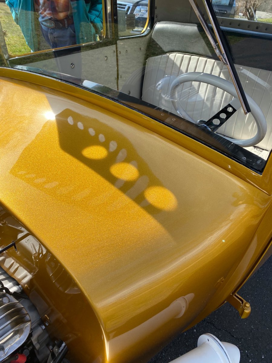

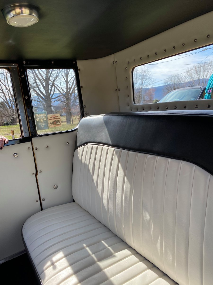

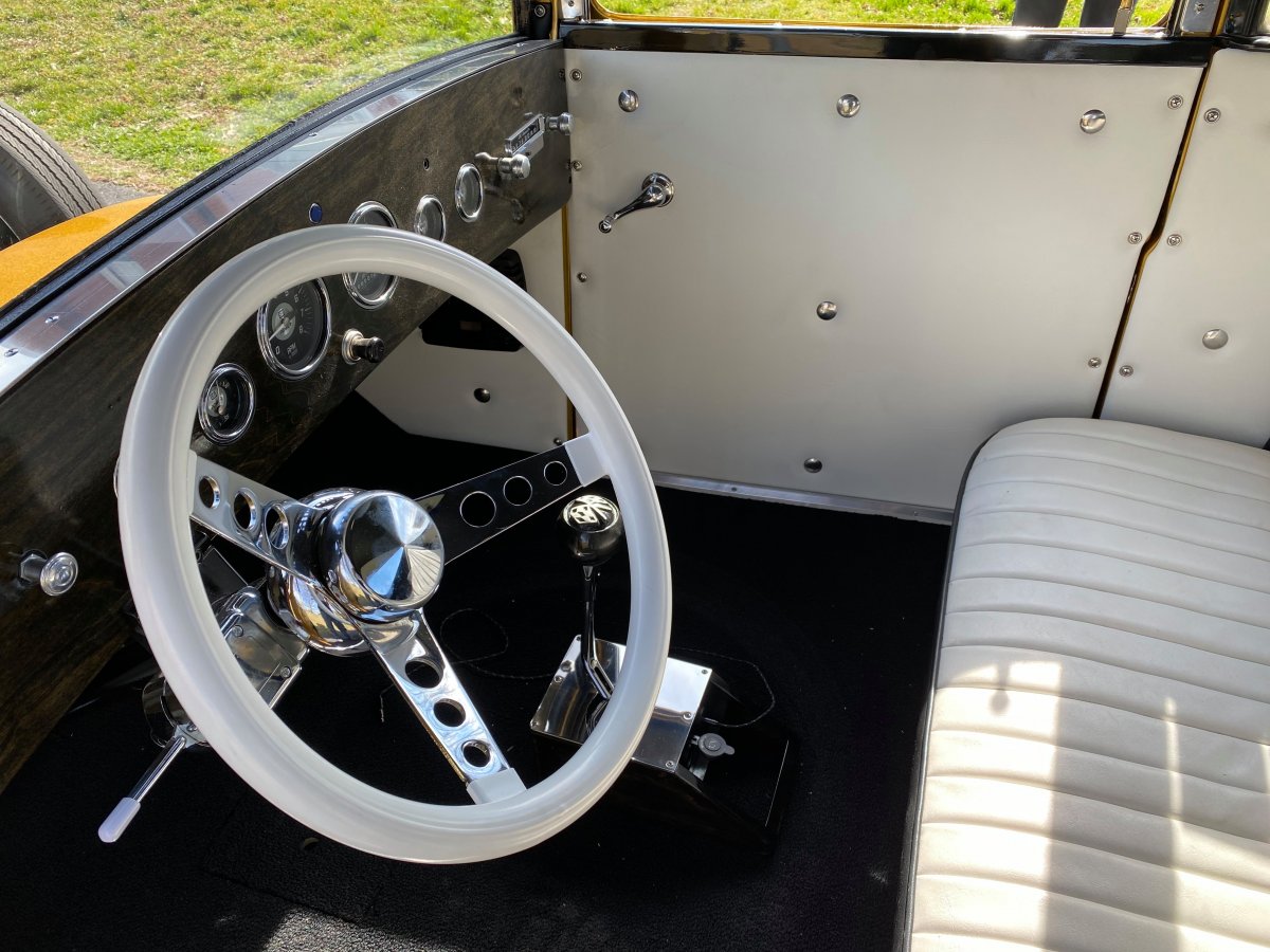

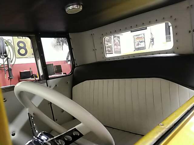

    Well I have been working on the interior. Not really something I would wish for but with limited funds you do what you gotta do! When I got the car out of storage the first time in 05 I had a bench seat recovered and the doors done. When I redid the car the door panel no longer fit and the old holes from the screws showed so i had to redo them. i did the door panels back the way they were in the 70's i would have done it in black but since the seat was white i stayed with it. Took me forever to find some ****ons! (I can't find the original ones)
    JUNK ROD, cactus1, Stogy and 8 others like this.
  14. loudbang
    Posts: 40,346
    Looks good. When you are driving it you won't even think about them :)

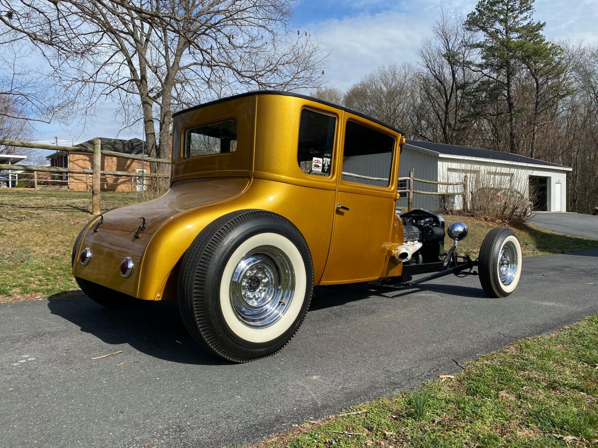

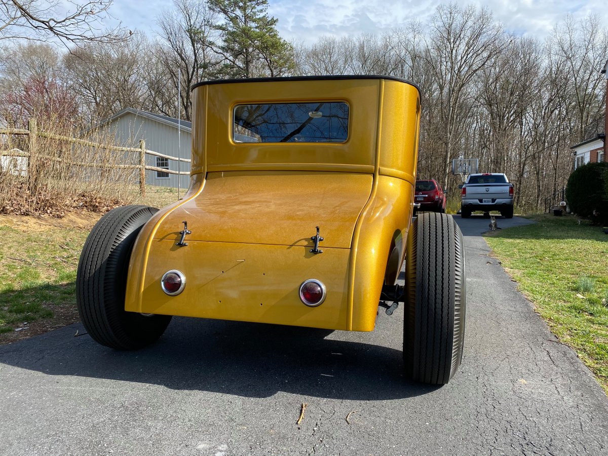

    Originally the rear gl*** was put in with an RV gasket. I thought this time I would put it in the original way but wasn't sure how to do it. I don't have an original frame to mount it or the money folks are asking for one. The repops are fibergl*** so that was out. So I had new gl*** cut and put the rubber on it and made a rear panel to hold it in place. I kind of over id it with screws so it looks like **** but it works great!
    T Pictures 007.jpg IMG_20200126_170922.jpg IMG_20200131_202058.jpg IMG_20200131_204417.jpg IMG_20200207_191615.jpg
    JUNK ROD, Stogy, AHotRod and 6 others like this.

    I really struggled on how to do the rear corner pieces. I finally saw an upholstery site where they talked about using ABS Sheet to mold shapes so i cut out a piece and heated it and rolled it over my leg and covered it. Worked like a charm!!
    IMG_20200207_141014.jpg IMG_20200207_142159.jpg IMG_20200207_151316.jpg IMG_20200207_152650.jpg IMG_20200207_155509.jpg IMG_20200207_155524.jpg IMG_20200207_191615.jpg
    JUNK ROD, Stogy, dehartcarl and 9 others like this.

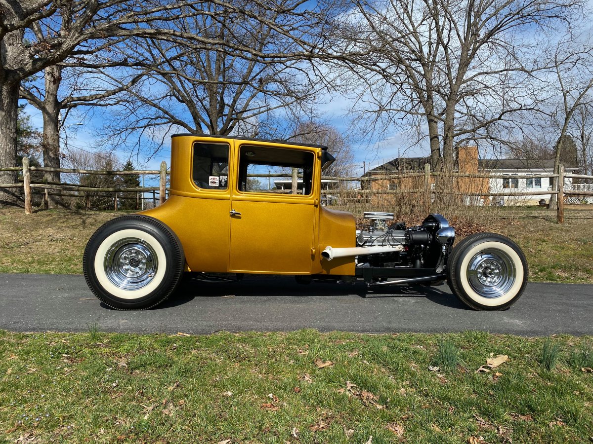

    Thanks for all the nice comments. I did the best I could with what I had. IMG_20200222_171818_390.jpeg IMG_20200221_185834.jpeg IMG_20200221_185916.jpeg IMG_20200221_185024.jpeg IMG_20200221_190554.jpeg
    Sent from my XP8800 using The H.A.M.B. mobile app
