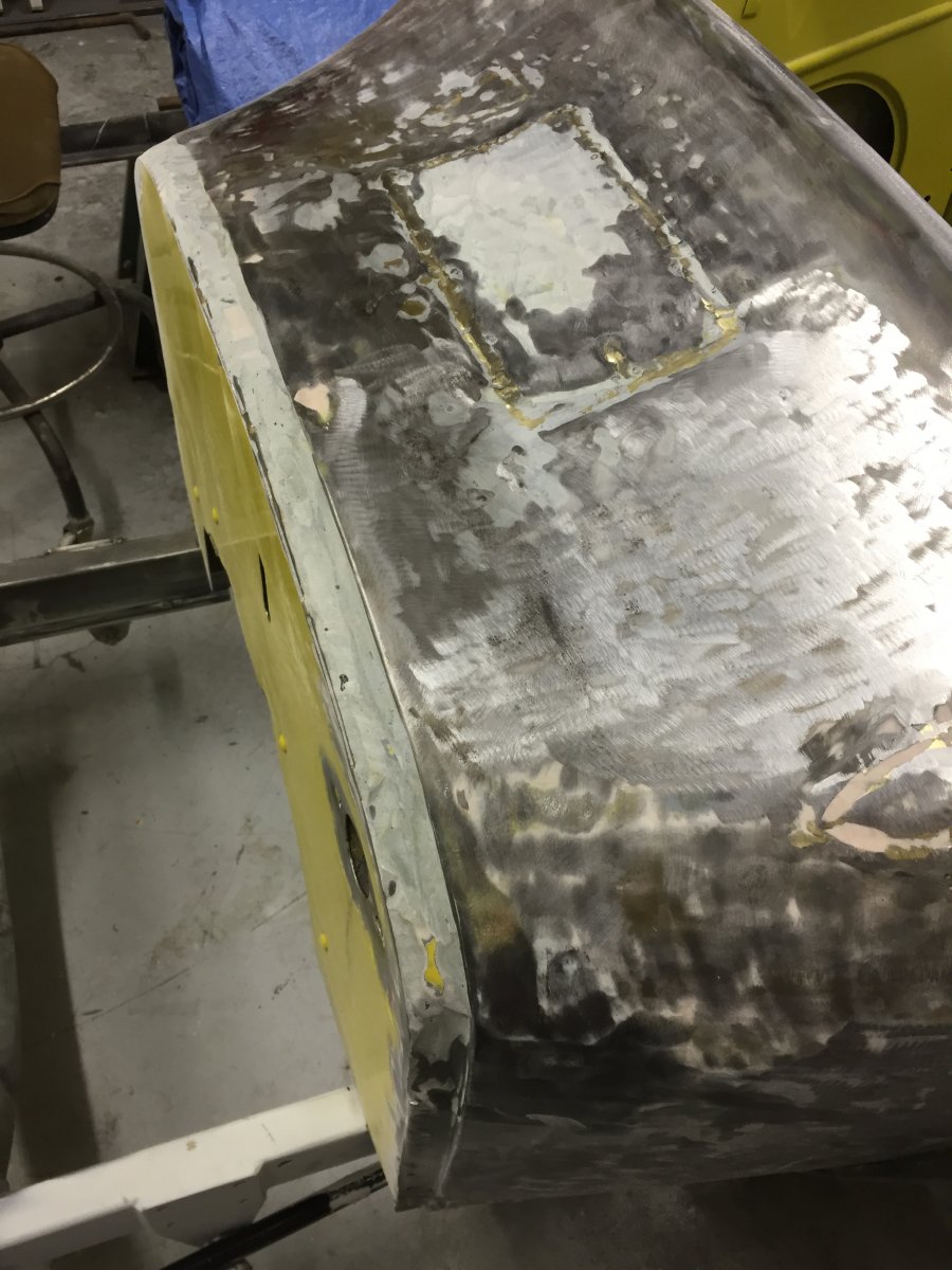

  30. VA HAMB
    Joined: Jun 14, 2006
    Posts: 1,377
    VA HAMB
    Another brazed patch job I had to remove. Not sure if you can see in the photo but I have peeled the patch panel down. IMG_6502.JPG
