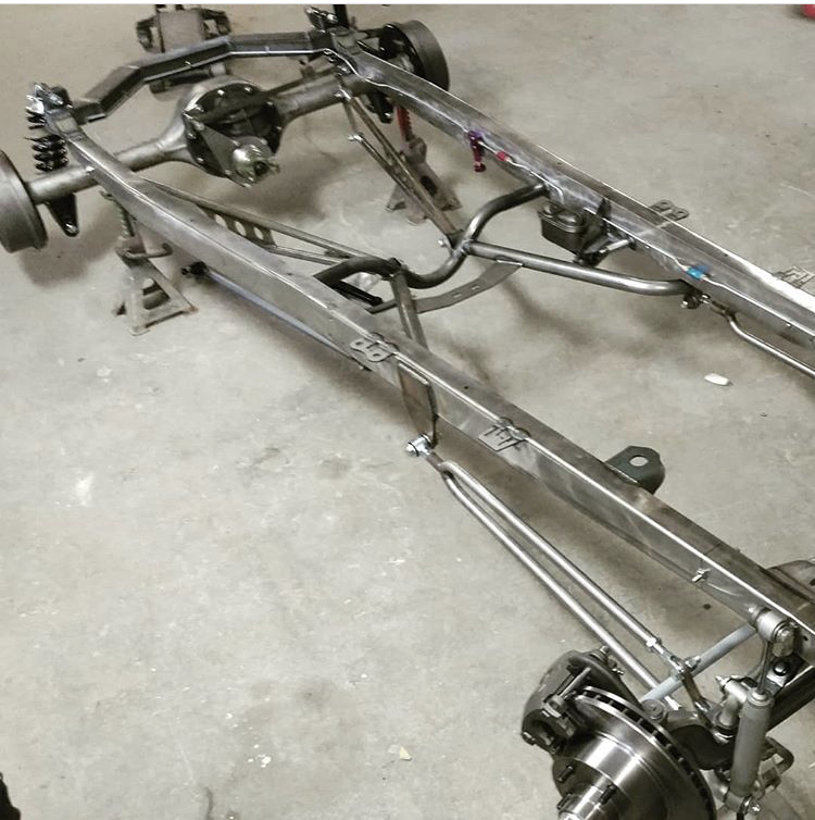

    As mentioned above, the A wishbones don't have a lot of caster built into them, so that might be why the originals were dropped so low at their back ends. Have you measured your caster with the new wishbones? Might be easier to fix (piecut) them now if they need some tweeking than once the car is completely done. Should be 5 to 7 degrees at ride height.
    Also, I hear you about your love of those rear ladder bars, but you really don't owe them anything. They look really weak, and have horrible geometry. If you ever noticed a hard ride in the back half of this car, I bet it's because the ladders don't allow it to articulate. Some new bars that point inward to the center of the car will give a better ride, and some real clevises attaching them to the rear axle will ensure the things won't come unglued from the axle housing.

  17. VA HAMB
    Joined: Jun 14, 2006
    Posts: 1,377
    VA HAMB
    Thanks I appreciate the info. I may have to re think the whole rear set up. I knew it wasn't ideal but it's what I had.
    I have given thought to the F1 box "hustle" idea for sure! :)
    Any suggestions on how I accomplish better geometry? I didn't want the bars outside the body and the frame prevents me from bring them together in the center. I don't mind different bars. I'd like the car to be right. Even though I REALLY don't want to have to repaint. :)

    I think you could probably leave you axle mount location the same and sneak them under your Z? Do a longer Pete and Jakes style ladder bar and attach them to that crossmember you added? That rear suspension isn’t going to compress very much in the real world so you don’t really need to have a ton of clearance above the ladder bar?
    Stogy and loudbang like this.

    4B45F1E9-2D59-4627-9D8B-356D23C04094.jpeg Like that more or less, drew it with a finger on my phone so excuse it not being exactly on point.
    Got a side shot of the Z in your frame with the existing ladder bars on so we can kinda see what your working with from a clearance aspect?

    49947B0B-35BE-40DE-A762-2E27887E51D6.jpeg Something akin to that?

    Tim's got it.

    Will do Thanks! I There's not much room at all. I'll see if I have a straight on photo. if not I'll snap one tonight. Can I use same bars or file 13 them?

    I think your current ladder bars have lived a full life and should be put to pasture.

    You can pretty much see what Im working with here.
