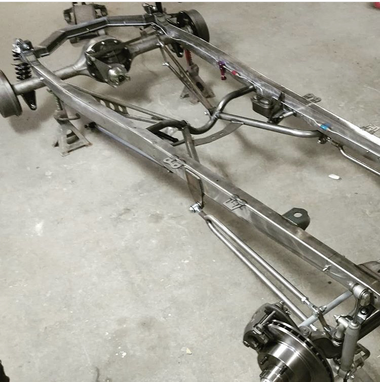

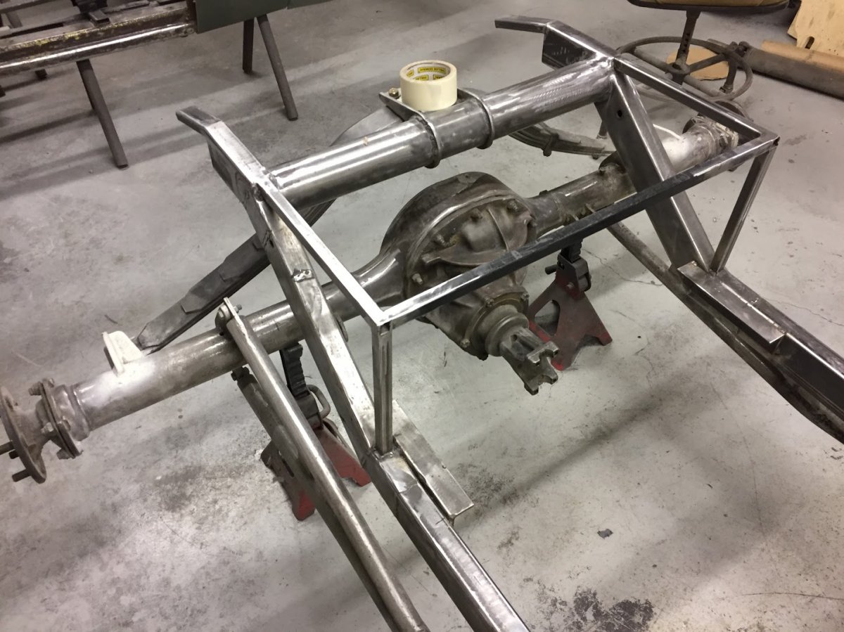

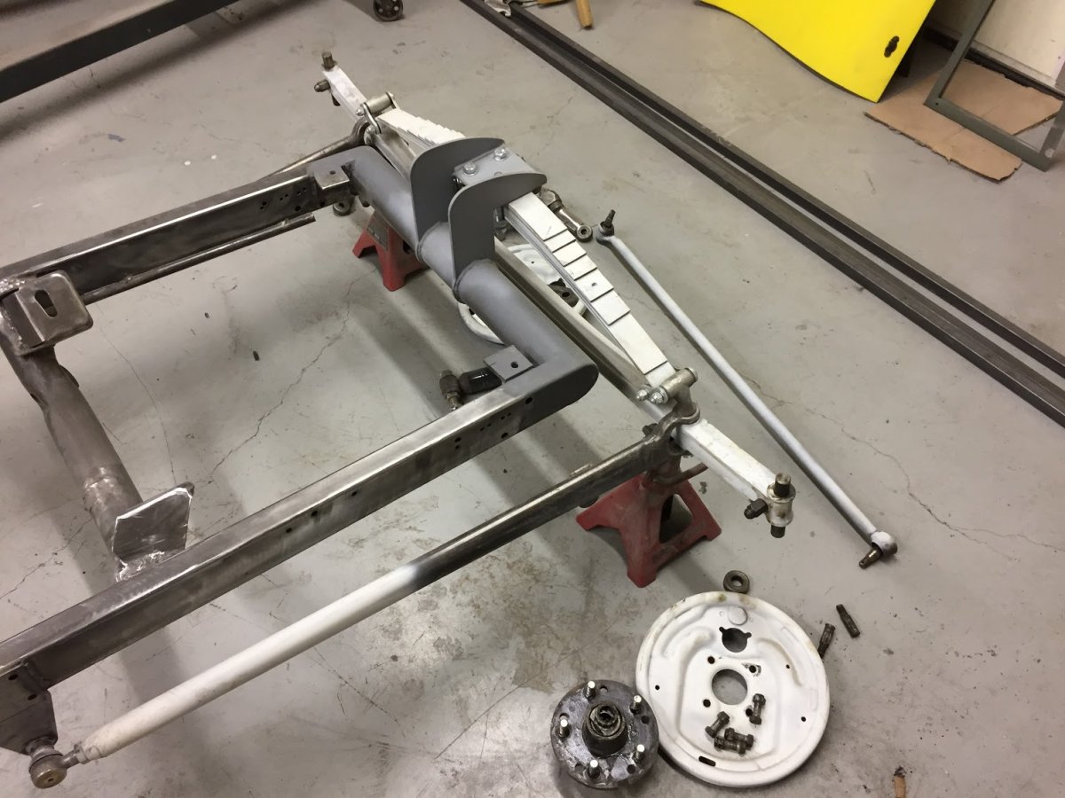

    I'm curious, if the front wishbones (?) are outside the frame, why do the rear ladders need to be inside?
    Stogy likes this.
  9. 31Apickup
    Joined: Nov 8, 2005
    Posts: 3,626
    31Apickup
    You can get away with it on the front as an I beam will flex, whereas the rear axle will not.
    Stogy and loudbang like this.
  10. tubman
    Joined: May 16, 2007
    Posts: 8,209
    tubman
    While the front suspension is not ideal either, it is less critical because a beam axle will twist slightly allowing some independent movement of the front wheels. Since it is a forging, it will take this slight flexing in stride. (I think we have all seen the picture of the Ford beam axle twisted 3 or four times.) The rear axle housing, being heavier and of tubular construct will not twist at all, which is the problem. For this reason, conventional wisdom says not to use parallel front radius rods with a tube axle because it is more rigid than a beam axle. See post #16 in this thread : https://www.jalopyjournal.com/forum/threads/twisted-beam-axle-safe.786627/
    ("31Apickup" beat me to it.)

    This is a great read. Pretty soon I will have to take my car apart and do the dreaded bodywork and am not looking forward to having parts all over the place. Everyone seems to be critical of your rear suspension - and I'm included in that bunch since my radius rods are angled towards the center too. But if you look at the suspension under an old Mopar "K" car, they have a dead axle back there with the control arms running parallel at the sides and I haven't heard of any issues there. Lot of T buckets were built this way. Where are the guys with first hand experience with this setup?
  18. alchemy
    Joined: Sep 27, 2002
    Posts: 22,672
    alchemy
    I had an old "T bucket" rearend, actually a beautifully fully chromed 57 Chevy rear, that had this exact same parallel ladder bar arrangement. Right next to one of the brackets was a crack running up the axle housing tube.
    Stogy and fiftyv8 like this.
  19. tubman
    Posts: 8,209
    tubman
    Killed in car accidents caused by failure of the rear suspension?
    GuyW and fiftyv8 like this.
  20. Blues4U
    Joined: Oct 1, 2015
    Posts: 8,068
    Blues4U
    from So Cal
    Guys, you're being ridiculous. There must be a million hot rods running around with parallel rear radius arms. Nobody is going to argue that it's the best way to set up a rear suspension, but it's been done countless times over the past 70 - 80 years, and the crashes that have killed the owners because of failed rear suspensions haven't made headlines. Go ahead, find all the news articles and post up the links here.

    Yea this had some cracks also. I do however have a 32 sedan with parallel ladder bars in the rear that was built that way in 1969 and I have no issues with it. Maybe I should look a little closer. This rear spring in this T is so stiff that I seriously doubt that the rear would actually move anyway. LOL! But seriously I'm still looking at how I may change it.
    Stogy and brEad like this.

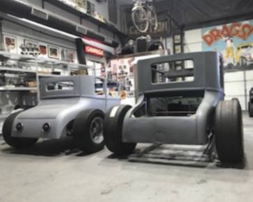

    Very inspiring thread. Don't mean to hi-jack you're excellent, but here's a shot of mine on the right next, to Mercury Charlie's T. We're working on them side by side to see who's can take longer. Ha.

    Awesome. I reallt like Charlie's T. I really want mine flat black like his. I just don't want to be a copy cat but I like the look. I like those those tail lights. They Galaxy?
