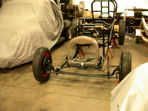

    Here's a couple pictures of the chassis that is now under that 27...with a banger.

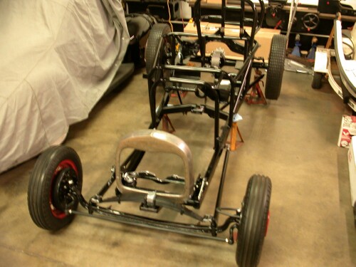

  3. TV
    Joined: Aug 28, 2002
    Posts: 1,451
    TV
    another

  5. hotrodA
    Joined: Sep 12, 2002
    Posts: 7,302
    hotrodA
    GREAT! That's what I was looking for; keep 'em comin' [​IMG] Thanks for the reply.

    HotrodA, you guessed it right that is the motor for it. The frame is a modified 29-A,running a T-5 trans and a Halabrand rear.The cal steering is a modified alum Ross.The bracket for the steering also holds the swinging peddles.The top of the cage is removable for street use. It is going to have a lakes type rad.shell and the doors will be welded shut.I have some other photos of different work that we have done if anyone is interested.-TV [​IMG]
