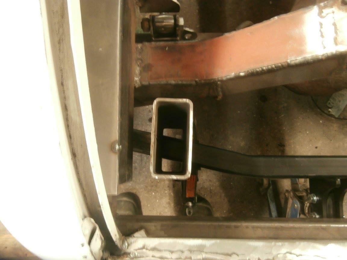

    One thing i have debated with my self is to mount a hitch or not.
    But its a good thing to have so i decide to have one to bring the trailer for longer trips.
    And i know at least one car from the era that had one to.
    So i bought one for Volvo 700 series to modify to my build.
    I cut the mounts off and keep the rest.
    Then i mocked it up with help of 3 jacks and measured for new mounts.
    I made them with the same tubing i used to the frame.
    And when all was done and welded it still fit as intended.

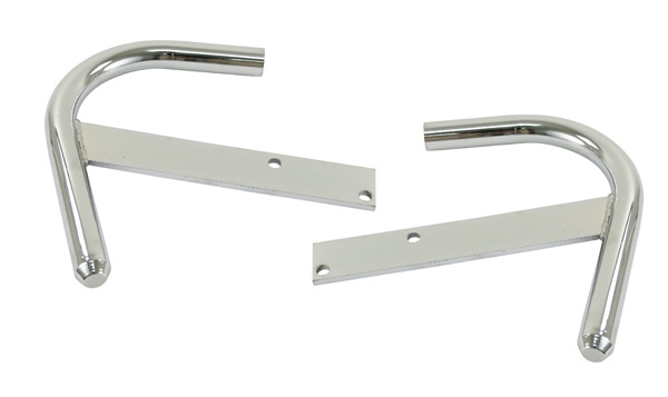

  8. AHotRod
    Joined: Jul 27, 2001
    Posts: 12,487
    AHotRod
    How about a nerf / bumper something like this Anders?
    brEad, Stogy, Tim and 4 others like this.

    I like nerd bars, bike fenders, bobbed rear fenders and other quarks (sp?) of the fifties and early sixties.
    But it's a look and feel thing, but in that era all has to look long, thin and lightweight.
    Look at how thin an early fifties car column is and how thin steering wheels of the era was. And the people [emoji33]
    And that is also why you attempt of nerf bars failed. If you you give it another go, remember there only to comply with the law, but has to be as light and simple as possible.
    So if you find the smallest avalible tube, and then go a little up I wall thickness, you should be golden.
    And if you can bend it in a nice big radius it should work. And look era correct, but I wouldn't do nerfbars without fenders. The look so good together.
    Then I would go for the ones often seen on VW bugs cal looker.
    They give the look of they can double as a point to push start the car on the lakes.
    But only on the rear, spreader bar in front should do the part.
    Unless you bobbed the horns or go to suicide mount.
    I can't remember what you did.
