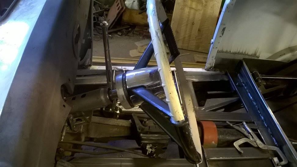

    This week i have worked with the steering.
    I was feeling real lucky when i found out that the 3/4 DD shaft was
    nearly a bolt in to the Volvo Hardy disc.
    It just needed some grinding on one of the D's to match.
    I got a Borgeson joint for the steeringshaft.
    The maximum operating angle they allowed is 35 degrees.
    So i did a serach on internet and write out a pic of a angle thingy. (Dont know what its called)
    I allso prepared the suport for the shaft.
    Then i cut out the angle thingy to sheck so i dont get to much angle.
    I landed around 30 degrees angle.
    So for the first time the steeringwheel is connected with the steeringbox.
    I then mounted the last steeringrod so i could twist the steringwheel and see the spindels move.

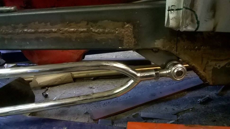

    I have a P&J Panhard bar for the frontend i intended to use.
    I dont know if the aftermarket steeringarms are longer than Ford orginal.
    But when i turned the steering max the gap betwin steeringrod and frontaxle
    was to narrow for the left mount.
    I am not sure i really need the Panhard bar anyway so i start without it and see how it handle.

    You can move the frame side panhard bar mout up for clearance. I had to do the same thing on the belly ****on. Like you said, you have clearance until you turn the wheels fully. If you still want to run the panhard bar, just cut down the frame side mount so it puts the bar up and out of the way. You're doing a great job! I have been looking for a coupe body myself.... You're making me want one pretty bad....
    AndersF likes this.

    Allways learn something new. Thanks.
    I am preatty sure the tech inspector wont be happy if i mount it in a angle.
    I try without and see how it handle.
    I think it clutter up the frontend anyway.

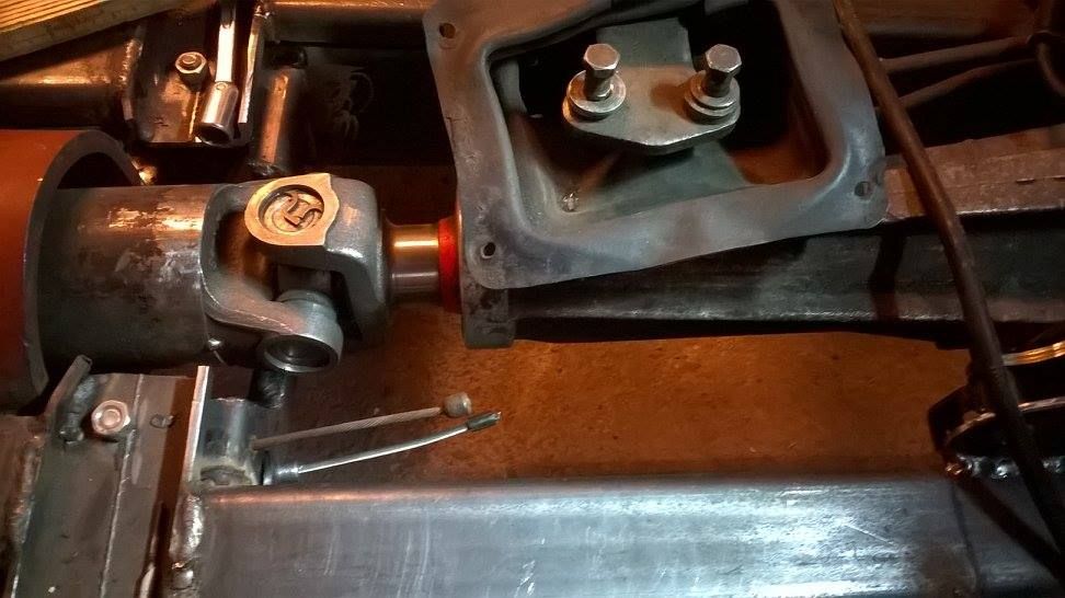

    One of the things i need is a parkingbrake.
    So i bought a Lokar for transmount.
    But i dont have a Lokar shifter so i had to make my own mouningtab.
    I could then make the endpice that close my X-member under the u-joint.
    The 2 small holes are to mount my brakecabels for my parkbrake.
    The right side rear cabels for a Dodge B250 Van reach all the way
    from both sides.
    So now is it just the pice that connect the cabels to the handle thats missing.

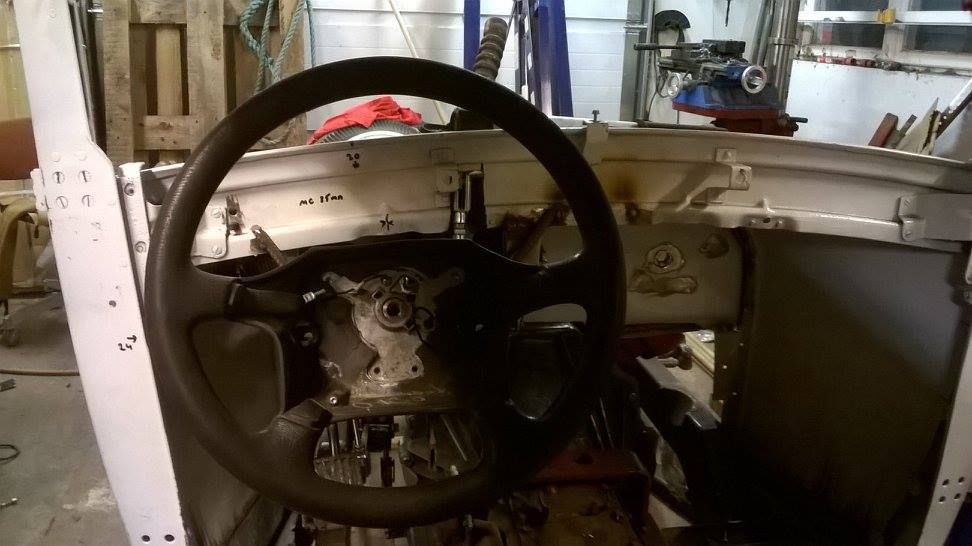

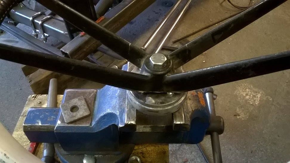

    I had to make a adapter to fit my good looking steeringwheel to my steeringaxle.
    Took the Volvo steeringwheel and cut up some plastic on the backside to acsess the four spokes.
    Then cut them off to remove the center from the steeringwheel.
    Then some hacking with varios tools to trim it down where i wanted it.
    I belive the pics show rather well how i did.

    Love the steering wheel - I did something similar to mount my Lokar emergency brake handle.
    volvobrynk and AndersF like this.

    Nice work on the steering wheel adapter, very clever
    AndersF and volvobrynk like this.

    Start to look like car now.
    Getting something done on yours?
    I was very happy when i found the steeringwheel.
    Had seen it in some builds and was my no:1 choise.
    And suddenly one was for sale here in sweden.
    A bonus is perfect size for a T.
    If no one make the parts you need you just have to try to make them yourself.
    Still wery ruff so it will need some more work done.
    The brake and clutch pedal is from a 245.
    Got the stuff for free and problaby better then aftermarket made i china.
    Yes, The steeringwheel is for boats and made in alu.

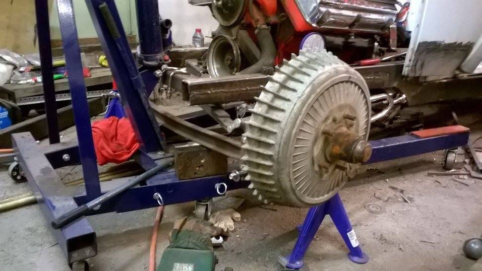

    Have been working with my front brakes.
    I need to adapt my Buick backingplates to Ford spindels.
    So i took a bit of heavy gauge sheetmetal and cut the centerhole.
    Clamped it to my spindle and used my handhold drillmachine with a drill same
    size as the boltholes on the spindels. Then just drilled in every hole long enuff
    to get a centermark.
    Then i took a small drill to do centeringholes before drilling the final holes.
    I could then bolt the plate to the spindle.
    Next i have to cut out the center of the backingplate so the spindle go through.
    Then i put the spindle through the hole and put it down in the drum.
    Mounted the spindle in the drum with the wheelbearings to get the right position.
    Then centered and chimmed the backingplate to the drum.
    Could then tac them together before i took it all apart for final welding.
    I had to do some minor adjustments after the welding but other and that it worked great.
    One side down and one more to go.
