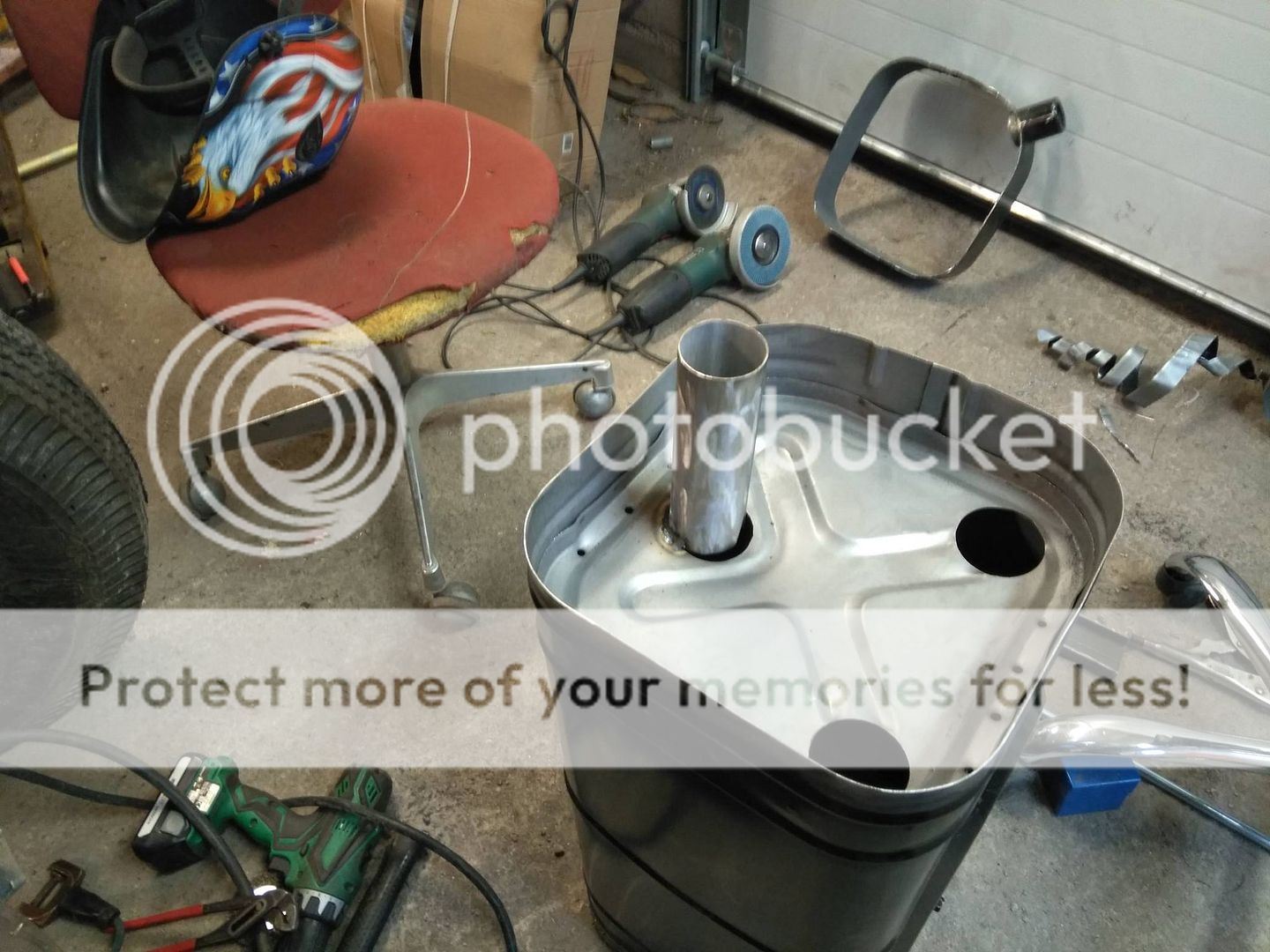

    I started with the floorpan behind the seat where i allso wanted the gastank and battery to be.
    Next task was to cut the tank to fit with the battery. I allso needed to relocate the filler.
    Then i bended up the supports for the tank and m***aged them around to fit.
    Then i could weld them to the floorpan.
    I allso needed to make a hole were the bottom pan on the tank is.
    But when i testfitted it all i got interference problem with the backrest against the tank.
    So i did some cut outs for the exhaust in order to move it all backwards.
    Then i found out the bends on the exhaustpipes differ a bit betwin the sides.
    I had to take the drivers side down and reshape it a bit to gain another 7/8 backwards.
    All this made my floorpan about 1-3/8 to short but started with plenty to remove.
    But i can now tilt the backrest to where i want it to be.
    Made some tankbands and brackets with reinforcements to mount the tank.
    Allso made a batterybox in sheetmetal as a extra protection betwin the tank and battery.
    That needed to be bolted. I am not sure i can put the tank in and out otherwise.

    I have rebuilt the brake setup for the mastercylinder.
    I used a mastercylinder for Dodge Dart 67-70 drums front and back.
    Modify them for remote filling.
    I started to finalize the clutch this winter.
    Came this far but could not get the linkage to the pedal to work properly.
    So i bought a hydraulic system to install.
    So it was just to modify the clutch setup to accept a hydraulic mastercylinder.
    To get the pedal at the right place when the clutch is released i tacked the pedal where i wanted it.
    The i could build the ***embley.
    Then i could mount the remote fillercup for the brakes and clutch.
    So now i got two of three pedals in place.
    Hopefully for good now.
