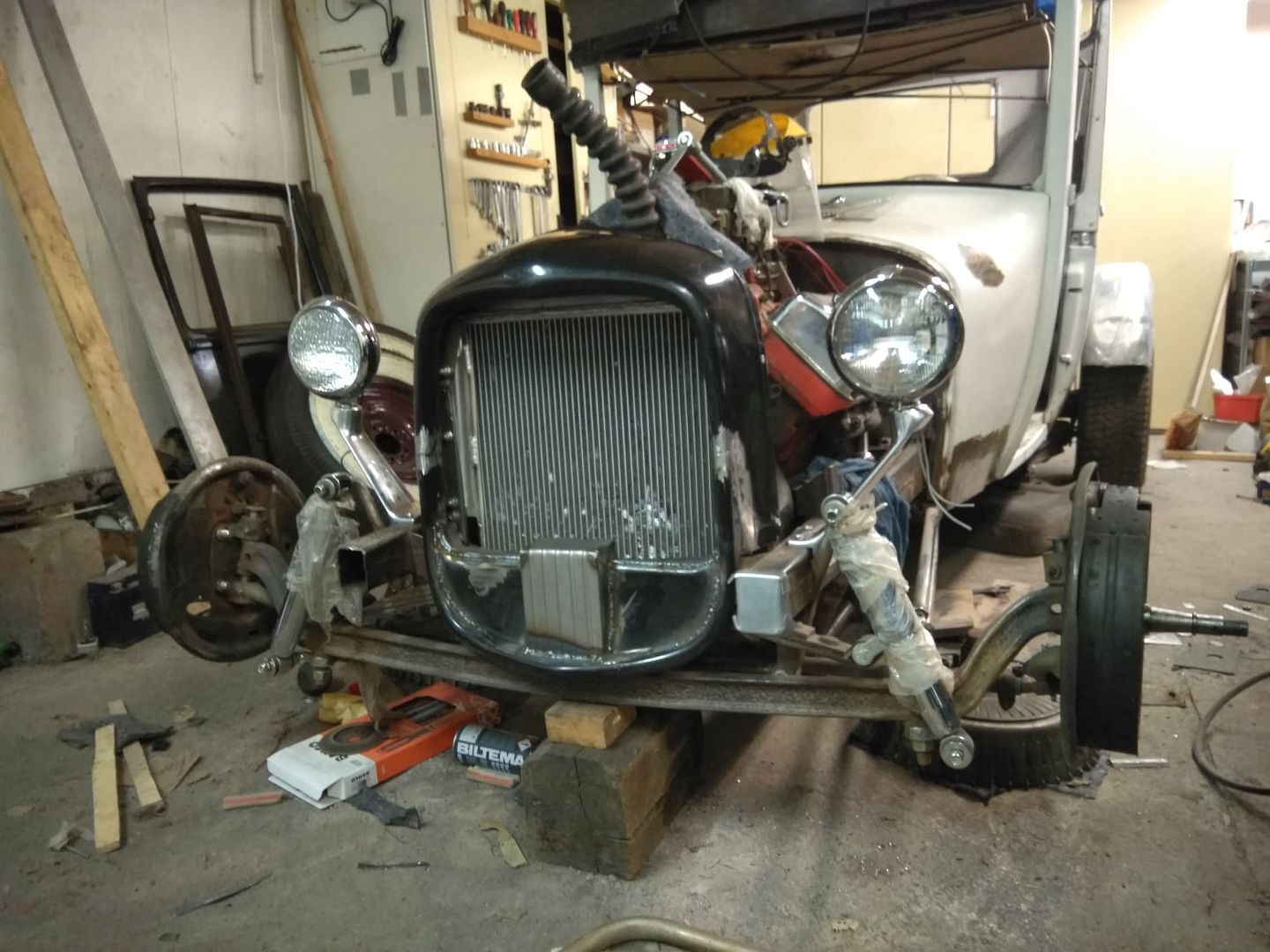

    Have been staring at my grilleshell for a while.
    It was just chopped off to serve as mock up.
    But how to finnish it? Straight edge or use the pice i cut off?
    This dont look bad at all but my crossmember and springclamp is in the way.
    But i decide that i could modify the bottompart to fit so i welded it together.
    I cut off a pice to clear the springclamp.
    Cut the sides and bend them forward to clear the crossmember.
    Took a pice of sheetmetal to make a cover for the springclamp.
    Made some beads and folded the sides.
    Could then start to fit it in place.
    Could then fold the top and weld it all in place.

  13. Stogy
    Joined: Feb 10, 2007
    Posts: 27,523
    Stogy
    You made the right choice @AndersF...looks real good...quit hitting your rad...:D

  15. 26 T Ford RPU
    Joined: Jun 9, 2012
    Posts: 12,952
    26 T Ford RPU
    I couldn't make up my mind what looked better but after seeing what and how you put the lower section on i can say you did good. It looks right. :cool::cool: JW
