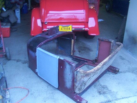

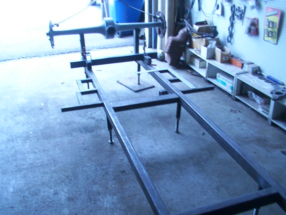

    Ever since the Showdown 2010 i been gathering parts and pieces to build a modified.
    I gathered an old XKE twincam 6cyl, a model 'a' frame, some wide5 stuff and about a month ago came across a '27 touring car cut down for a body.
    So i started the build...i am not much on explanations, so are on your own to figure out what i'm doing - you have a question i'll be happy to answer. My shop is dirty so if you want to follow a build with glistening floors and tools aligned by size on a bench - you are in the wrong place.

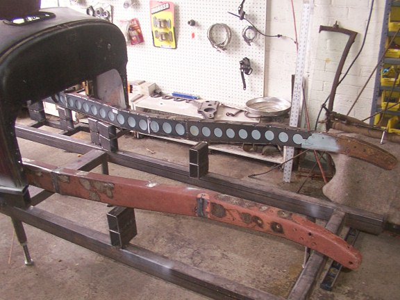

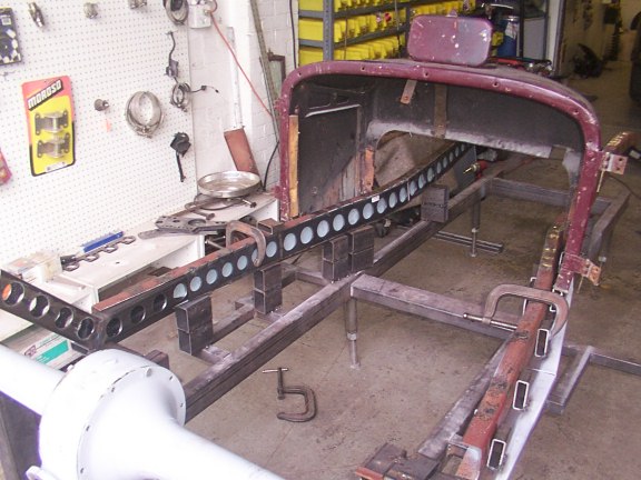

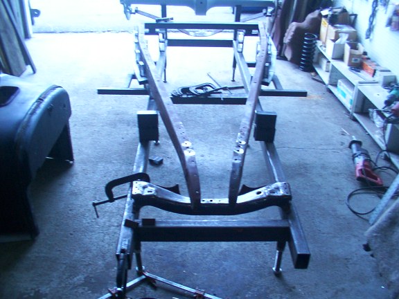

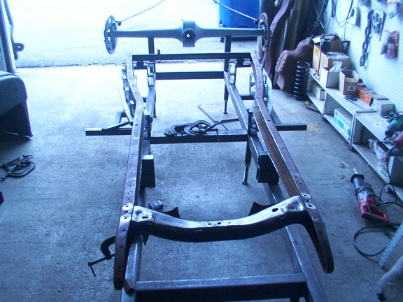

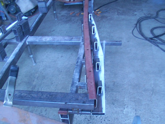

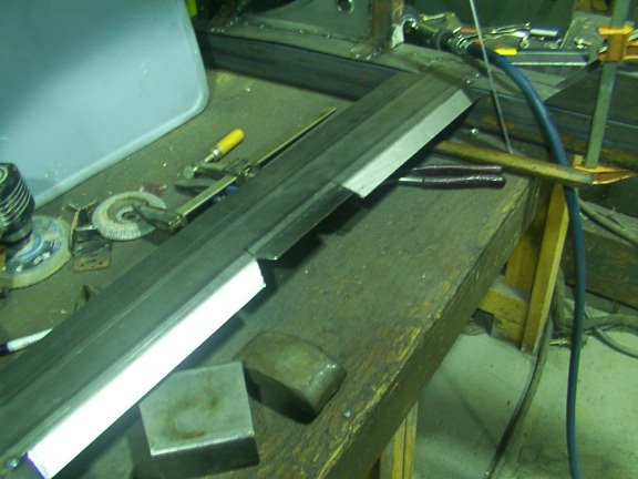

    A few more showing frame development.
  3. oj
    Joined: Jul 27, 2008
    Posts: 6,598
    oj

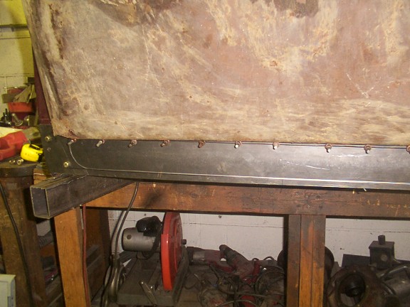

    Frame needed a lot of work

  5. Cool! Looking forward to the progress pics. Did you make those boxing plates? How many hole saws did it take? ;):D

    Take nothing for granted, especially with a '27 on A rails. (no different from anything else, really, BUT!
    Notice the excessive taper of the frame staying within the rocker and cowl lines (top view) Looks like everything can squeeze in there, right?
    Be sure everything fits within the narrow front...Nose will cover, but make doubly sure the radiator will fit between. (if it is to sit on top, it will be Midget-Short!)
    Allow for a ***tet of headpipes to drop inside the frame rails, and the carbs are also within liveable parameters.
    (ask me how I know...)
    I'm excited about this build, the Jag is a beauty. (I also have '27 T's, 4 of 'em. Coolest hot rod going, if you can fit in it!)
    Nice frame jig, too.
    Lay out the whole car, you will stumble across stuff that you didn't anticipate...I promise.

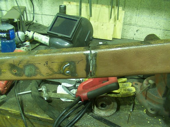

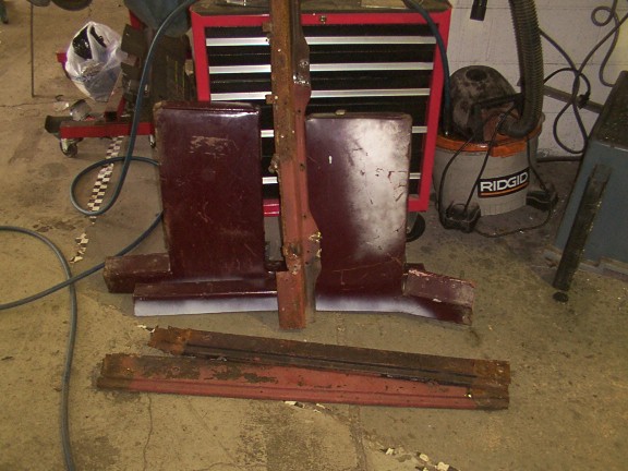

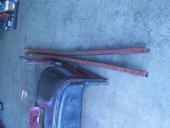

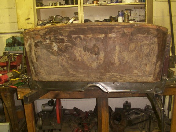

    The above pic is an intermediate step in the framerail development. I had finished reforming the rearward section and that toe'd in the front - as seen in the pic. I then made a small cut in the frame at the firewall and brought the rails back to the stock crossmember. I also made two 7deg piecuts in each framerail, the first about 4" after the firewall to raise the frame and the 2nd about 8" behind the crossmember to bring the crossmember back to the original Ford angle. Theres a couple pics showing this process, and a pic showing a modified framerail sweep and an unmodified one.

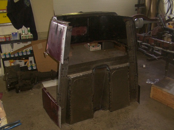

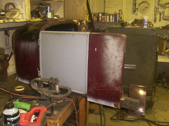

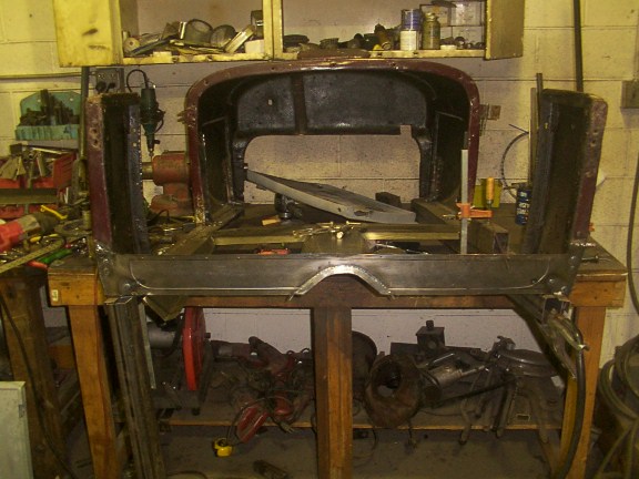

    Heres a few pics of the body, i blew it apart and am in the process of building it for the ch***is.

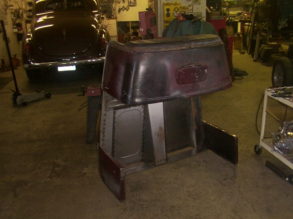

    A few more body pics.

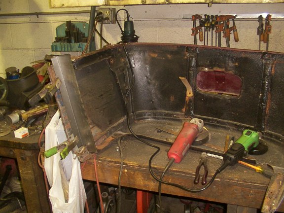

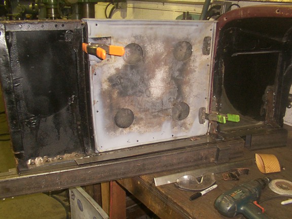

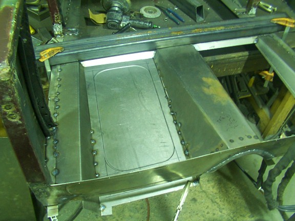

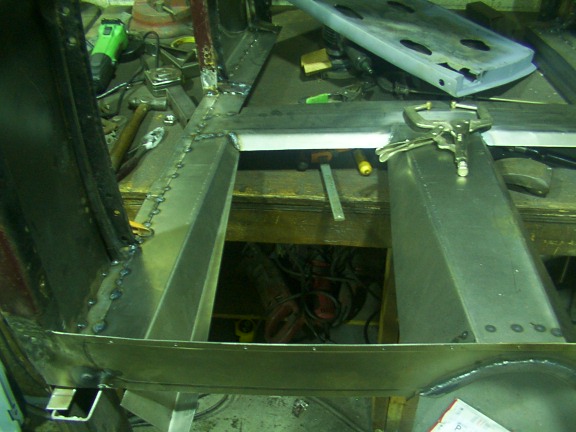

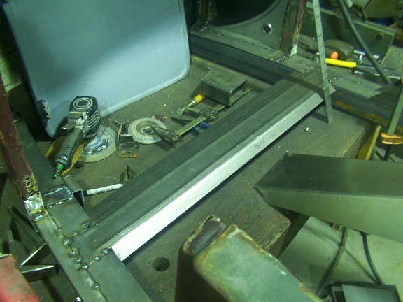

    A few more. If you've noticed i have done away with the original subframe. To put the strength back into the body most of what you are looking at is 16ga steel.
    The other thing is that when i reformed the frame rails to match the body i opened the center area up, the seats will be below the top of the frame rails and that is what you are looking at being formed. The 'tunnel' is not for the driveshaft - it is for a suspension piece, the driveshaft will be above that tunnel.

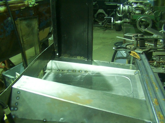

    I finished the seat pockets and drug it over to the frame.

    Your flooring and seat pockets are works of art. My '27 tub has a very tired subframe I was going to repair...
    I think I'm going to compliment you and imitate your 16 gauge runners and lower boxing!
    Superb save for a 'T' body.
    I did an 'A' frame for my '27 bobbed roadster...when on my frame jig, I removed the body and glanced at the frame rails...they looked like an "A"-member for a Navajo teepee! (I did the 'Vee' at the firewall, and brought them forward...but they sure were a t****zoid before I brought 'em out at the firewall! Optical 'delusion'...) LOL

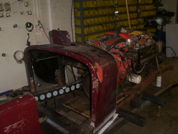

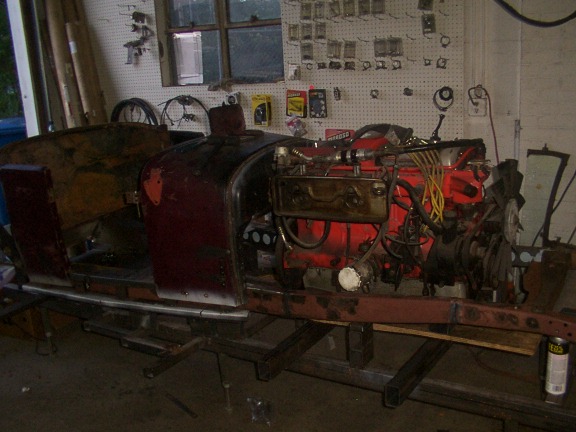

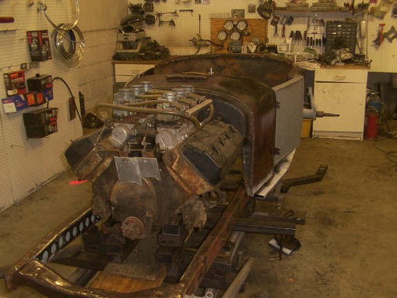

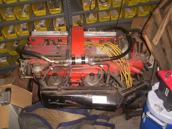

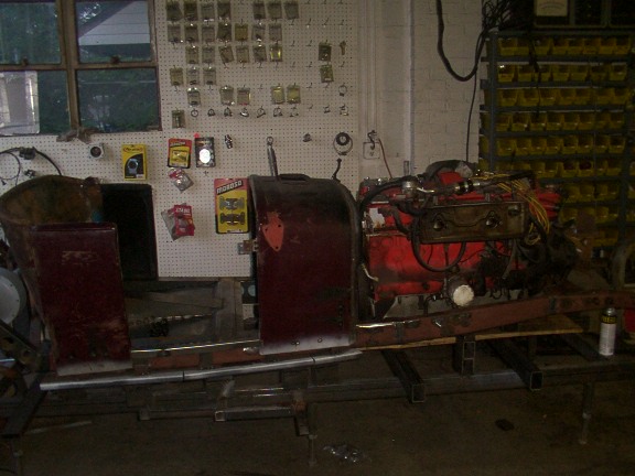

    I think i have found out why these engines aren't common in hot rods. I'm kinda bummed out right now, but would value your opinions on which way to go. I set the motor into the frame rails last night, i knew there were height problems and it was kida long but....
  22. Rex Schimmer
    Joined: Nov 17, 2006
    Posts: 743
    Rex Schimmer
    from Fulton, CA
    PFU!!!! Pretty ****ing Ugly!!! Time for a nice 4 cylinder.

    That pretty well summed it up for me too, PFU.
    Whad'dya think, an iron duke? one of those mercruiser ford 1/2 of a 460? anybody got an old dirty offy-drake under the bench to cut loose?

    OJ,
    Don't give up yet. Can you:
    -Lower the engine a little down between the frame rails?
    -Raise the body (un-channel it) just a bit?
  25. Boones

    Yep OJ, you've got your self a situation. When I looked at the first pic I thought "Holy ****, I don't remember him putting a Detroit Diesel in there!".
    It's way too big proportionally for the body in my opinion. I think Just Gary is right, un-channel the body and lower the engine to get a new perspective. It may still be too big, but I think these two items will really help the flow of the car.

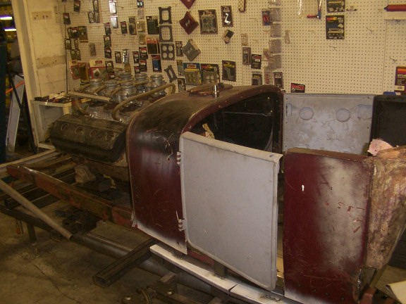

    Well, that Jag is one neat engine but it just wasn't right. How about this one? Am i back on the right track boys? Are we getting somewhere now?

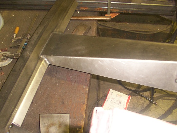

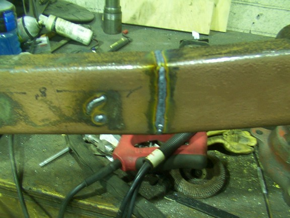

    A brief update, between the jag and the hemi i welded the frame boxing members (man did that shrink the frame rails!, got a problem to solve there), i finished the rear kicks and have a nice rear crossmember and a real nice open drive banjo.
    The engine came with an offy adaptor to bolt a '37ish toploader and an aluminum flywheel. It came from an old g***er and been sittin under a bench for decades.
    A little bit of luck and i'll have a roller by next week.
