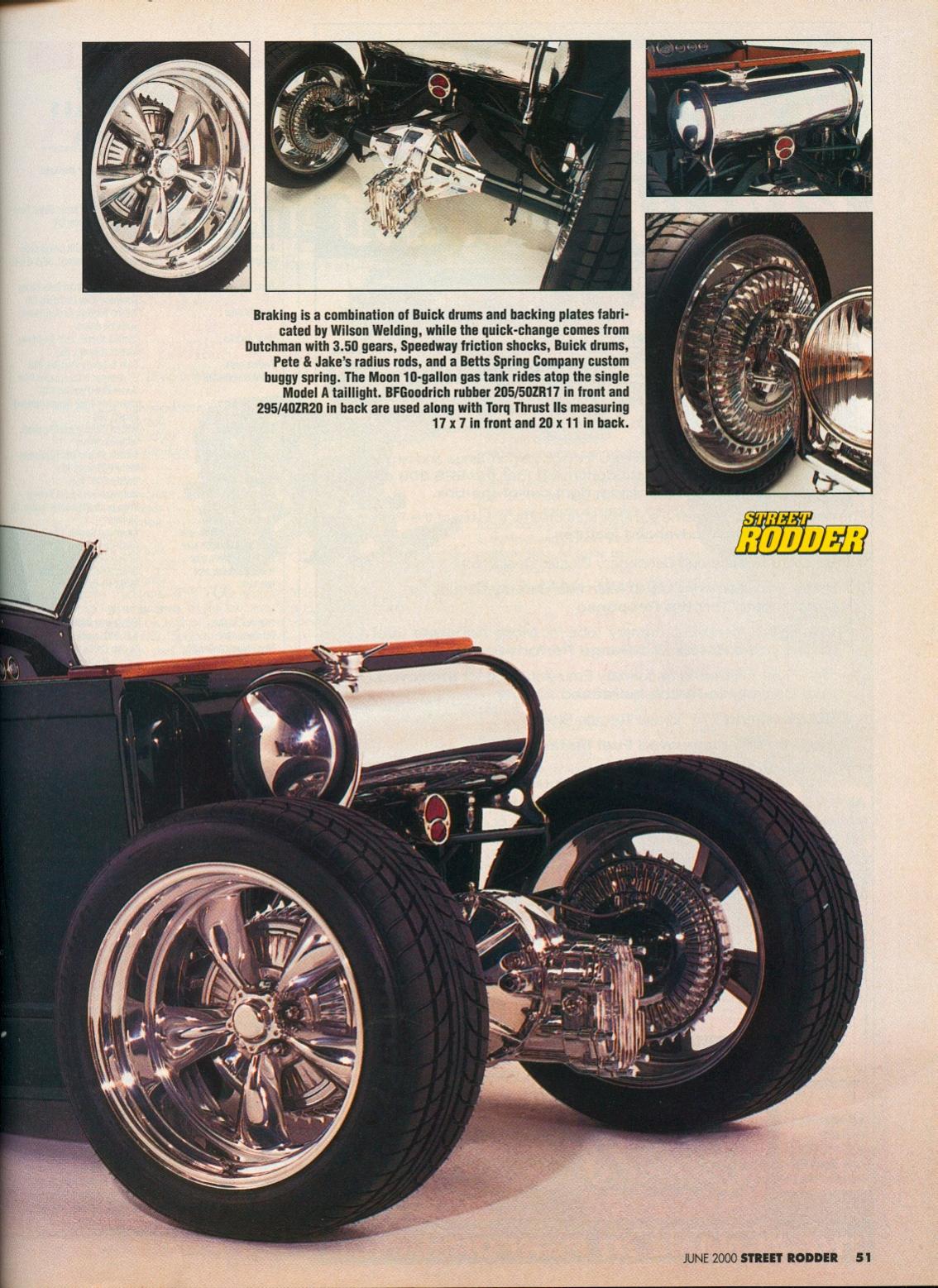

    there was a 29 "modified" built with a Jag. It was in Rodder's Journal and maybe on the cover of Street Rodder. Pretty cool car. I think it was built By Brizio. It was british Green. One of the only things I didn't like about the car was the big and wide american torque thrusts on it...just wrong.

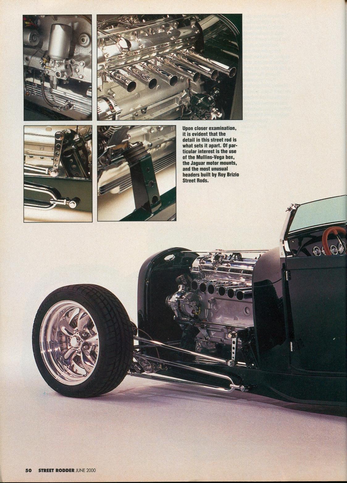

  4. That Hemi just doesn't look right in that engine bay, find a way to use the Jag DOHC 6 & get rid of all that excess **** like power steering pump and run a remote oil filter & drop the engine down.

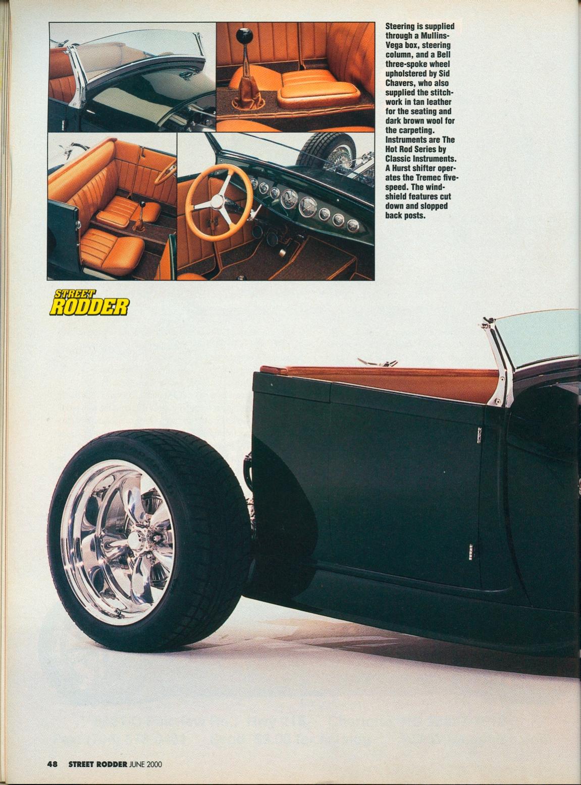

    Here is the Street Rodder article on Carlos Lara's Brizio built A mod.
    It is also featured in issue 13 of The Rodder's Journal.

    I messed with that jag and tinkered myself silly with it. The comments about stripping the motor down to bare essentials are right, it would kinda help. The best thing i came up with to minimize that long engine was to make a 'Miller' type radiator shell and it would kinda wrap back around the front of the engine making the hood shorter. Another problem was the carb location, they would fall right in the transition curve from the top to the sides of the hood, they should be 3-4 inches lower, i would make my own intake manifold and as far as flow/efficience goes it would be terrible and look like **** when the hood was open. I never got far enough along to evaluate where the headers would be.
    The things that brizio did was to make the car taller, by many inches i'd say - the body sits on top of the frame rails and the effect is minimized by the big tires; the shorter cowl sets the cab closer to the radiator. And a lot of chrome/polished aluminum/eye candy so that you see an engine and you see a hot rod - very subtle stuff.

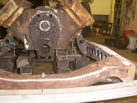

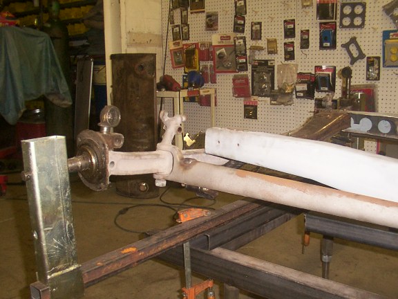

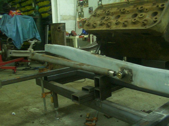

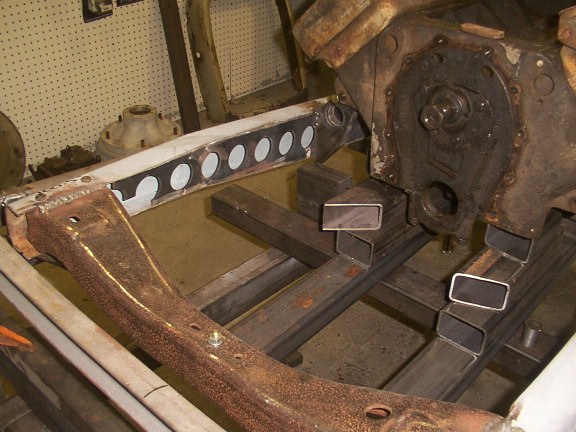

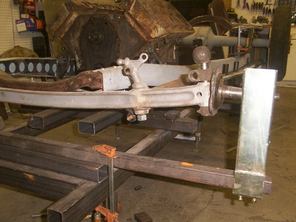

    Made some visible progress. I have the fromt axle jig set up so that the spindles are at ride height, i split the bones and tack welded some adaptors for tierod ends and drilled the frame for the receivers for the tierod ends and tackwelded them. I made the attachments for the front spring and have them welded to the bones. I made the motor mounts and have them tackwelded to the frame, yup solid mount.

    Does anyone have pictures of this car from the Rodders Journal, Specifically, I am looking at more details of the front suspension and how it is put together.
