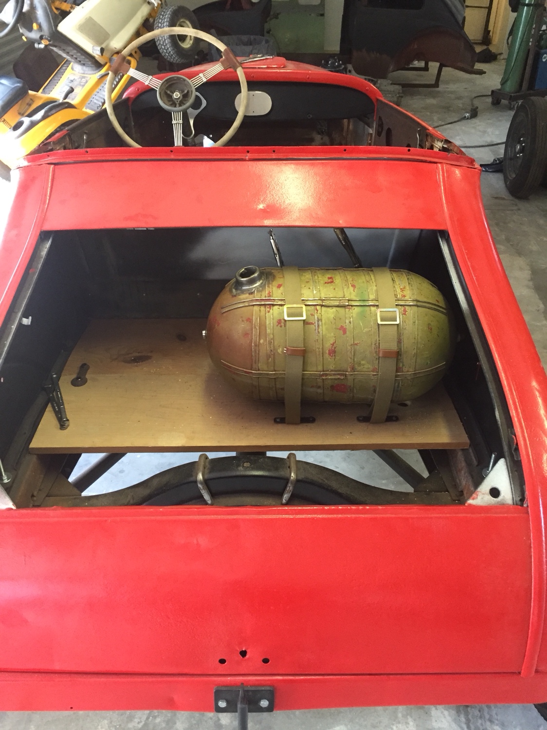

    [​IMG][​IMG]

    Very cool! JW

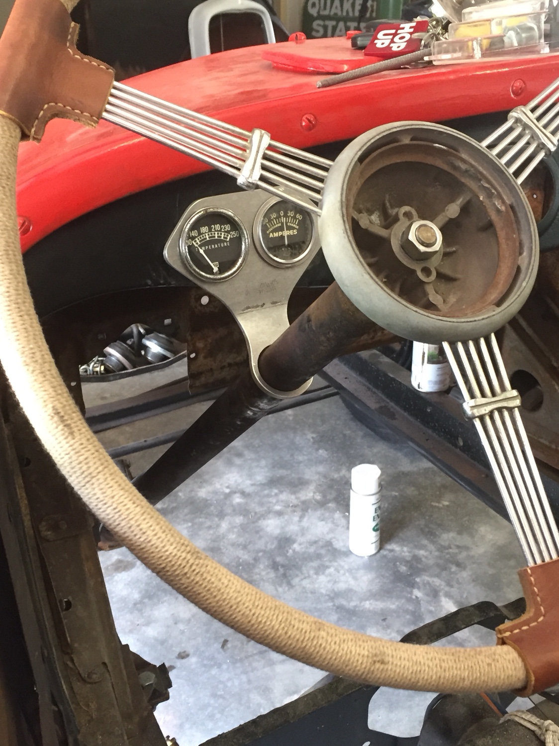

    [​IMG] did a little reshaping and polishing

    Looks like some russian ak47 skings. Build looks great man. Hope to see you on the beach next year

    Damn I like what you did with that dropper and switch panel. :cool::cool: JW

    Close, theyre Mosin Nagant slings. Ive got a soft spot for that rifle haha . Ide love to see your car there too! Ill try and get the car to the moonshine run this year, its coming up quick!
