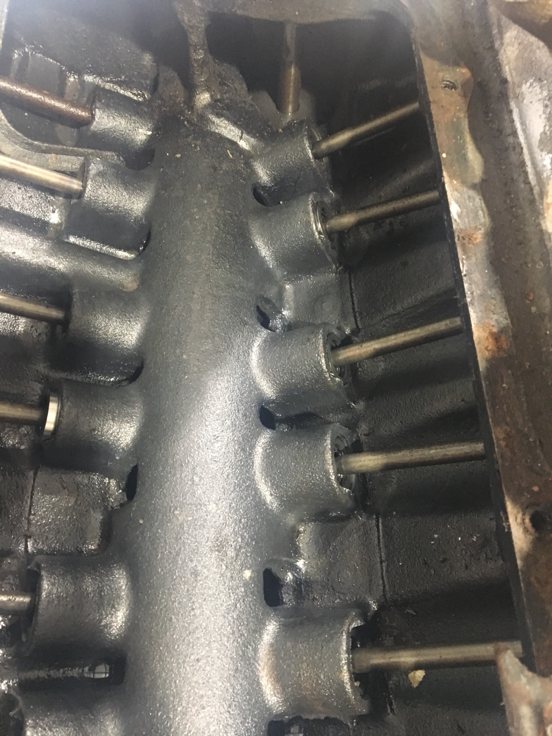

    No updates right now, been taking care of some other commitments and slowly gathering the parts to rebuild the flathead. Although I DID score this lightly used ‘57 chrysler industrial 331! [​IMG][​IMG] Ive never opened up a 60 year old motor and saw a lifter valley that looked like this one. It will be a father son build with my dad sometime in the future

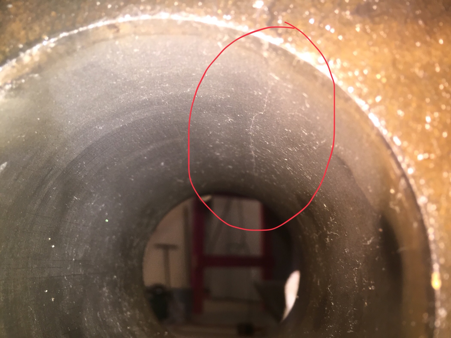

  4. Texas36
    Joined: Oct 20, 2012
    Posts: 516
    Texas36
    Pulled the tin can sleeves out of my block and found a crack in one of the bores. Looks like I cant avoid the machine shop forever... [​IMG]

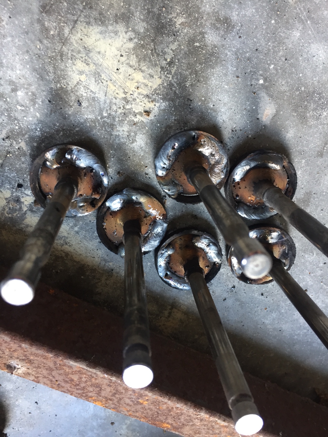

  8. Texas36
    Posts: 516
    Texas36
    The valve seats were wore out on the engine so we decided to put new ones in ourselves rather than pay the machine shop extra to do it. I ground down the old valves to fit inside the seats, then my dad welded the old valve to the seat in the block effectively shrinking them enough to fall out. [​IMG]
    Its a scary looking process but does no harm to the block. All the heat from welding is focused on the old seat, the block is only warm to the touch. [​IMG][​IMG] the new seats hammered in with ease. Next is to get the pedals where I want them so we can pull the engine and send it off to the machine shop.

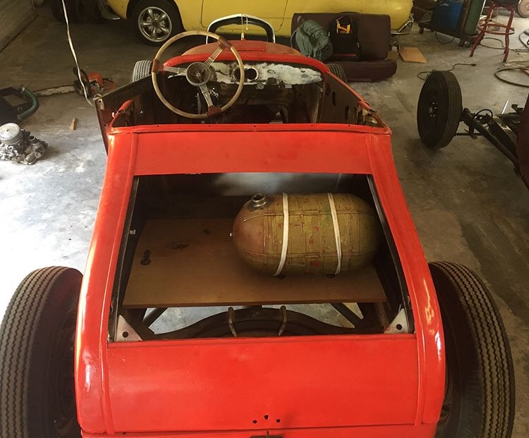

  10. Texas36
    Posts: 516
    Texas36
    [​IMG][​IMG] I repurposed the model A running board brackets that I took off the frame to make a mount for my gas tank. Ill have to make some real straps to hold it, but I think it will work out. Or at least I hope...

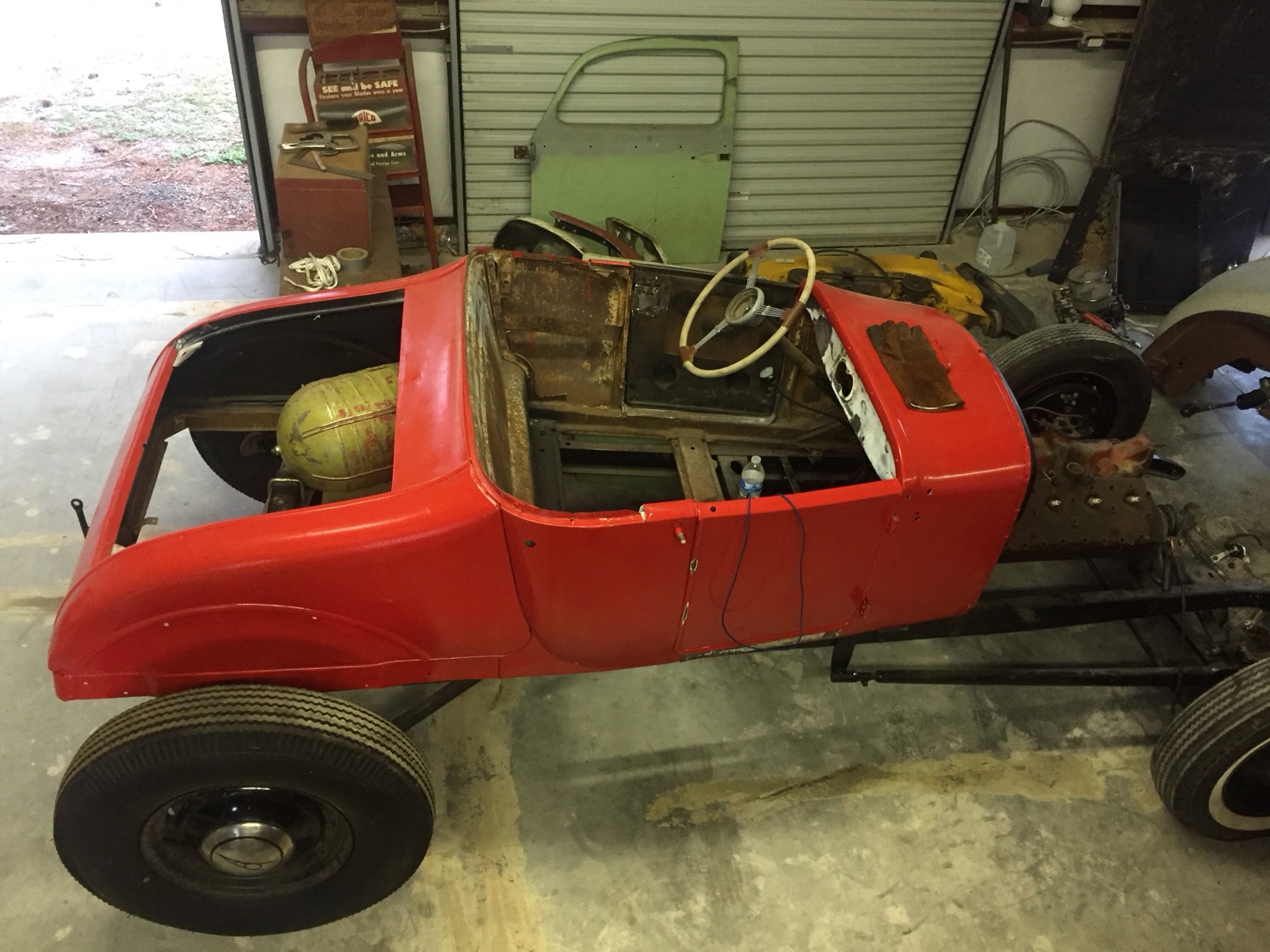

  11. Texas36
    Posts: 516
    Texas36
    [​IMG] and lastly the doors close now. Im a terrible welder FYI, especially on paper thin sheet metal but they are stiff enough [emoji14]

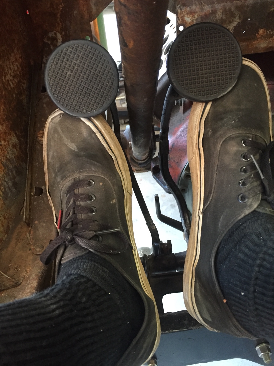

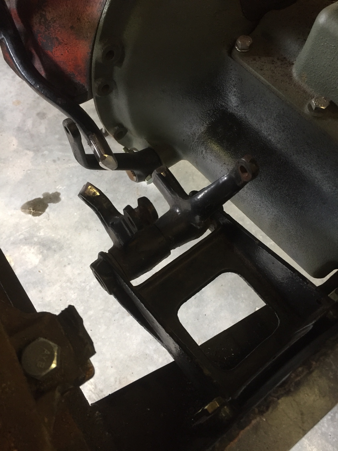

    We took about 4” out of the lower shaft of the pedal arms and pie cut the top elbow for a better pedal angle then tig welded everything back together. A lot less headache than I thought the pedals were going to be. [​IMG][​IMG][​IMG][​IMG][​IMG]

    Food for thought on your clutch connection. What ever you take out on the throw of your clutch pedal you should add a little to your arm on your bell housing to make up for the loss of leverage. I hate a hard clutch that doesn’t need to be. Keep it up I’m loving the progress! Here’s mine i built. [​IMG]

    Good point, thanks for the advice! Beautiful car too you hit the nail on the head

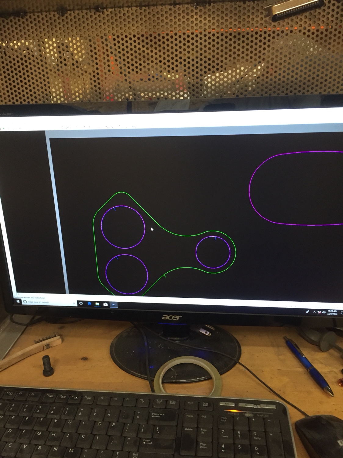

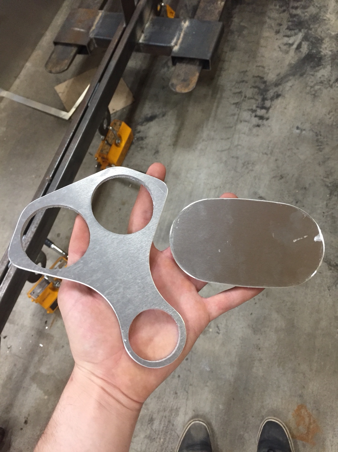

  23. Texas36
    Posts: 516
    Texas36
    I gotta give my dad all the credit for this one. Originally I was going to make a simple steel column drop for the car but he had a cooler idea involving aluminum... [​IMG][​IMG][​IMG][​IMG] those holes up top will be for my SW Temp gauge and oil pressure. the plate that covers the center hole will be for my ignition. Im going with a push ****on to feel cool lol

    Texas36
    [​IMG] A couple WW2 era rifle slings work well for the tank hold down

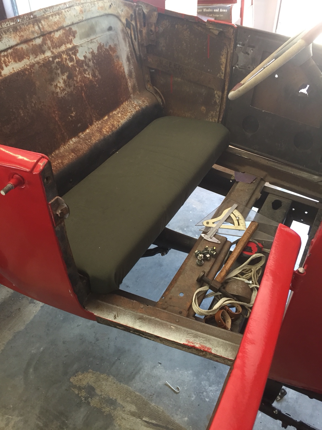

    [​IMG] I also recovered the bus seat in some green canvas

    Bus seat what a great idea the seat sits nice and low

    Texas36
    Thanks! I got the seat courtesy of @ChuckleHead_Al . It will sit slightly higher when I put the floor under it
