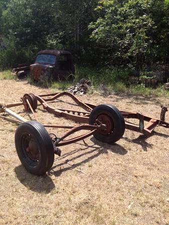

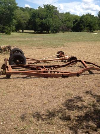

    I'm still in my acquiring parts phase for my 27 Roadster build and ran across a full frame and suspension (front and rear) from what I believe is a 36 ford, that I can get for a song.... I know the width and wheel base are bit different and would require a little "massaging" but has anybody used one for a T or A build? Thoughts? field frame.jpg

    It would take a ton of work to get the frame to fit the body or the body to fit the frame. The wheel base is different, but so is the width, shape, etc. That being said, it looks like there is a lot of usable stuff there. The front axle and rear end could be easily adaptable and if you get a set of 1932 American stamping rails, you can use the 1935-1936 center x-member to stiffen it up as well as have the trans mount, pedal mounts, etc. It isn't exactly what you need, but it's a great start!

    Also, and it's hard to tell from the pics, but it looks like the stuff is 1937-1940 and probably 1939. That's good because the brakes look hydraulic rather than mechanical (totally usable) and the rear wishbones look like the 1937-1941 ones that bolt to the backing plates rather than the 1935-1936 ones that bolt to the axle bells with the spring hangers behind them. The frames, for the most part, are pretty much all the same during those years.

    Save the front and rear suspension and sell the frame. The frame seems to be in pretty good shape. I'm sure it'll sell quickly. Make your own frame from 2"x3" rectangular steel. The rear could be adapted but it kinda depends on what motor you're gonna run. It'd work with a hopped up flathead but a blown and injected hemi might be a bit much for it!
    I'm running the same '37-'41 front end on my 'T' roadster.

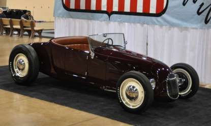

    didn't Blackie Gejeian use a similar combination to build his AMBR winner?

    Thanks so-cal, the guy who was mowing the grass said he thought it was a 36 but you may be right. The suspension is what caught my eye and the frame might just get thrown in on the deal.
    Evintho - I'm gonna run a 37 flattie that's already have so that rear will hopefully hold up ;). I have considered scratch building a frame or running an A frame. I wanna keep it a pre-1950 build for the most part......

    It looks like 39 parts based on the backing plates/wide 5 drums... SO cal is right. The rails would take a ton of work to fit your body but everything else would work great ( 33-36 front axles look very good dropped ) You could use the rails if you really put your mind to it , and could look killer and give you a very swoopy looking t ....

    I'd take the center crossmember and front and rear suspention stuff, and junk everything else, I might consider using the kickup from the rails on a model a frame also
