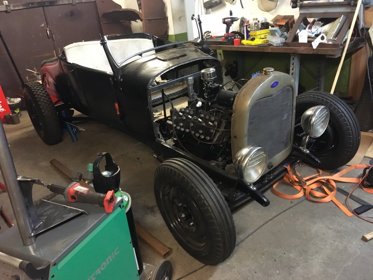

    Made some progress this last week, made a new steering column and mounts for that, got all brakes and wheels mounted and started mocking up how I want the taillights, finally drilled the holes for body mounts on frame and got some other odds and ends tied up.

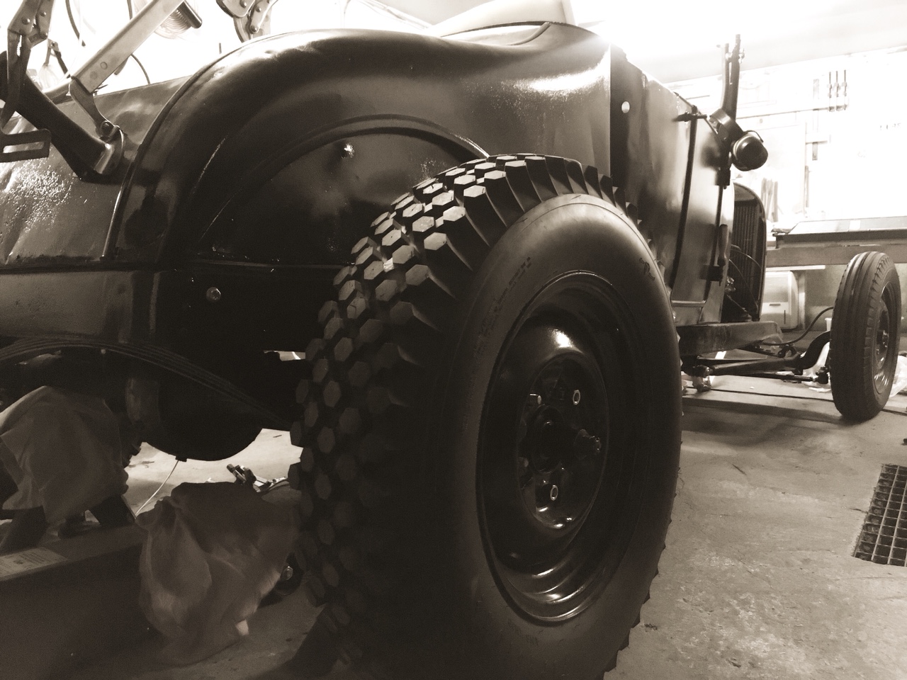

    Where did you find the knoby rear tires ?

    Coker I believe

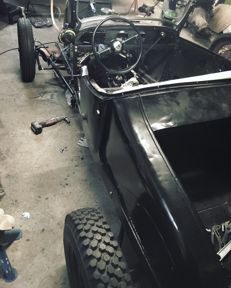

    Got the steering column finished, mounted head and taillights, got the rear axle and driveshaft ***embled with speedometer drive and restored the f-1 steering box.
    Got all the stuff to finish the emergency brake so that is next, pretty soon the car will steer and stop, just gotta make it run.

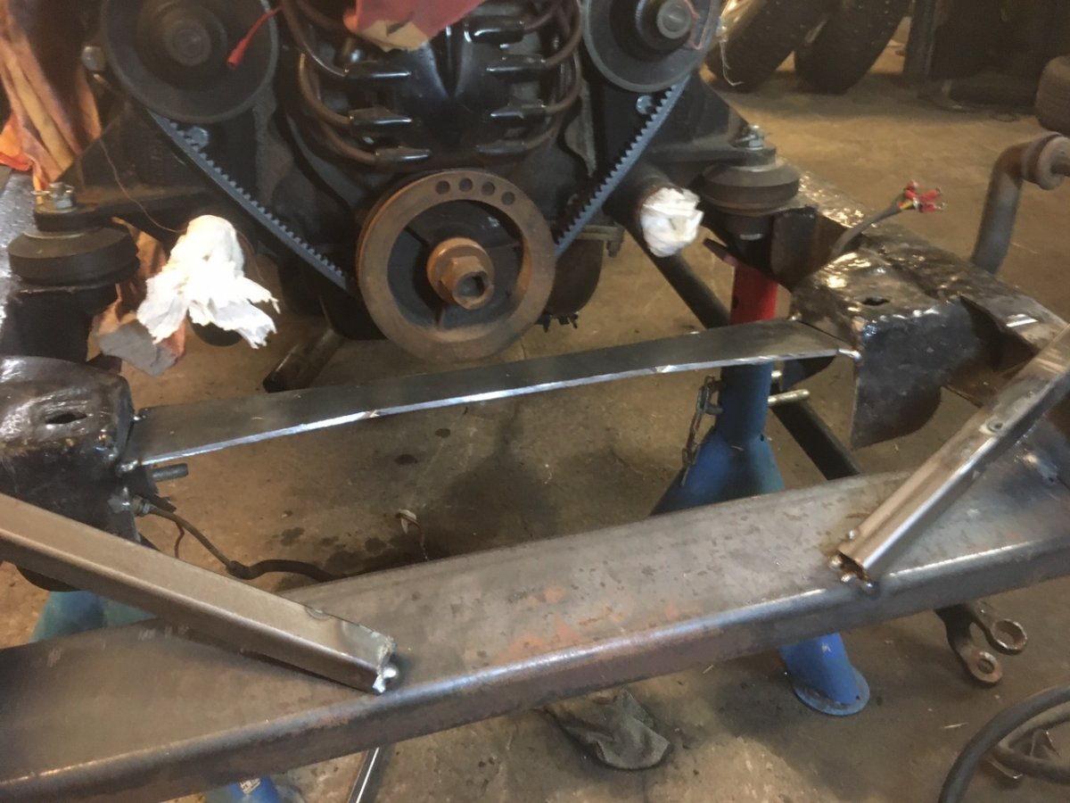

    So I had to re-do my caster on this car early this winter. Forgot to post it then but found the pictures on my phone just now.
    I drove the absolute piss out of it the first year and a half after it got finished, racking up over 2000 Swedish miles in that time.
    Had a little bit of vibration in the front tho so decided to correct that before I got my 1935 five window ford home
    (There is a thread on that in the traditional customs section)
    Put some braces in so it wouldn’t warp when I cut out the old front crossmember.
    Put the new angle into it and also measured the distance between the spring bolts and the radiator so I could lower the car and minimize the room between there.
    Here’s the difference between the old and new.
    Better view of the caster angle
    Made a notch in the frame and boxed that up too, so the spring won’t hit it when I drive over bumps at high speeds.
