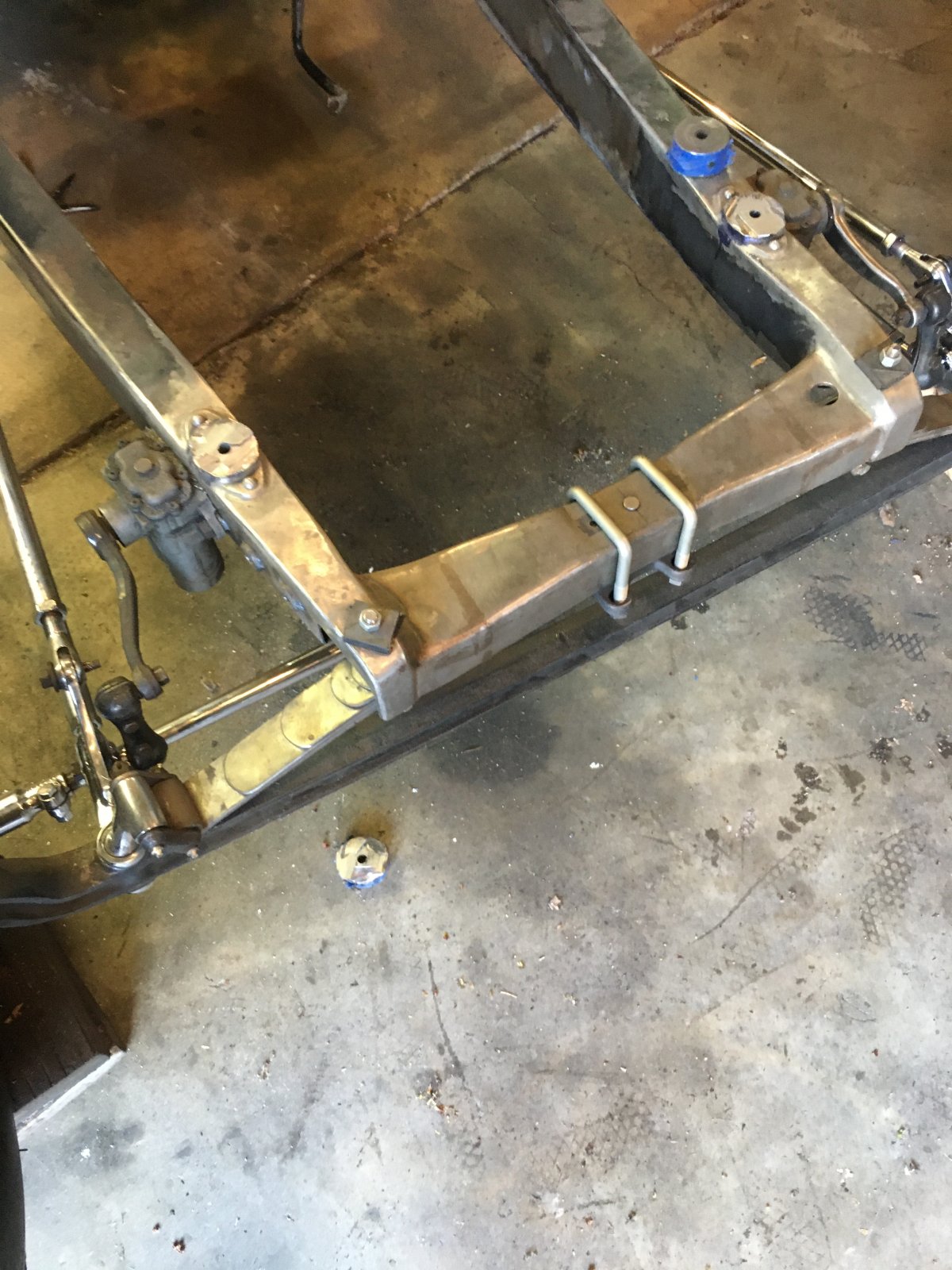

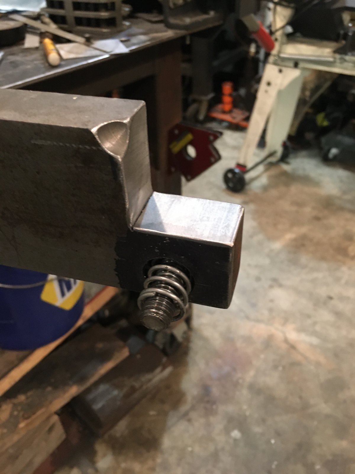

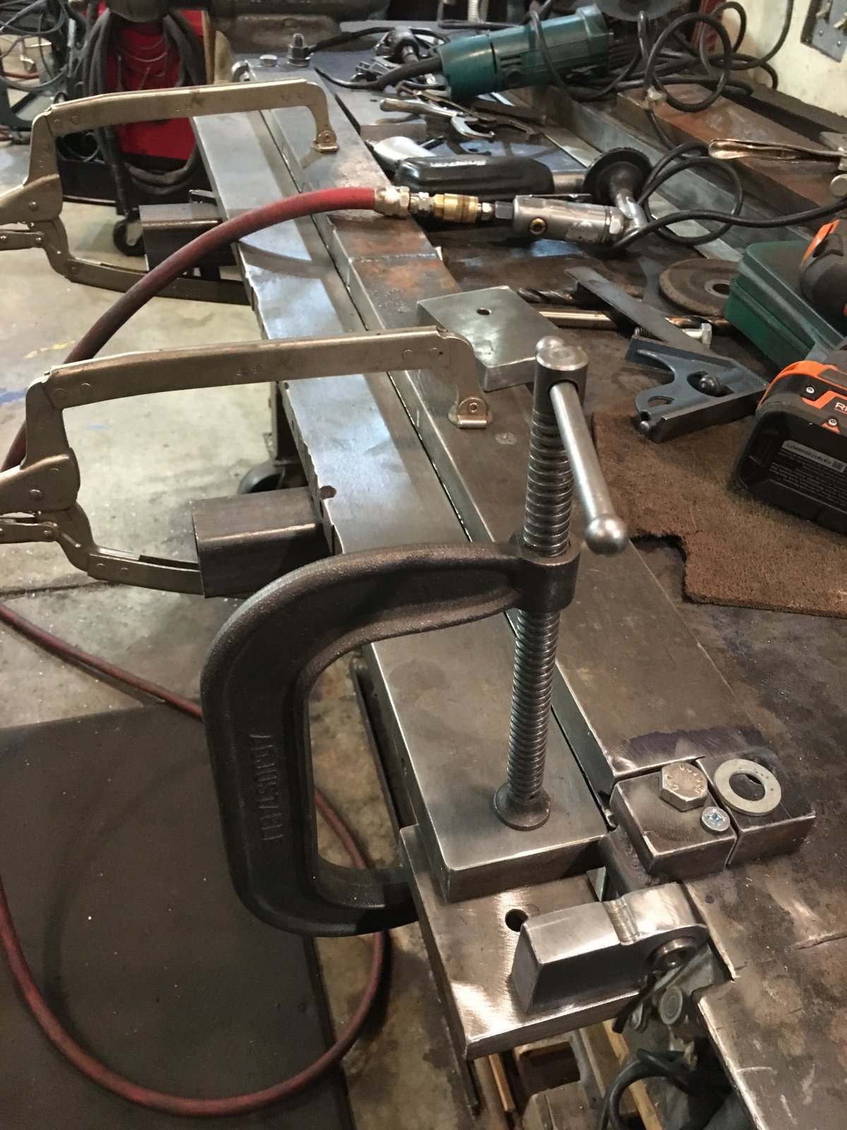

    Little update here. @Tim , the wheelbase is 106" which I think is 32 ford stock wheelbase, sorry it took me a year to answer that question. I took a couple pics of the hammerforms tonight as well. As you can see, they are super crude, you just cut a big blank and bolt it through the top and bottom, aneal and hammer.. anneal and hammer, then sand and polish smooth, cut excess away for a flange finish. IMG_4886.JPG

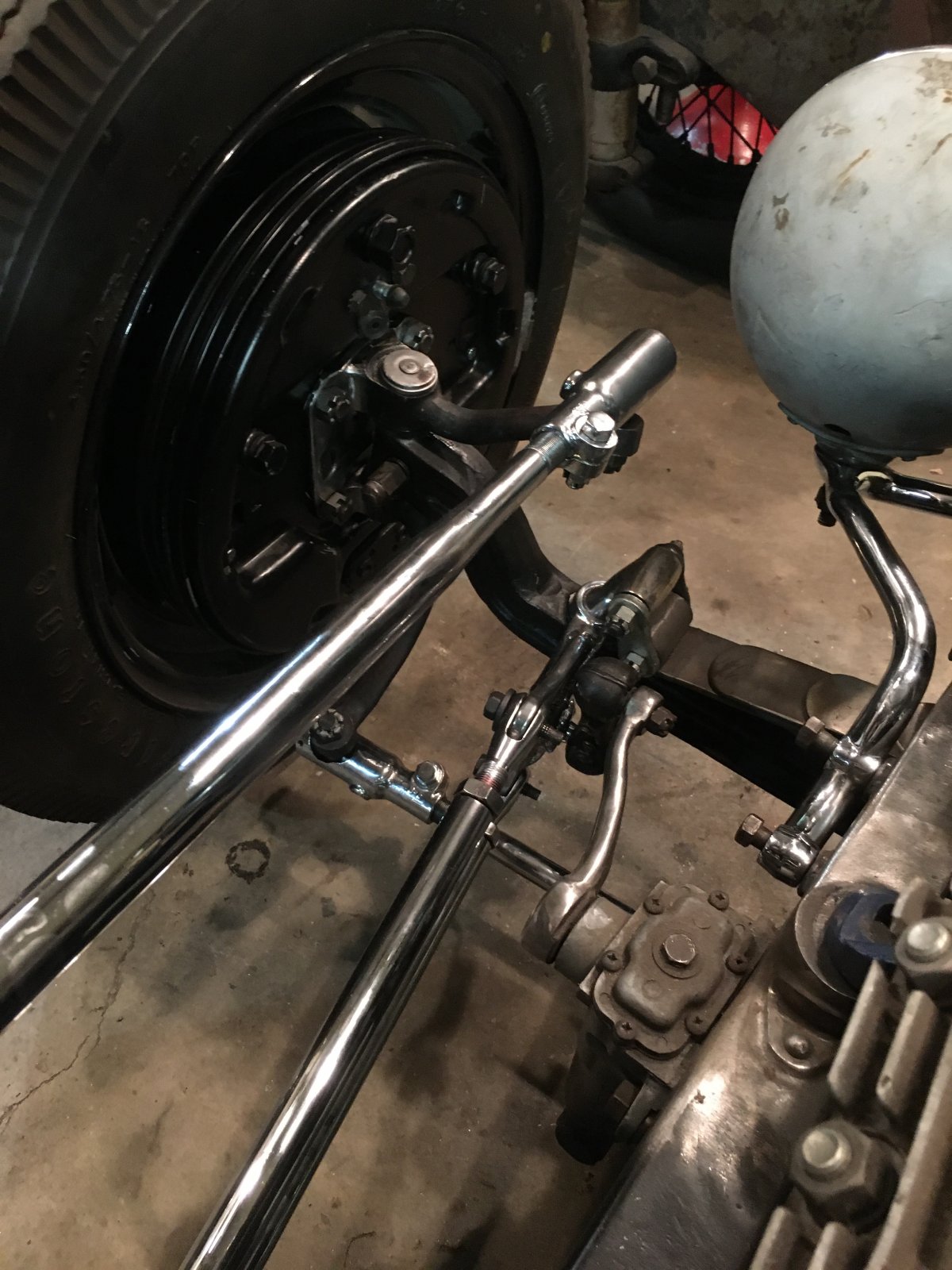

    I dropped off a load of stuff to a chrome shop 2 hours east of here around 3 months ago. I got all that stuff back a couple weeks ago. So stoked on this, I wish I would have taken more stuff out there.. Maybe for version 2.0. This is my hairpins, batwings,headlight bar, tie rod, drag link and all early ford ends for same. Came out awesome. IMG_4834.JPG IMG_4838.JPG IMG_4838.JPG IMG_4838.JPG IMG_4834.JPG IMG_4838.JPG

    I did not take many pictures of this process because I feel like it is a pretty well known swap. I originally had built the front end with 40 ford round back spindles. I made my batwings in such a way that the tie rod could not go through the hairpins as it would crash the batwing before turning too far. Consequently I ended up dropping the steering arms to run the tie rod below the hairpins, this made my steering arms very short. Earlier, I also welded a pitman arm to the spindle to fashion an upper steering arm for the draglink to attach to. While I am confident in my welding etc. it still bothered me. I had a pair of 32 spindles I was saving for a model A roadster that I have stashed. I decided to switch over to them instead. I get more lowering, integral steering arm from ford and longer lower steering arms. I had one of those kits to adapt later hydraulic brakes as well. That piston ring thing is super lame, I machined my own adapter rings, I copied what @NealinCA did basically, built up the outer perimeter of the spindle and re drilled the bolt pattern for later hydraulics. I did use the dumb valve seat for the seal/spacer, just welded it on so it would not spin. I also used Neals part numbers for the torrington style kingpin bearings.. Thanks for the info Neal! Car steers nice and has a good feel to it. Jumped up and down on the front as well, bump steer is less with the 32 spindle than with the 40's. Longer steering arms? Dunno. Happy with it. IMG_4857.JPG IMG_4857.JPG IMG_4857.JPG IMG_4858.JPG

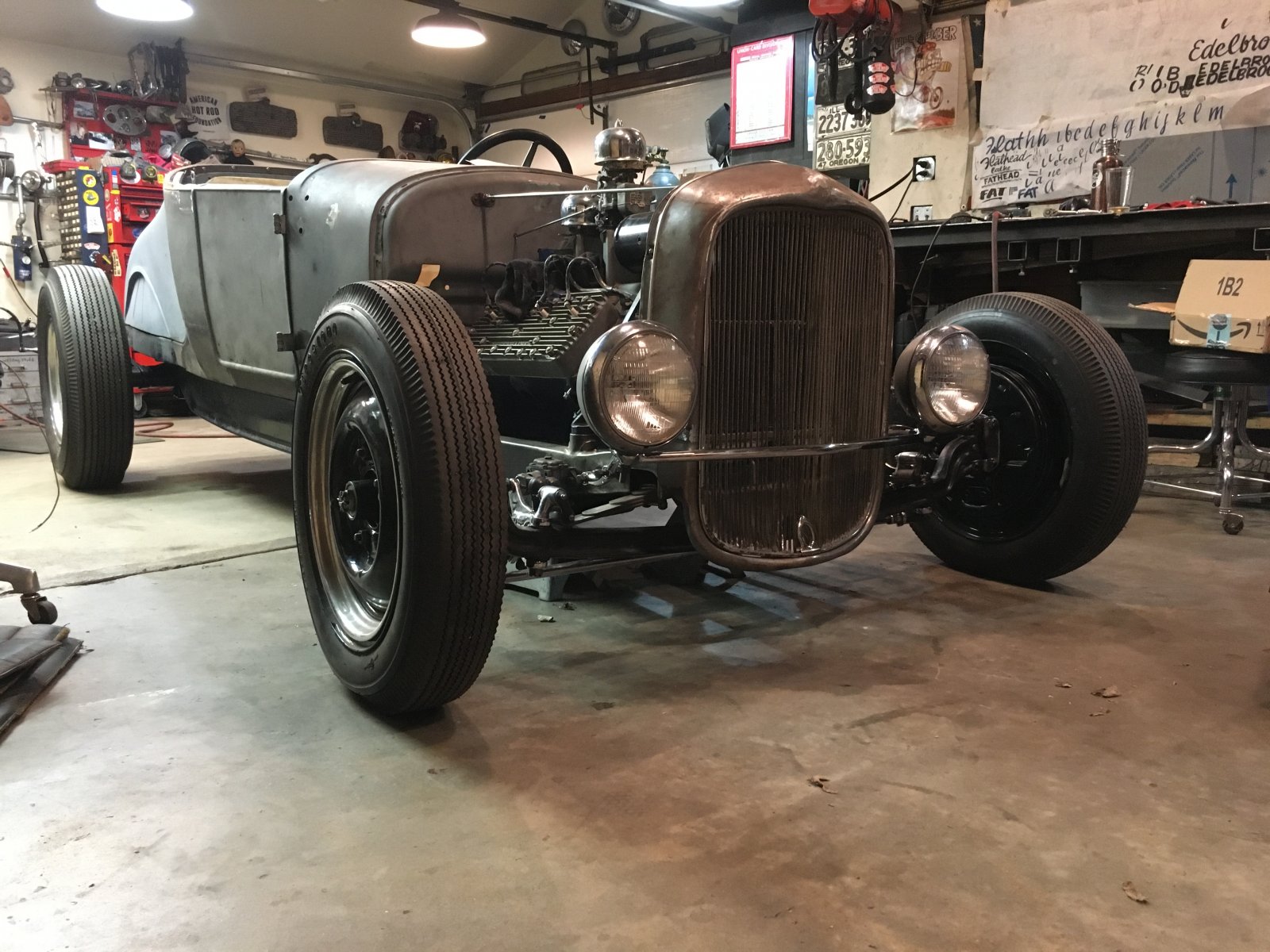

    Here's a couple random shots for fun. Decklid is latched and functional for version 1.0

    Howdy folks, I'm going to post a bunch of pictures that will bring this thread current. I decided that the only way to get this thing done was to have a hard deadline, otherwise I would piddle fart around with it forever. I have been going to rpm nationals the last few years with some friends and having a blast. This event happens over my birthday weekend which makes it a special treat. Last year my buddy Willy let me race his rpu, ol number 9 , for my birthday! Man what a blast! This year I will turn 50, which is a reasonably big birthday I think. Anyhow, I decided, what better way to celebrate than to get my roadster done, take it out there and break it proper good like. So thats my plan. These photos will include, some more fabrication, ch***is ***embly, painted ch***is, body work, paint, louver punching, pinstriping, anod some final ***embly. If all goes to plan, I will have time to make an interior as well. I have a relicate leather hide and a yard of german square weave carpet waiting. I know.. total street rodder. IMG_4903.JPG IMG_4903.JPG IMG_4904.JPG IMG_4903.JPG IMG_4904.JPG IMG_4906.JPG IMG_4903.JPG IMG_4904.JPG IMG_4906.JPG IMG_4907.JPG IMG_4903.JPG IMG_4904.JPG IMG_4906.JPG IMG_4907.JPG IMG_4908.JPG
