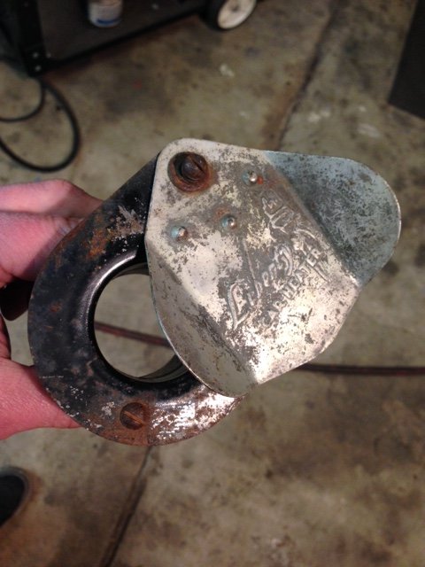

    Oh, one more.. This is a heater outlet I got on ebay that uses exhaust hot air. I found and bought another one as well. One for each side,mismatched but cool. I think at least. See ya. jjj.JPG
