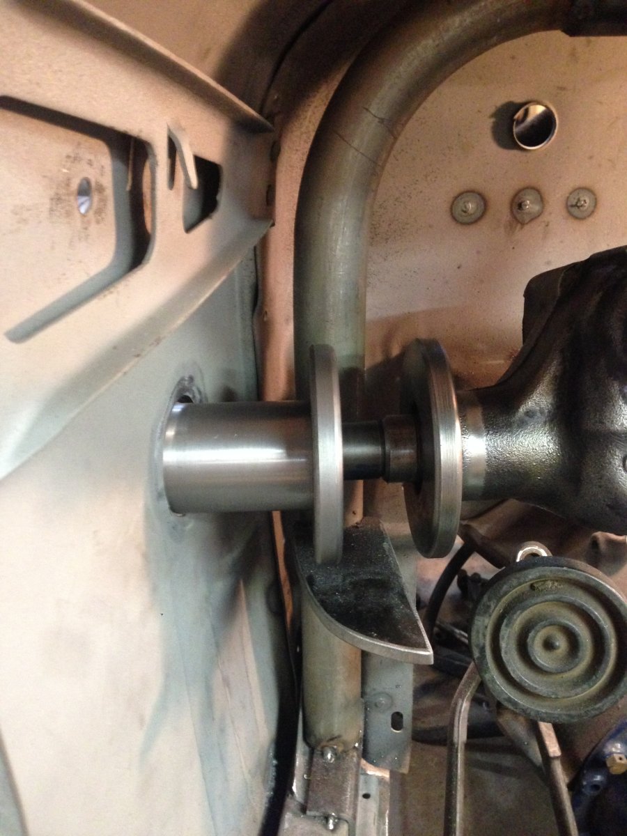

    here's a little update, box is pretty much finished, I decided to make a longer snout that pokes through the cowl instead of just the sector shaft. Seems like a better look and keeps that support out there. Photos show the shorty, then the finished one. I also made the p***enger side doo dad that will provide the mount point on that side. Photos show the sector extension job, press fit into the torsion bar, I still need to weld and pin it.

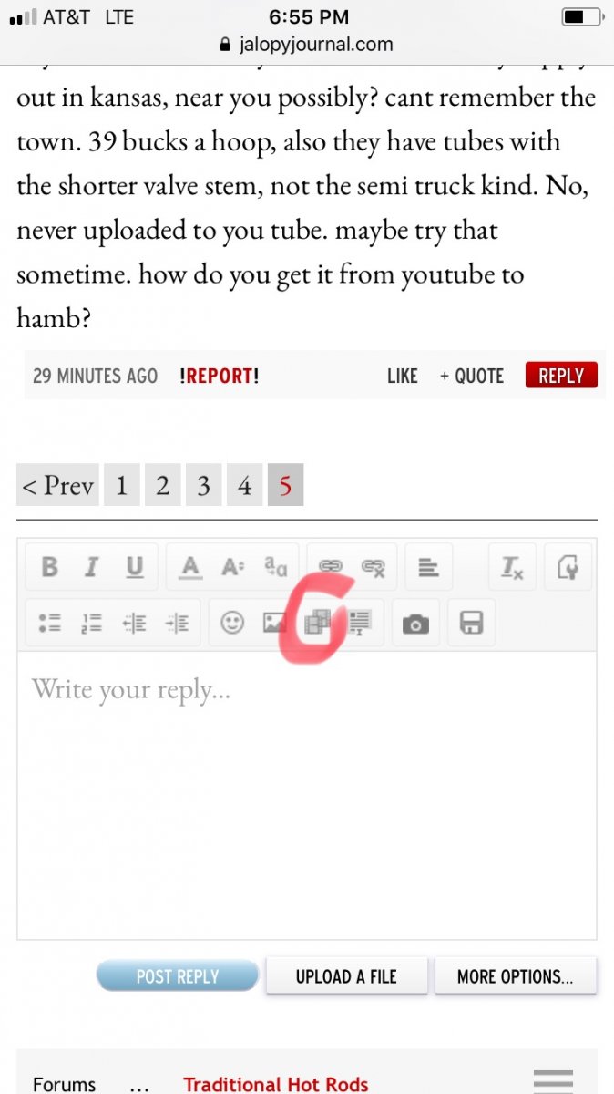

  14. Whoa! Awesome! Where'd you buy the hoops??? I need some for my dirt car.
    Did you upload the vid to YouTube first? I don't believe you can host it here directly?
  15. PINEAPPLE
    Joined: Aug 26, 2012
    Posts: 533
    PINEAPPLE
    Hey Mike, I got em from hey machinery, or heywheel online. They are a farm machinery supply out in kansas, near you possibly? cant remember the town. 39 bucks a hoop, also they have tubes with the shorter valve stem, not the semi truck kind. No, never uploaded to you tube. maybe try that sometime. how do you get it from youtube to hamb?
    brEad likes this.
  16. Cool I will Google them. Thanks!
    Once you YouTube it grab the link and add it once you open that little filmstrip link I circled below.

    all the steering box bits are made from model a rear wishbone chunks and the shaft collar pieces are old axle housing chunks and keystock welded on for the bolty bits.
