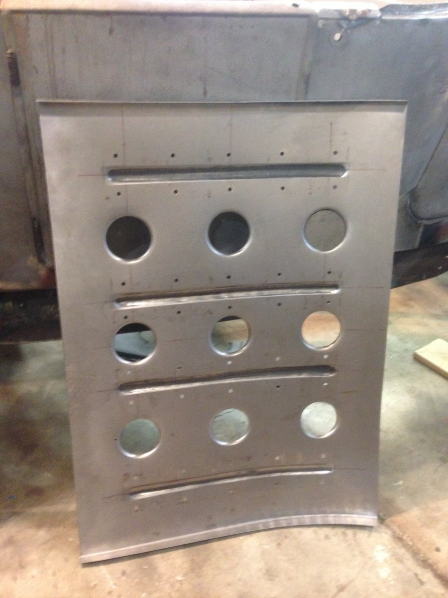

    hi guys, been a long time eh? we can still be friends if you want, I'm keen. These are some shots i never posted from before. inner decklid skin build, i actually saw the technique here on the hamb by an aussie fellow. I copied him. it worked great.

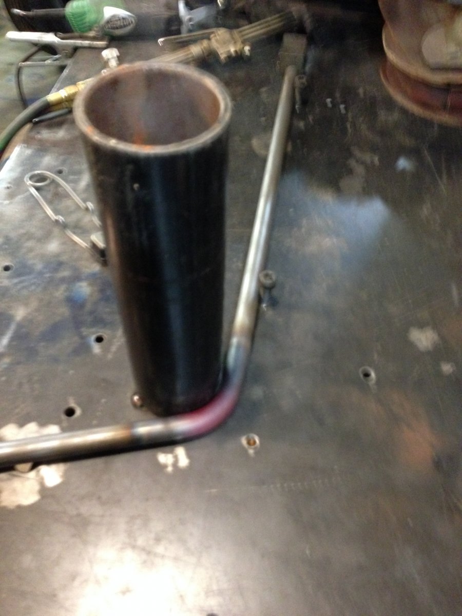

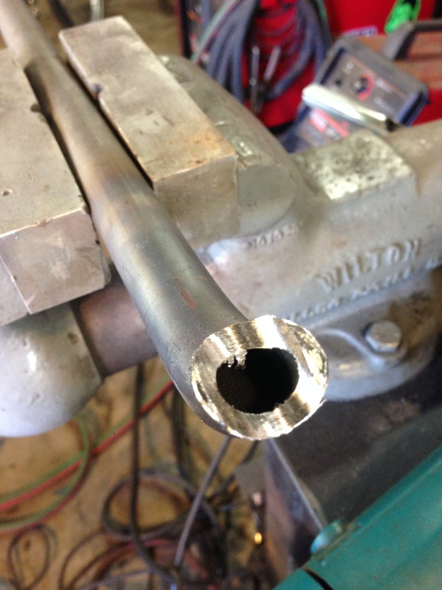

    Here's a few more of the hairpin situation..

    couple more on the hairpin mount

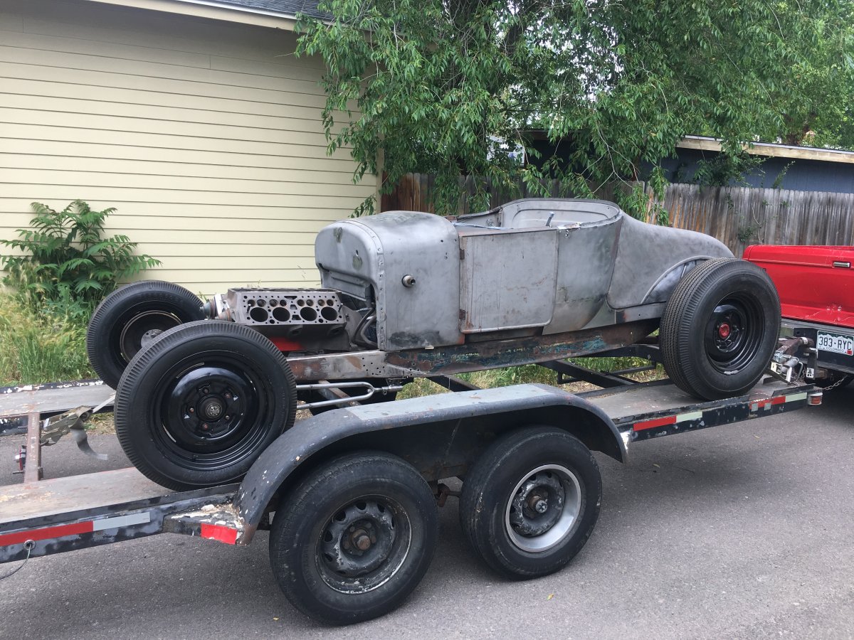

    I put a 33 coupe together for a neighbor over the last year or so. My roadster was in storage in his garage for that duration, I only have room to work on car at a time. Here is a couple of shots from the day we brought it back home in june.

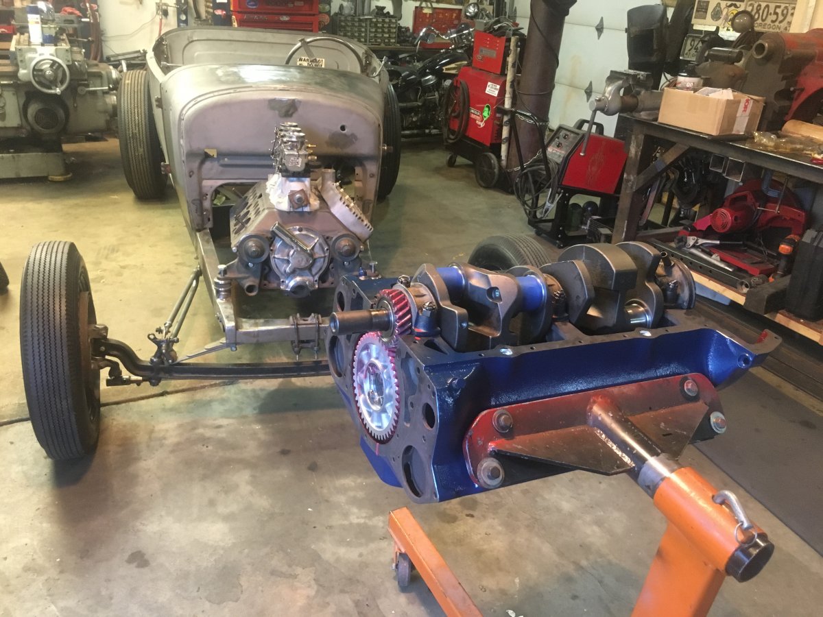

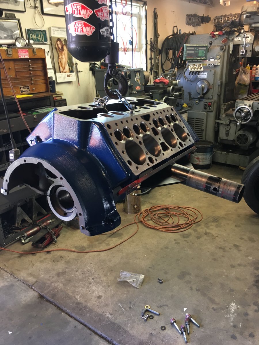

    Here is a couple shots of building the engine. Nothing too crazy, 1940 block,bored 3.200, 3.75 stroke 8ba crank and rods, isky 1007b cam, johnsons, 1.5 chevy valves..

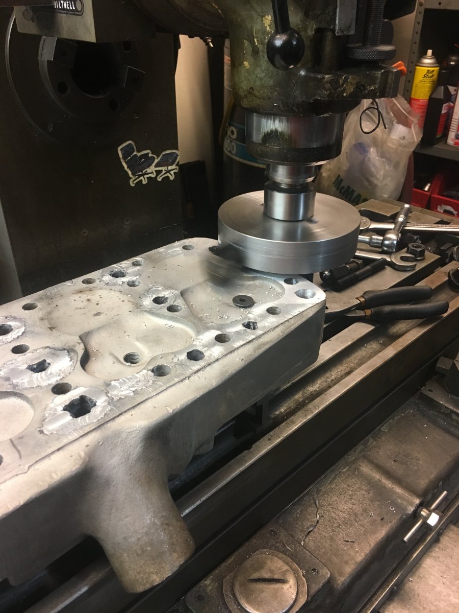

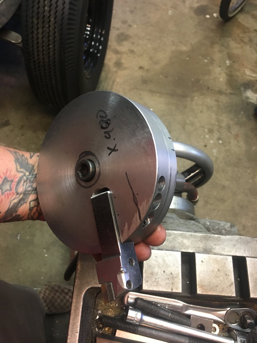

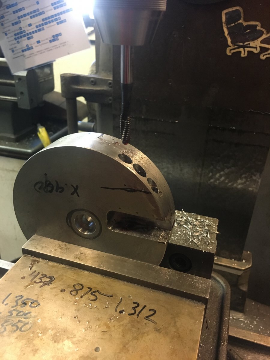

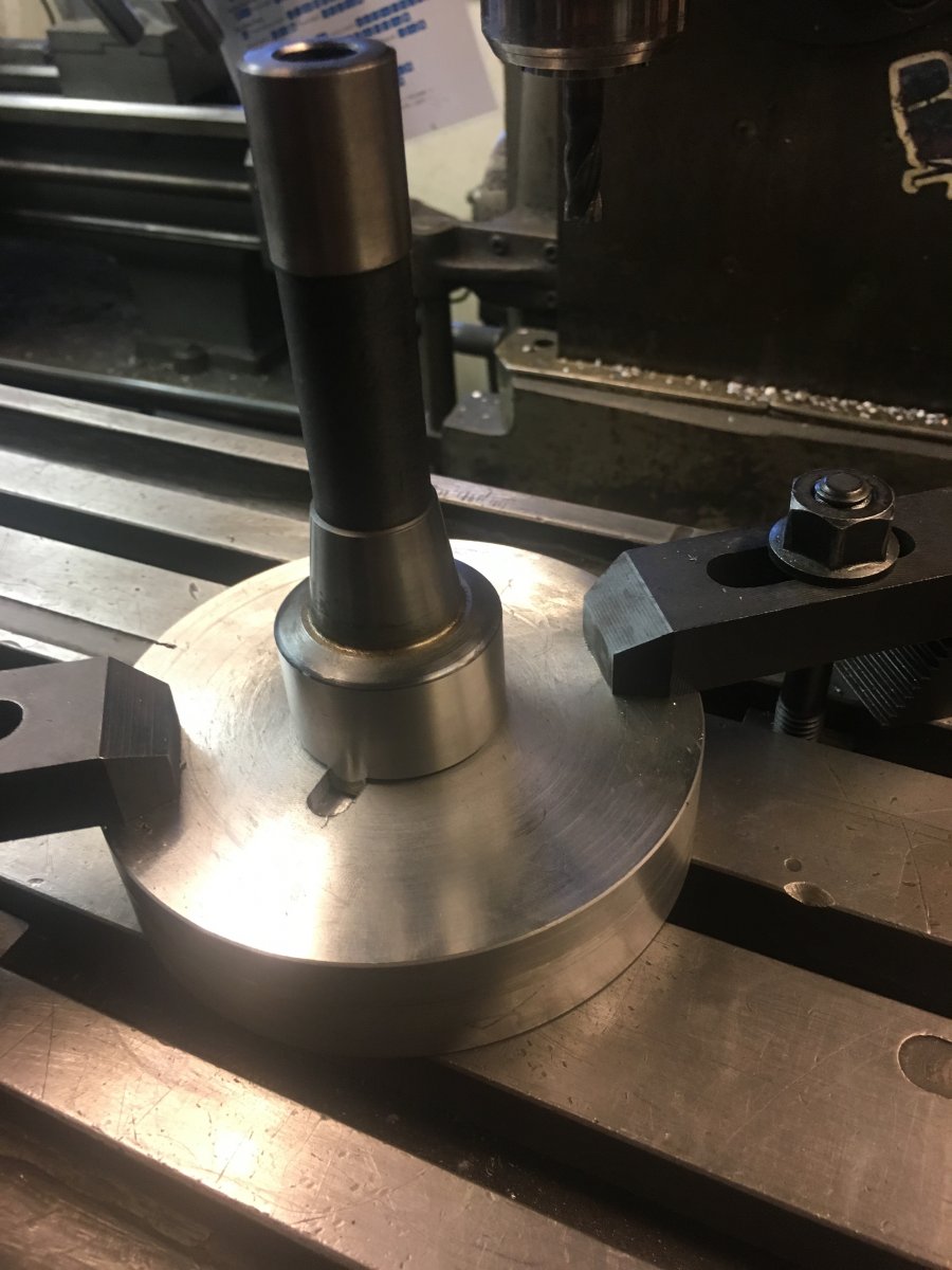

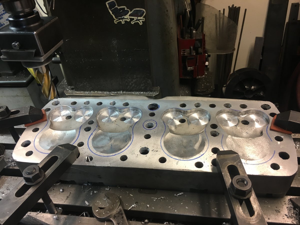

    Here's a fun little timing pin I made. These old offenhauser heads have been hanging around forever,several years ago I welded up all the drama. I though maybe it was time to see if they would work, ya know just for fun in the spirit of wasting time. A few shots of machining them back to life, I had to make a flycutter to get a good finish on them. Flycutter uses an insert lathe tool, super handy! I then had to clay them for clearance and flycut over the valves, I used an endmill in a boring head, kinda janky but it works. I ended up polishing the chambers and countersinking the last few threads out, also installed steel time serts cause the threads were shot. couldn't find any photos of the finished chambers. Loads of work, but a fun experience. We don't do this because we want to be sensible right?

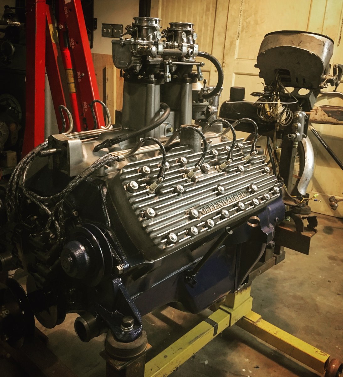

    I've just tried to upload a couple movies to the thread of the engine running on the stand.. I cant get it to work. There is a couple fun ones on my instagram @meteormotors if any of you want to check it out. Thickstun pm7 intake,a couple old chrome 97's that I went through, new throttle shafts etc. , crab distributor and a stock early style fuel pump. I have broke the engine in, runs great, and now it's in the car. I have been working on the radiator bits to drop off at the shop for a custom built one. I will post more as I get more done. Can't promise it won't be another year though. Ha
