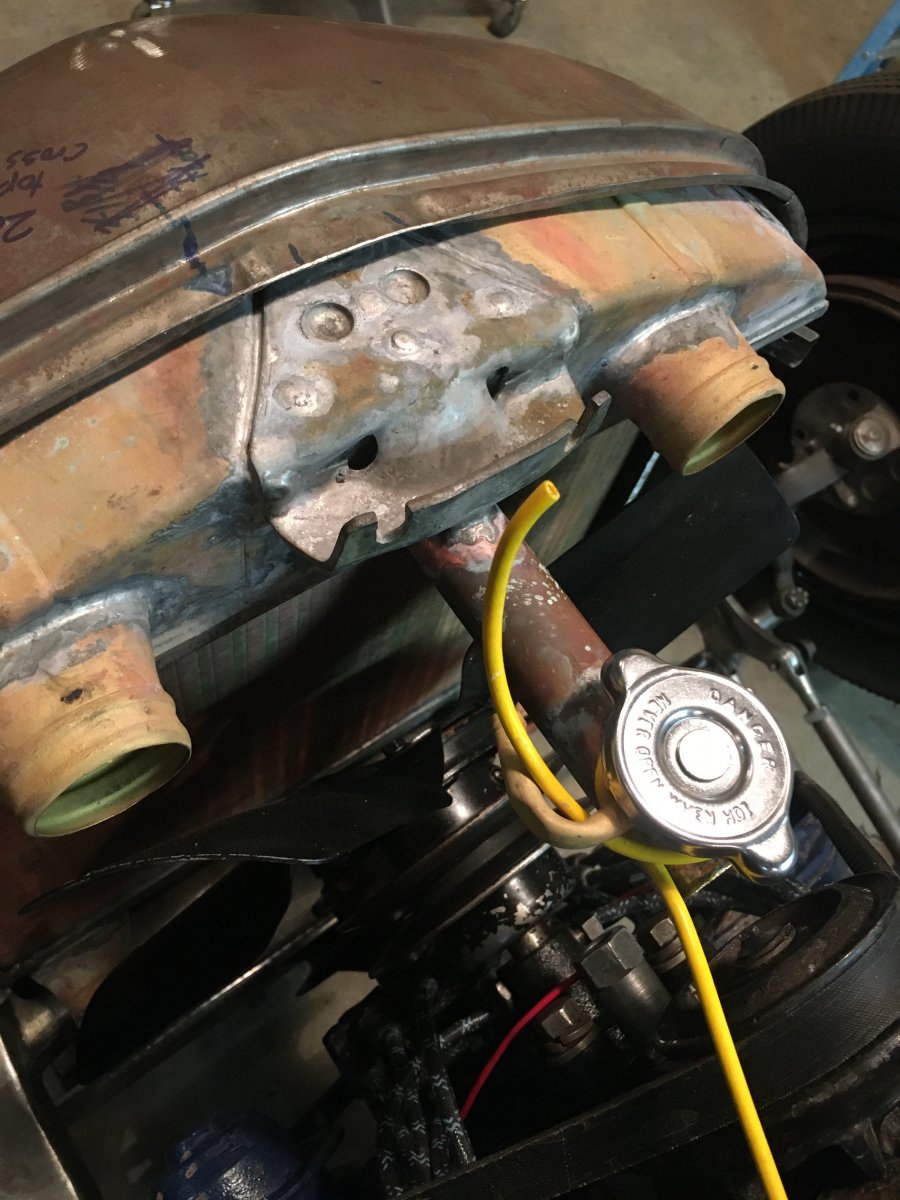

    I feel like I am missing some photos. Some of this may be a bit boring, but I will try to get close to the current configuration. A couple of radiator shots.. the first is the core, for reference on the tube size and staggered arrangement. Spike radiator in englewood colorado built this for me from a 29 model A top tank and a 35 bottom tank.

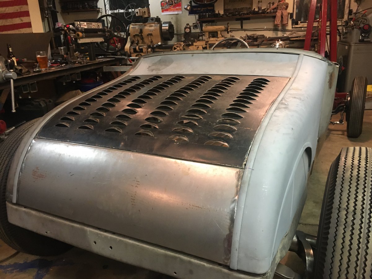

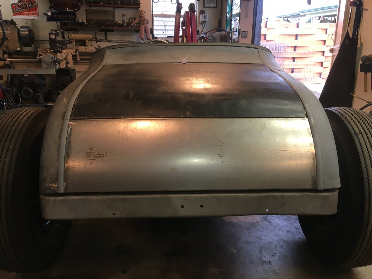

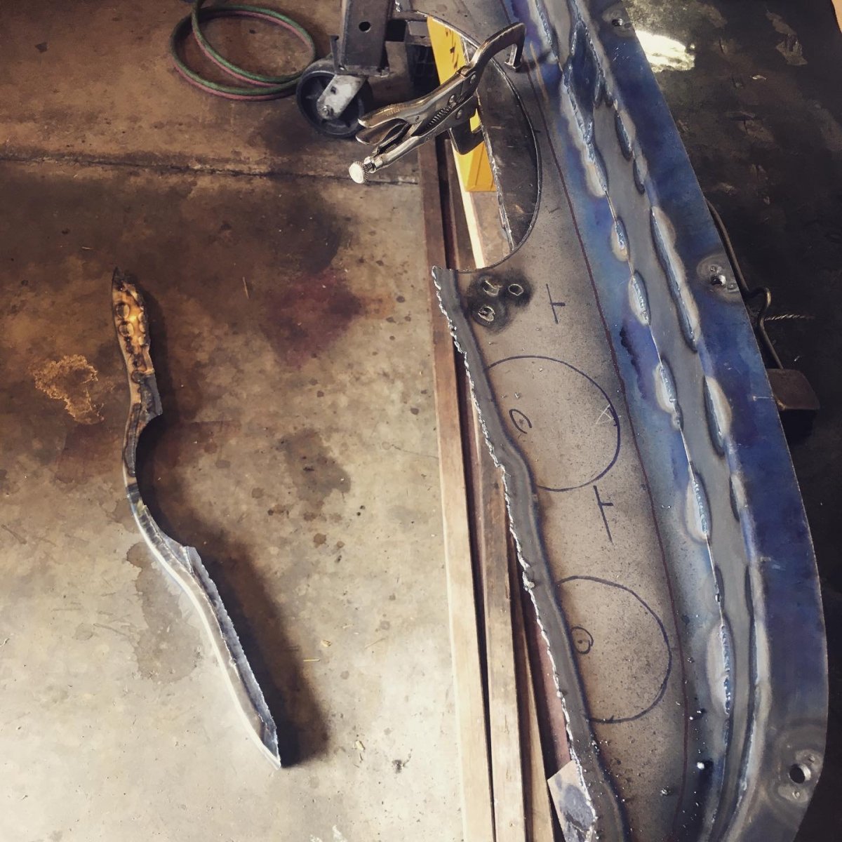

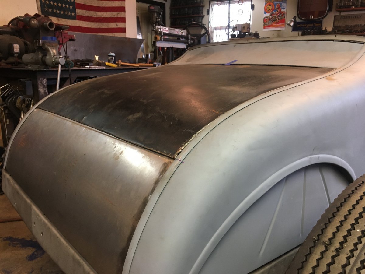

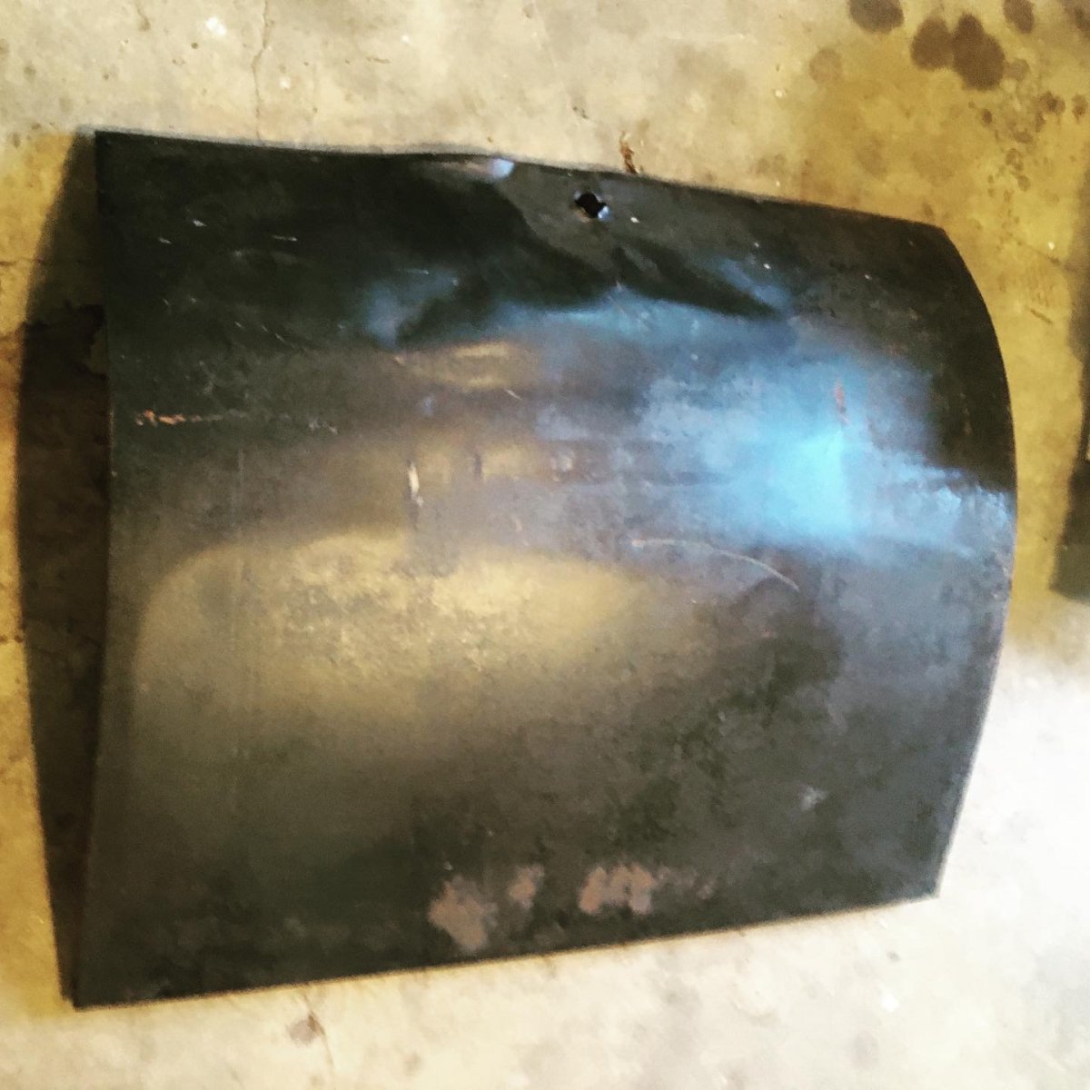

    This one is pretty fun. I had about 3" of original decklid. I had decided to make one from scratch (what could go wrong?) . I had this model A one laying around for a while. The bottom was really ragged and rusty. I checked the crown of it's catwalk area against the T catwalk, shockingly they were the same (for my eyes anyhow). I unskinned it from the inner skin, marked out some new lines, tipped the edges on my skateboard wheel bead roller thingee, tapped 90 degrees and used the shrinker stretcher to shape to the new profile. Once it was fitted, all the raggedy bits were cut off because the T is shorter overall.

    Well you may not have the fastest moving build but your attention to detail is right up there with the best of them and tends to raise the bar a bit.

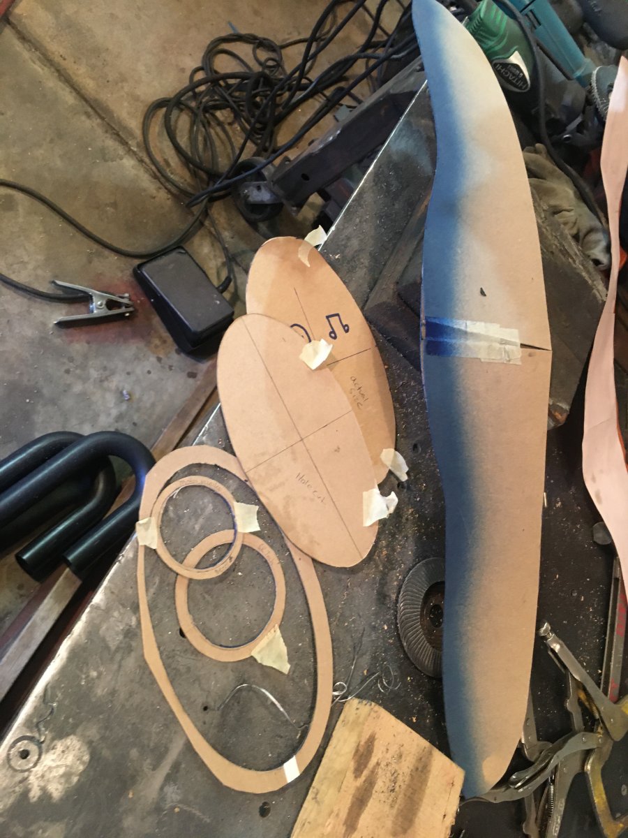

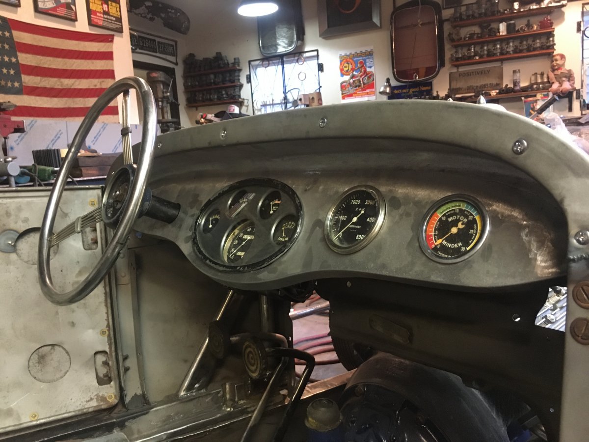

    I mentioned in a post a while back that it's always fun to show the mistakes that happen along the way. I wanted to have my dash sorta cove in like an auburn jobby. I had cut the dash across the cowl area and inserted a filler strip to get the depth. I then made a 1 x 1 angle piece from 18 gage and shrinker stretchered it to a new lower profile. I then proceeded to patch up all the little shapes and holes leftover. Stupid idea. I never would have gotten it straight with a pile of bondo. I torched it off. I then made a whole new dash from 18 gage and welded it to my top rail bit and cut some gauge holes in.

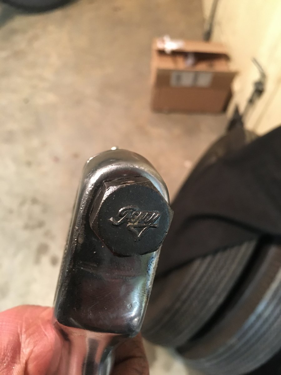

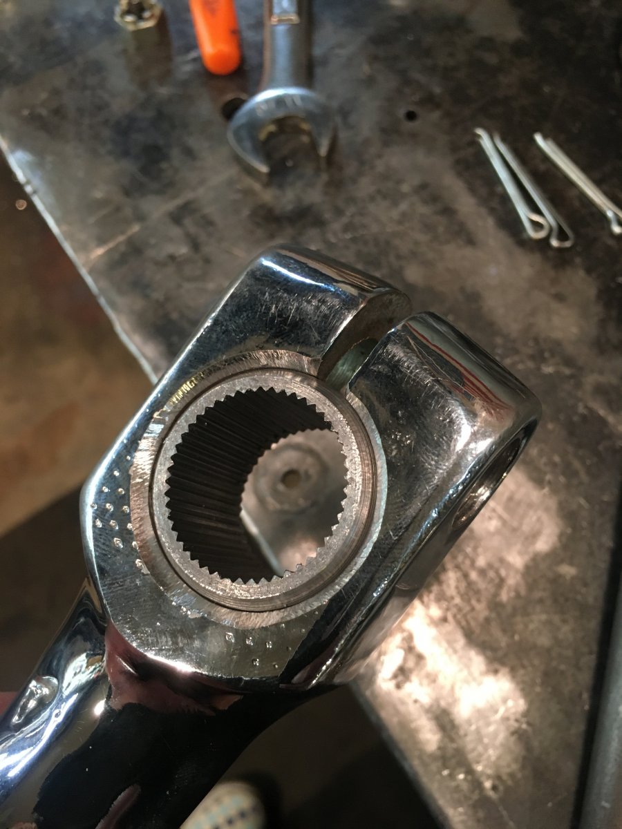

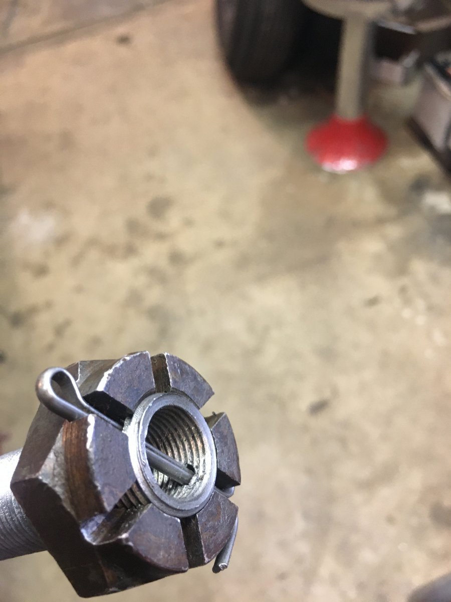

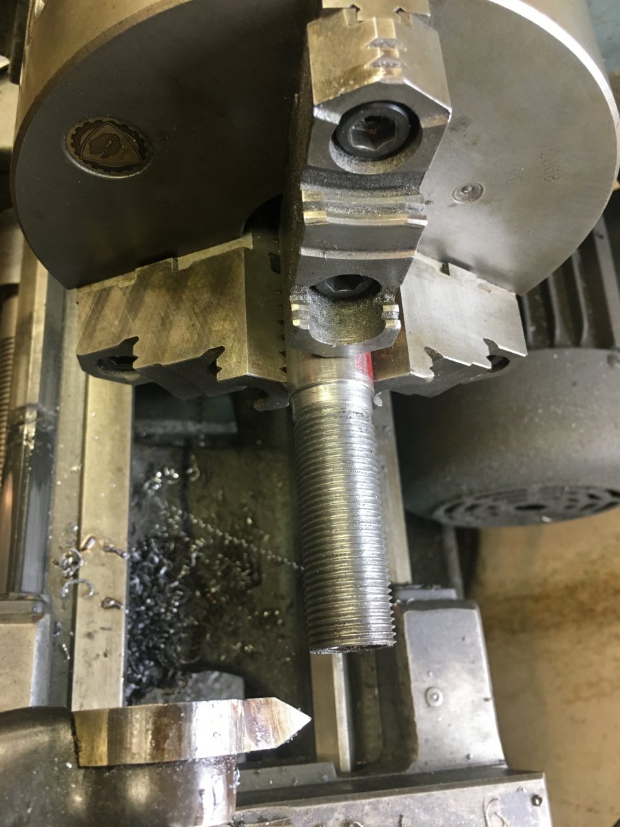

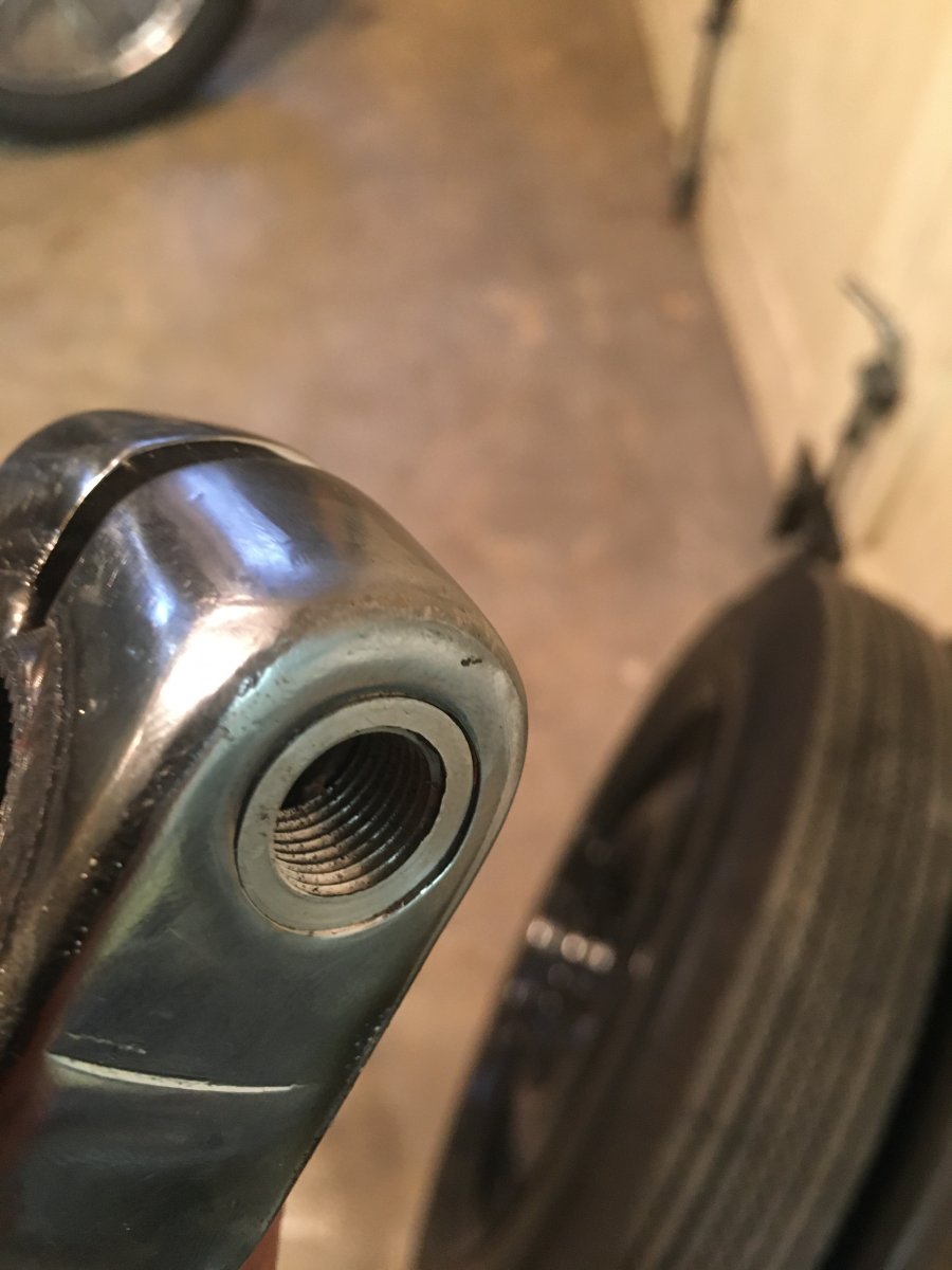

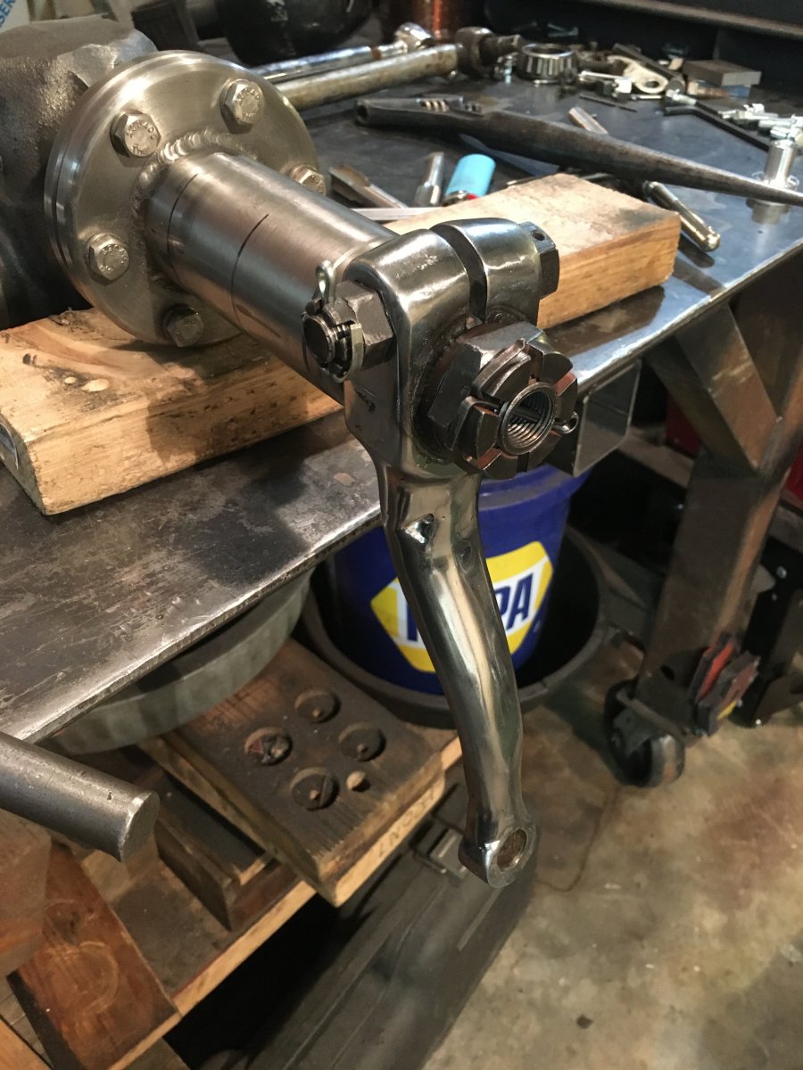

    Oh boy was this a project. This is an old chrome pitman arm, f100, which has been extended by an 1' or so. It was on this old deuce ch***is I drug home 15 years ago. My sector shaft extension is a splined torsion bar piece for dirt track cars. I ordered an internal spline chunk that fit from an off road place. Bored the pitman arm on the mill and turned the chunk so all bits would have good meat and a healthy press fit., fat chamfer and tig weld. I wanted to keep it old timey so I made up some threaded bushings to fit in the original bolt slot and thread some fake bolts in. For the bit holding the arm on the shaft, I had to single point thread a chunk to fit the torsion bar internal threads. It was a weird size and pitch, like 3/4-20 or some nonsense. Anyhow, I chamfered a pitman arm nut on the back side and welded it to the newly threaded bit to make a bolt that looked like a nut. I drilled the stuff for safety wire, for a racey look. Fun project.

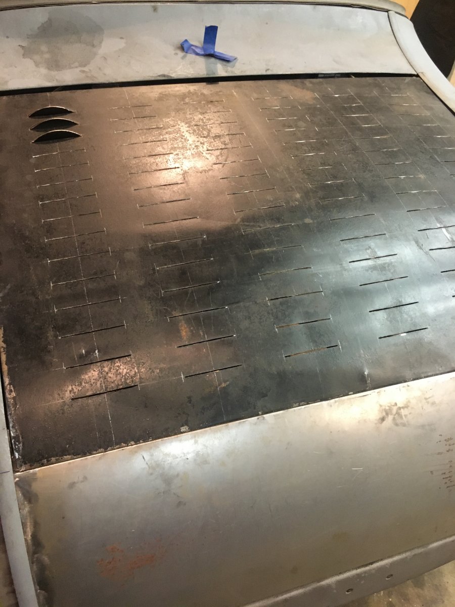

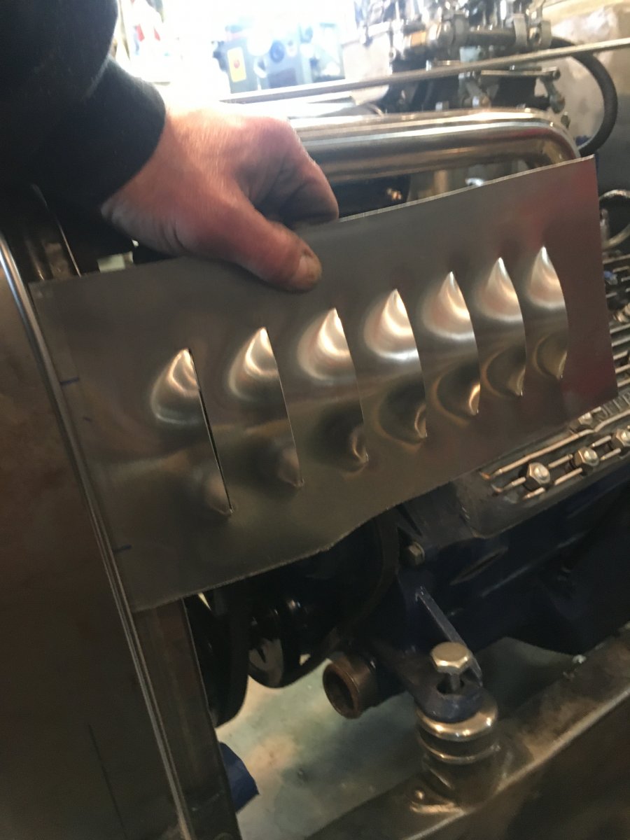

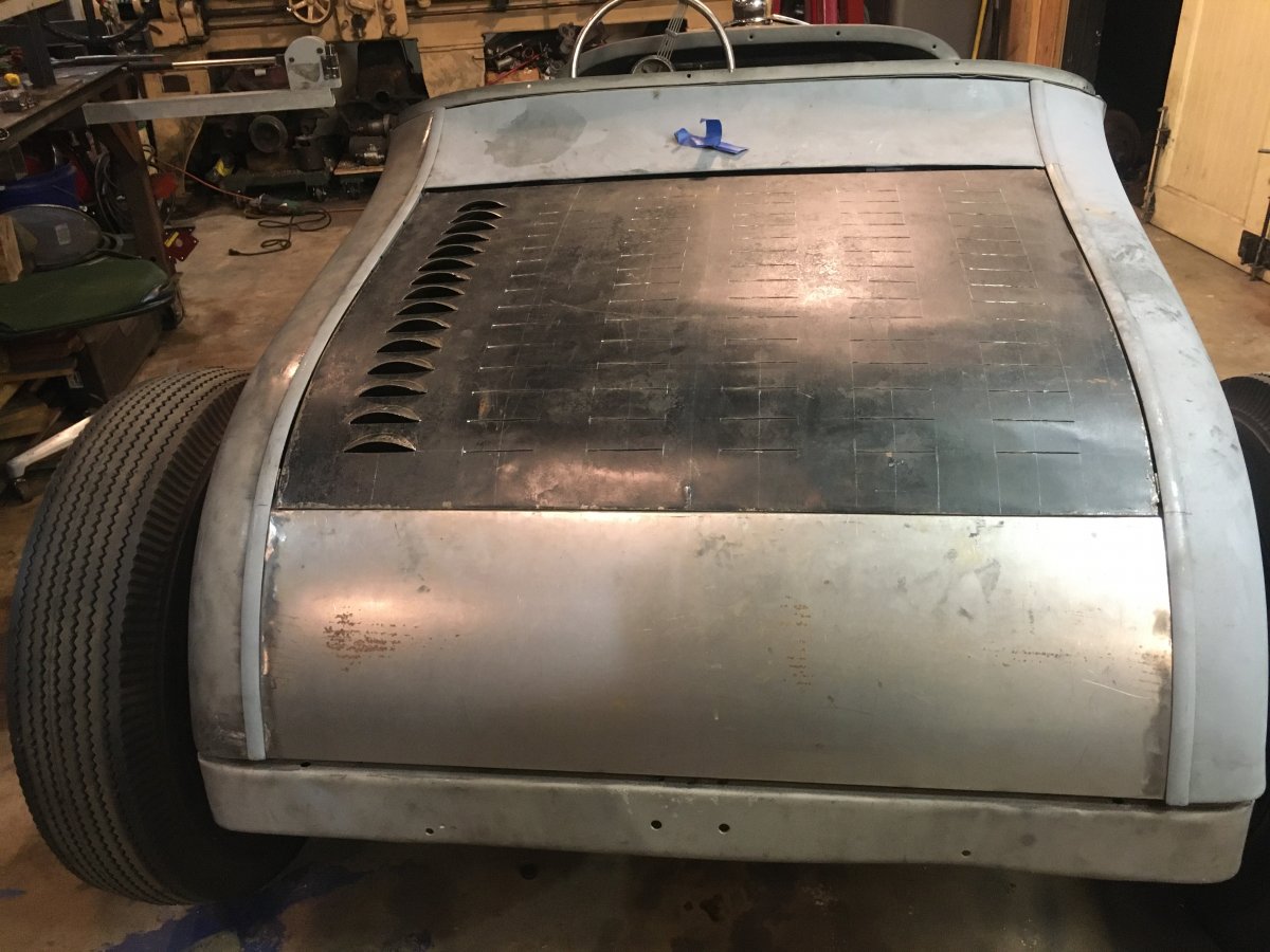

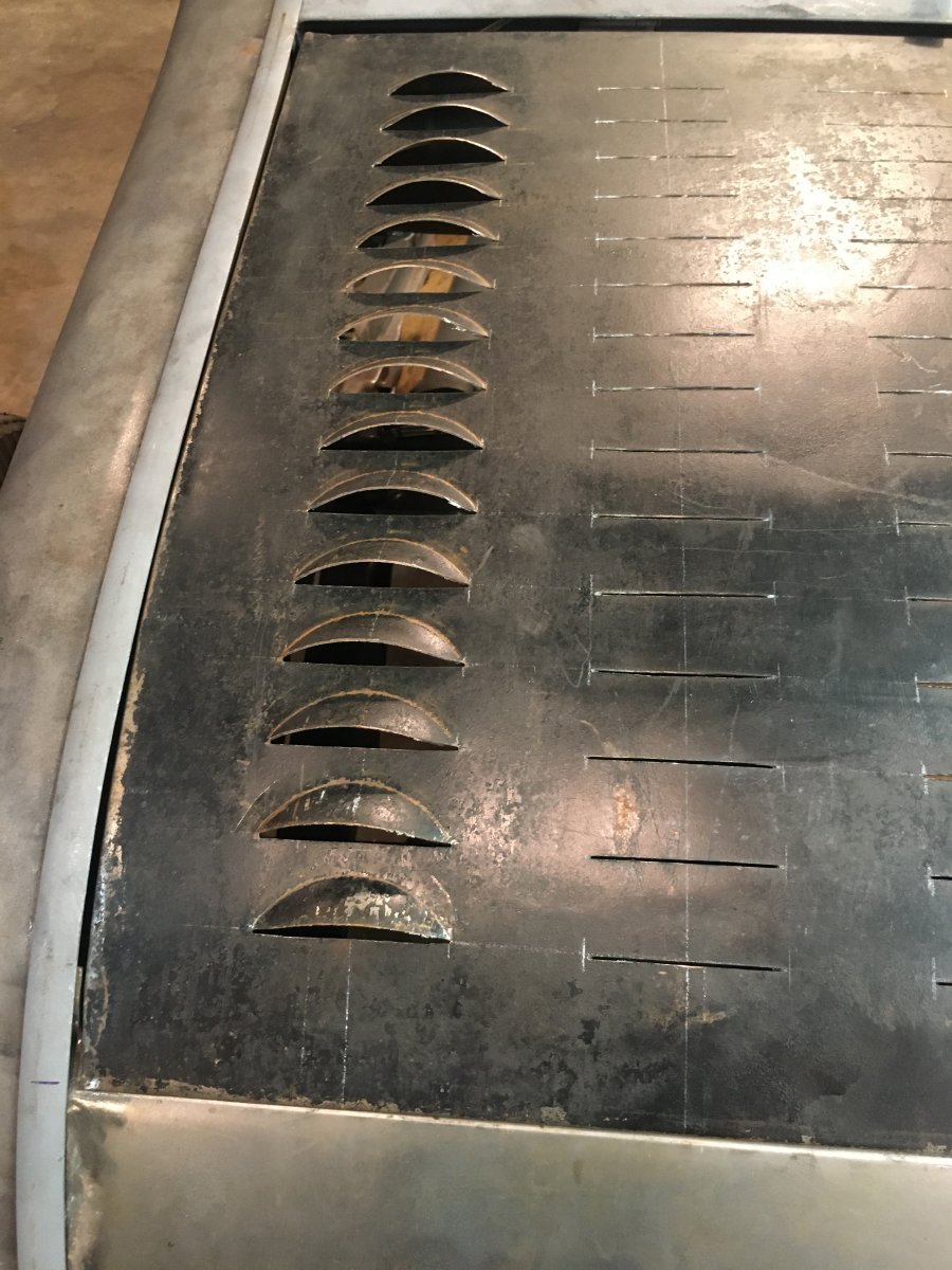

    Years ago I had seen some threads kicking around about cutting and punching louvers by hand. I made a louver punch similar to the one Jerry Laboranti uses.. I think he is on here but I cannot remember his name. He is an incredible craftsman. I used a 1934 ford big truck clam shell and torque ball chunk to make the punch. Again a few false starts but pretty good success in the end. I plowed my "new" decklid full of louvers.
