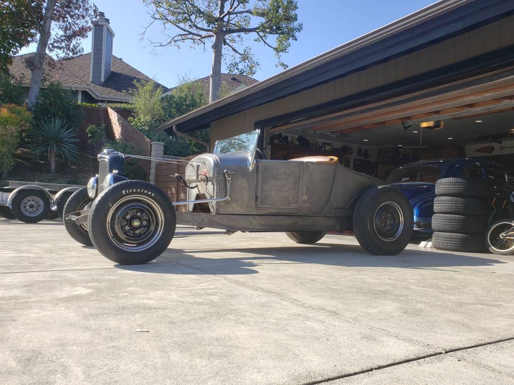

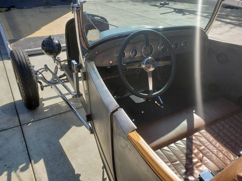

    Nice car! Here are some pictures of mine. I built this one in 1996. Rebuilding the motor for it now. Maybe you have seen it, since I used to live just north of Denver? Keep up the good work. 20200208_100836.jpeg 20200208_100934.jpeg

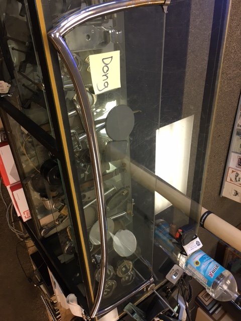

    Dong

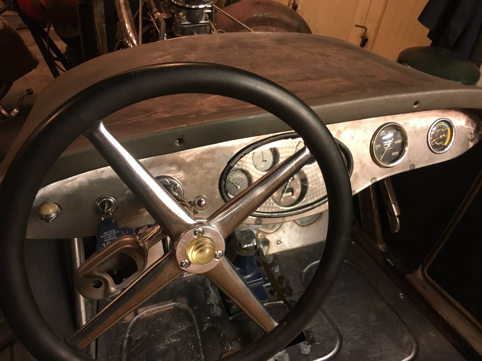

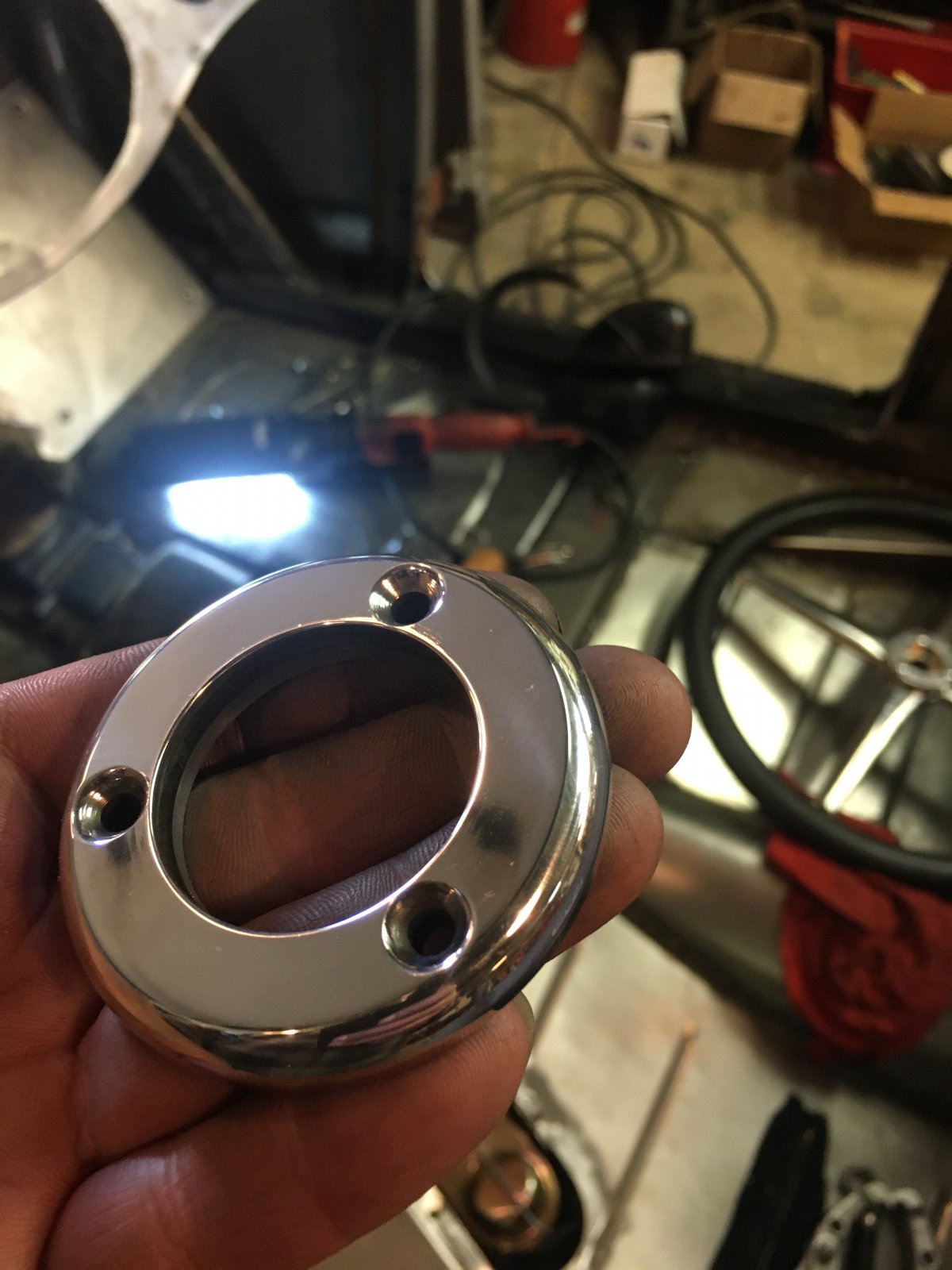

    So I am going to update my thread here a bit. The order and pictures may be a bit ****tered as I have not kept good record of anything. I have gotten a fair amount of work done. I've posted some of this to instagram. I'm growing weary with that with the new format and all the ads though. Anyhow, here's some pics. Windshield gl*** installed, some interior shots, I have changed the steering wheel to a model t wheel that an old timer friend flattend and polished up. The little donut thing is piece I made to surround the mast jacket-which is an 8ba oil fill tube-the donut bolts through the dash and has an o-ring in the ID to keep it all insulated from rattles. I've got my switch and ****on ***ortment figured out and installed.

    I'm using my old key switch from my 50 pickup, 2 pole starter ****on and some weird old light switch I found on ebay. I sectioned a yankee turn signal unit down to fit the confines as well. Here's a couple shots of my tack strip. I was originally going to make it, but I'm not much of a wood worker. I ordered this thinking it was going to be a nice steam bent piece. It showed up in a little box. A bunch of pieces that didnt fit for ****, so I threw it under the bench in disgust. I eventually dug it back out and shaped all the pieces to fit together, stained it and screwed it on. More to come in a bit. Dinner time.

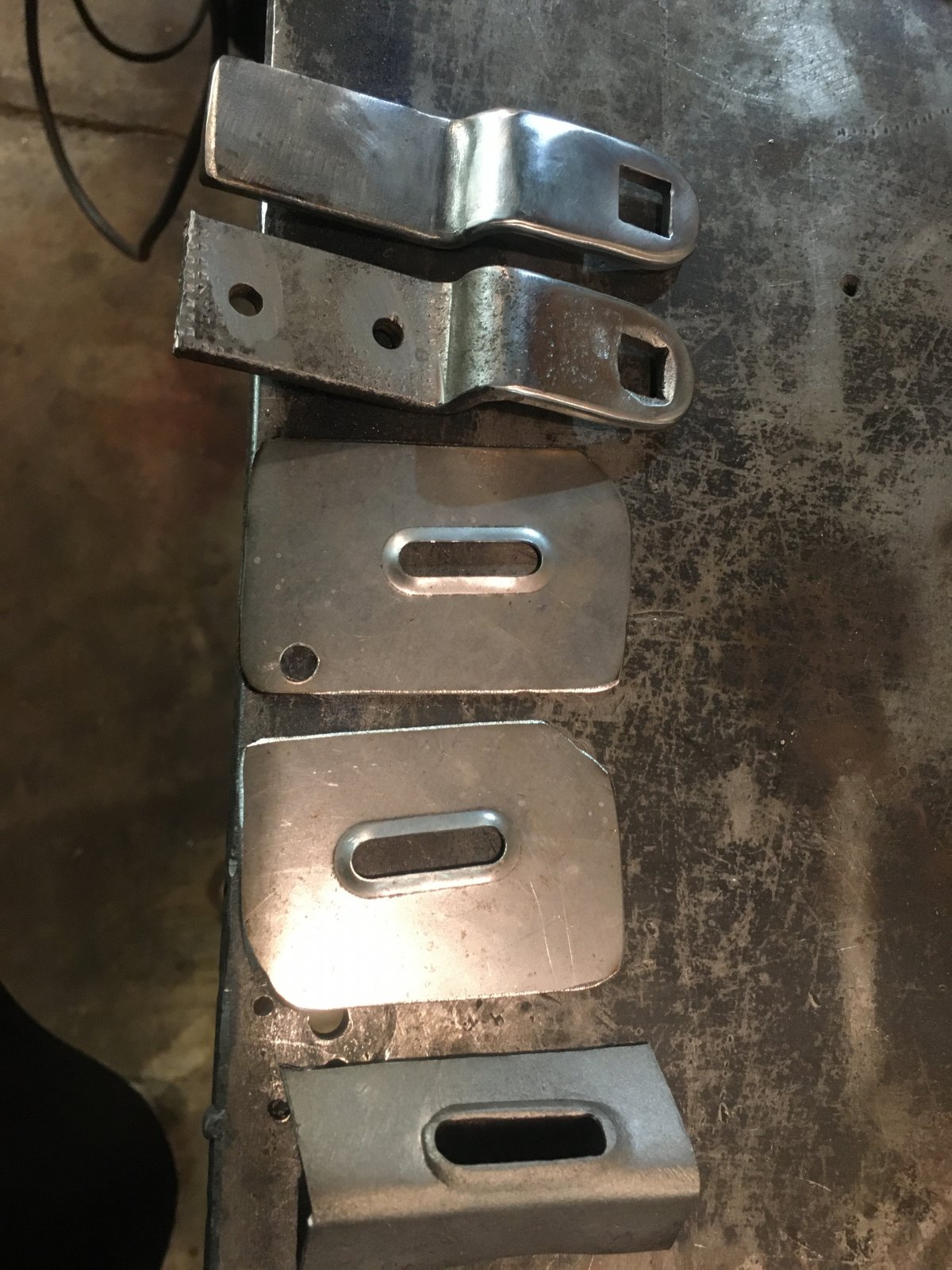

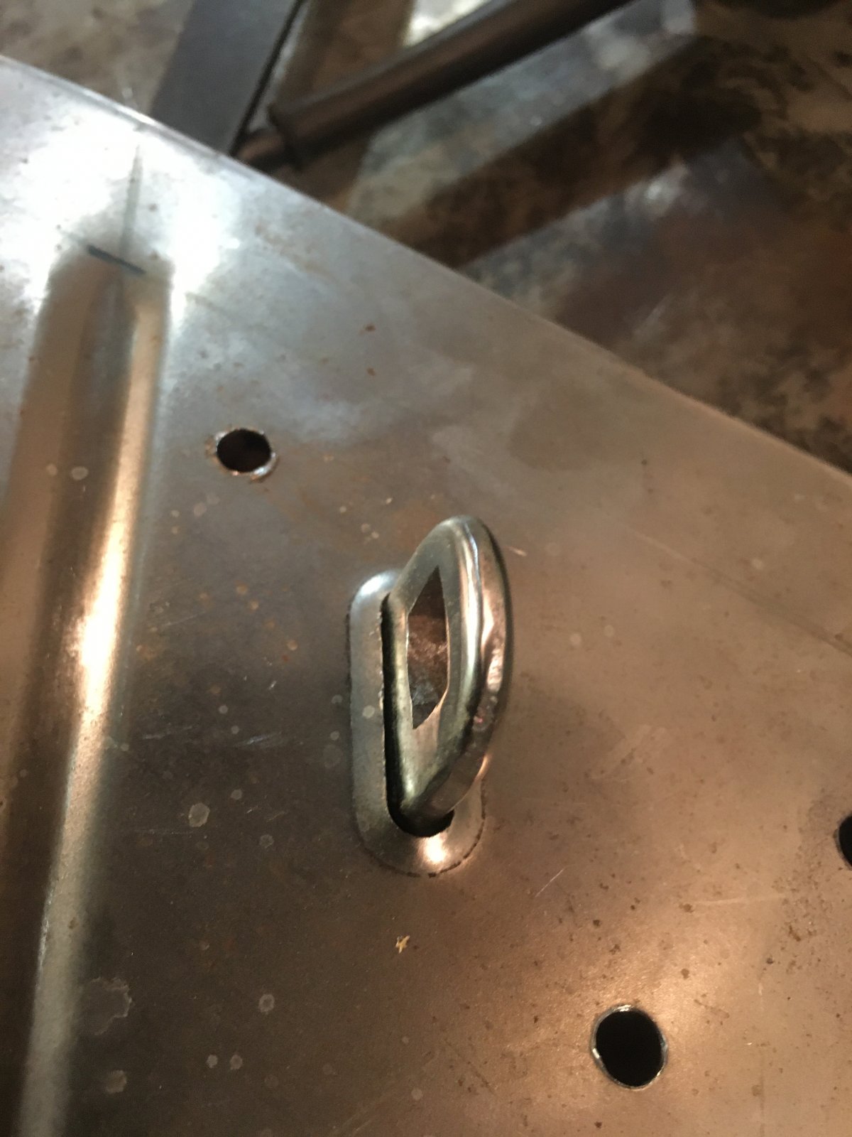

    Thanks @Tim , I will still get the wheelbase and hammer form pics for you. The car is blown pretty far apart at the moment. I am in the middle of ***embling the rear axle/torque tube with new bearings races etc. The front end is off as well, around 10 weeks ago, I dropped the hairpins,batwings,draglink,tie rod and headlight bar off at Quality Plating for chrome. They are in Yuma Colorado, about 2 hours from Denver if anyone around here is into that. They told me 10-12 weeks, so I'm getting pretty excited. Model T roadsters have this big ugly stud that sticks out of the body for the top iron to pivot on. Later roadsters have a tab sticking up through the 1/4 that is a touch more svelte (hoop i splet thay rite) . Here is a series of photos of converting the 1/4 to a model A style top iron pivot. I milled A little hammer form thing, hammered it in, then milled a slot for the tab. I used another door skin to patch one or both 1/4's , cant remember, then welded it all in. It was a real pain in the ***. Not sure it was worth it because I'm not certain it will have a top and it makes a tonneau cover more tricky for the hole in it. Shown in one of the photos is an original model A tab and one I made to copy it.

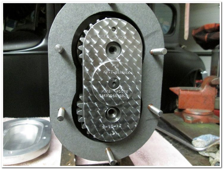

    I will have to take some shots of the finished part on that. I met Mike Moore at RPM nationals a couple years ago, I got on the list for onme of his quick change center sections. I got that back in the mail a while ago. I think I was #36 on his list. I'm hecka stoked for this, although I'm going to test out my slip in axle conversion rear end first, if it works then I will machine this carrier for slip in axles.

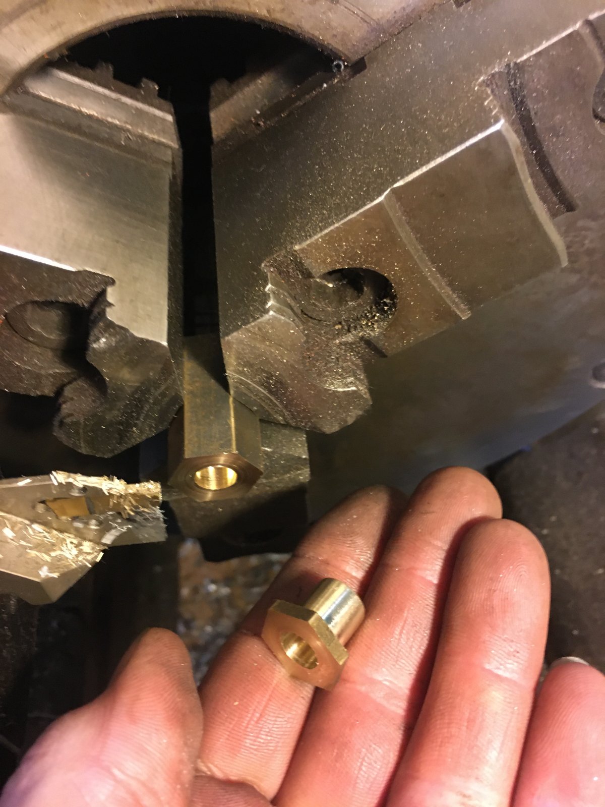

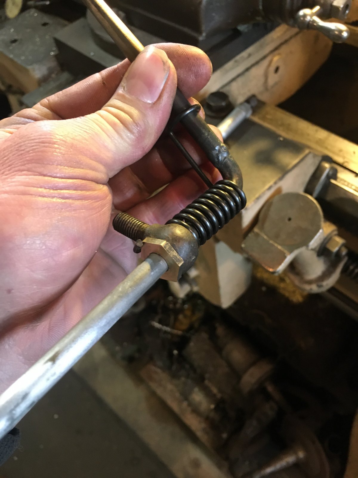

    These few pics are of my throttle pedal ***embly, new return spring on a 33-34 pedal with br*** bushies made from hex stock for the pivots.

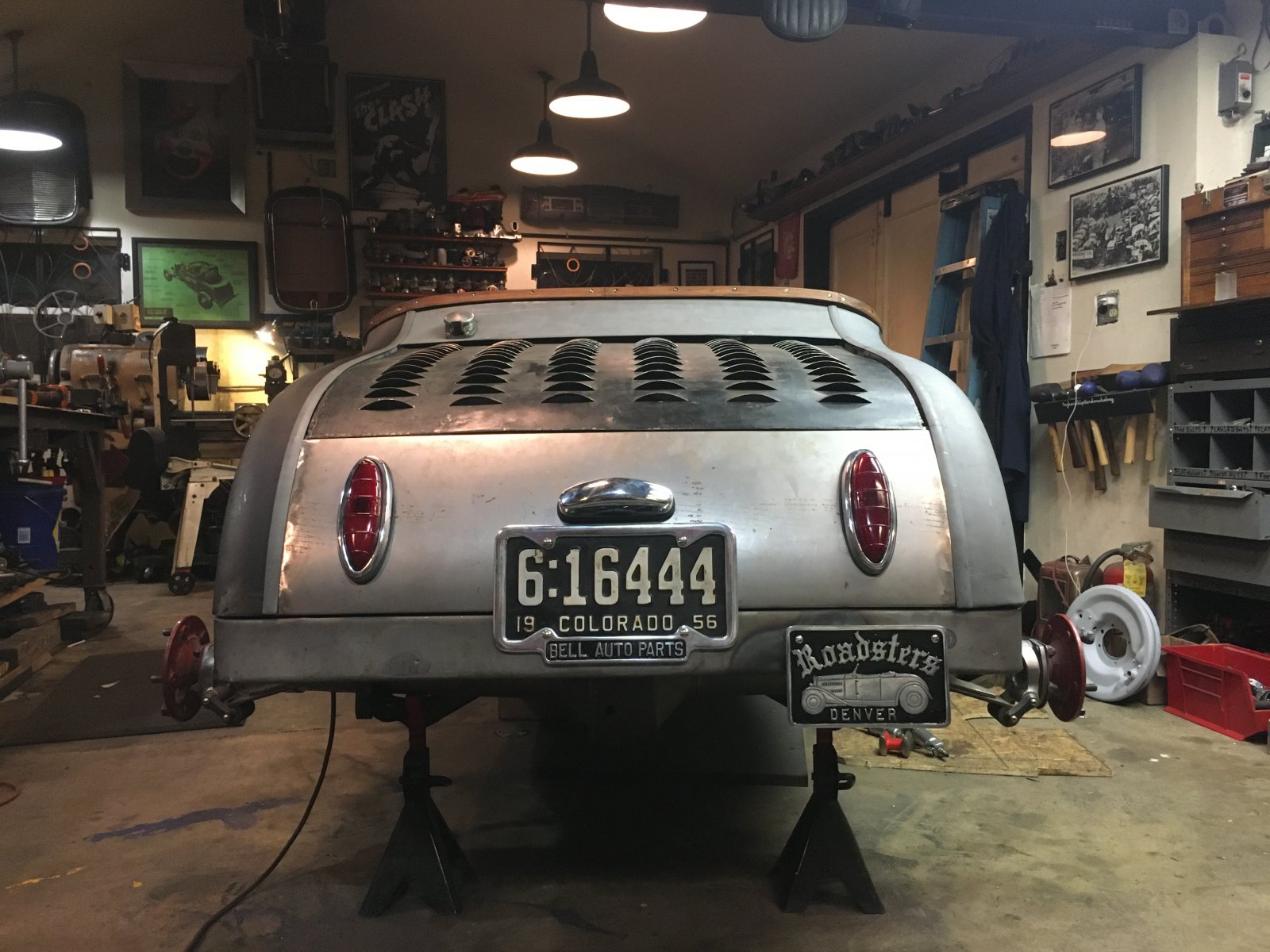

    Here's a couple bustle shots to close out the evening.

    I recognize that quick change. Mike is a great guy and only builds 2-3 of them a year. I am lucky enough to have #35. He is a very talented machinist and does an excellent job on these. I see he shipped yours to you, but I was lucky enough to pick mine up and meet him along with see his shop and collection. He had just started on yours and showed me how me does them on it. Very cool indeed.
